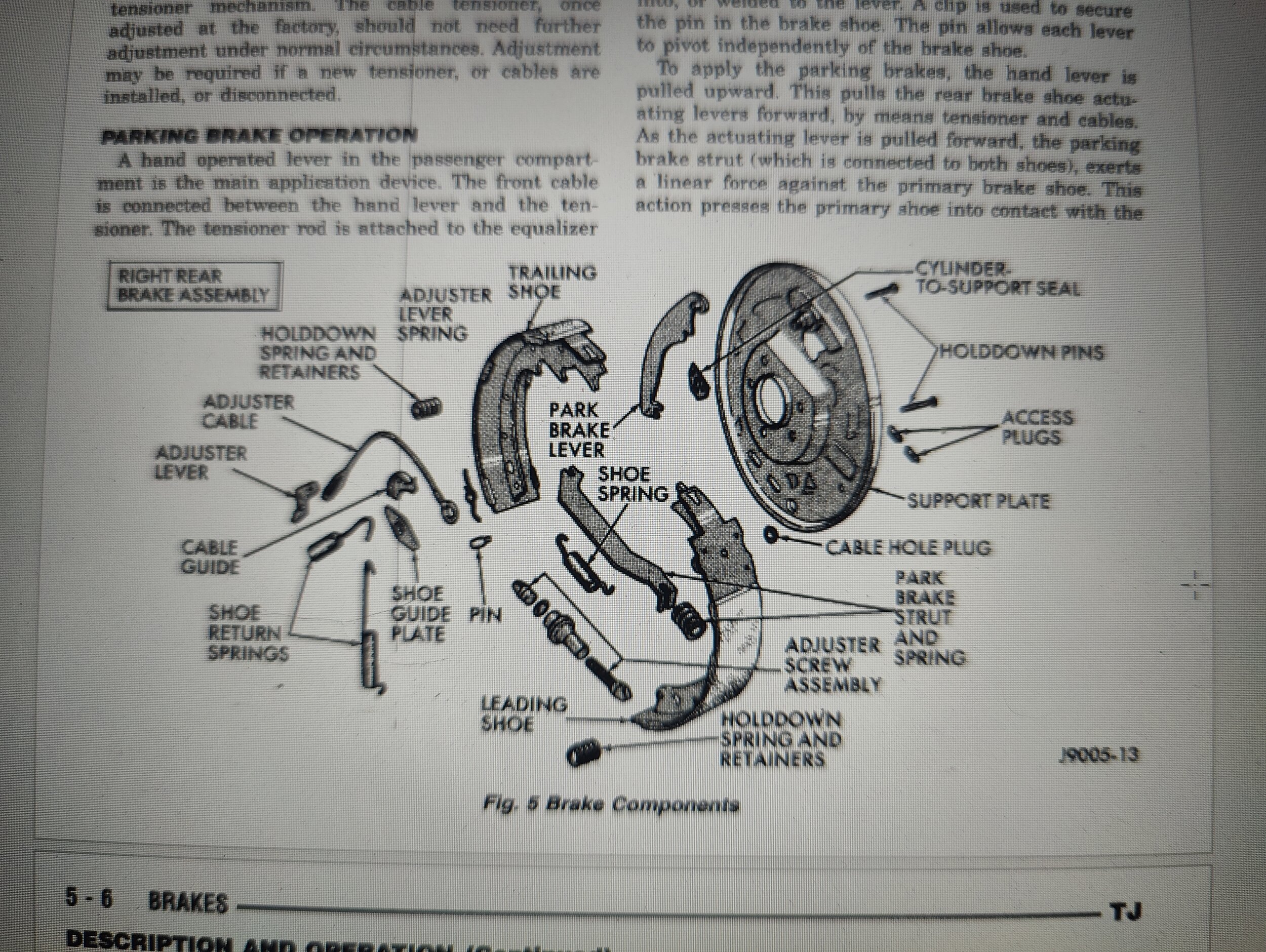

So I have a Dana 35 with drums, and I just completely redid the drums. New everything. However, my parking brake stopped working after the new hardware was put on. Do I have to break the cable adjustment bolt loose? Mine is fairly rusted.
Pictures? You probably just installed the parking brake pawl wrong. There are diagrams in the FSM under the resources section.

Dig up the diagram in the Factory Service Manual...compare that...
