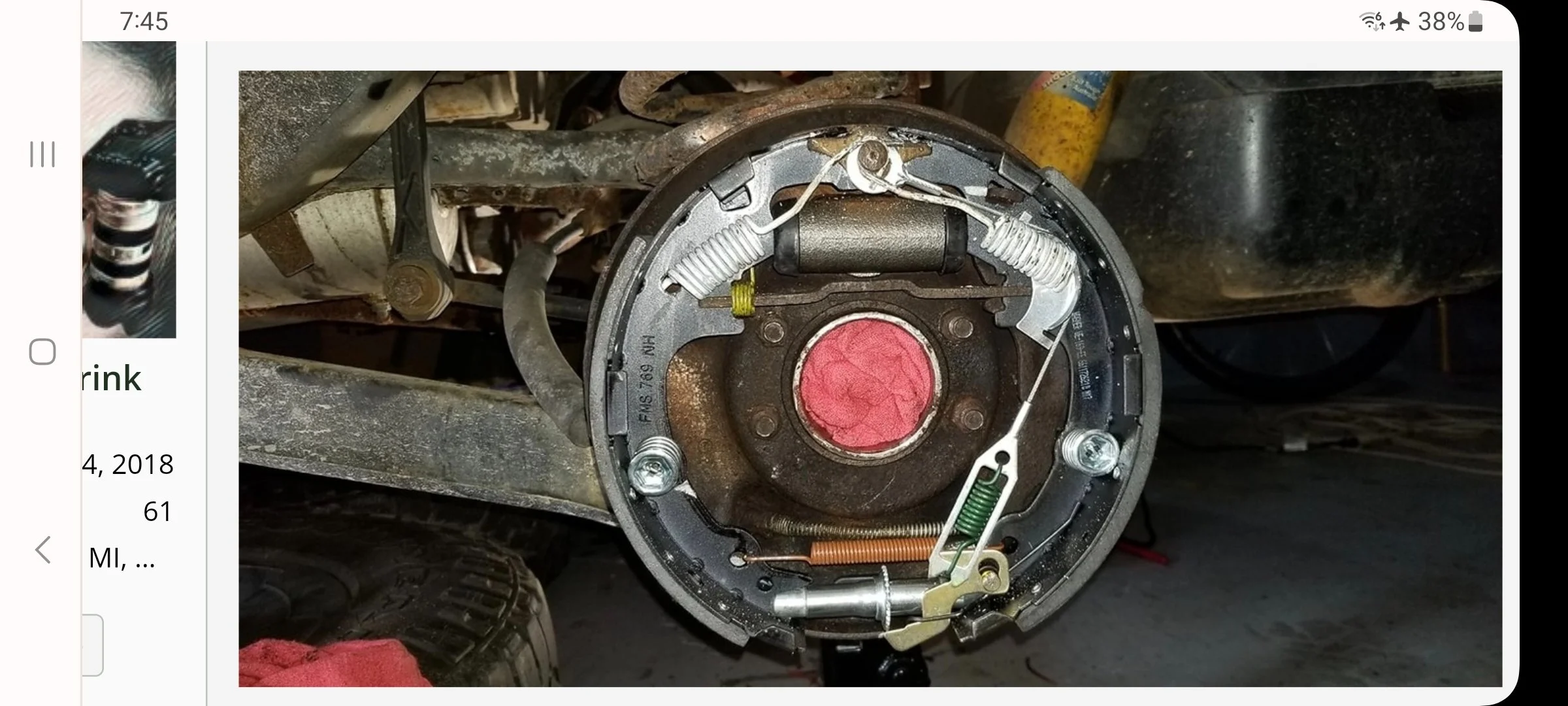

Are you referring to the actual pawl that pushes on the screw adjuster (expanding the shoes apart)? Some versions of that have a weird design with a section that does possibly contact the brake drum. It's okay to grind it down.
I'm talking about the dog-leg pawl at the bottom of the brake assembly.
Reactions: Rygrego
And if your pawl does not contact the adjuster, put a twist or two on the cable before you assemble it.

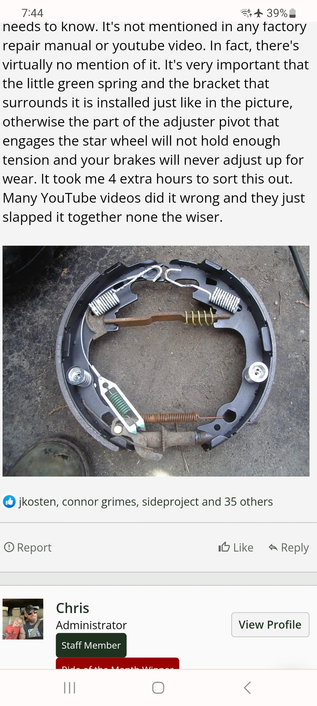

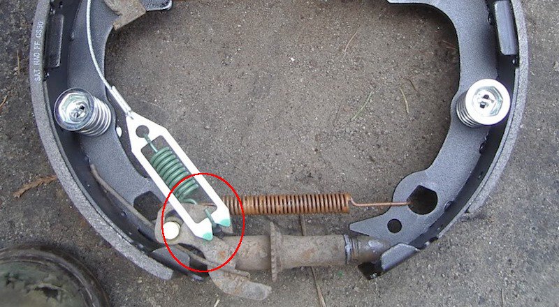

This is the correct way to attach the self-adjuster spring assembly to the adjuster lever. It is NOT obvious, but this is the ONLY orientation that works, anything else is a fail!

With that adjuster cable, as well as orienting it properly on the lever, you need to make sure the dimple on the rear of the adjuster guide is seated properly in the hole in the shoe when the spring is fitted. If it isn't the guide plate won't be sat fully flat against the shoe and the cable will be too slack.
