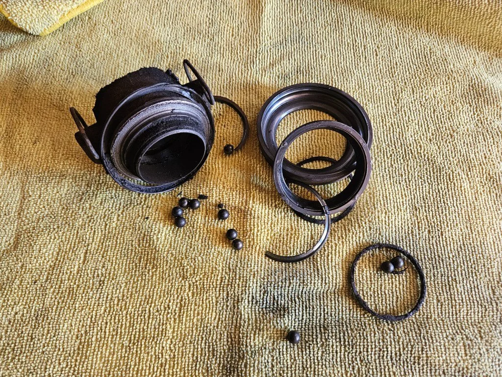

Legend has it that LUK switched to the nylon/plastic TOB so that it does less damage if/when the TOB fails. No idea whether it's truth or legend. I just swapped out a National TOB that failed within eight months of being replaced.
