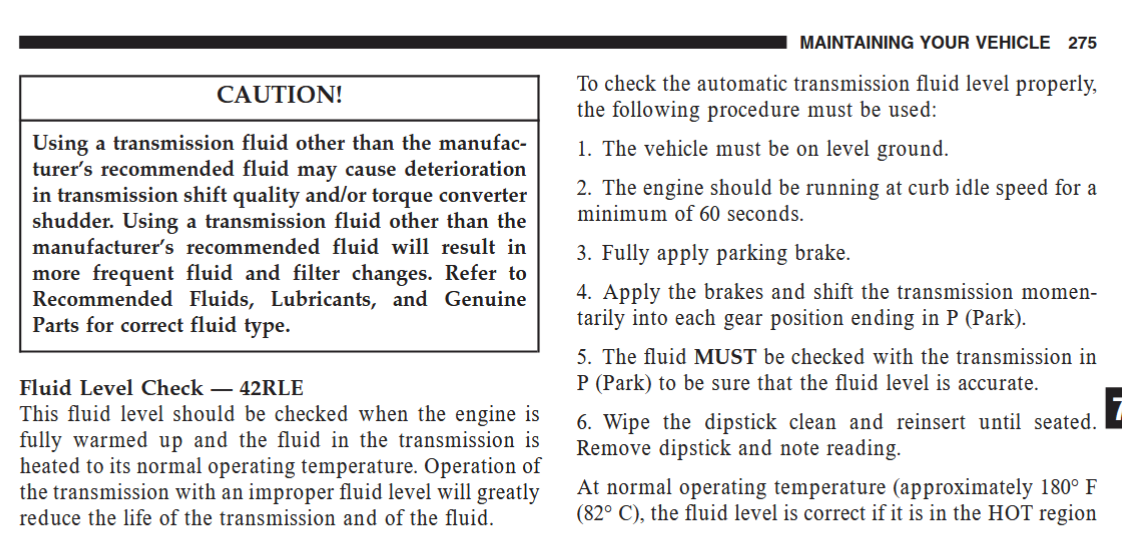

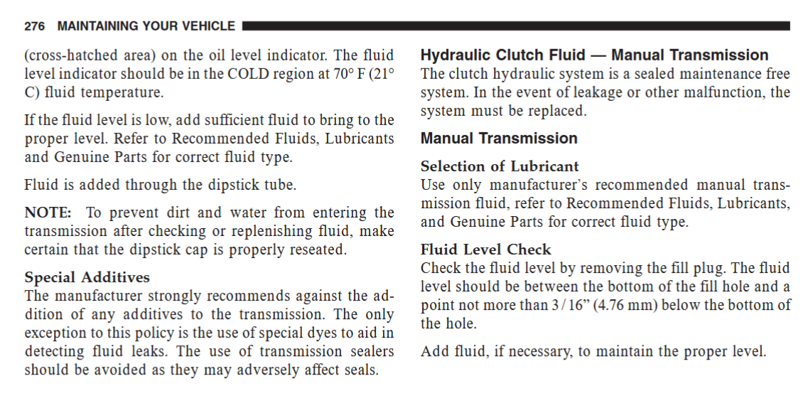

Can you be specific in how you changed the fluid? Did you check the level per the owners manual instructions for your automatic? It sounds like it's low on fluid.
I know you posted as a 2008, but your profile says 2005.
I had a shop look at it. They drove it for about four days. ( Owner drove it to and from home.) They are the ones that changed the fluid. I did check the level, it looks good.
