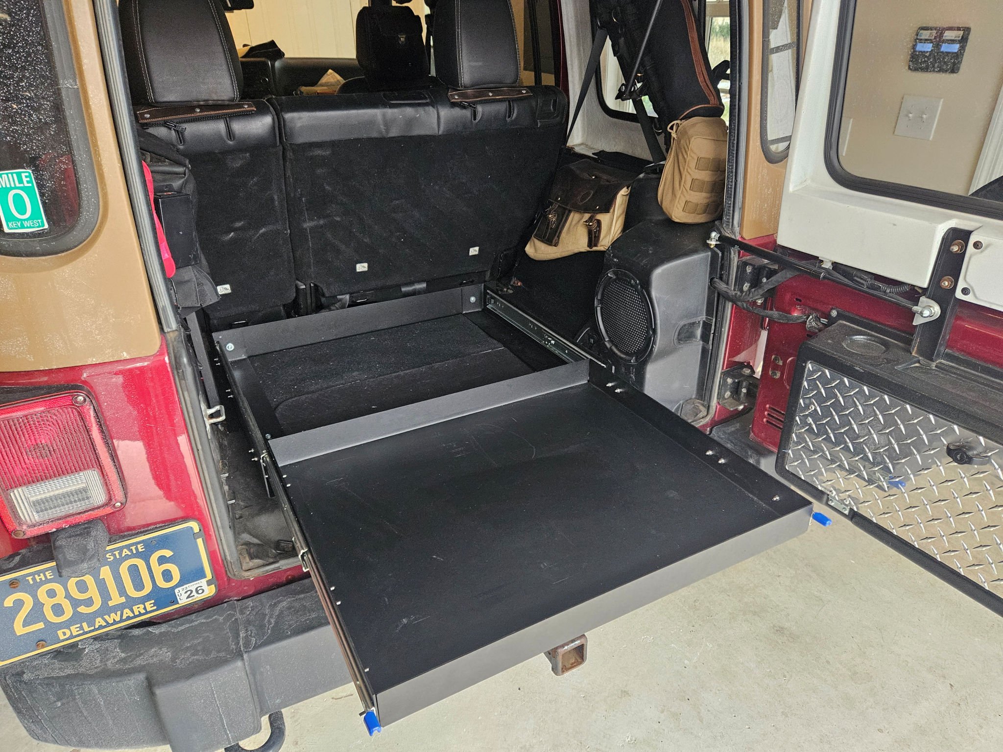

Have we figured out if it fits with the rear seat in the LJ?
In the JLU will it be able to fit with the rear seat upright and usable?
Thanks
B

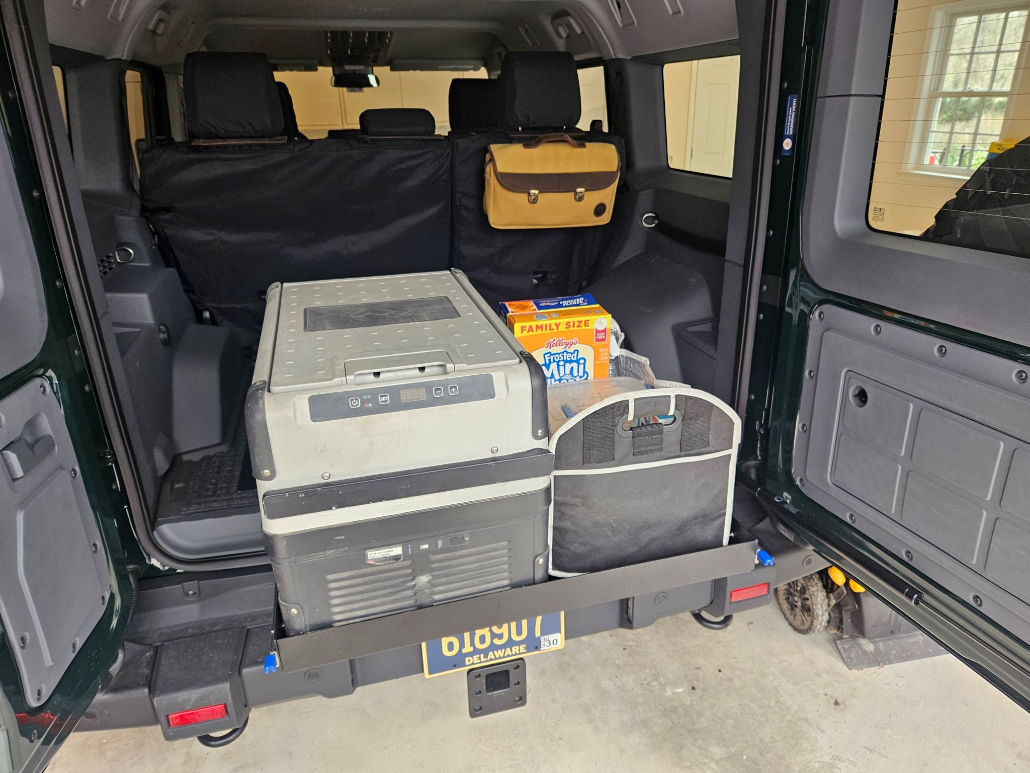

Yes in the JLU, JKU, Bronco and Grenadier it fits with the rear seat upright and usable. The very first photo in this thread shows the tray installed in my JKU and the rear seat is in place.

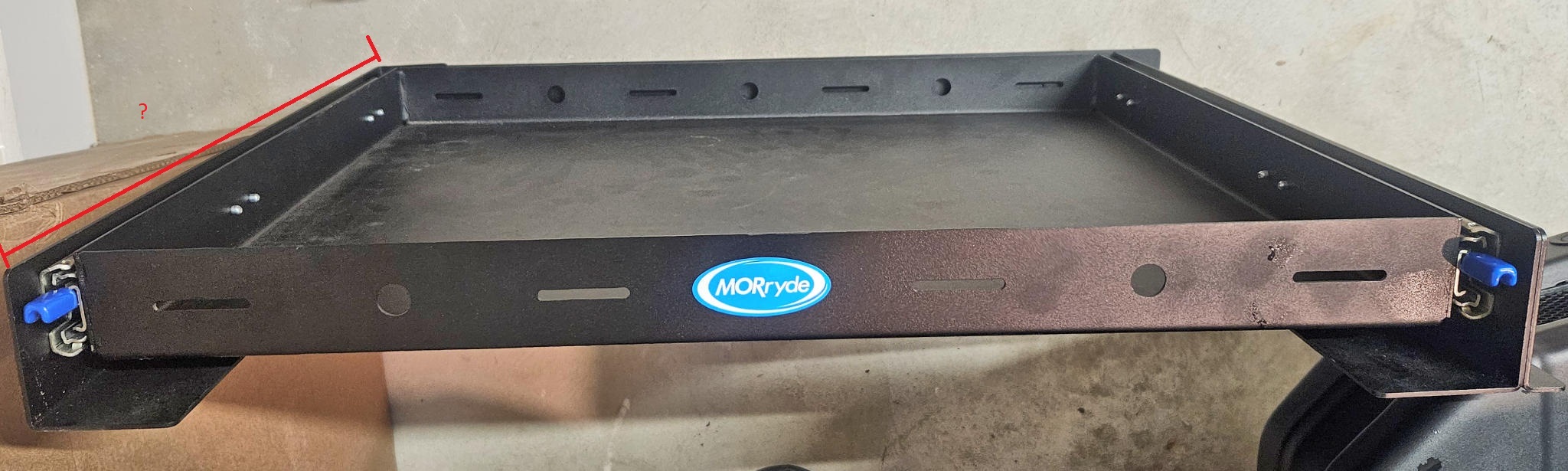

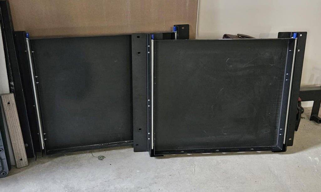

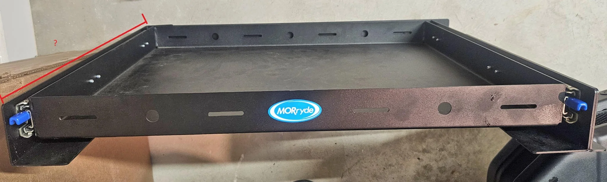

BTW I've got two of the trays here right now and while I don't plan to use them in my Jeeps or Grenadier I do plan to do some further product development with them, I've got some ideas for add-ons that maybe MORryde would be interested in (shown below with the Grenadier/Bronco mounting brackets).
