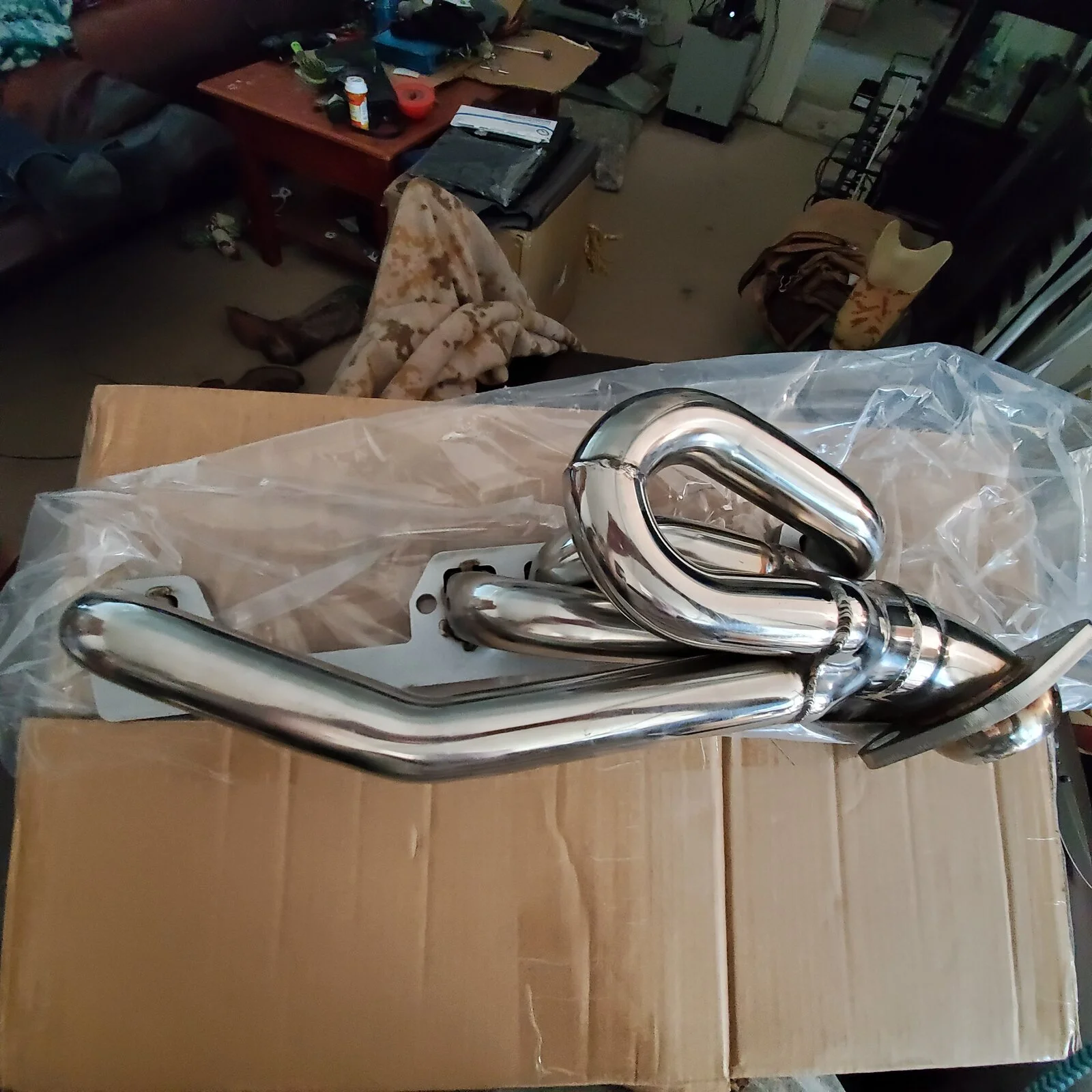

I just bought some CHEAP short tube headers that I'm going to use to see if they will work in the TJ frame with my V-8 and if they do then I'll get some brand name headers instead. Since I'm not having to deal with CA and all their stupid BS I don't have to have CARB approved headers.

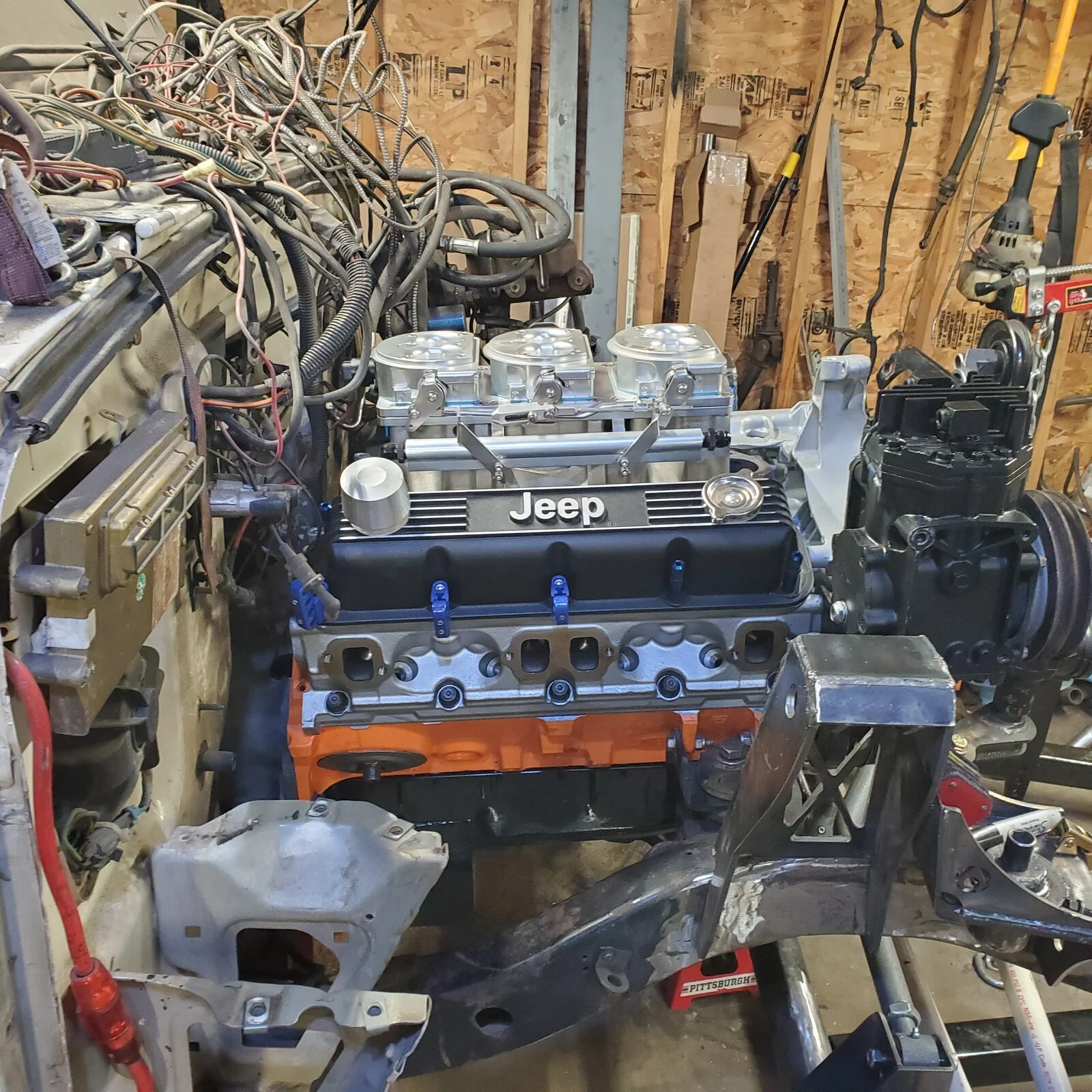

I know many guys who bought a wrecked truck or GC and used all the parts off it and then sold off the rest and when done had done the whole swap for under $1K. How much does a stroker engine cost? You might be able to do the engine swap of the stroker engines in a weekend but for not much longer you can do the V-8 swap also if you have everything ready before hand. Of course the wiring harness is the biggest hurdle in all that.
I started with a SE TJ so I didn't have the option of going to a stroker 4.0. And so it was just as easy to do the V-8 swap as it would have been to try and do a 4.0 swap.
If I lived in CA still and was looking at doing a V-8 swap I'd either do a Hemi or LS swap just becasue of the support that is now available for both those platforms. But back in 2005 when I started my swap both a Hemi or LS was so costly that I couldn't justify the expenditure which is why I did the magnum V-8.

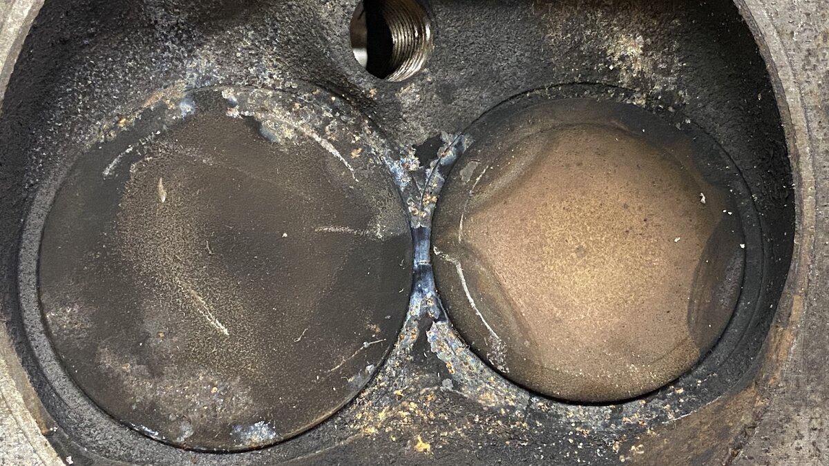

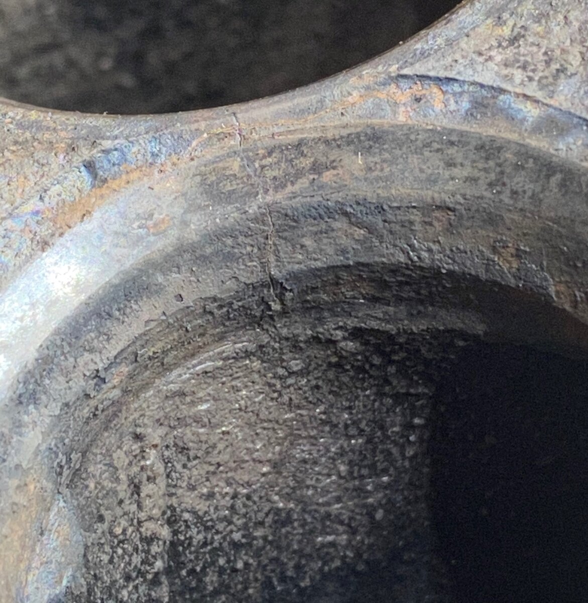

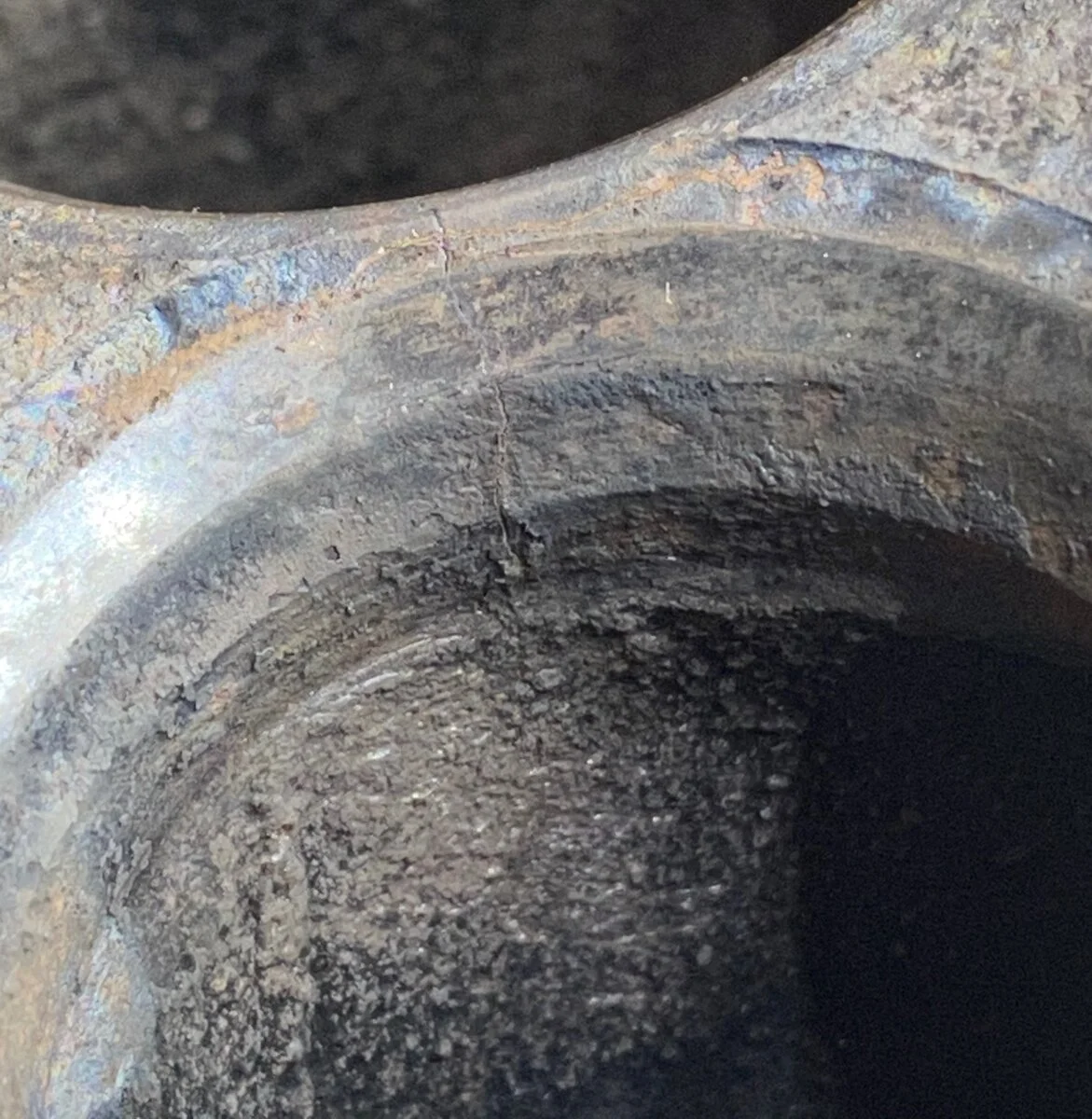

Some of the guys who have done the magnum V-8 swaps over on JF have said that they have seen 18-21 MPG after doing their swaps. I can't claim to ever have had those numbers but I was fighting other issues with mine for a long time. I never had any cooling issues with mine until I had other engine issues. Mine ran at 210* all day long even when the outside temps were 100* or higher. My overheating problems were finally diagnosed as a cracked cylinder head that didn't show itself until the engine was at operating temp.

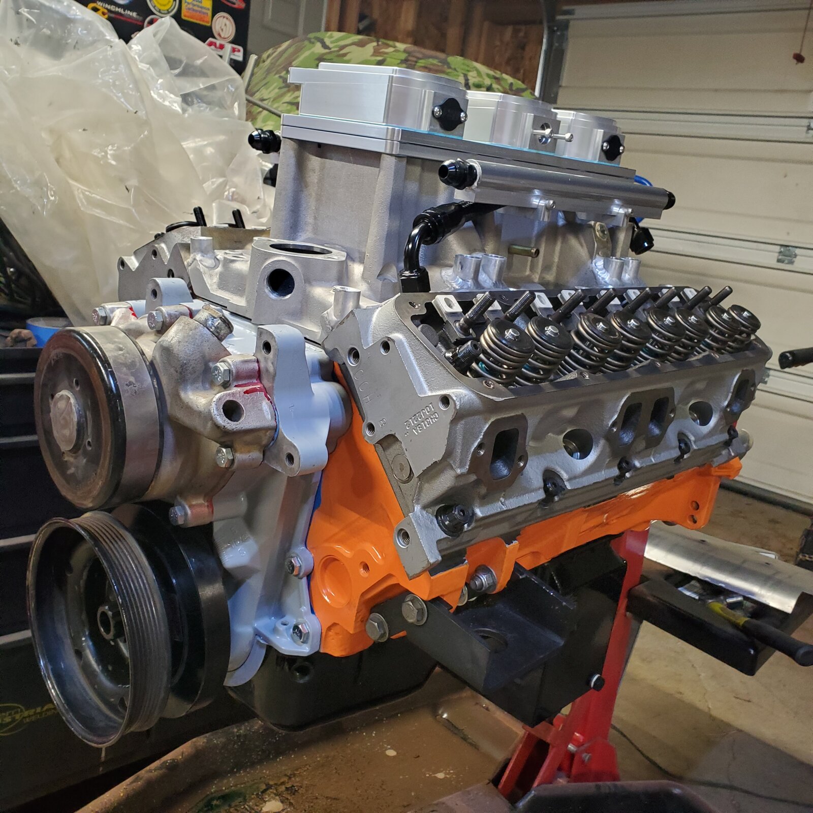

But I'd picked up a 5.9 core engine and lucked out and traded it for a stroker SB after I'd rebuilt it.
Now with my 6.7 stroker I have decided to have a little fun and have a FI 6pack manifold I'm going to be running on top of it.
