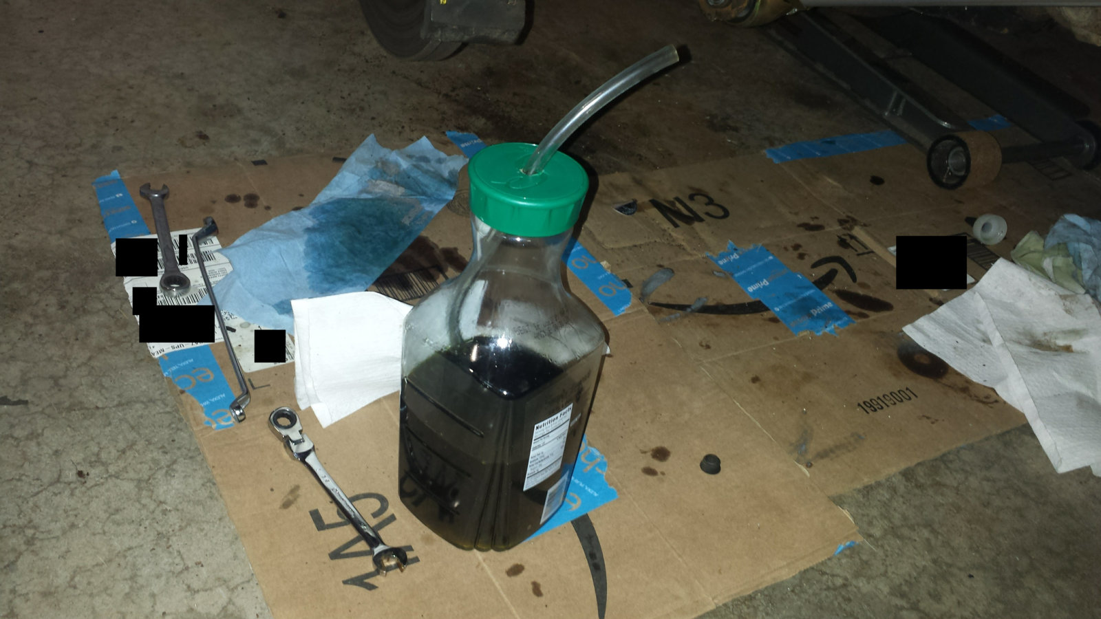

You don't need any special brake bleeding kits. Use a bottle connected to soft hose. Have somebody in the driver's seat press the brakes while you open and close the bleeder valve. Keep going until you either have no air bubbles in the system (you shouldn't have any since you are only replacing the pads) or until you see fresh fluid coming out.

Perfect ! what size is that wrench for the bleeder ?
