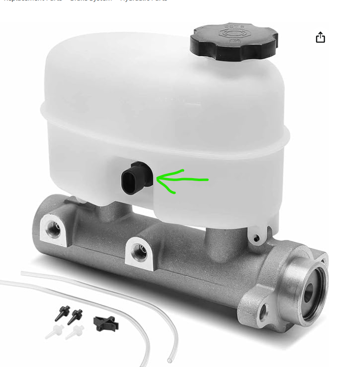

The shop is stupid. It is not a brake fluid level switch. First, a fluid level switch or sensor would be in the side of the fluid reservoir so it would be able to read the fluid level.
We have a simple plunger switch that has a spring loaded plunger that holds the shuttle valve in place. Entirely different function.
Fluid level switch-
