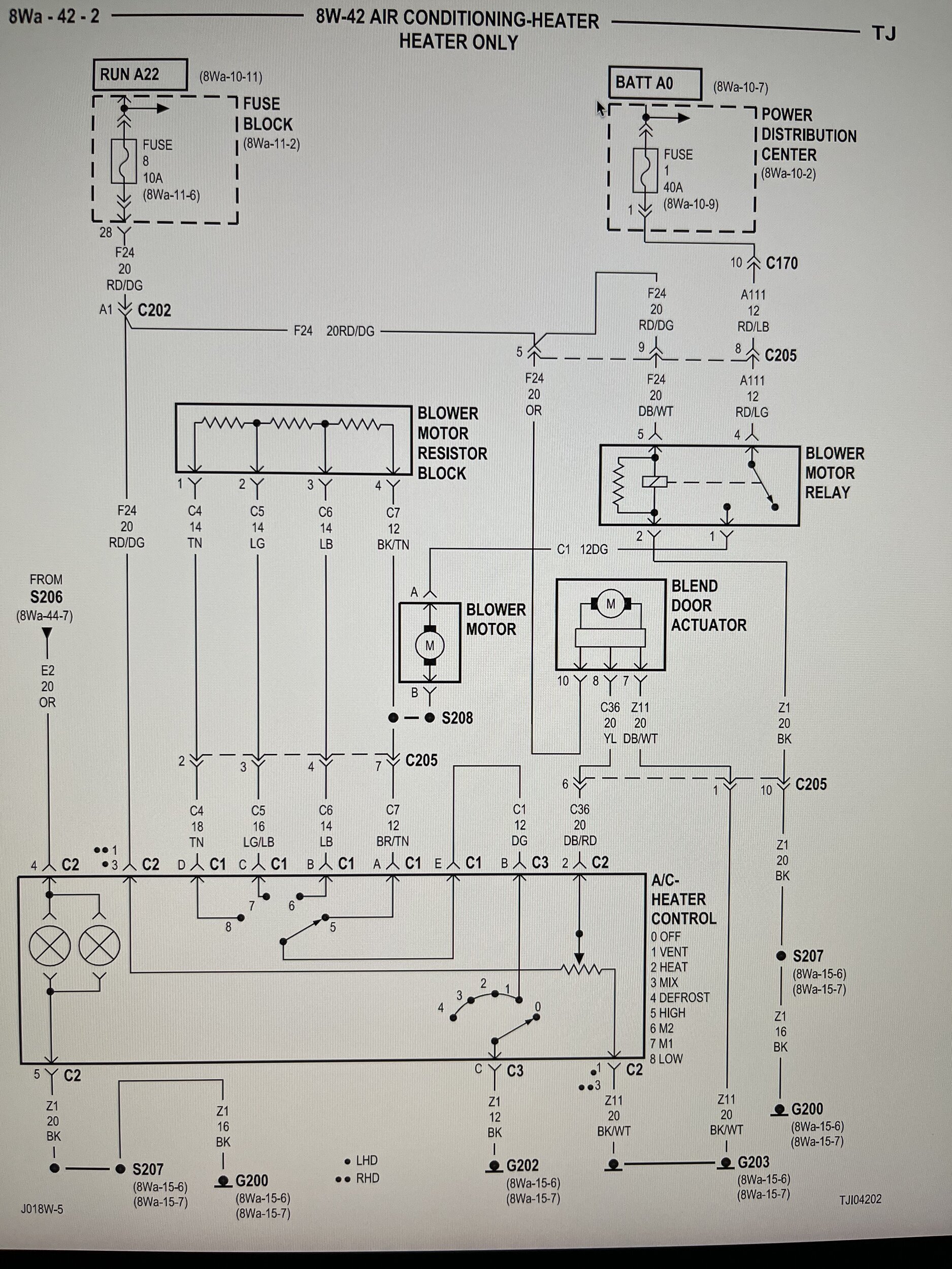

OK, lost my #3 blower speed. Found the bower resistor plug connecter melted on the gray wire.
Sprayed some electrical contact cleaner on it, and it worked for a few months.
Not working again, so I decided to fix the issue today. I have a bunch of auto electrical connectors mostly removed from my old Jeep Liberty which dropped a valve. Found a similar connector, and removed the pin connector, to attempt to replace the pin in my TJ plug.
Got it replaced, but still no #3 speed. Guessing the wire was broken, I cut some off. But still not getting any power to the gray wire.
I doubt the switch is bad. Resistor is good.
Can anyone send me the wiring diagram for an 01' TJ or at least the blower wiring color codes etc.
I am very experienced in electrical and electronics, but this really has me stumped.
Thanks in advance.
