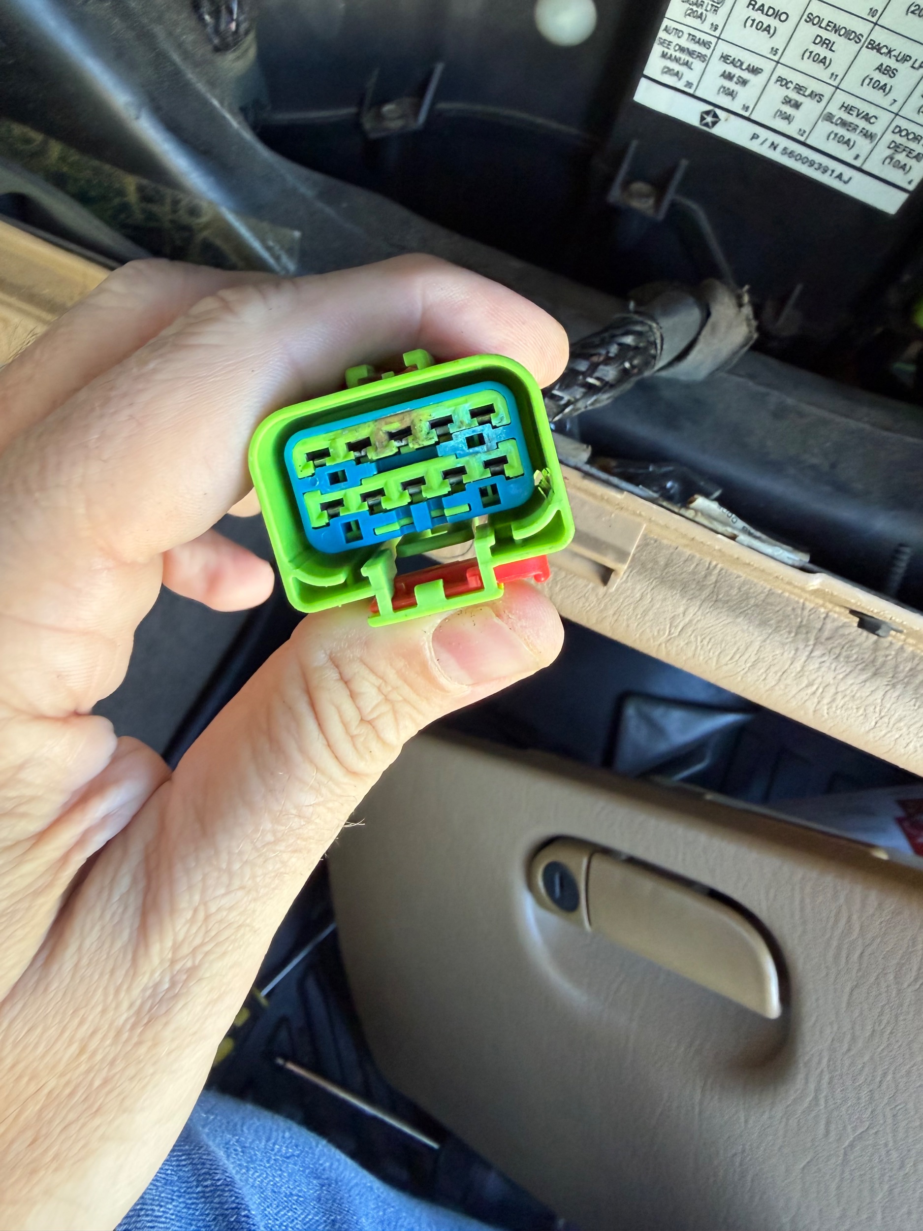

Ok so my heat core does work and I feel heat but no blower function. I checked relay and fuse and are both good. I changed the heater resistor and still nothing.

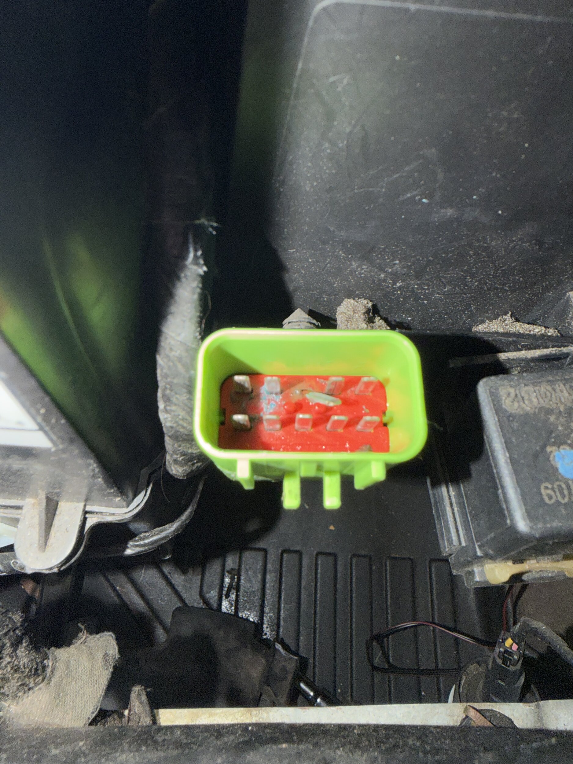

This connector had a lot of corrosion and used electrical contact cleaner and a pin is broken. I believe this is my issue and should be resolved once I fix this. I can’t find a replacement harness for this? What’s my best way to repair? I doubt trying to save this harness since it was really corroded badly.
Any guidance would be appreciated. A soon to be really cold Jeeper here here 🤪
Or bypass that connector for just that one wire.
I did bypass the wire thanks! I used my multimeter and I’m getting power all the way downstream to the blower/fan. I just ordered a new fan I think it the issue. But I do believe the corrosion in the connector was also contributing to the issue. Could it have made the fan stop working?
Before not working at all it would sometimes not work and then randomly start blowing. It had signs of an issue for a whole.
