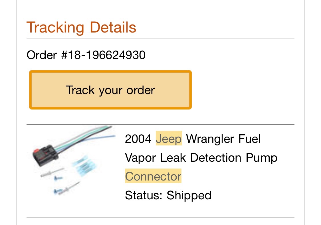

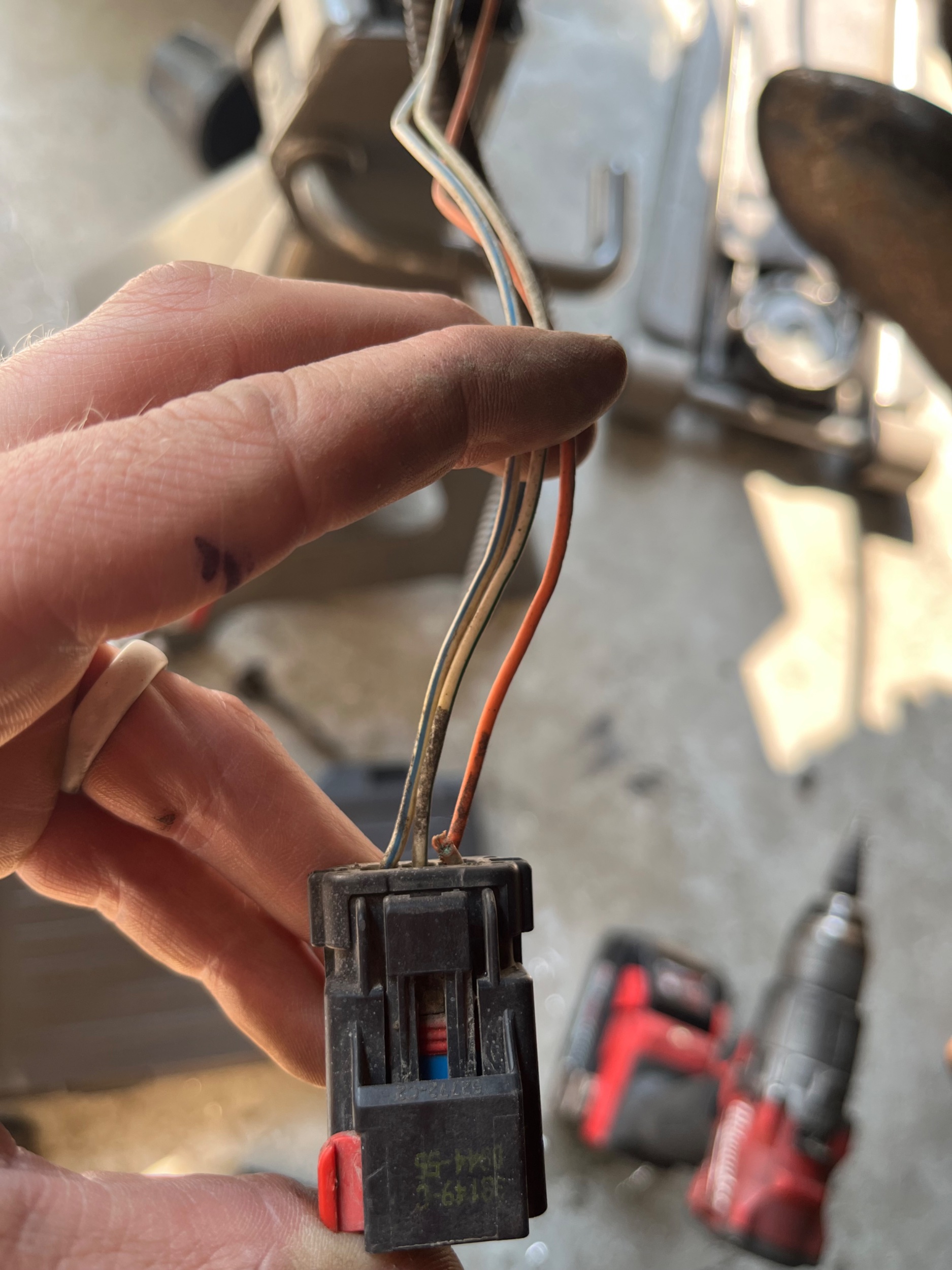

As part of my relocation back to make way for 37s, one of the wires on the electrical connector which runs from body harness to the evap assembly broke. Does anyone know if there is a replacement available in aftermarket for this? I bought an evap pump connector with leads from Rock Auto but it’s a four pin, I can’t find this exact connector. I bought de pinning tools on Amazon but also not sure what pins are required. Any help is appreciated.

Using that name, I found this that looks like it could be a match: https://www.partsgeek.com/my7h7s9-j..._Bz9kAYhM_6y3qfbMqrG1hP2W9An290YaAoVGEALw_wcB
That’s what I thought also but if you look in the description it says “4 terminals.” This is essentially the one I purchased Standard Products
S-949

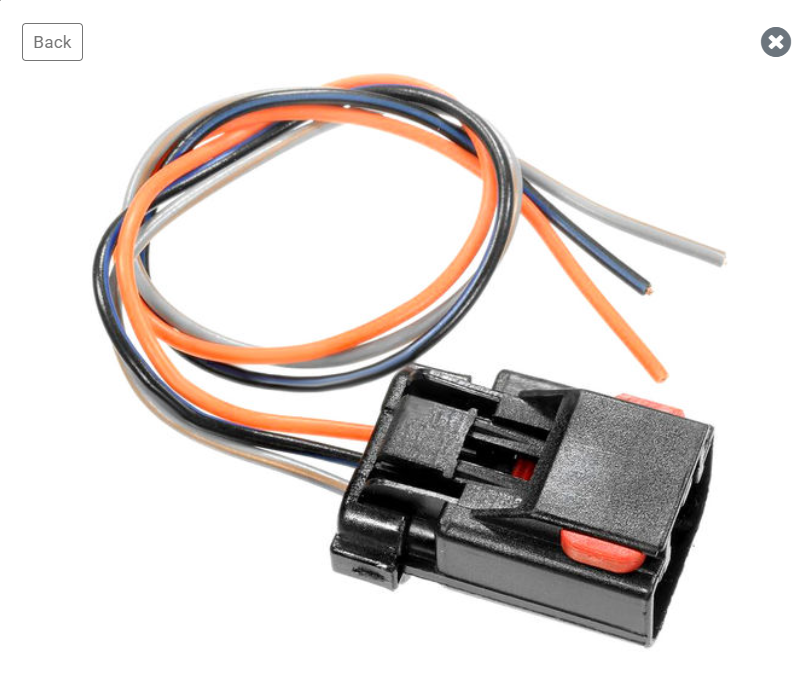

Searching for that part number, amongst other results gives this one I found on Amazon com
https://www.amazon.com/dp/B087M7MLGB?tag=wranglerorg-20
It's available as just the plug, with 4 crimp terminals or with pigtail wires.
Check the end on view of the connector as it needs to match the exact shape of the one you want to replace if it is going to fit.

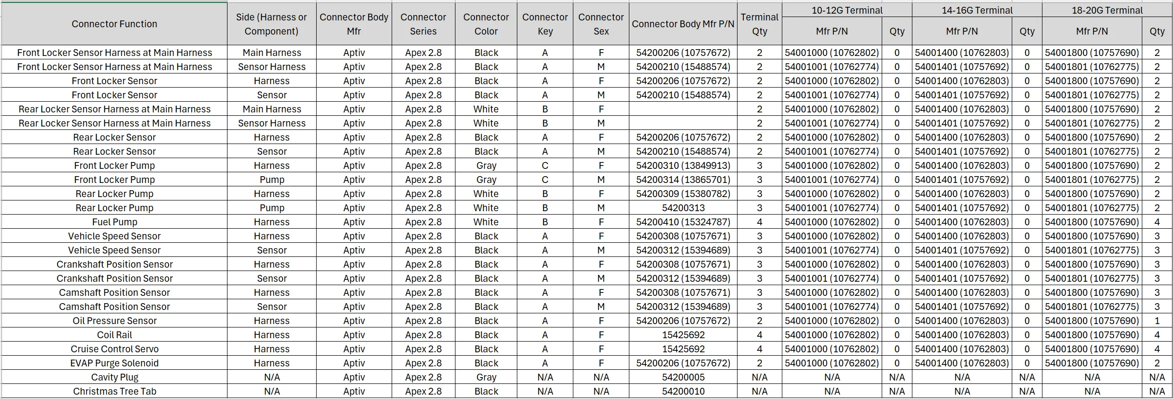

For anyone wanting a connector and loose terminals (without pigtails), those style connectors are Aptiv Apex 2.8 connectors. The black body is key A (other body colors are different keys and key letters). Here's a spreadsheet I put together for my '05 Rubicon when I re-did the rear half of my harness while installing the Atlas and cutting brakes (I highlighted the part numbers for the 3 pin female, but you need to determine what wire gages you're dealing with):
I found three different sources for those connectors, and prices from all were very reasonable (to me, anyway):
  1. WayTek
  2. Custom Connector Kits
  3. Corsa Technic

I think there is more than just that going on here and it wouldn't be the first time Jeep has done this. His rig is an 04 and should have an actual leak detection pump and not the NVLD system the 05-06 use. The problem here is his connector is a 3 wire, 3 pin which is what the 05-06 uses for the NVLD and not the 4 wire, 4 pin his 04 should have for the LDP. We also know his is an 04 due to the separate TCM. Or, I'm really missing something obvious which someone needs to help us figure out.

I got the 05-06 connector, but haven’t wired it yet. It’s a match! Super odd to see the year jump in my 2004 which does indeed have the stand alone TCM so its definitely wired as a 2004 (in the front). Thanks for the help.
