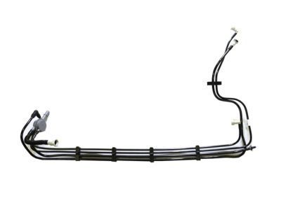

3) checking the evap pump location at rear smoke is readily coming out from the hose CONNECTION TUBE on the manifold looking piece. - The connection tube was cracked at its base -basically the manifold was cracked. YEESH!! This item seems to be unobtainium - no long available -it looks like it is made/sold as a complete hose assembly - but again obsolete.
4) I used some plastic epoxy and patched the crack - not leaking after second test - time will tell... I am now on a search for a replacement evap hose assembly

mopar # 52100491AE Hose-Fuel Line
