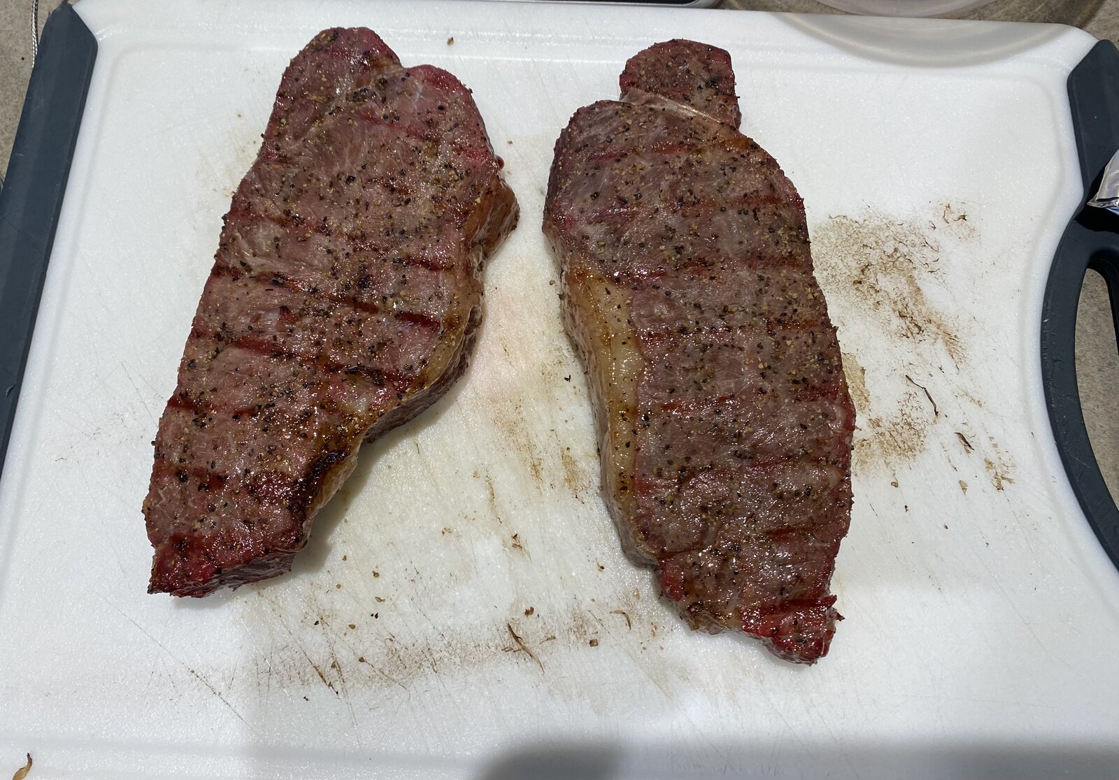

First cook with the new controller was strip steak and corn on the cob. 225f until 110f internal on the steak(they were a little thin) and then cranked it wide open to sear. Controller runs a touch on the cool side with a low of 209 and topped out at 228f one time but most of the time ran 212-222f. It is 52f and raining so I knew that between the weather and having the drip tray in 450f was out of the question. And I was correct hitting a high of 411f so a bit low to get good color on the steak. But for a first run I think I am going in the right direction.
Used Pro Blend pellets and Anything rub on the steak.

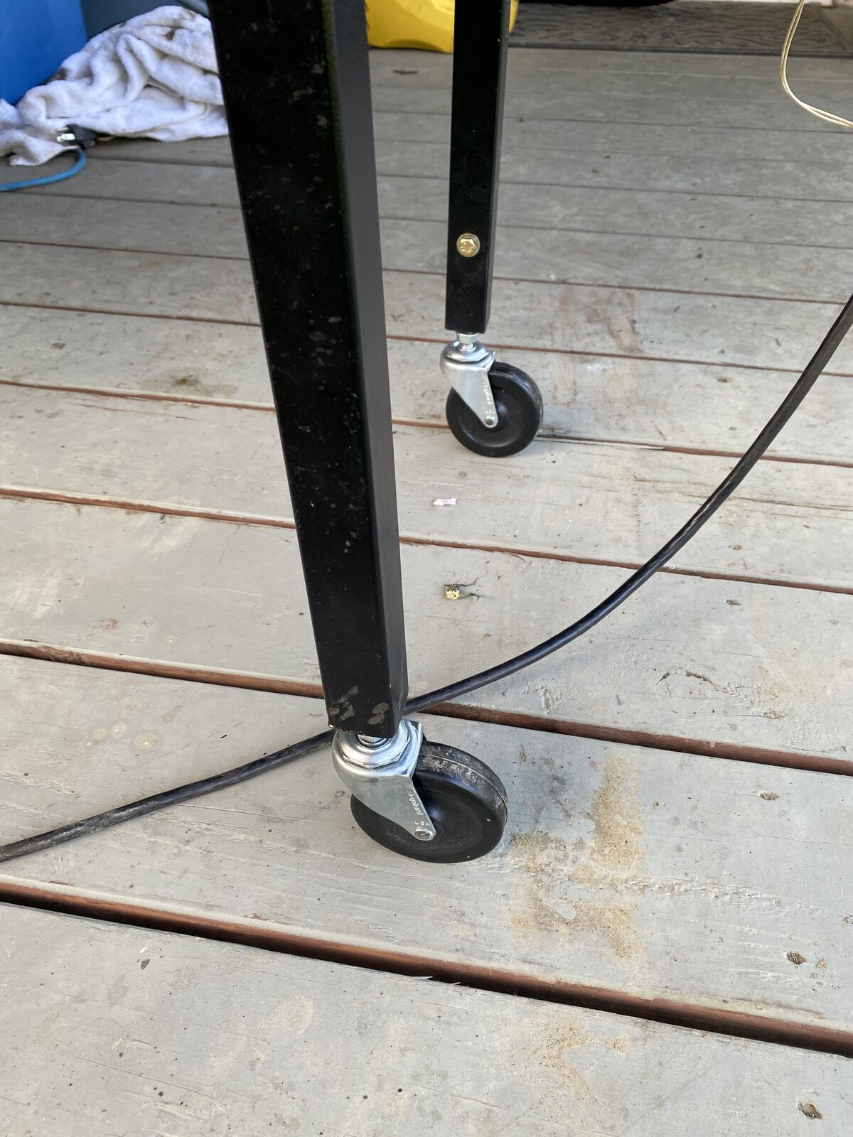

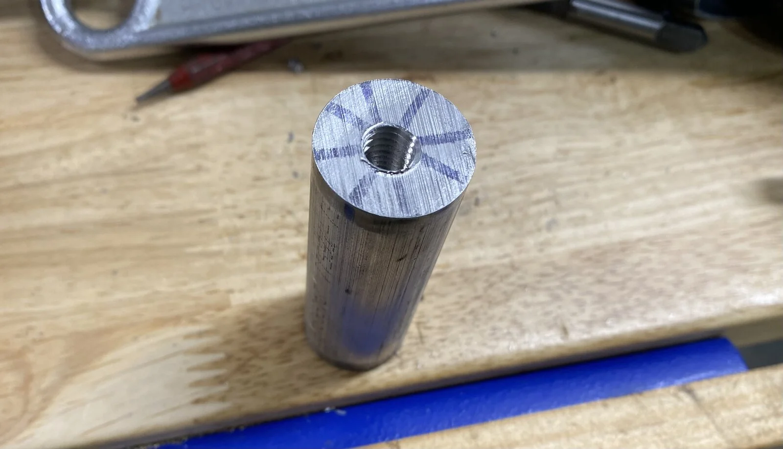

Time for some fab work. Needed to fix the caster legs to actually hold a caster. So picked up some one inch aluminum stock and went to work.
Drilled and tapped for caster.
Drove slugs into legs and drill/tapped for a 1/4 inch grade 8 bolt because why not.
And finally put in place. Now to find some more hardware to finish bolting the legs on and cleaning up the hopper underbelly.

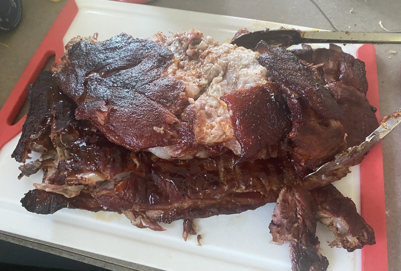

Today was ribs.
Keeping it simple. Same rub and Pellets as the chicken last weekend. First hour on smoke then 275f for a couple hours. Rib trimmings got put into beans that went in when I wrapped the ribs. Got distracted mowing the lawn so went a touch too long and ended up a bit Texas Roadhouse style. Flavor was good though.
Not too bad other than having to improve timing. Might try not wrapping and just do a mop to add moisture.

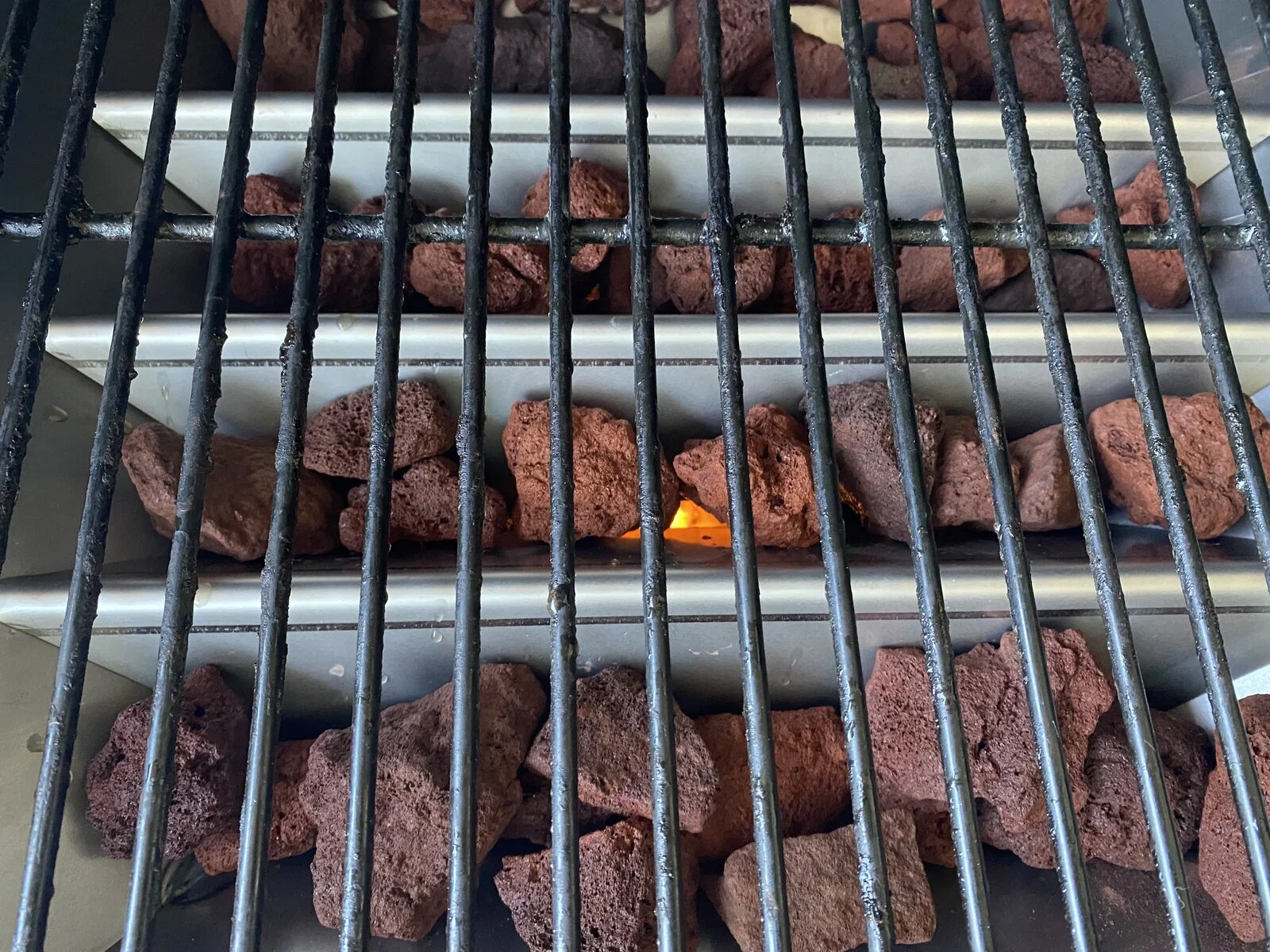

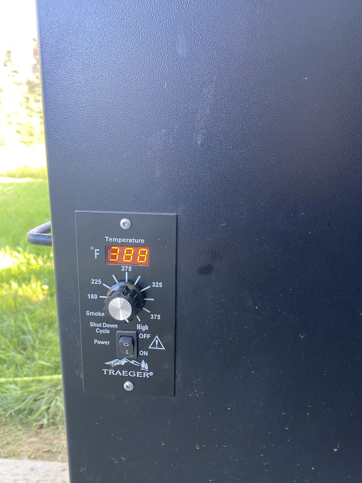

The girls have told me no bbq for a while. So last night was meatloaf. I did notice that the Traeger was having a tough time getting up and holding 375 so I think the auger motor might be wounded.
Reactions: MichaelGH
So I gave it a good twenty minutes and unfortunately my diagnosis is correct.
Reactions: tworley

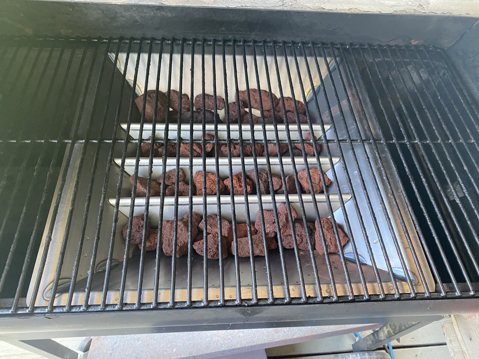

But we have fire so I threw some hot dogs on to get an idea where the hot spots would be. Predictively it is right in the middle so on goes some chicken breasts.
This worked out just fine since you really do not need full fire to cook chicken. Give them a flip ever so often and we got dinner.
I think that once I fix the auger motor this will fun to play with and might just allow me to retire the gas grill. Only thing I can see is that overly fatty burgers might not be the best as they will make a pretty big mess.
