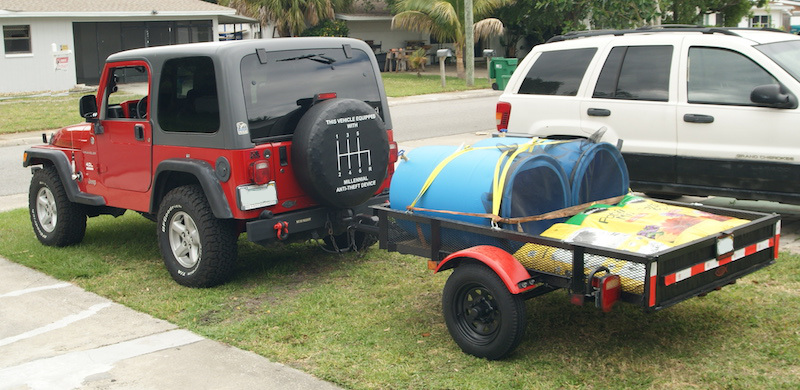

This picture shows how NOT to load a trailer. I had picked up the lightweight rain barrels at one location, then stopped off at Homeless Despot on the way home and put 5 large bags of potting soil behind the axle. I actually had negative tongue weight (Pintle/Lunette). I let it go as I was right at 1 mile from home via 25 MPH back streets.

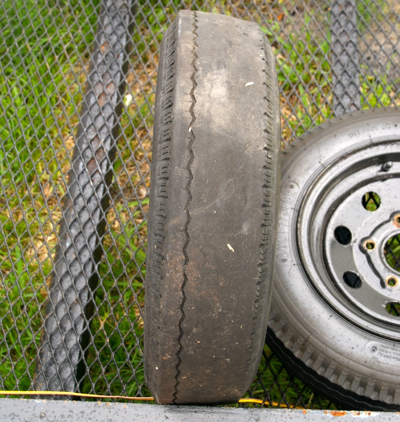

Because THIS is what happens:
Trailer axles have purposeful bends in the middle of them. Flipping it reverses the bend, with the results you see here. This particular tire/wheel came off a trailer that had had an axle flip - I got it because I wanted the wheel. The tire was disposed of...
