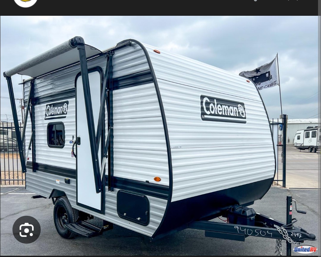

Coleman 13b
What are you looking to accomplish with an extended tongue? Sweet spot for handling is generally matching vehicle wheelbase to trailer wheelbase (hitch pivot to axle). I was able to accomplish both on my camper build, but the JLU has a longer wheelbase.
That said, it's not going to do anything to make the trailer lighter.
It removes trailer sway and fishtailing. Also aids in backing but Im proficient there. Im just feeling around but I know no way in hell can l pull said trailer any distance comfortably but l can get $uch a damn good deal on the trailer that im just touching on every possibility and even considering reinforcing trailer frame to add reciver hitch to rear of trailer and flat towing jeep behind it and pulling doubles with dodge 😂 or pulling jeep then trailer 🤔 yeah, that sounds more better....or, getting a big assed trailer? Or....can finally go coilovers and stretch 🤓 So basically it aint gonna happen but gotta exhaust every possibility as pumped fulla coffee and heading out the door to vegas to look at these little trailers. But damn im missing my diesel pusher right now...kinda
Looks like that's the dry weight of the trailer, 3,500 lb GVW.

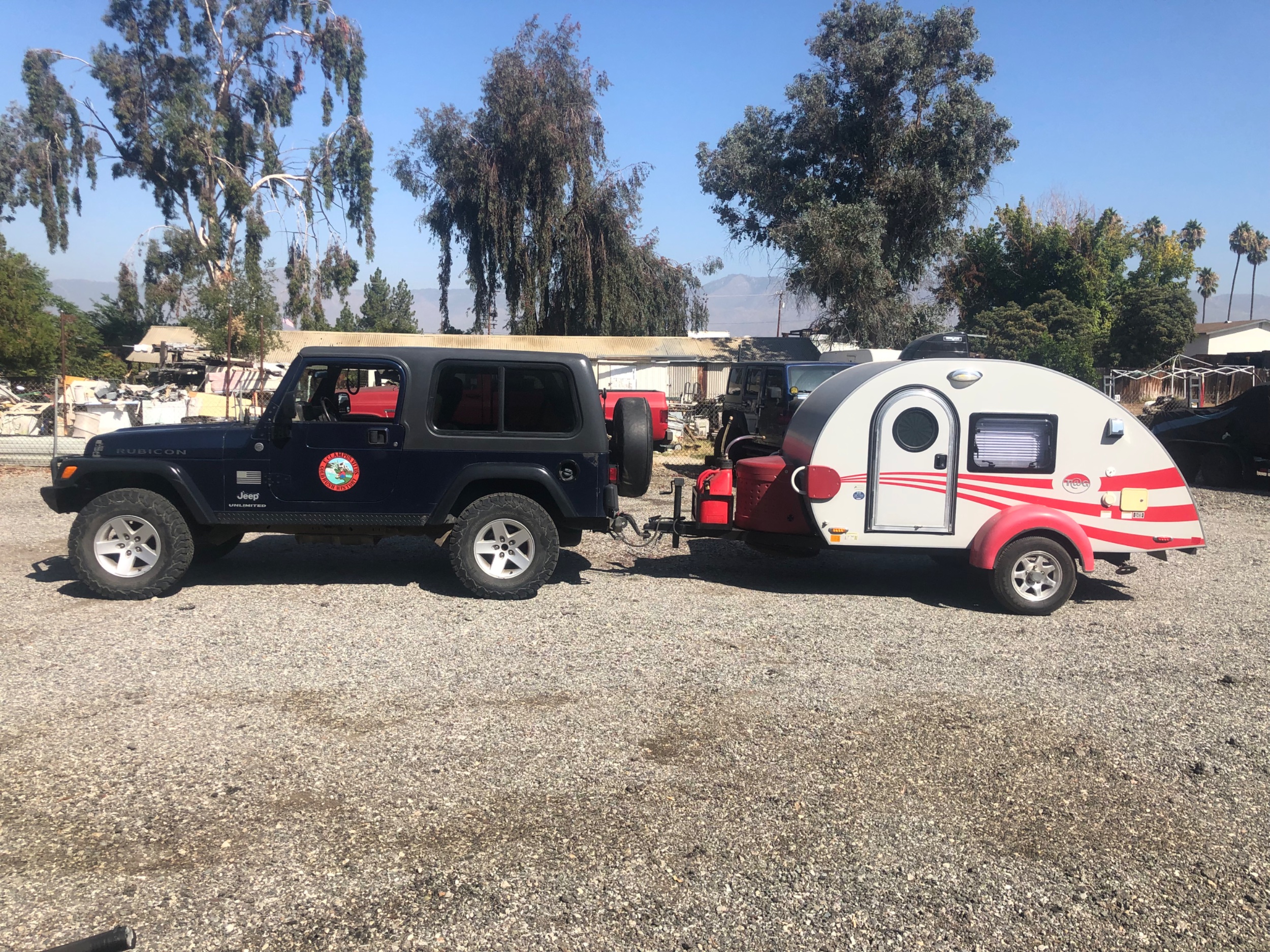

1200# trailer with 300# gear in Tj. 05 TJRU 6sp 2.5 OME lift and 32s. Pulls and handles great. Up and down 6% grades with no issues. Heading to the Colorado River this afternoon for 5 days.

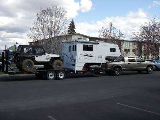

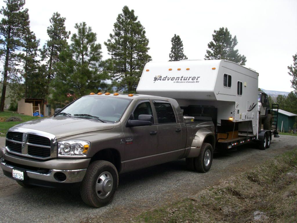

I will tell you a 3/4 ton would pull my RNTH but I felt a lot better once I got a 1 ton dually.
I hauled it like this to Moab with my 3/4 ton and when I got home I bought a new 1 ton.
1 ton dually towed a lot nicer.
