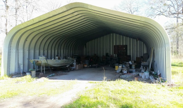

Future garage 45'x30' on 10 acres we are in the process of buying. My Jeep will love it!
For the land and house and garage we are paying 118000. It was 160000 last Summer but the little old lady living here needs to sell it. The house is a POS cosmetically but structurally sound and we are gutting it and rebuilding the inside. Not sure yet on the property tax.
We have some livestock were going to put on it for an exemption. She is leaving the boat in the pic with a few other things my wife wanted.The Colorado river is 1/2 mile away. I know this is way more info than you need but hey, that's me;)
No, that's cool, and that's a great price. We are buying a house / land as we speak which is why I was asking.
That will be really awesome having that much land. Maybe you can have your own off-road park on it!
