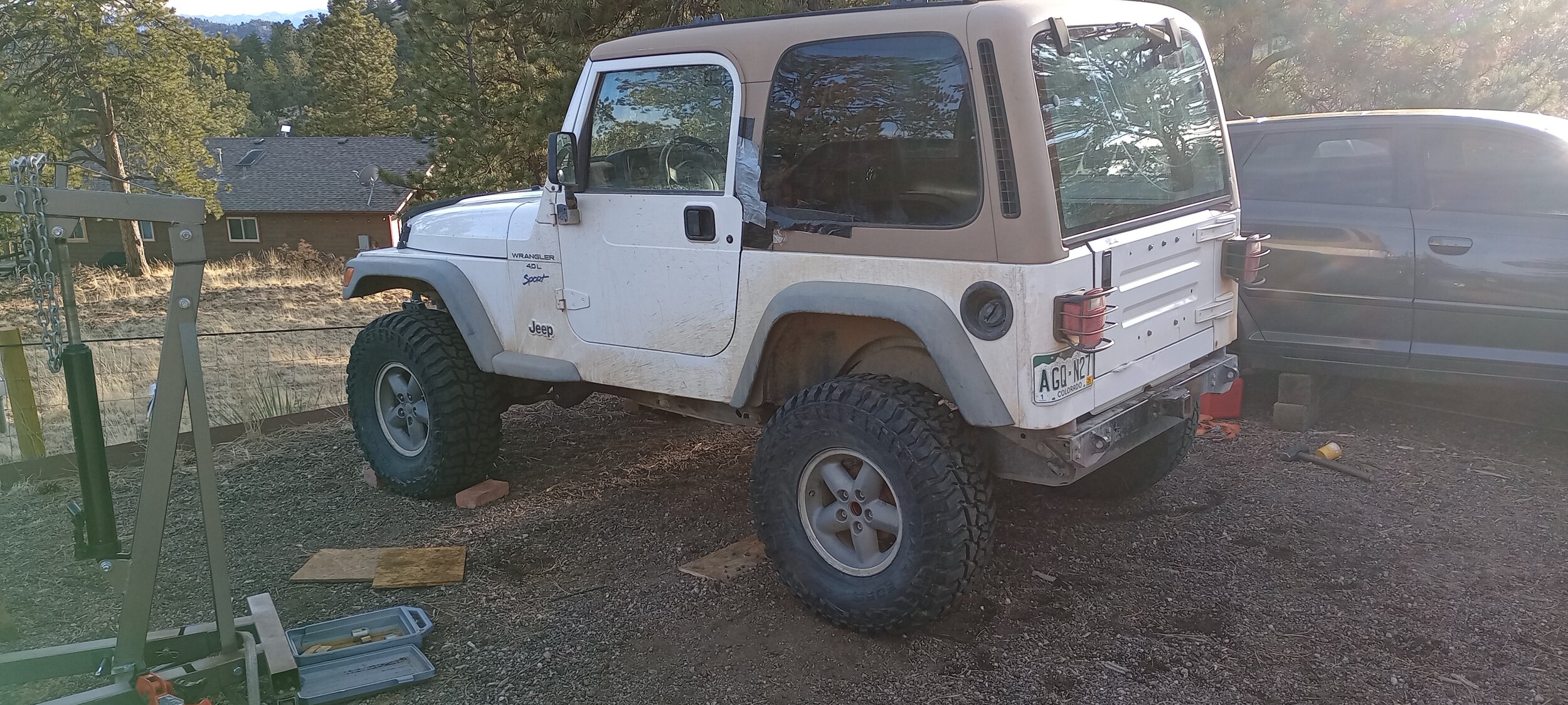

Woohoo finally drove it again!
It definitely feels like it has some serious torque compared to before. It is interesting driving 45 in 4th gear... That definitely used to be a 3rd gear speed. Also, my speedo reads 60 at 45 so necessity of the speedo healer went way up. No bad noises though!!
It drives like ass though (always does I guess) I might see if I accidentally adjusted the arms to uneven lengths side to side, I kinda just adjusted them til the bolt went in easy.

Yours is a 97 right? If it is then you need a new speedometer gear...
https://wranglertjforum.com/threads/need-tooth-count-for-speedo-gear.38888/
https://www.quadratec.com/c/reference/jeep-speedometer-gear-tooth-chart
33" tires & 5.13 gears is a 43 tooth gear.
https://www.quadratec.com/p/ppr-industries/speedometer-gear-short-shaft/43-tooth-short

Find a good shop who deals with lifted vehicles (understands adjustable arms, etc.) and get an alignment there. My local Jeep dealer sells upgraded Jeeps so I went there. But any good shop that modifies trucks/Jeeps should do — I wouldn't trust any alignment shop who is just used to OEM stuff.
I tried like hell to get my Jeep aligned in my garage with tape/laser/etc — It was a terror to drive. Took it to the above dealership and it was a freaking go-kart after they worked it! Stuck to the road.
Haha. no. Nobody works on this but me.... well, I guess and the windshield guy. I'll figure it out! I don't think it is the steering I think it's something else. Just idk guessing by the way it feels, it doesn't feel like when I needed to reset toe in the past.
