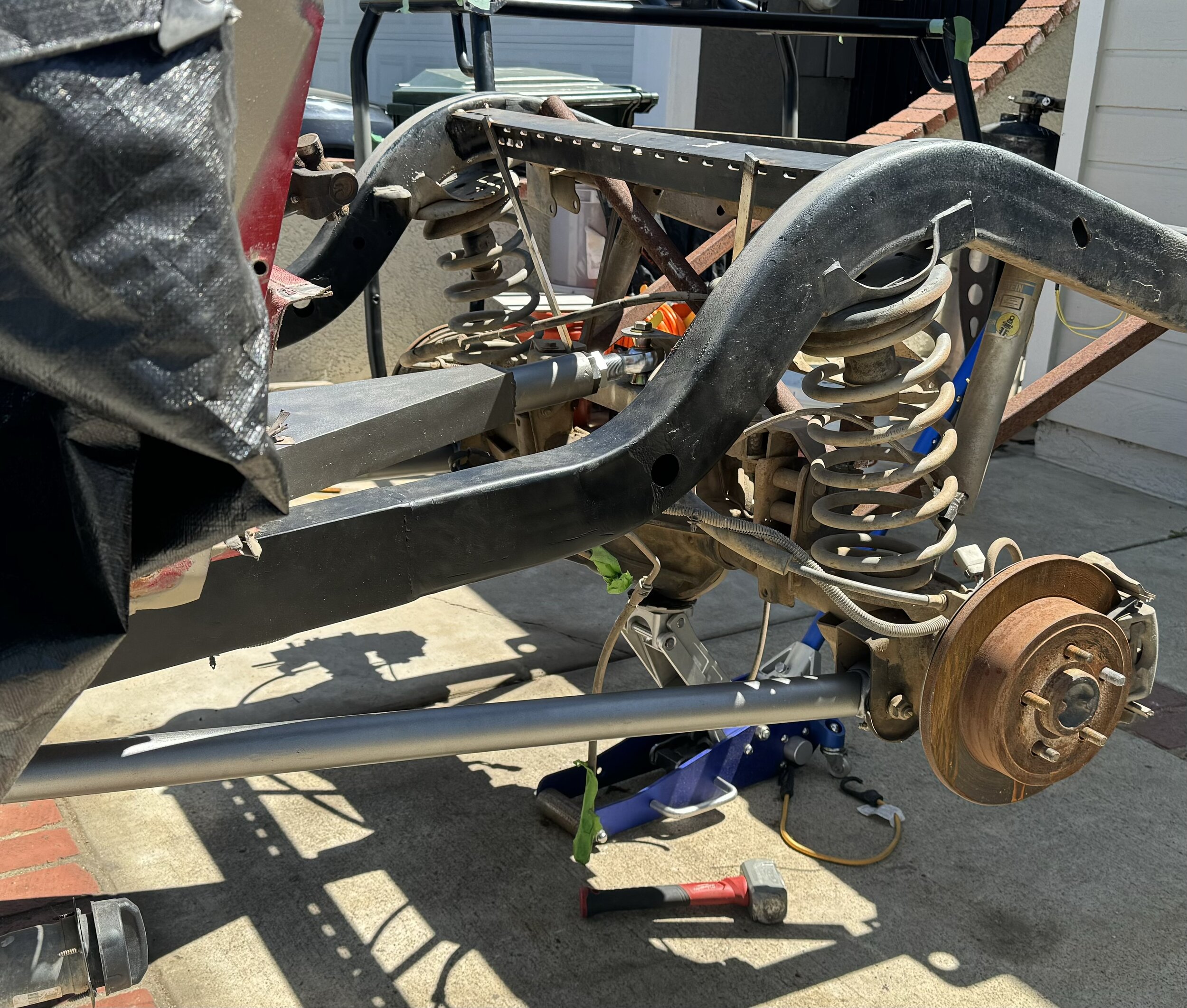

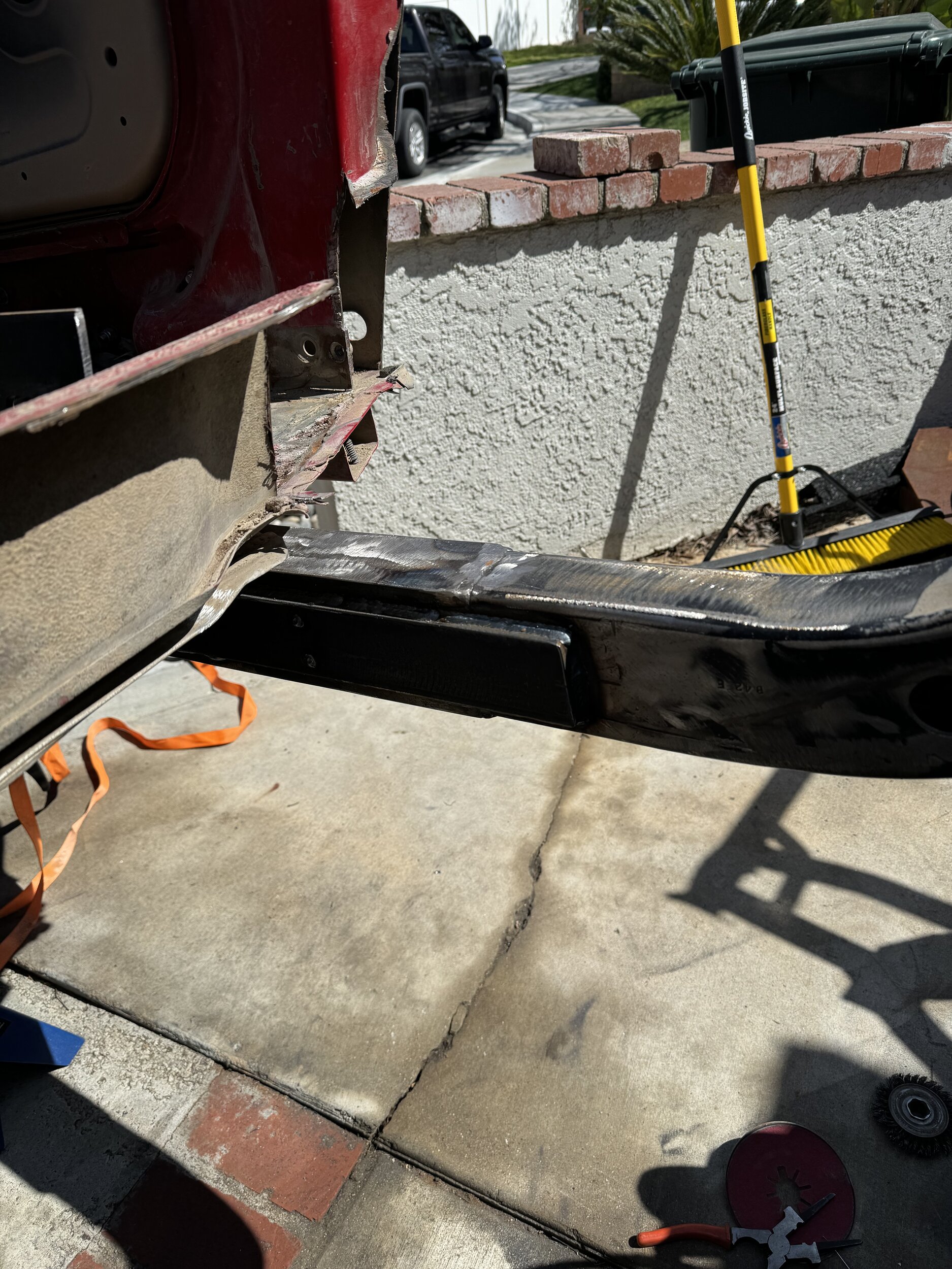

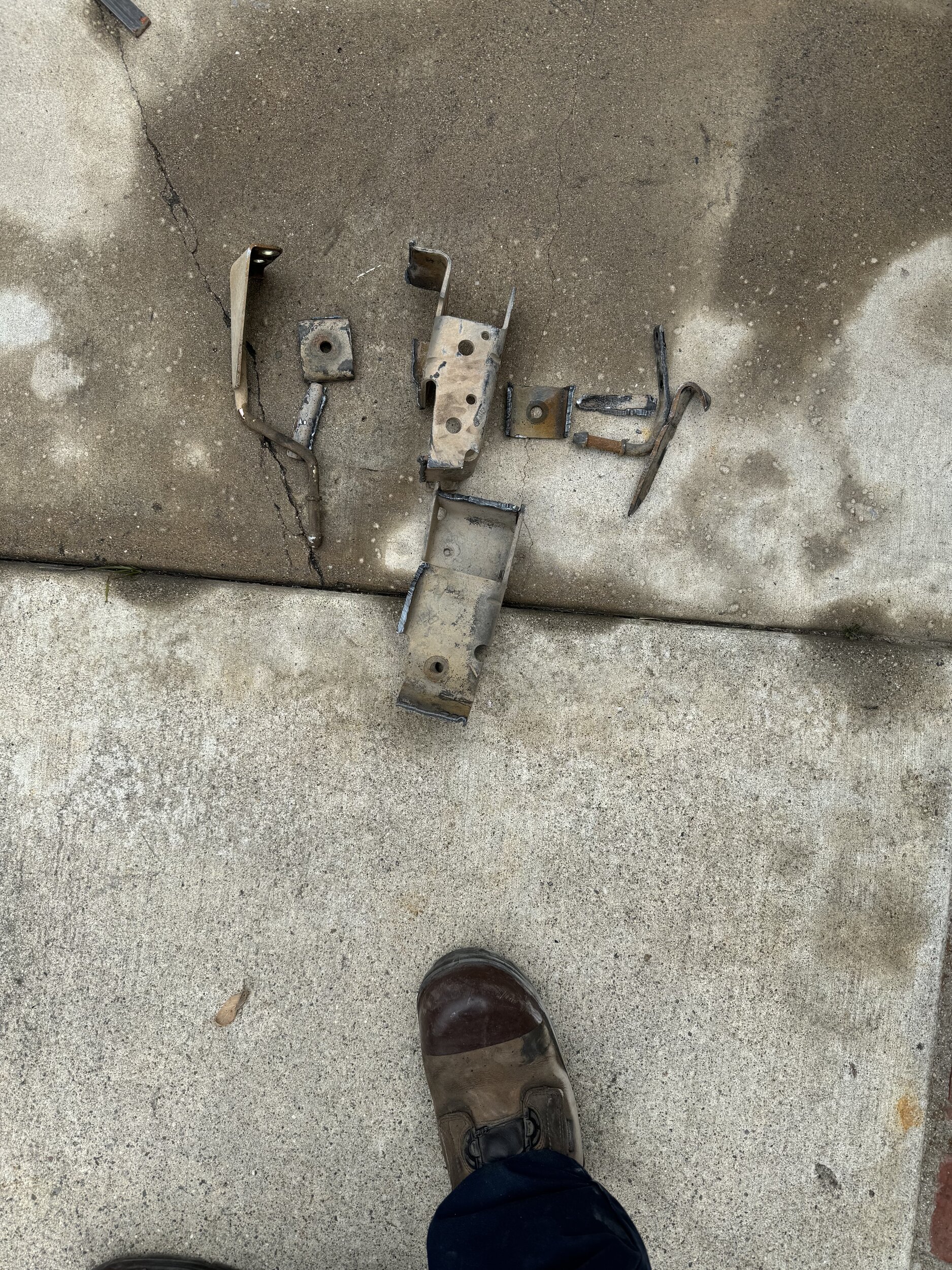

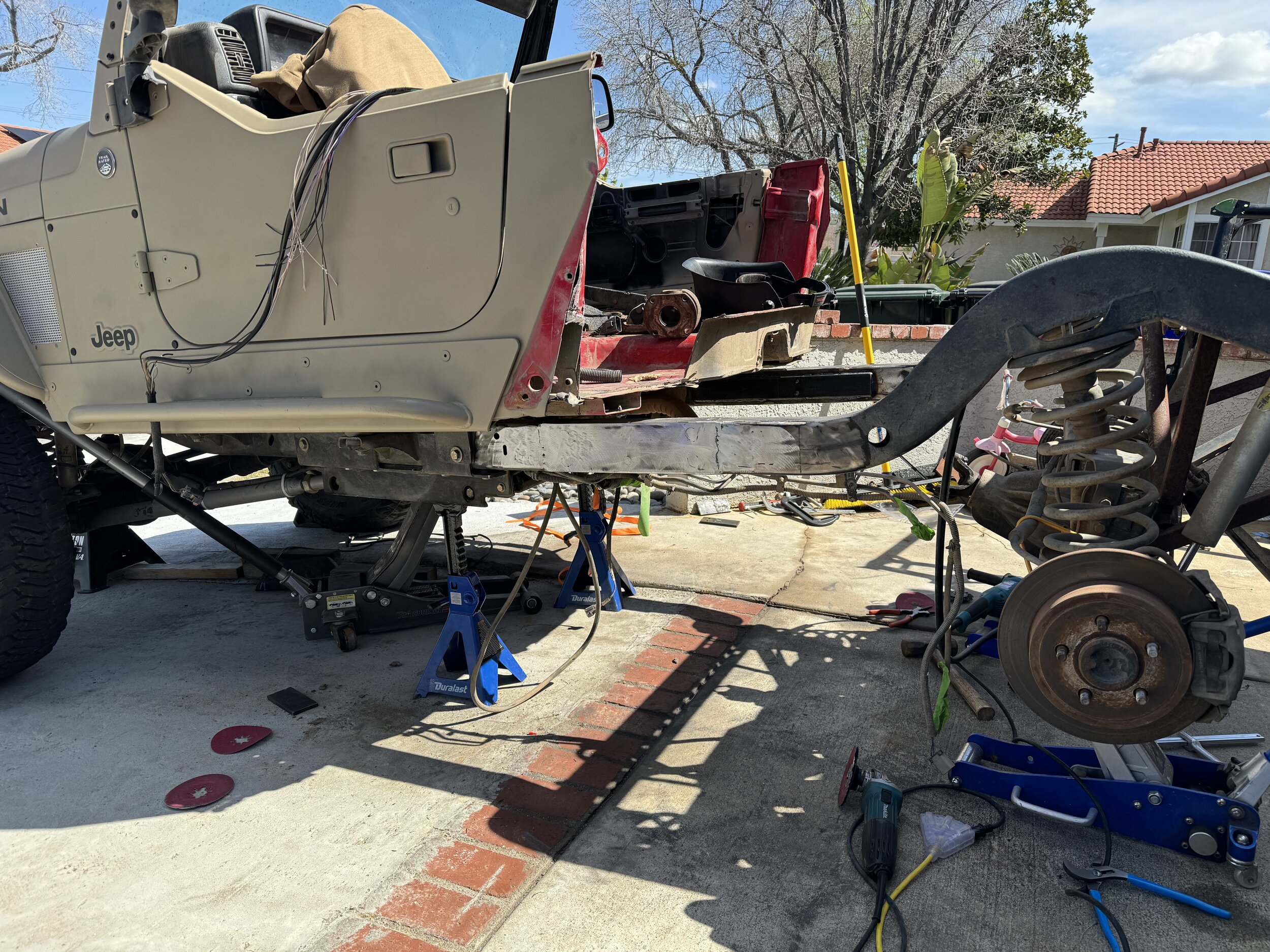

I got to cut off some old not used suspension brackets and exhaust hangers.

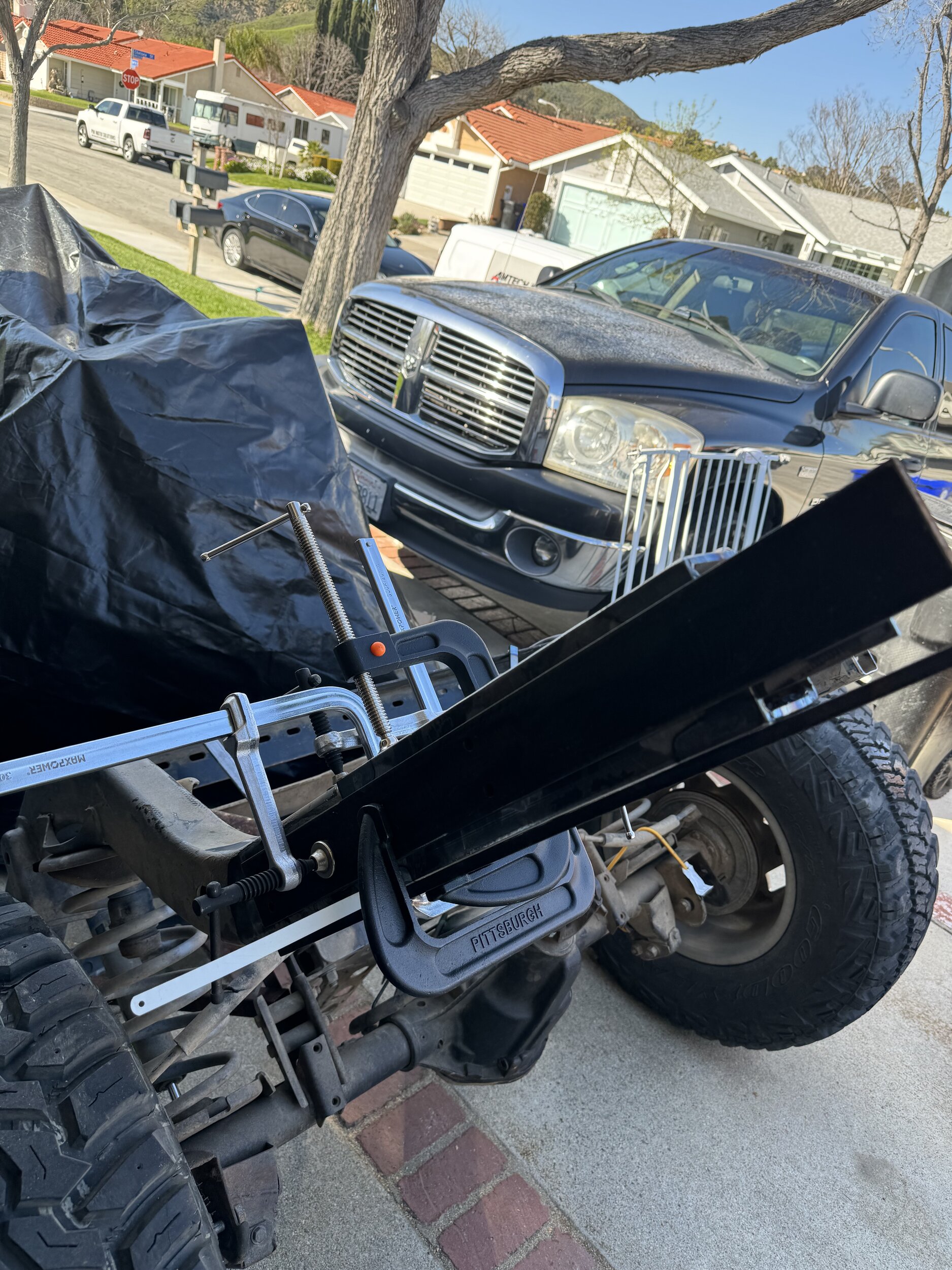

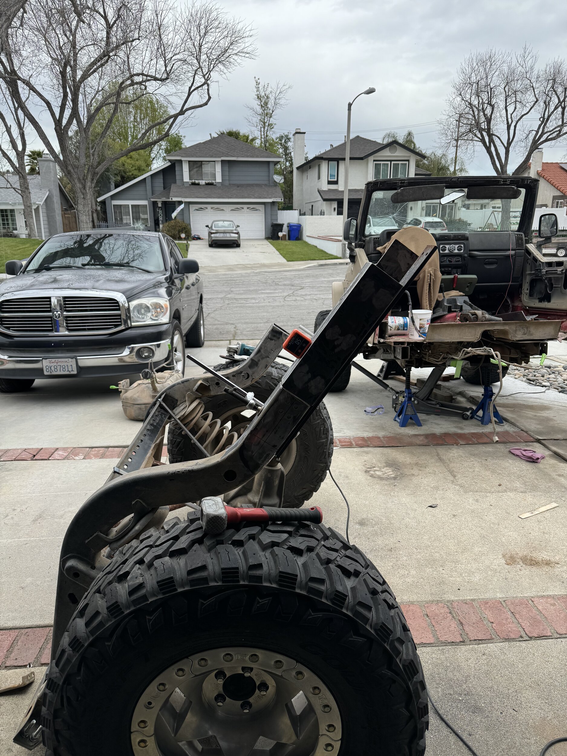

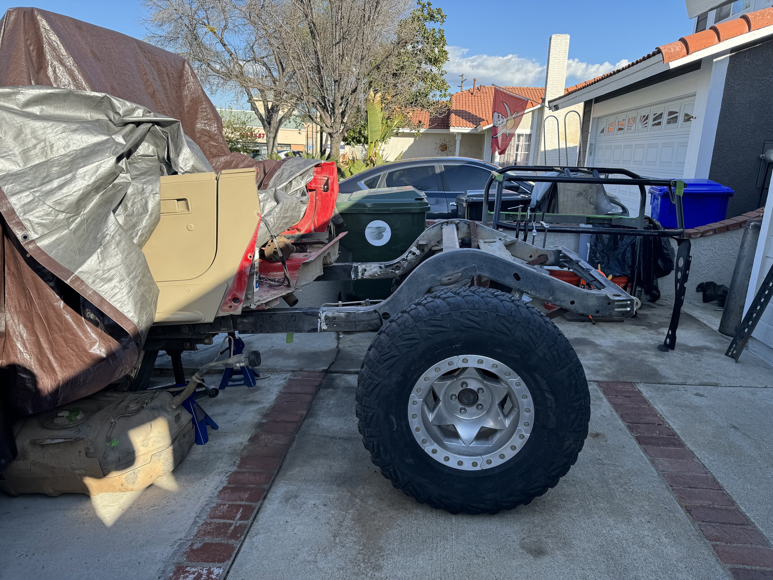

Kinda coming along,suspension is done. I took the springs out cycled it and everything is good. I have to adjust pinion angle down and measure for drive shaft, I extended the 3/16” brake line, built the AN fuel line and vent , just waiting on a part from Amazon,the quick connect fitting on the fuel pump side is 3/8” and on the side where the fuel line comes off the frame is 5/16”. Thought they where both 3/8”.
