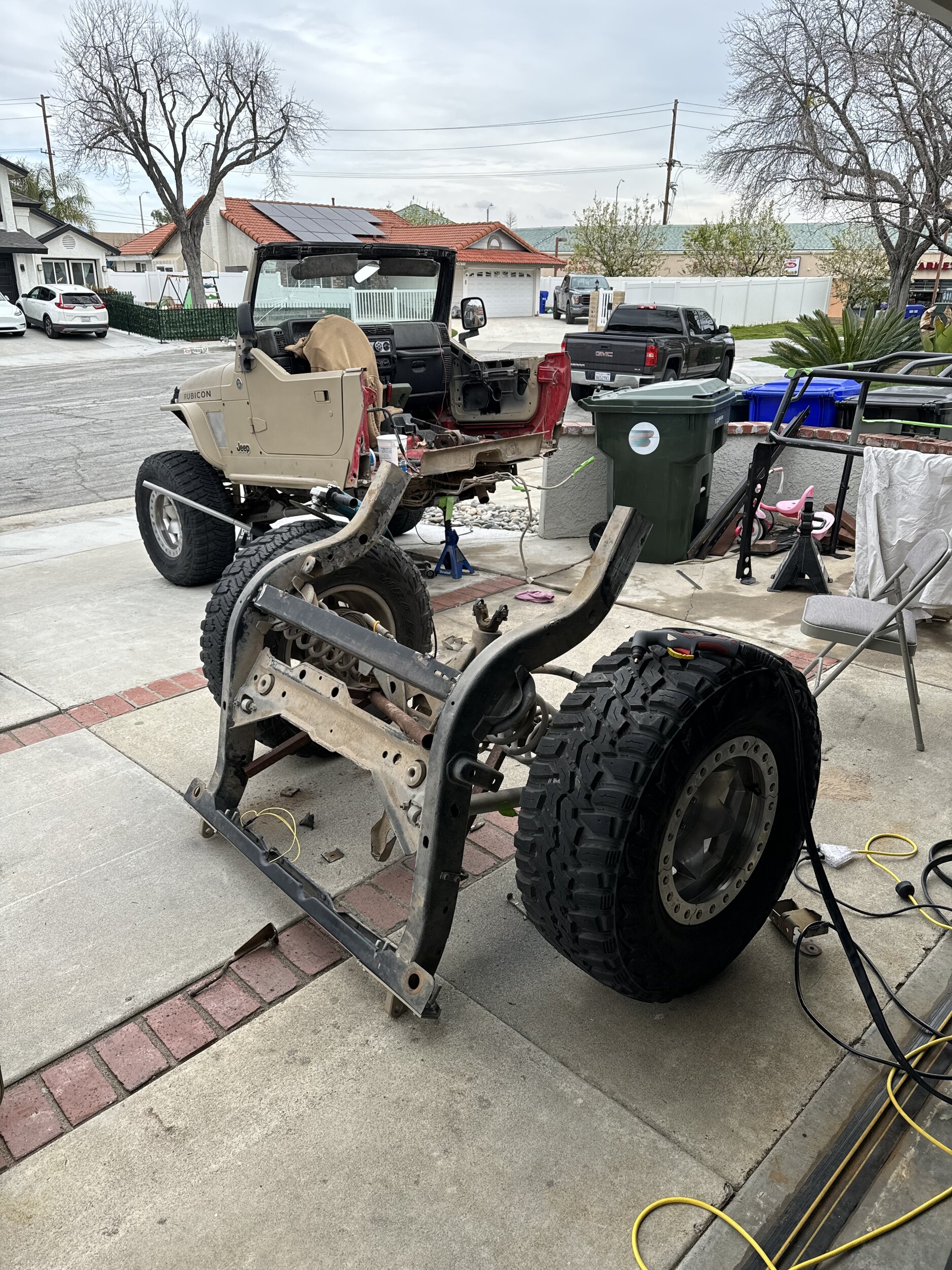

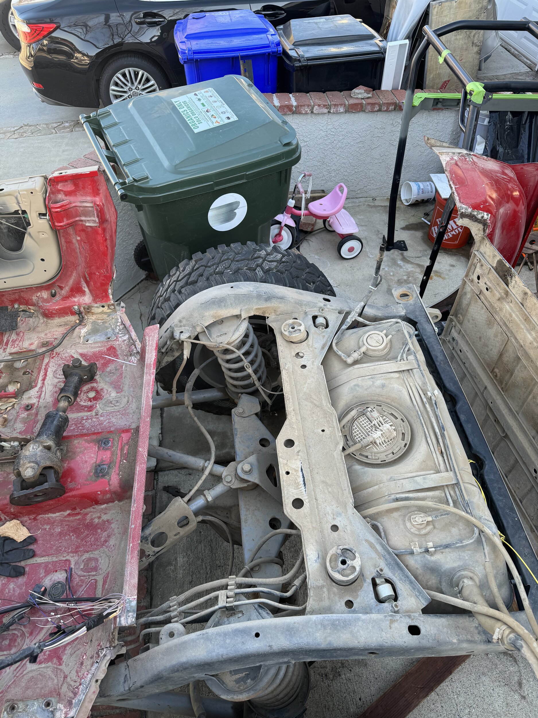

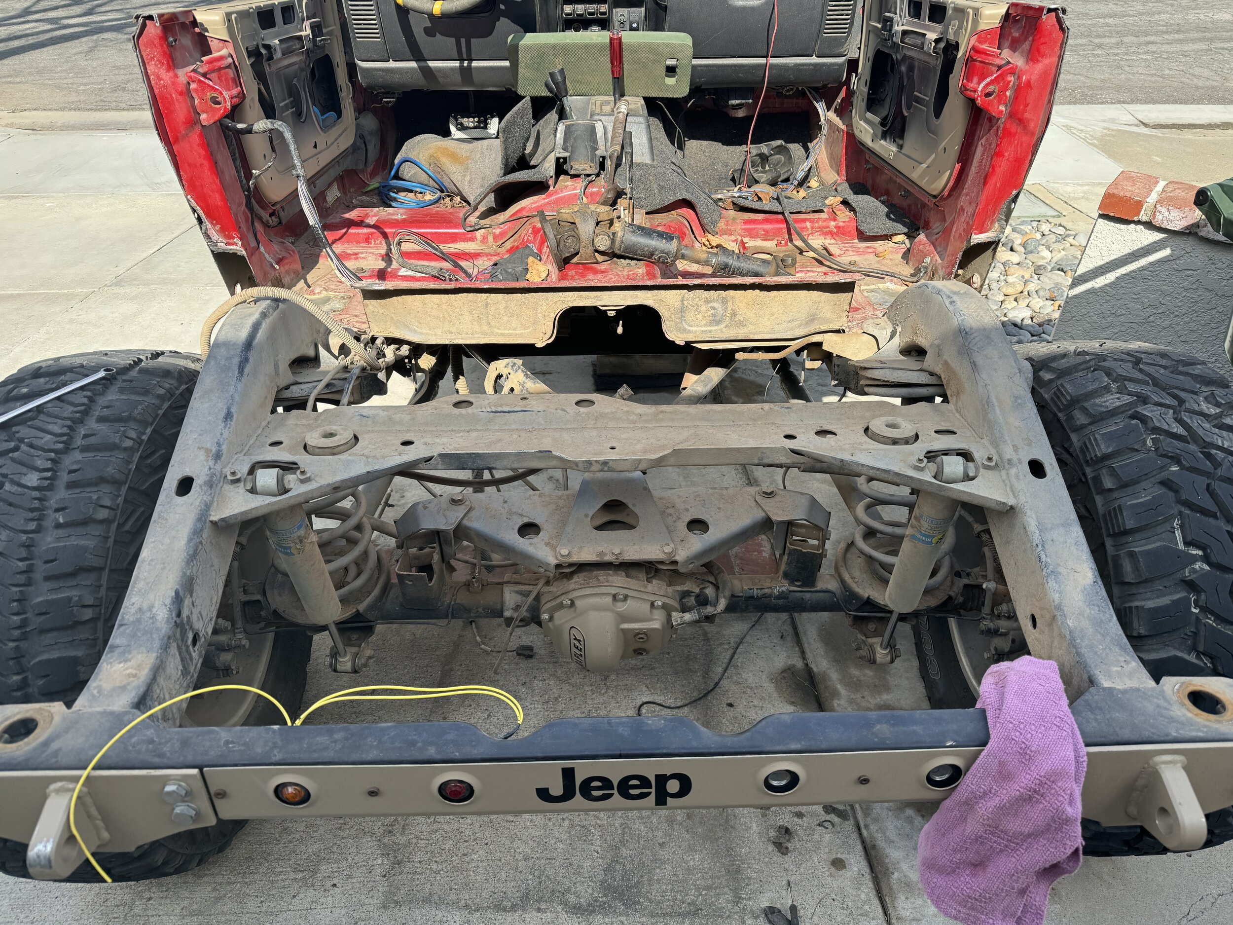

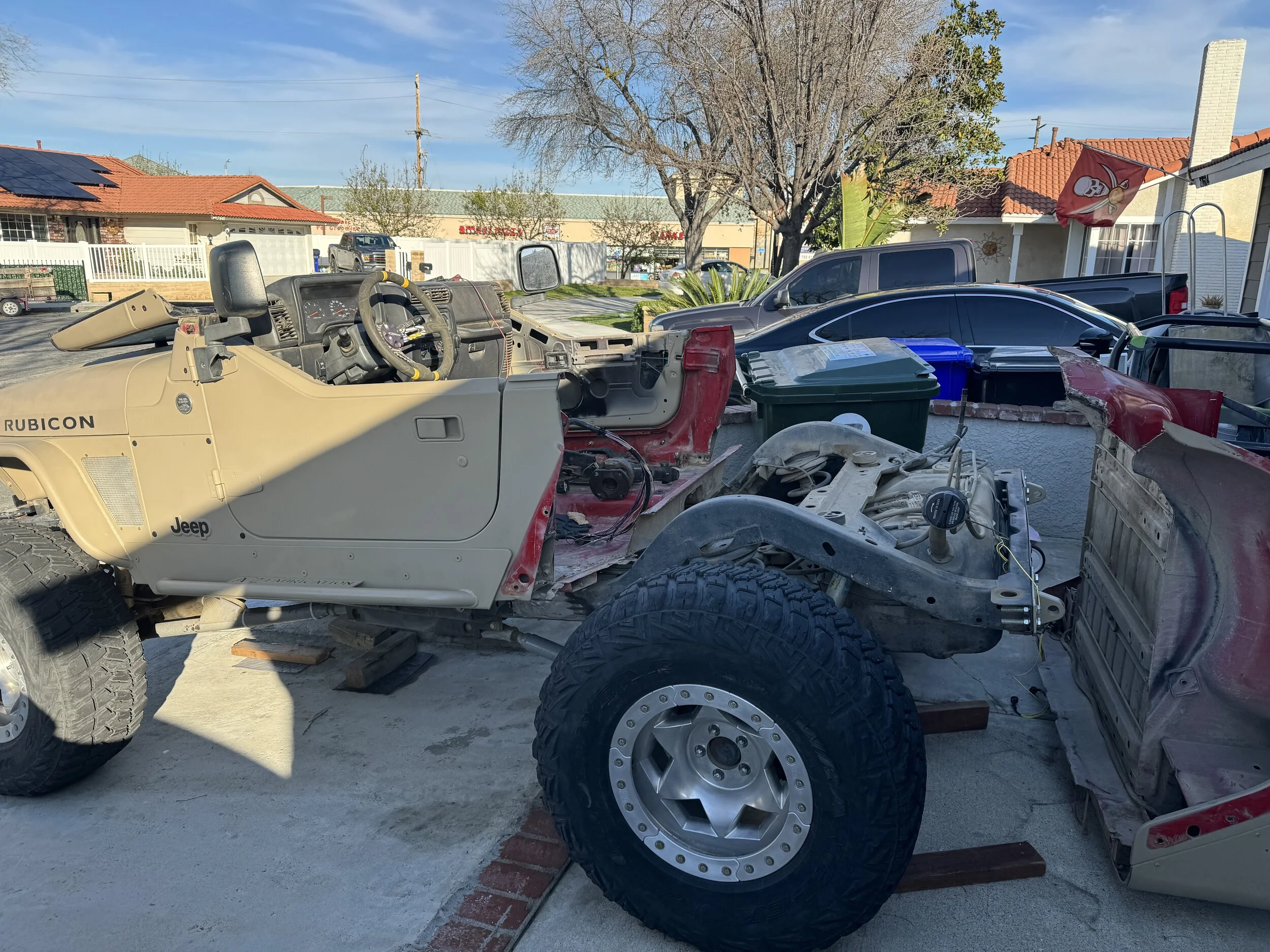

Got the tub off today
This build process is looking very familiar haha. Prepare yourself for a lot of sheet metal work. I'm the son that works for TKE, also local 18. I'm guessing you know Mike Montana, he lives in castaic also.

Don’t know the guy, castaic is small and I constantly see elevator vans and trucks and don’t know any body lol, I worked for thyssenkrupp Elevator out of LA back in the day in repair as a helper.
I’ve never used bondo before so I think I’m just going to do some aluminum corners over the visible panel.

How did you and your dad get the upper rail with its multiple layers welded smooth inside so the soft top doesn't snag? Separate the spot welds to access?
Not at all. I cut the rail I received from donor tubs and just welded them in. You can weld the top easily enough then weld the bottom from outside then inside the tub. Drilling the spot welds would work just on the donor pieces. That might be the best way to go. They are only 15" long.

I guess I'm concerned about getting wire and lumps in this area under the lip. But it wouldn't be hard to flatten a piece of copper pipe and contour it to make a welding backer i guess?

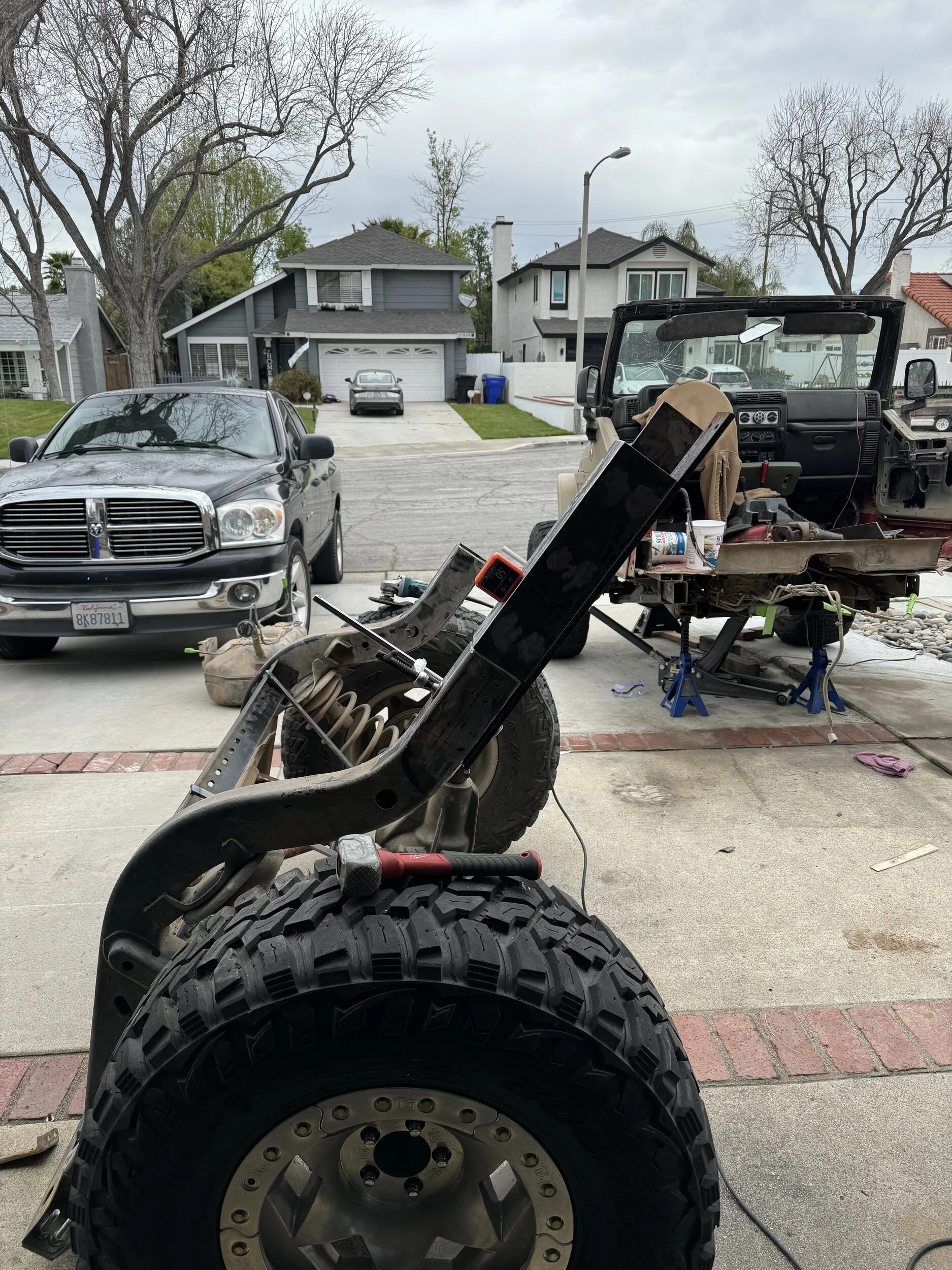

There’s about 1/2” of dry mud in the frame 😀 had to stop today cause it started to rain. Wish I had room in the garage or a flat drive way lol
Shouldn’t be hard, I’ll make sure to post pics how I do it. Probably just butt weld the ends and plug weld the top, grind/smooth it out.
