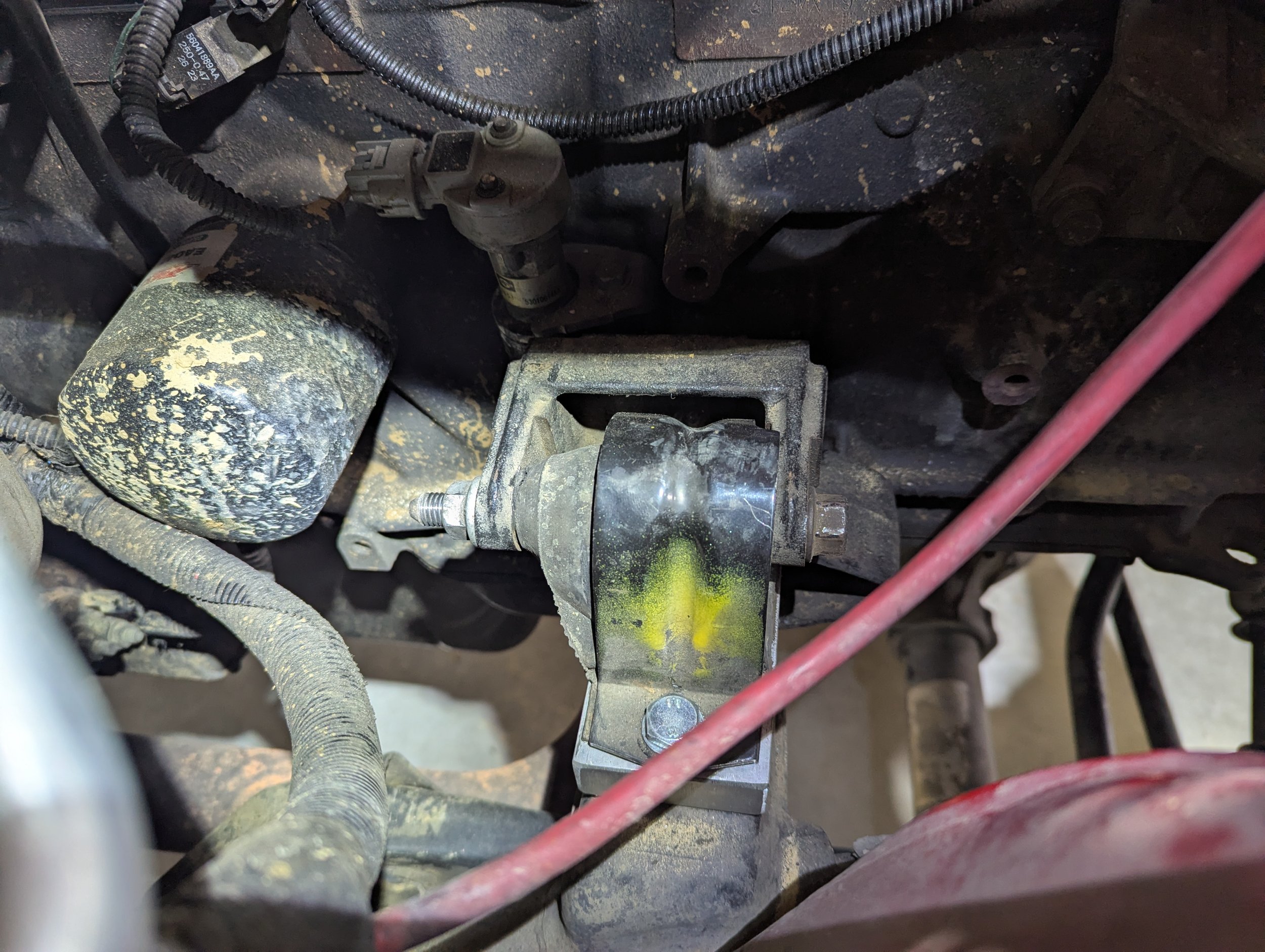

So today was quite eventful. I figured out what mrblaine was talking about with the motor mounts getting off a bit. Took a while but that rocks. Mounts went in super easy as expected except I'm a dumbass again and though the body lift replaced the mounts so I didn't buy new body mounts. That will be a future project as they were dorm but not shot. The Savvy cable really disappointed in the quality of the end joints. One of mine pulled itself right off pictures below. Cable and brackets were perfect and bad assed. The one that popped off had poor threads that pulled right out. I replaced with a himes joint in had in the tool box for the last 20 years lol. I might replace the other one soon I just don't trust it anymore. Motor mount looks stressed if y'all would look at the pics and let me know your opinions I'd appreciate it.

The mount looks that way because the transmission is still lowered.

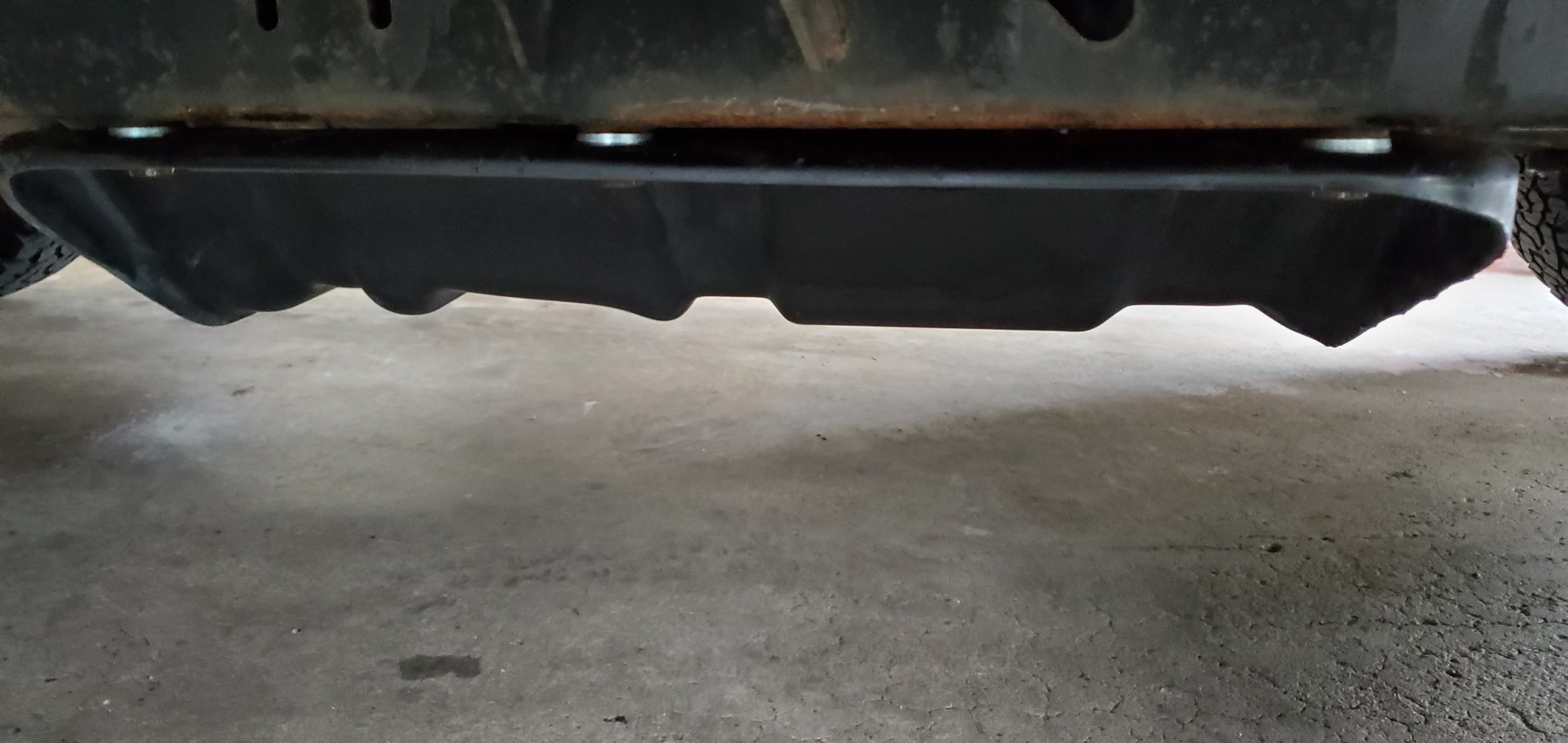

So a dumb question for anyone reading this. There are some spacers on the transfer case skid plate that are about an inch long. Is that normal or is that what someone before me put on to space the transfer case down? Also to be sure I get everything a tummy tuck is primarily a new skid plate and a longer drive shaft right? I am looking at it since my shifter is so close to not shifting. I nipped out a little of the plastic and put a little bend in the shifter for now. The Savvy one is 1150 dollars are there more affordable options that work well?
Someone put those spacers there. Likely because they lifted the Rubicon around 2.5-3" and had a rear driveshaft vibration or other driveshaft issue and $40 for a spacer is less than $430 for a DC driveshaft. Should look like this minus the thick silver washers - which you might consider as they maintain an air gap between the skid and frame that prevents rust.
