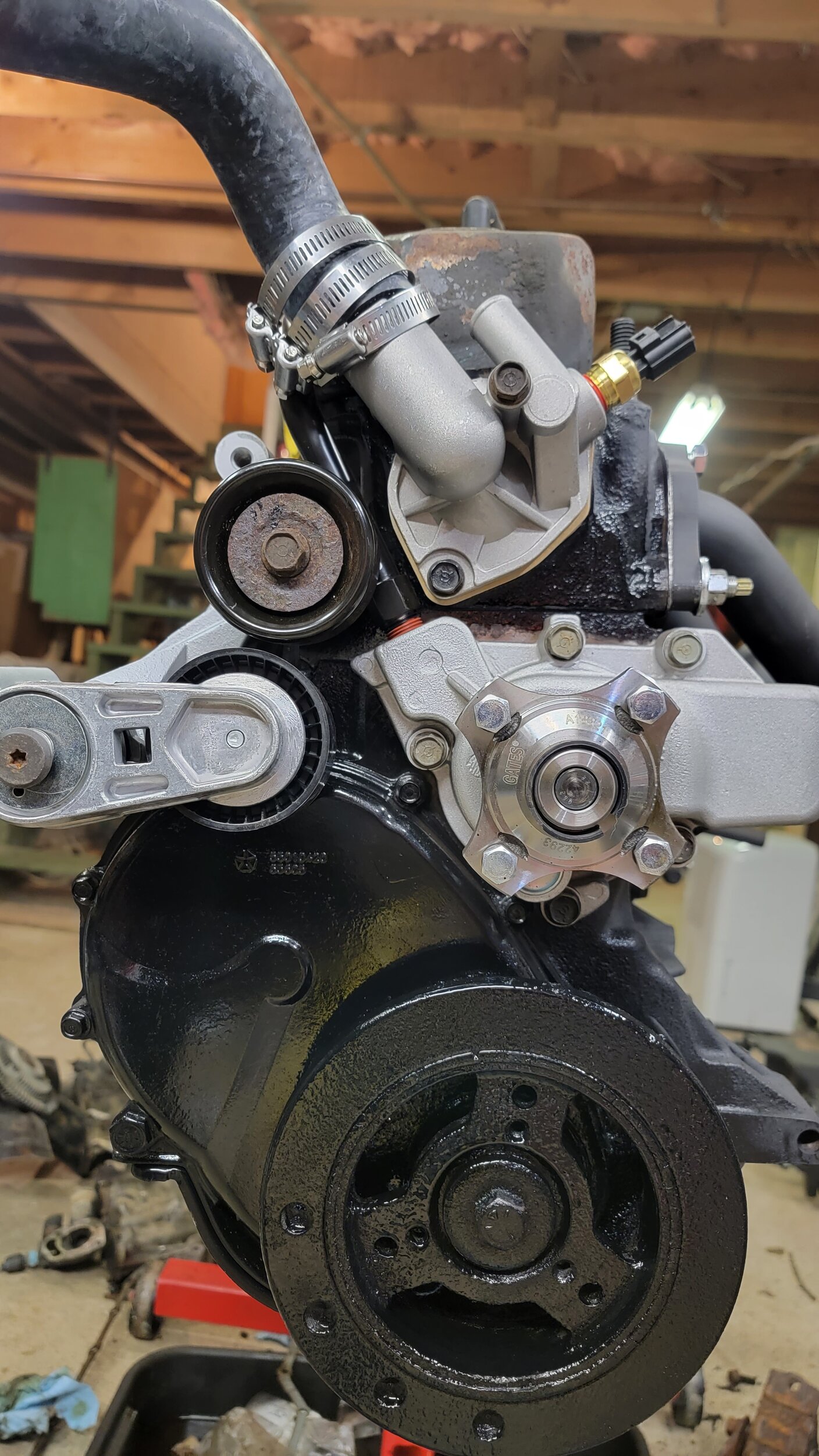

I would say yes…but this engine has a rod knock so I rebuilt another 4.0 and I’m just waiting to put it in.

I picked up the spare 4.0 for 200$ and have another 500 into it with the header and rebuilding it. I wish I just went with an LS from the start but I dont mind the 4.0. Once I swap the motor I have an ax15 I rebuilt at the same time, so itll have a new engine and trans.

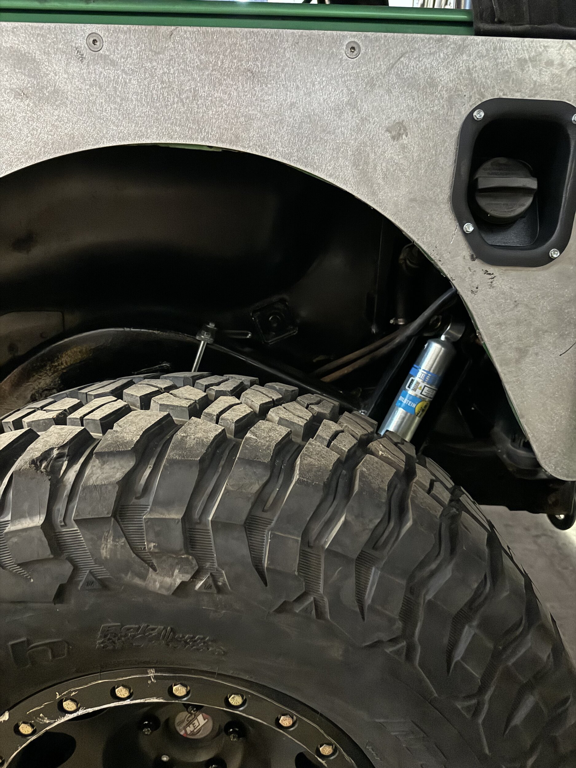

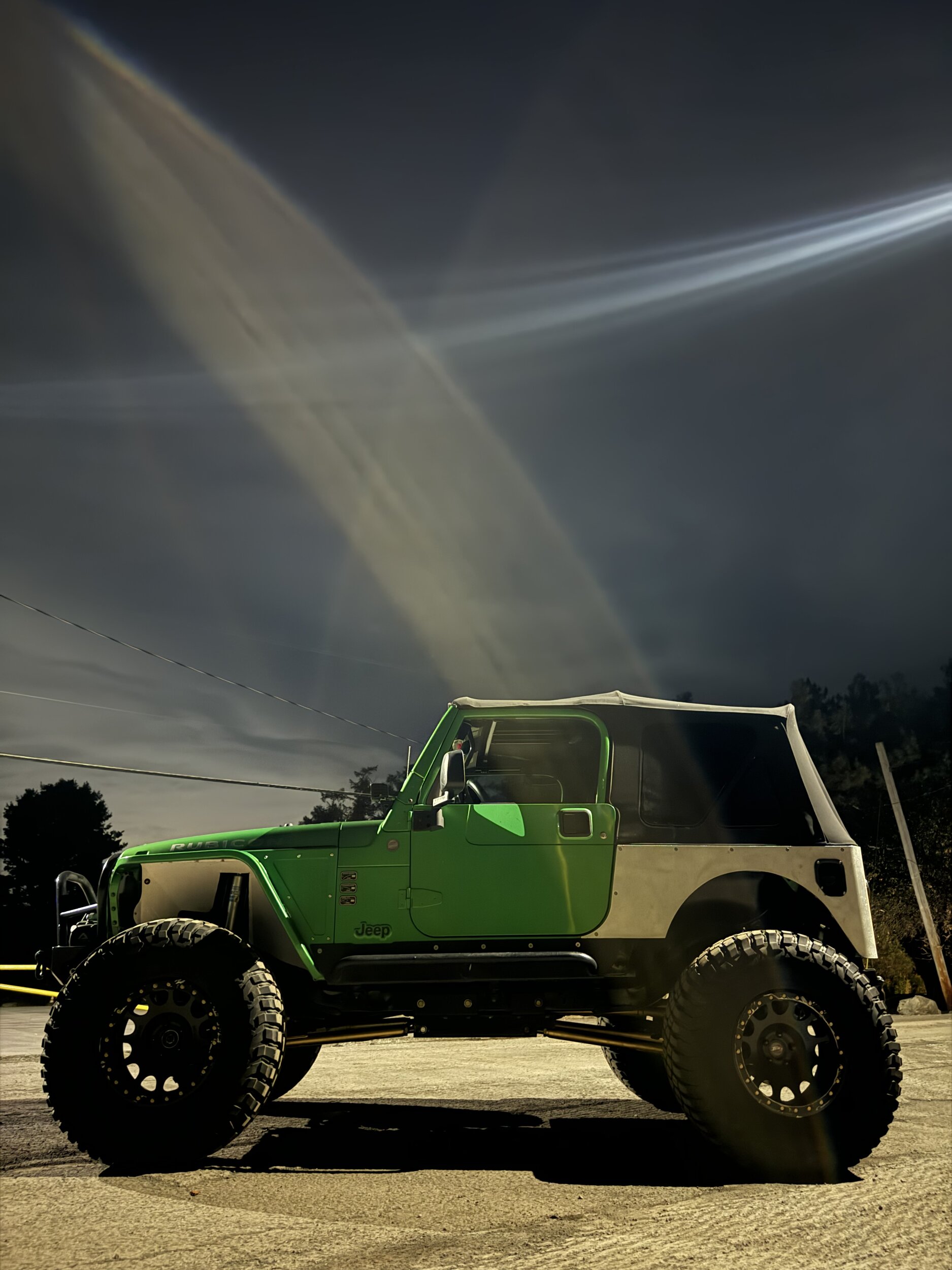

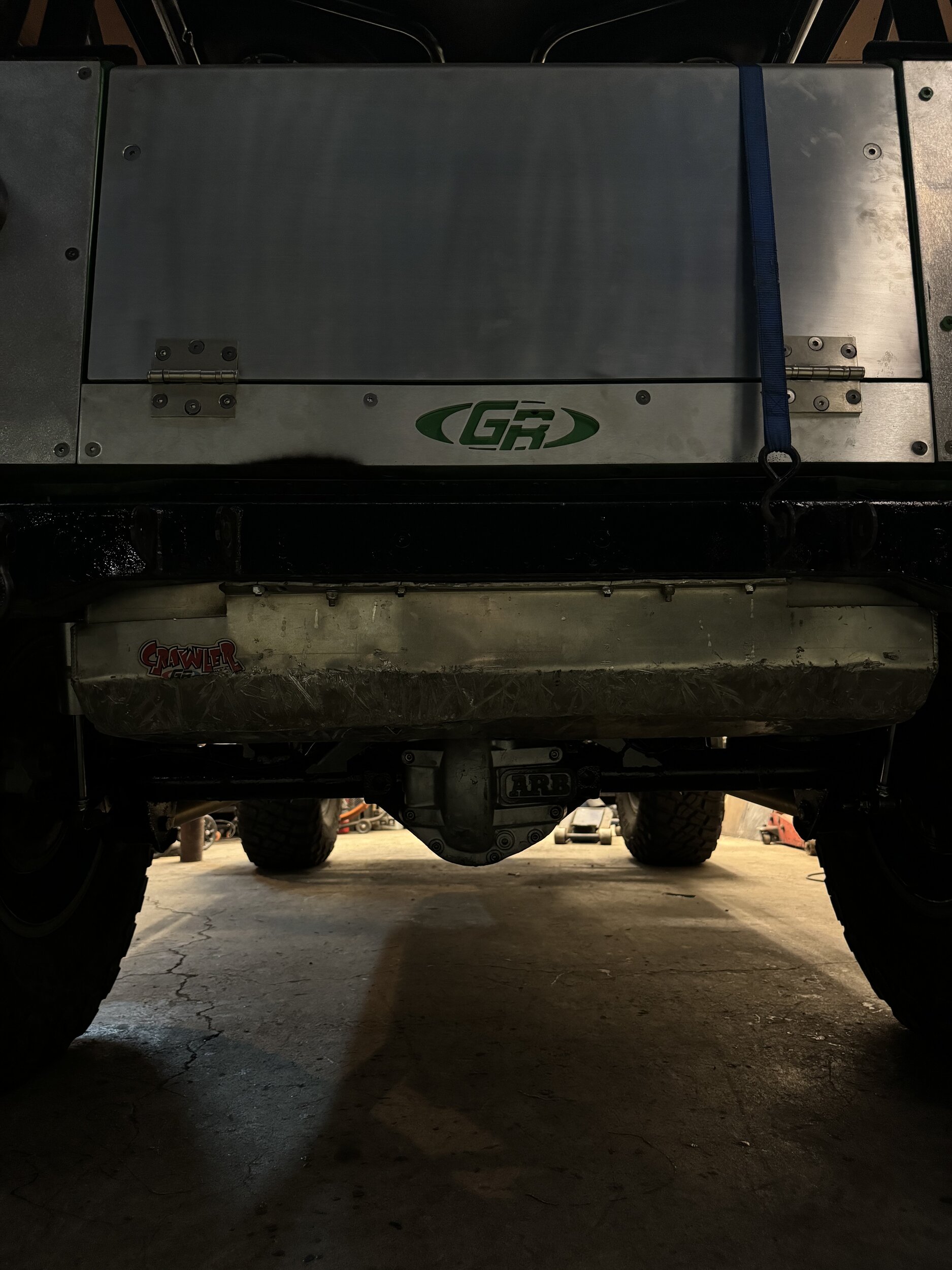

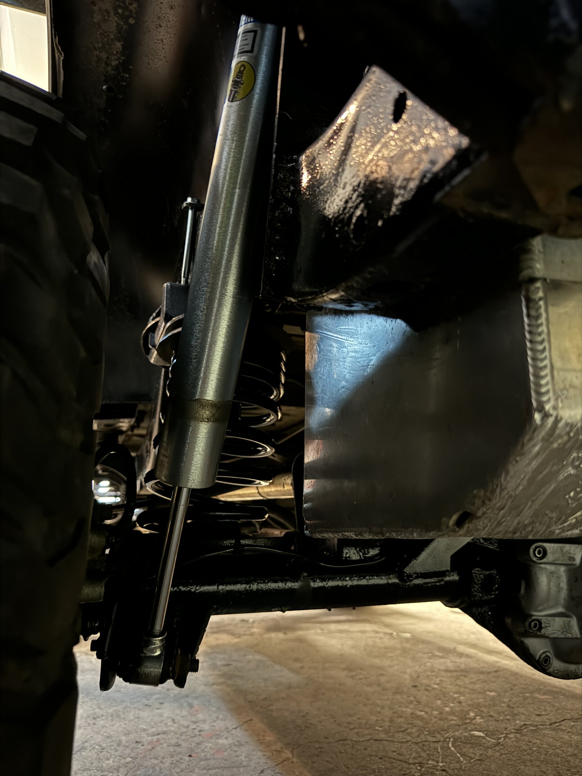

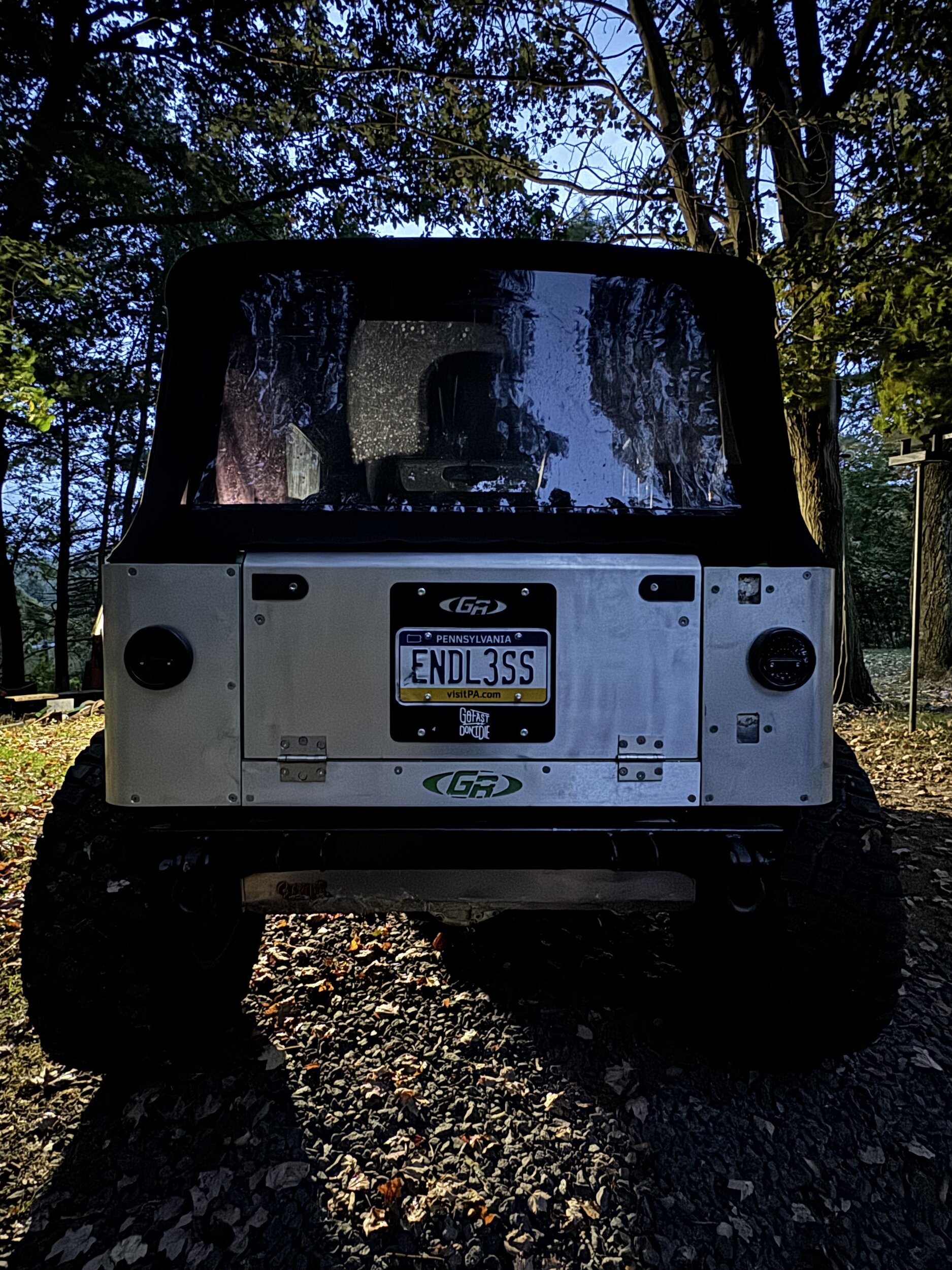

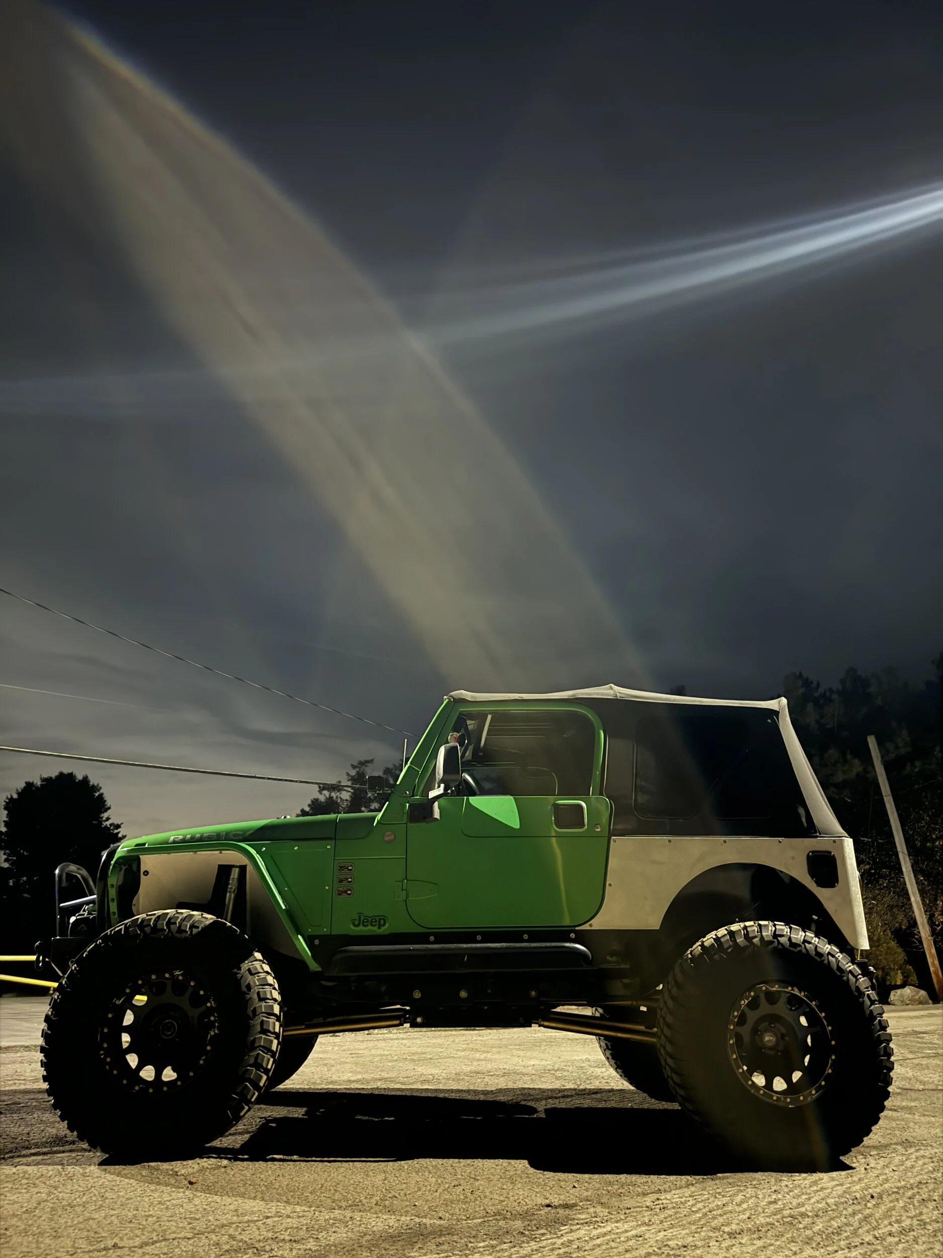

Finished up the stretch this weekend.
Genright stretch corners, Genright aluminum tailgate installed.

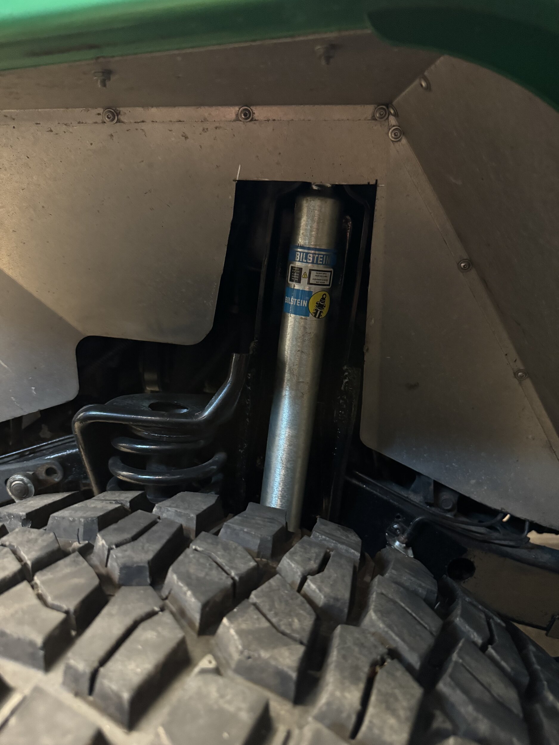

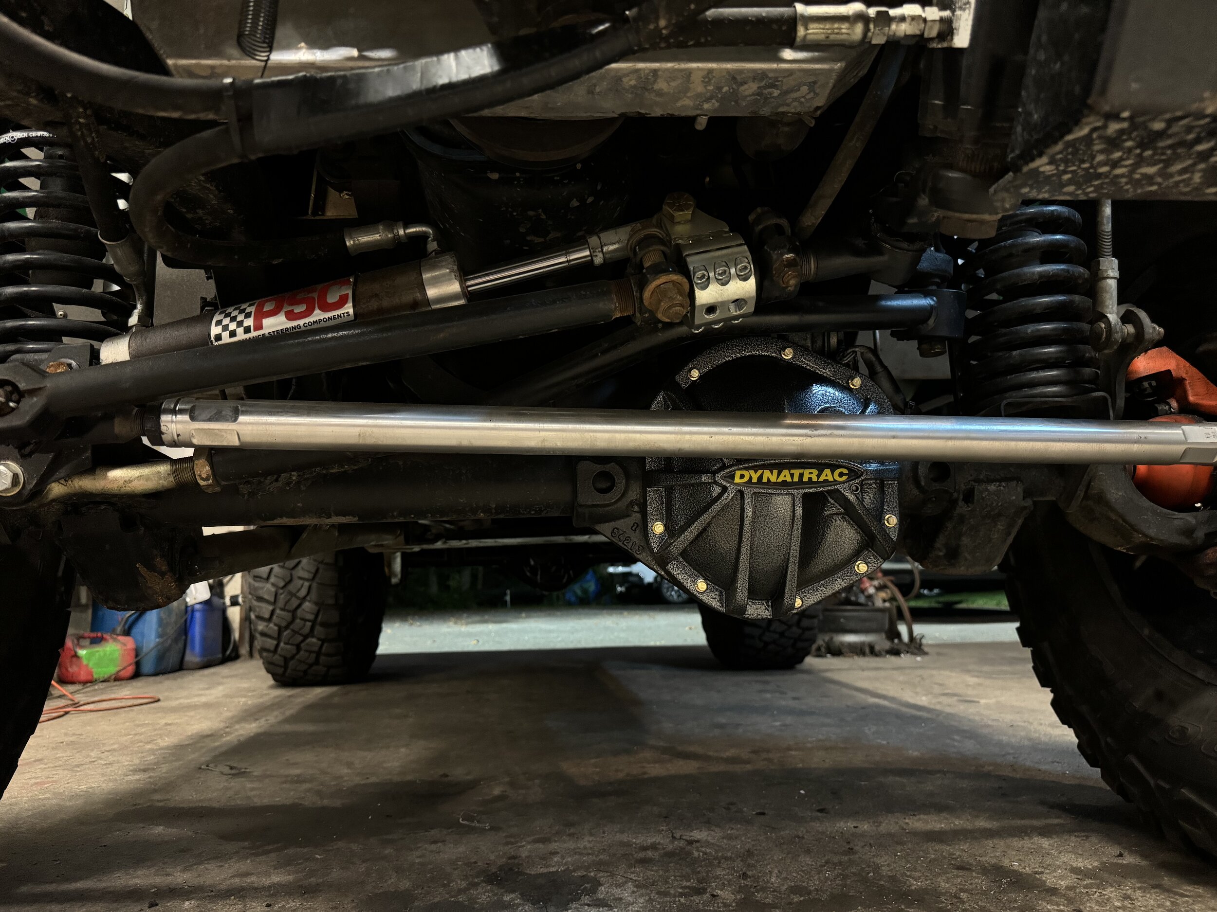

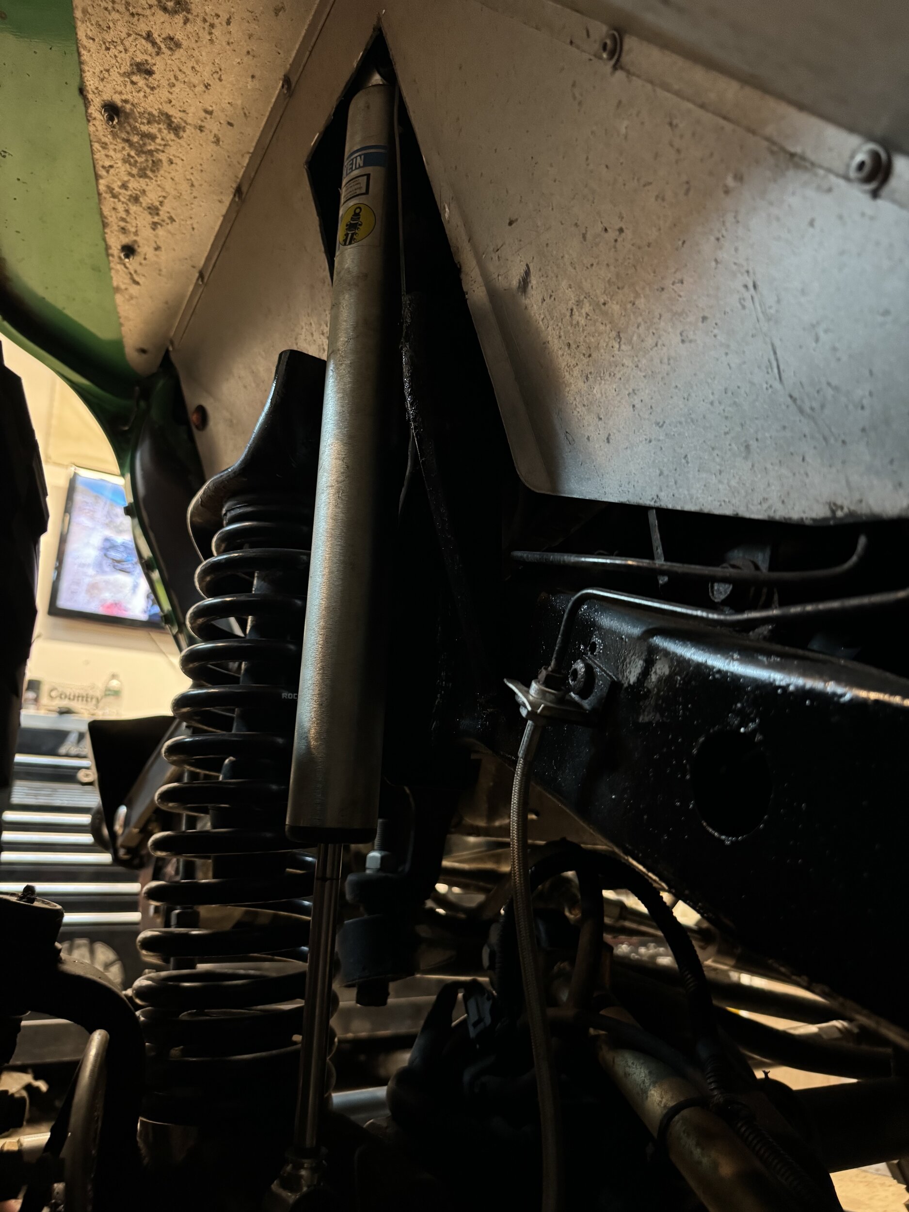

Installed bilstein 5125s, 14in travel front and 12in travel rear.
Ford outboarded shock towers.
New dynatrac front diff cover.
New Barnes rear truss

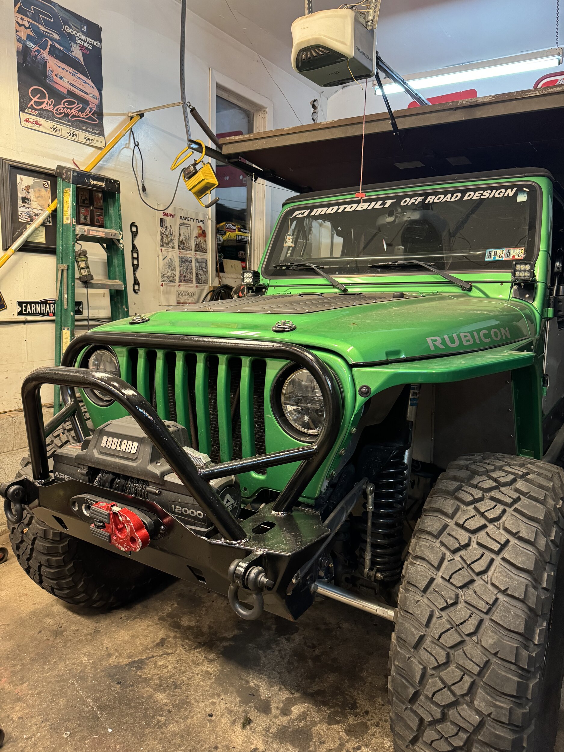

Traded my obnoxious poison spyder comp stinger for a JCR mauler bumper. I like how clean it looks, with the grille hoop.
Still have to get the Genright mini boat side rockers painted and installed.

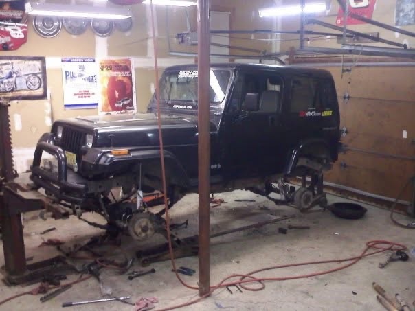

Here’s a good throwback. 17 years ago my father got me a 4in lift for my YJ for my 17th birthday. The jeep that started the addiction. I got this when I turned 16. I was never into jeeps before I got this one..and boy was I hooked after 😂 it was a 94 with a 2.5 5sp. I ended up doing a 4in lift and 1in body with 35s and a front locker.

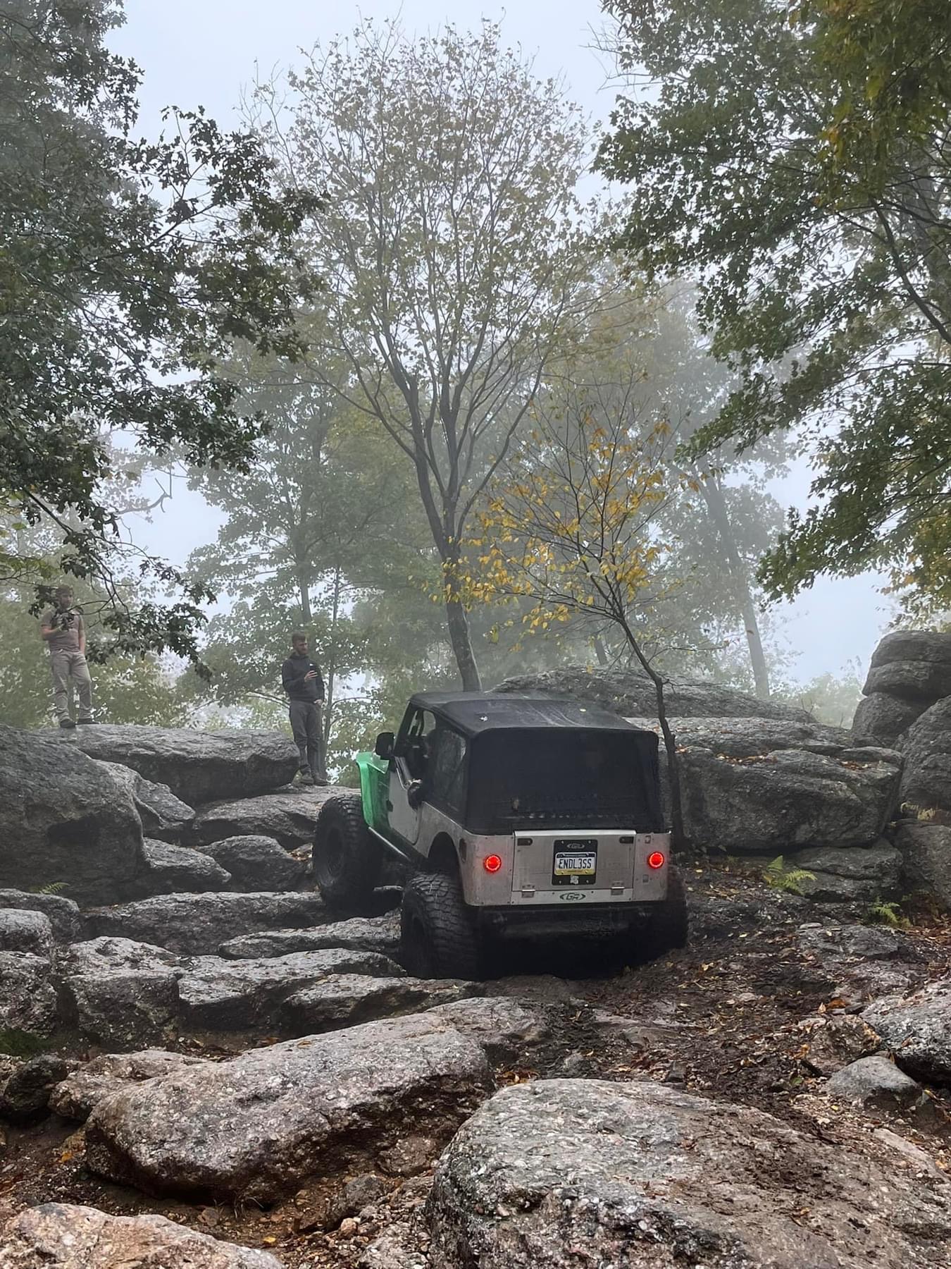

Awesome, thanks man. Ill be at rausch this weekend but itll just be a shakedown run. A couple buddies are going with 35s, 1 has open diffs but it should be a good time. My tom woods rear driveshaft got delivered today.

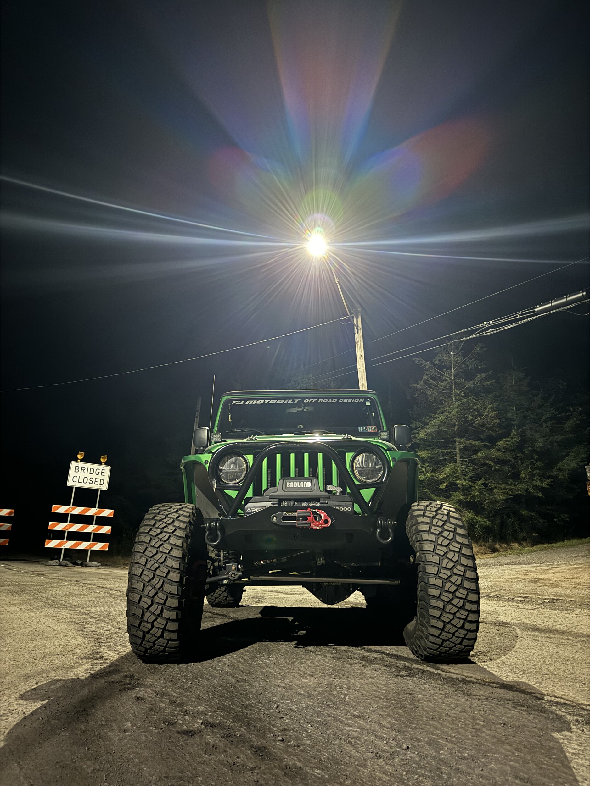

Took the jeep out for the first time since finishing the stretch. My custom Tom Woods driveshaft finally came in. No issues driving. Took it to the end of my road where they’re doing bridge maintenance so it’s closed. Took some cool pictures. Hop back in the jeep…and nothing. No crank no start. Cycled the key a few times and got a P0463 Fuel Level Sensor High Voltage. Absolutely no idea why it decided to happen when I take the jeep for a drive. I ended up going back home, picking up the truck and trailer and dragging the jeep back home 😂 I’ll dive into it tomorrow or this weekend hopefully.

Also finished up the tailgate. Amazon flush mounted compression latches, Genright plate delete. Love the flush look.
