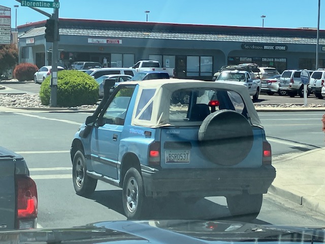

Saw this poor guy today. Not only does he have an accessory hated by all, with the intake turned around facing backward it probably pulls a vacuum and costs him a couple of the 40 or so ponies the old Tracker is likely making these days. :ROFLMAO:

I'm sure you're joking, but you're technically supposed to turn it around in rain/snow.
Still weird to see on an Arizona vehicle..
Simply raising the air intake level higher does nothing in a desert environment. Dust doesn’t magically disappear 6 feet off the ground.
In a Jeep application I would agree however raising the intake does benefit other applications such as Toyota. This is due to the air intake design through the side of the fender and out through the wheel well. Engine heat combined with tire wake create a negative pressure zone that essentially sucks in dust directly at it's thickest and heaviest. Moving the intake out and above the cab not only removes this intake pressure but also removed the intake from the densest buildup of dust. Night and day difference and adding a pre-cleaner is 100% the thing to do.
But for a Jeep...I dont see the benefit.
