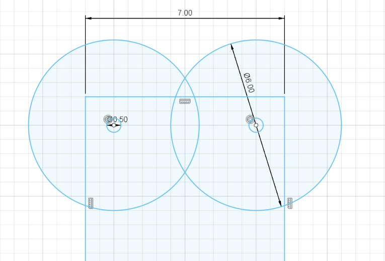

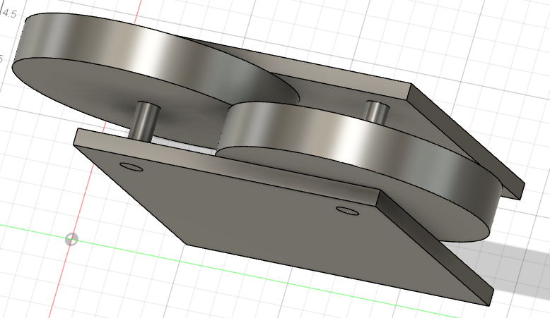

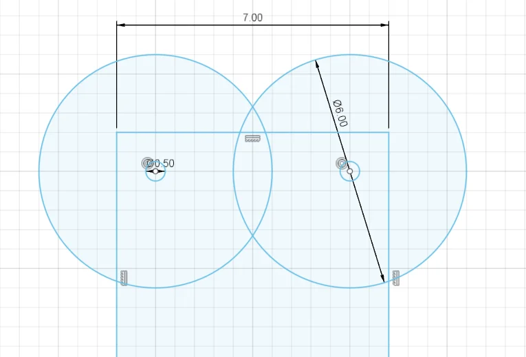

Here's what I was thinking for the rollers. A series of plates with holes in them and some wheels.
Need two of these mounted a distance from each other

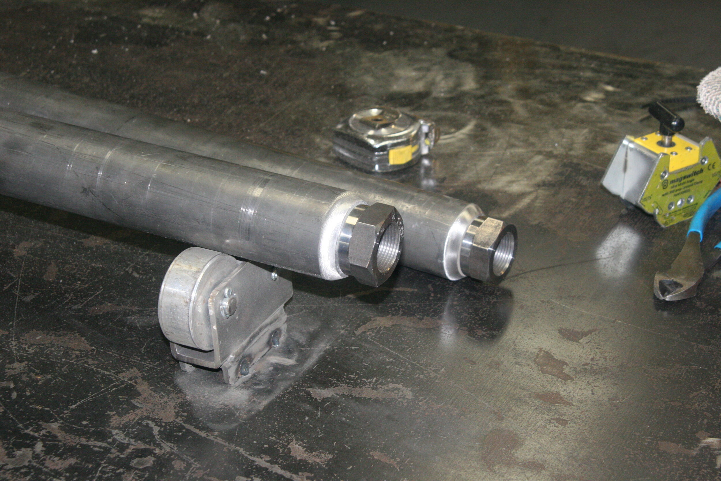

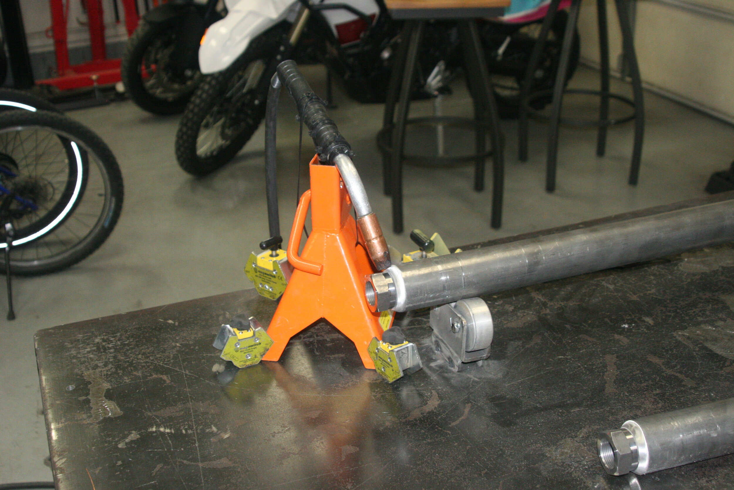

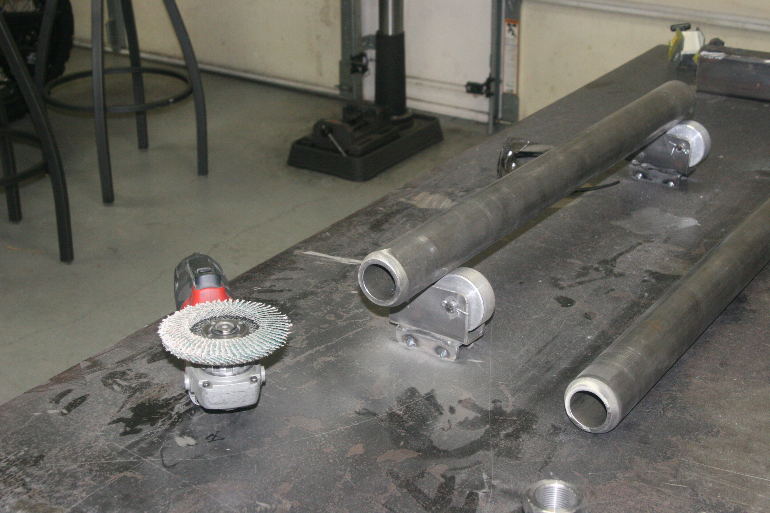

This is the setup I use. A foot switch controlling the welder, grounded to the fab table. The roller assembly is welded to the fab table.
I guess I need to develop a more sophisticated mount for the torch though....

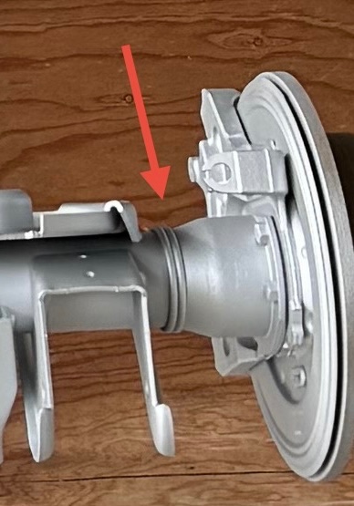

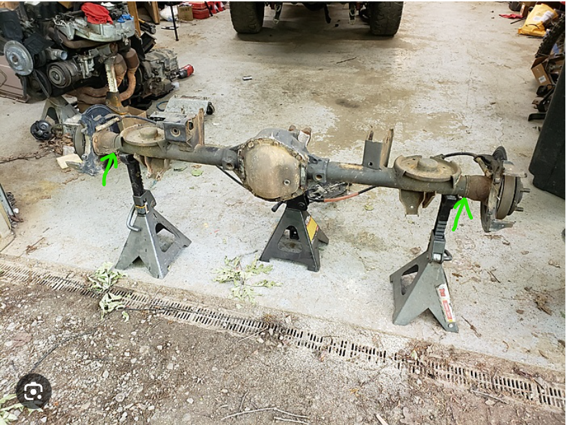

Only because you likely didn't know what you were looking at. All TJ rear Dana 44's starting about 03 or so, maybe a year or 2 earlier have the housing ends friction welded to the tubes. If you look where the tube goes from straight to just about an inch before the upset starts for the seal and bearing bore, the two rolled rings there are friction welds.
You’re right. It was right in front of me:
