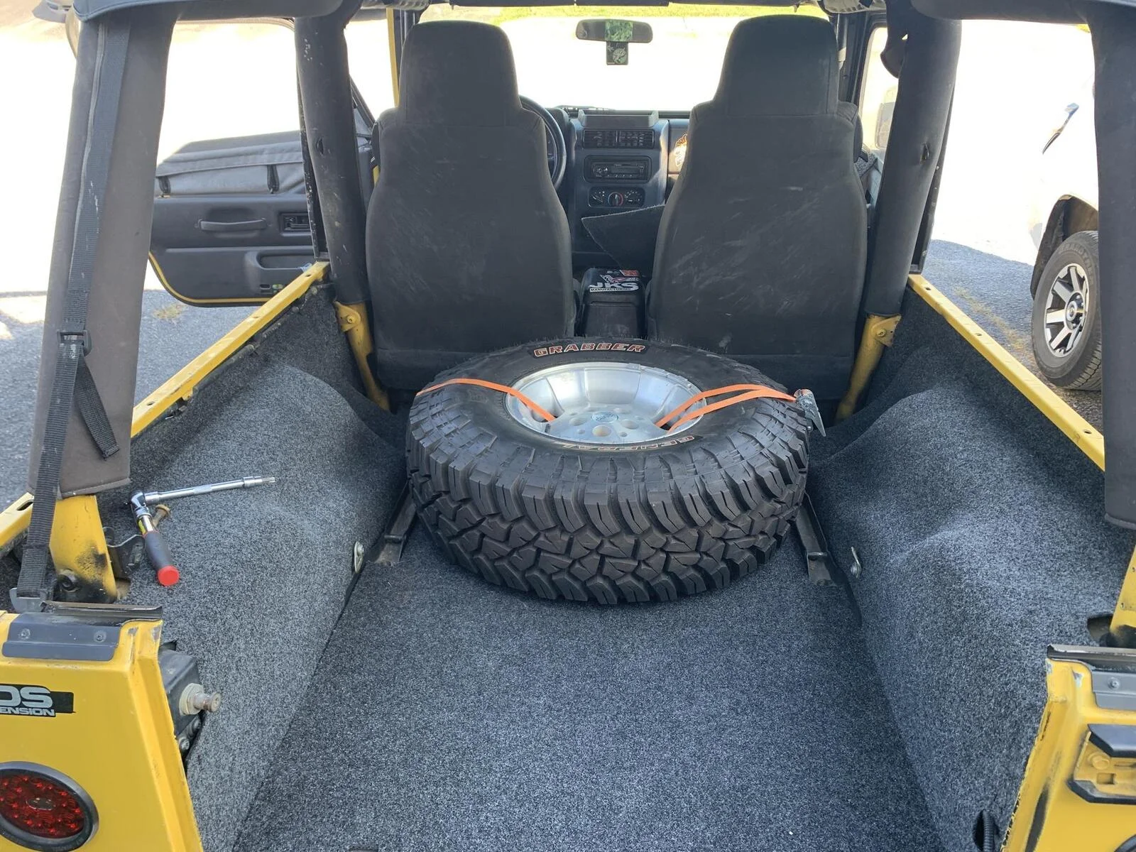

I finished another project that I started 2 years ago. I put the rest of my BedRug kit in. It looks great and hides the shit bedliner job the PO did. fenders flares are notched for the sliders, savvy skid plate is back on and we are ready to go wheeling this weekend. Time to put some scratches in the new belly skid.

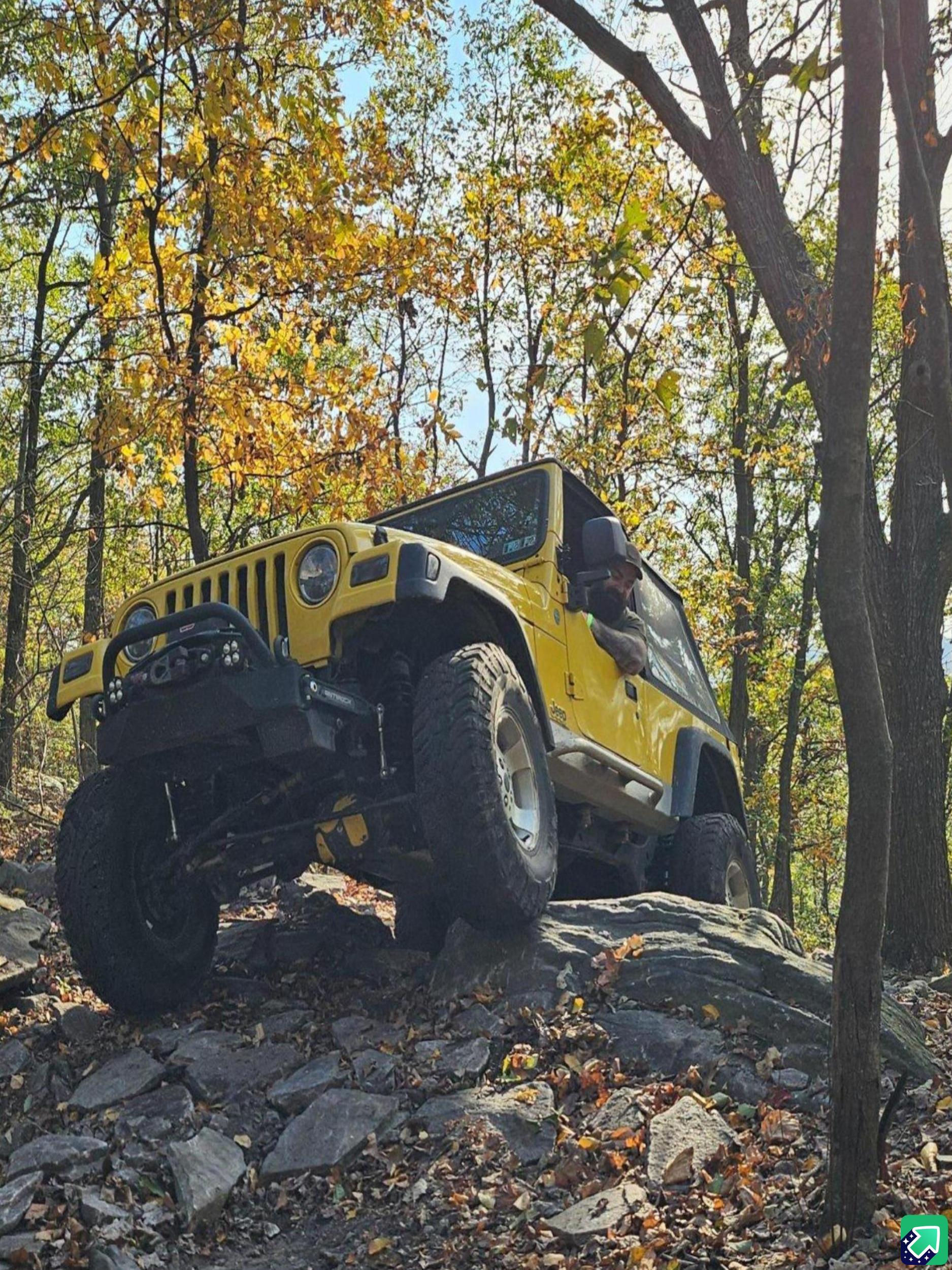

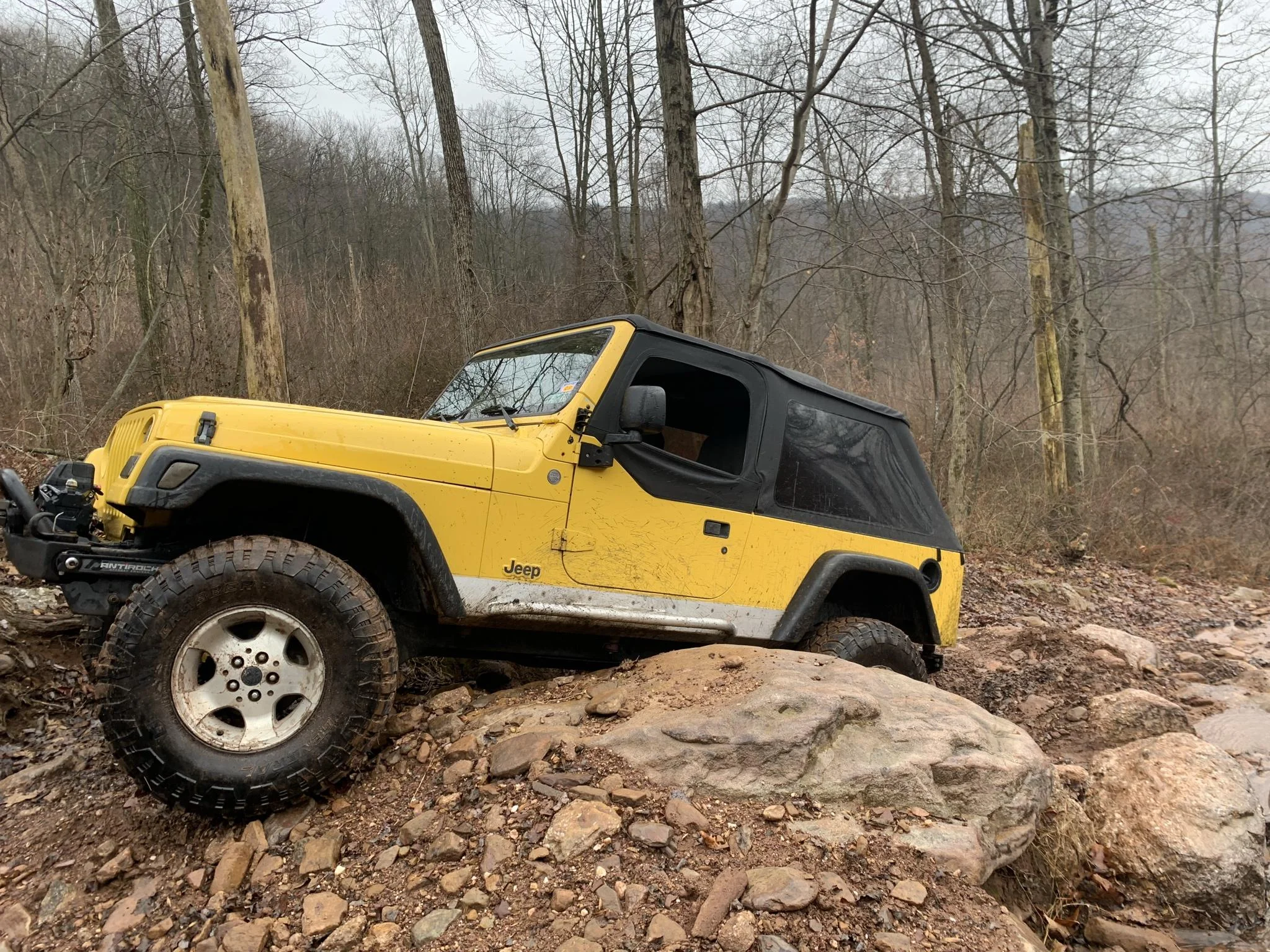

Good times at Anthracite Off-Road park on Sunday. Our group had a beginner in it so we kept it fairly mild but the belly skid proved it worth a few times. No scratches on it but I went over stuff the shovel would've caught.

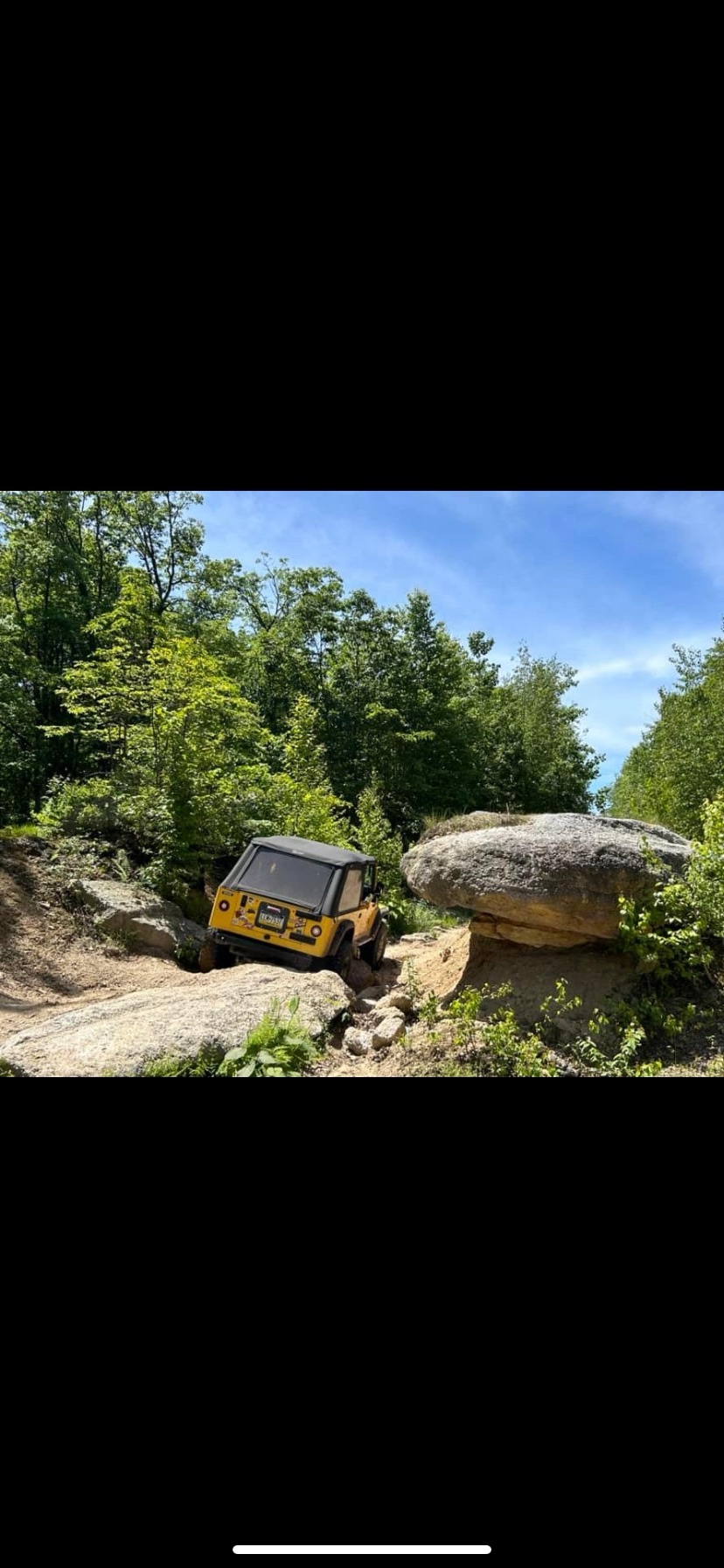

Happy to say I made it up this spot with a couple adjustments and a spirited bump of the gas pedal. This was on crawl daddy. There is one spot on the trail I had to take the bypass. Lockers are really whats "holding" me back at this point but I can't complain. This thing is a beast and alot of fun!

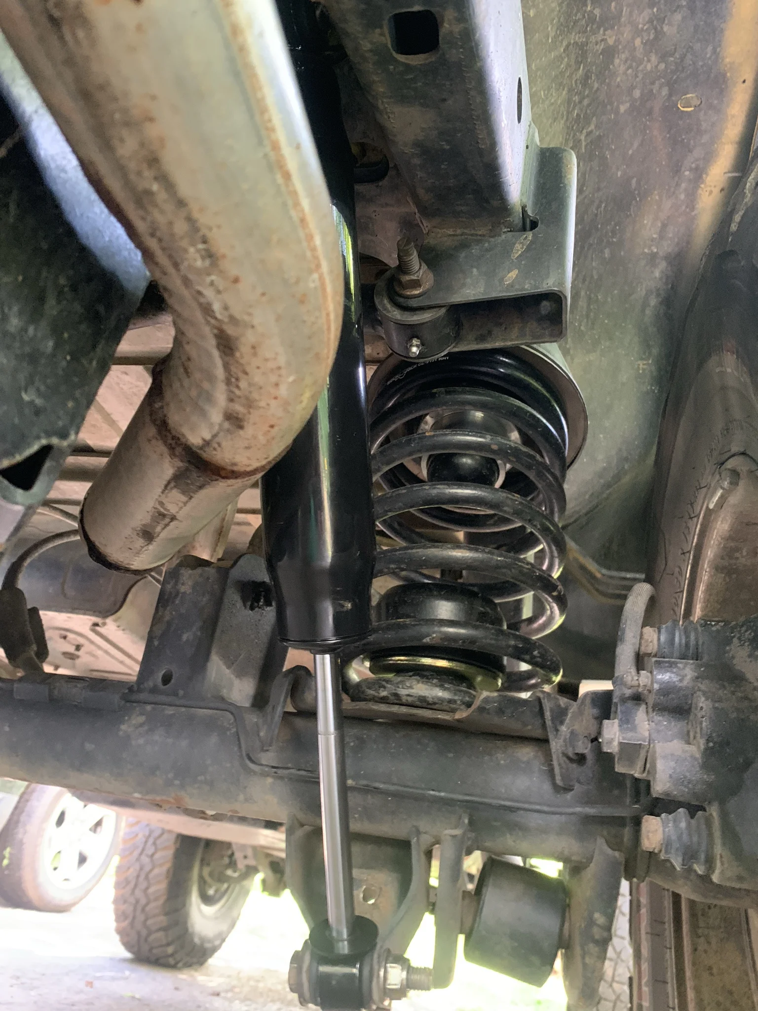

Currently I'm fighting a clearance issue between my barnes gas tank skid and a motobuilt dana 44 cover. I re-adjusted my axle and spun my lower control arms in to 15.25" bolt-to-bolt and it still hit on bumps.

Small update: I've had an issue with my diff skid (motobuilt) hitting my gas tank skid (barnes4wd).
I adjusted the control arms- no dice
Added Rock Jock rear bumpstops (i had none before) - no dice
Black max shocks and barnett skid-- winner winner, chicken dinner.
Still needs a proper trail test but I'm liking the new rear shocks.

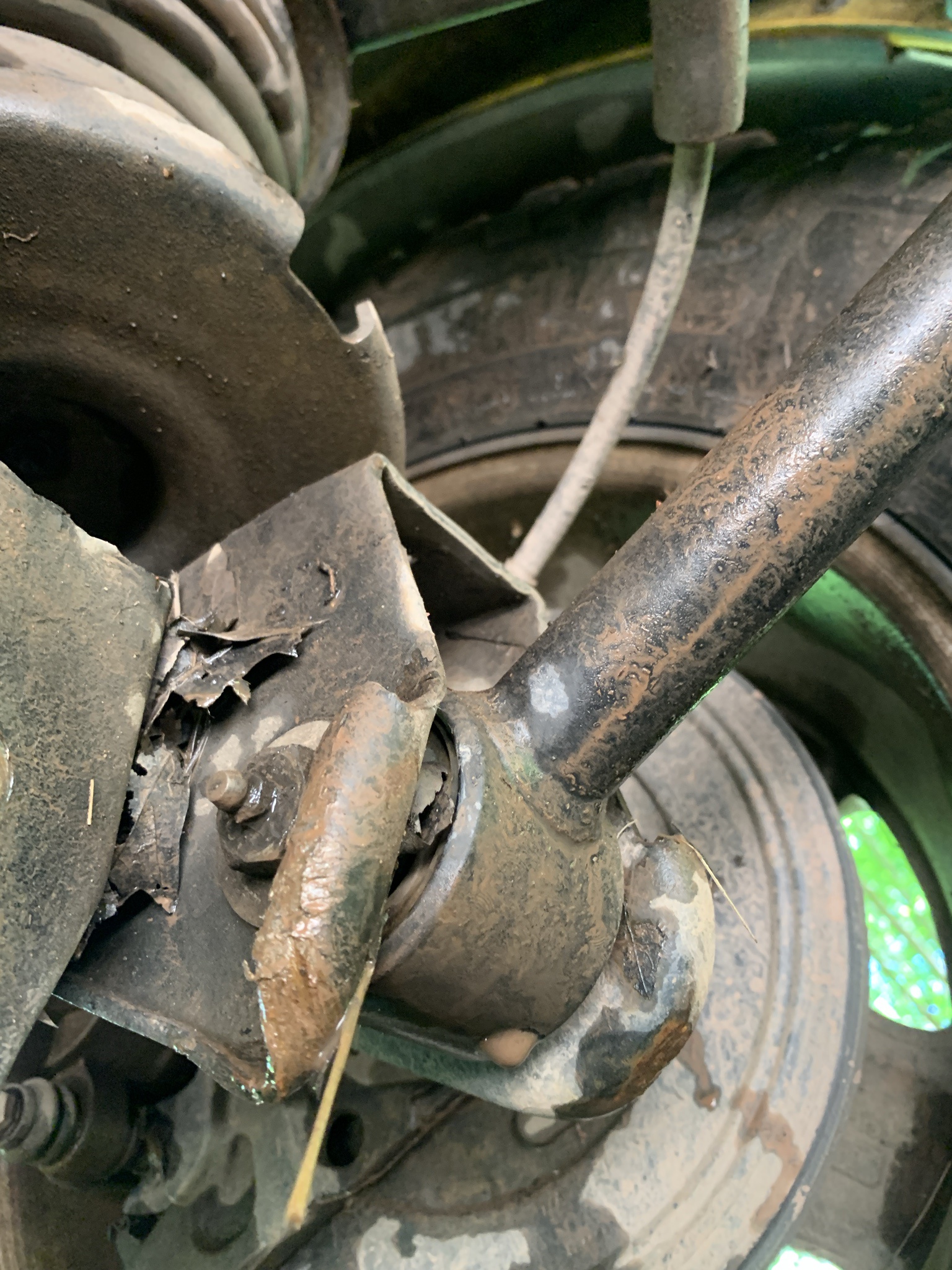

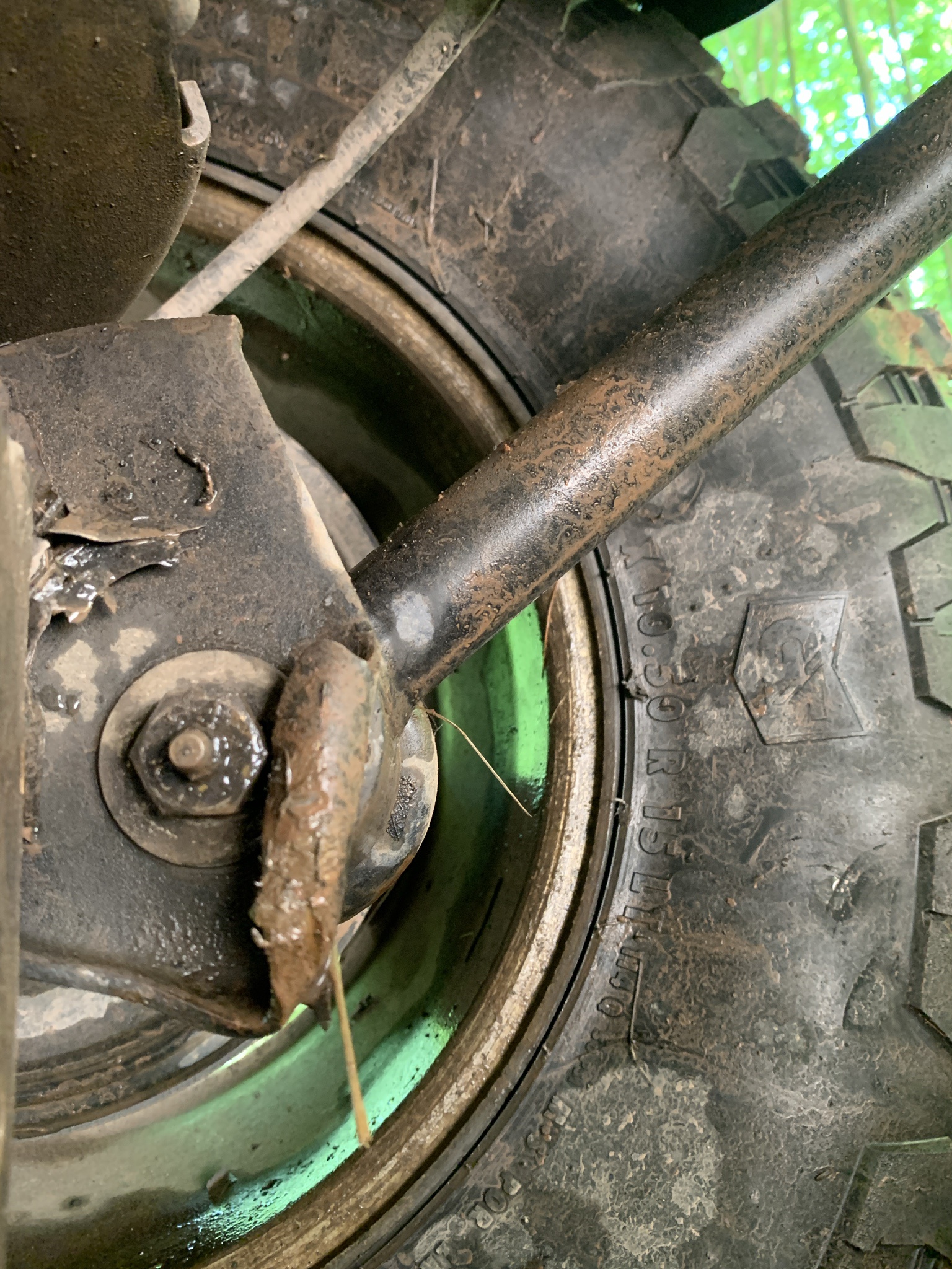

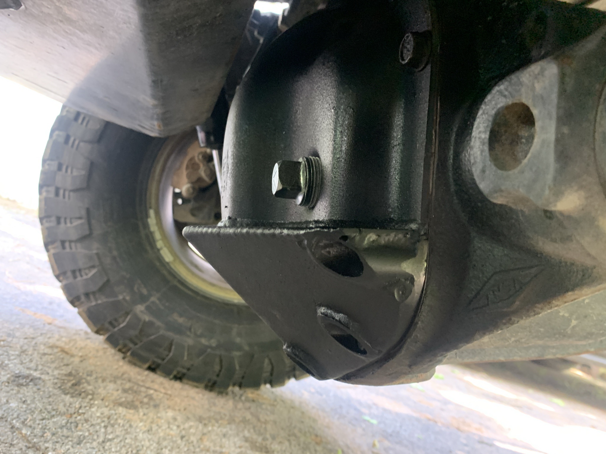

I found my next project. Do I pound this out or do I need to weld in a new bracket?
great pic ha
Rausch Creek gave me the same damage on the rear control arm mount years back. Was able to drive on it for many miles as it didn't throw off alignment.
I tried MAPP gas and hammer to fix it but gave up pretty quickly and decided it would take too much heat and hammering that the metal would be fatigued. I figured the repair would just guarantee it happening again.
I went with new mounts from Iron Rock Off Road. Haven't banged on them yet but they are stout!

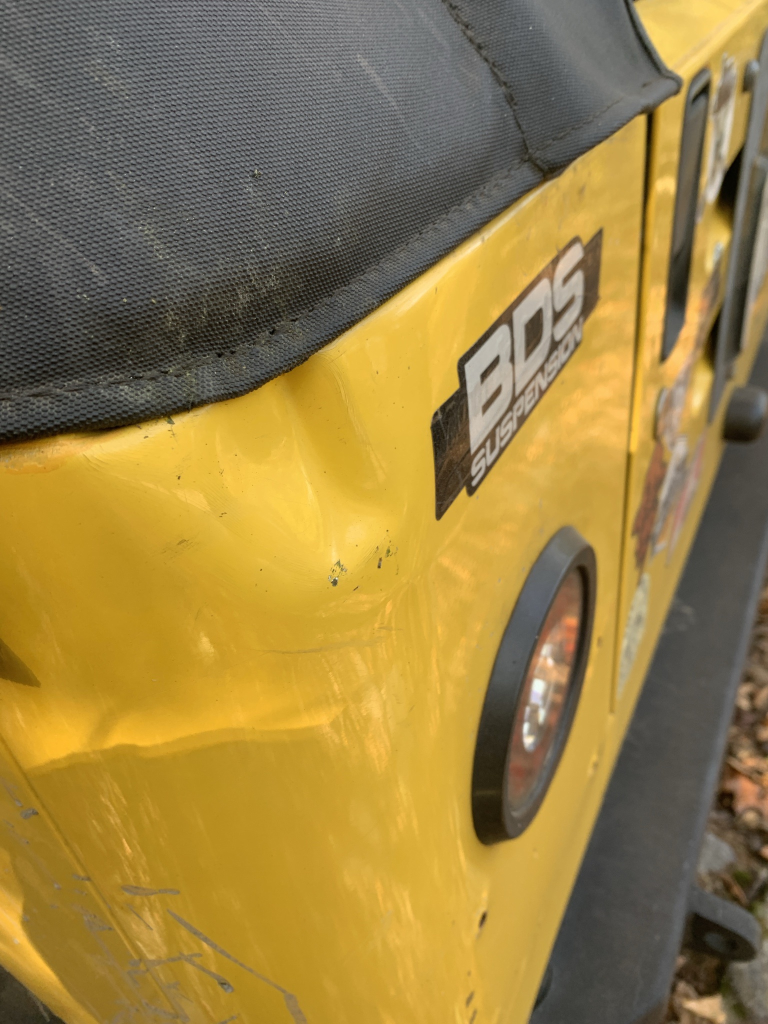

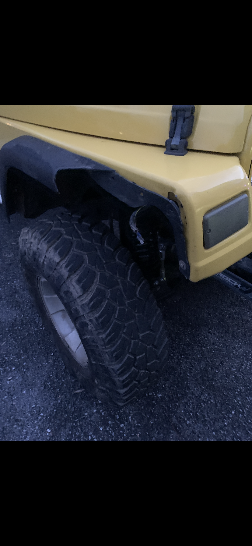

A few wheeling shots from a group trip to AOAA. I recieved my first real body damage...it was the lightest tree bump ever.
Its a small dent but I'm scared to pull the soft top right now. I'll wait for spring before I mess with this

Looks like a great ride on the rock!
Sorry for the damage. :( Hopefully you can knock it back out. Good excuse for corner armor...

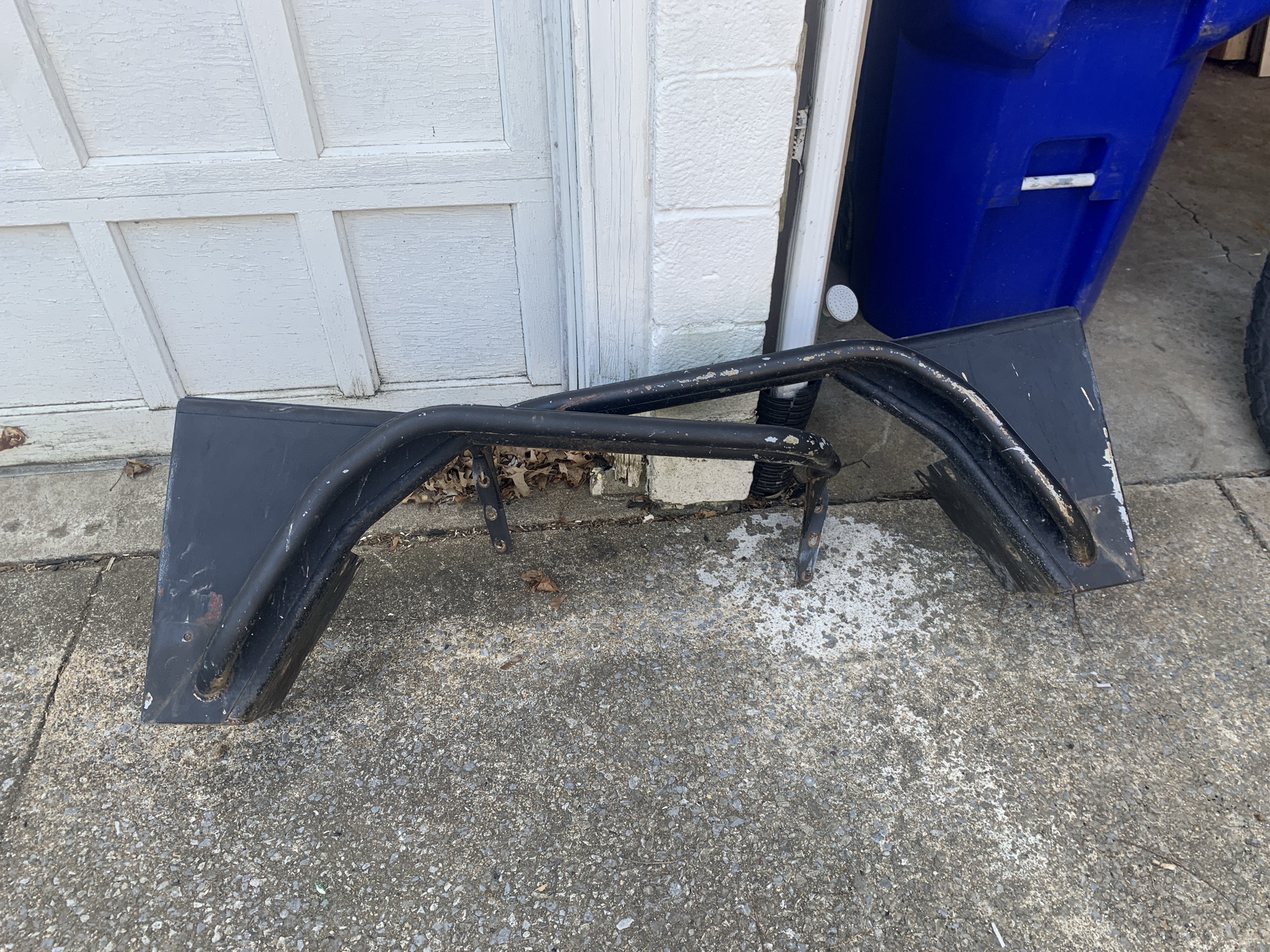

Markeplace strikes again. I picked up these poison spyder fenders from a great seller for $325 but I'm at a cross roads for armor. I have genright boatside sliders (which may have been an impulse buy) on my jeep now and it looks like I'd have to trim a decent amount to make the fenders fit.
At this point I like the idea of running the fenders more, having bumped a few trees. After wheeling with the sliders for a few trips I'm nervous about how the tubing is ran. I feel like it should be longer with the LJ.
So I turn to you wrangler forum.
Option 1- trim the sliders to make room for the fenders
Option 2- trim the fenders to make room for the sliders
Option 3- Get new sliders and sell the genright boatsides
Option #1
That's the way I went. I still need to finish cleaning them up and paint them. Here's how I trimmed them:

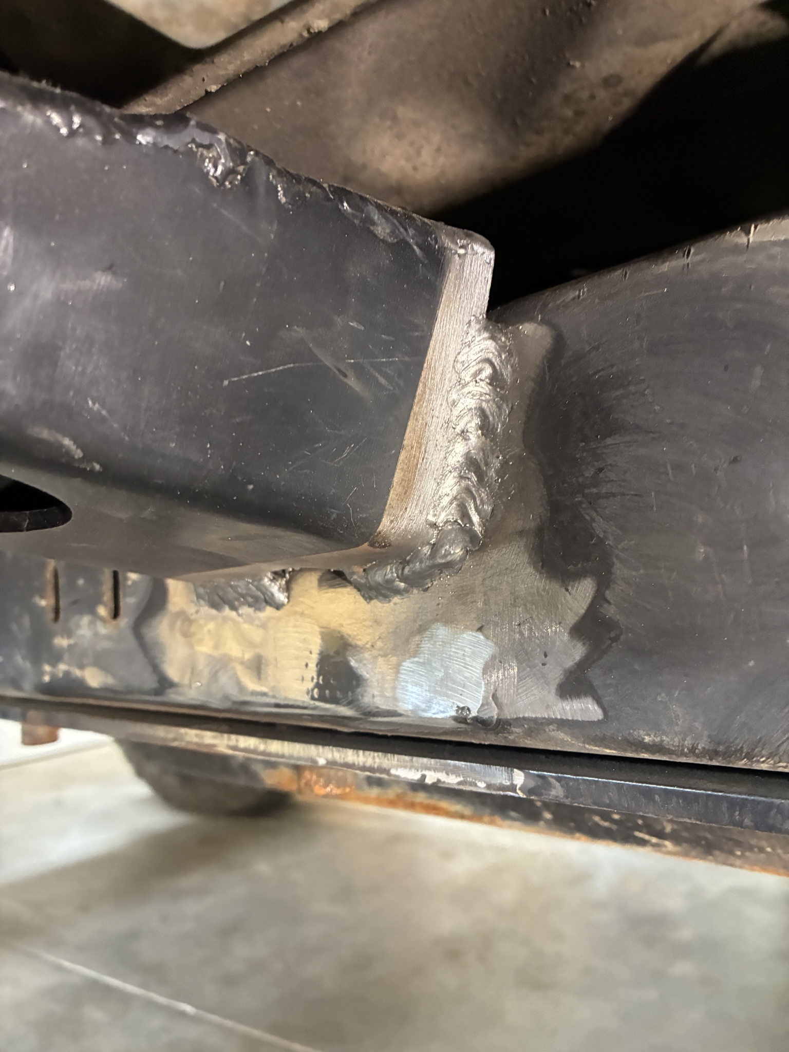

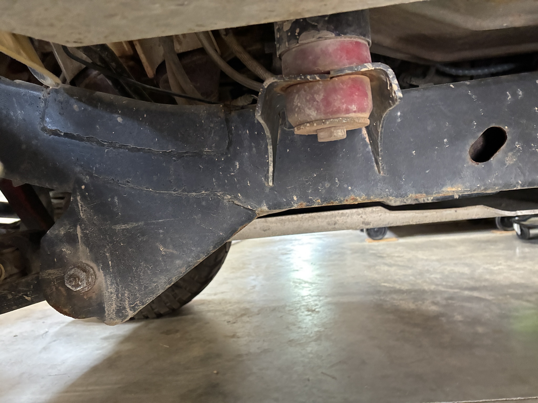

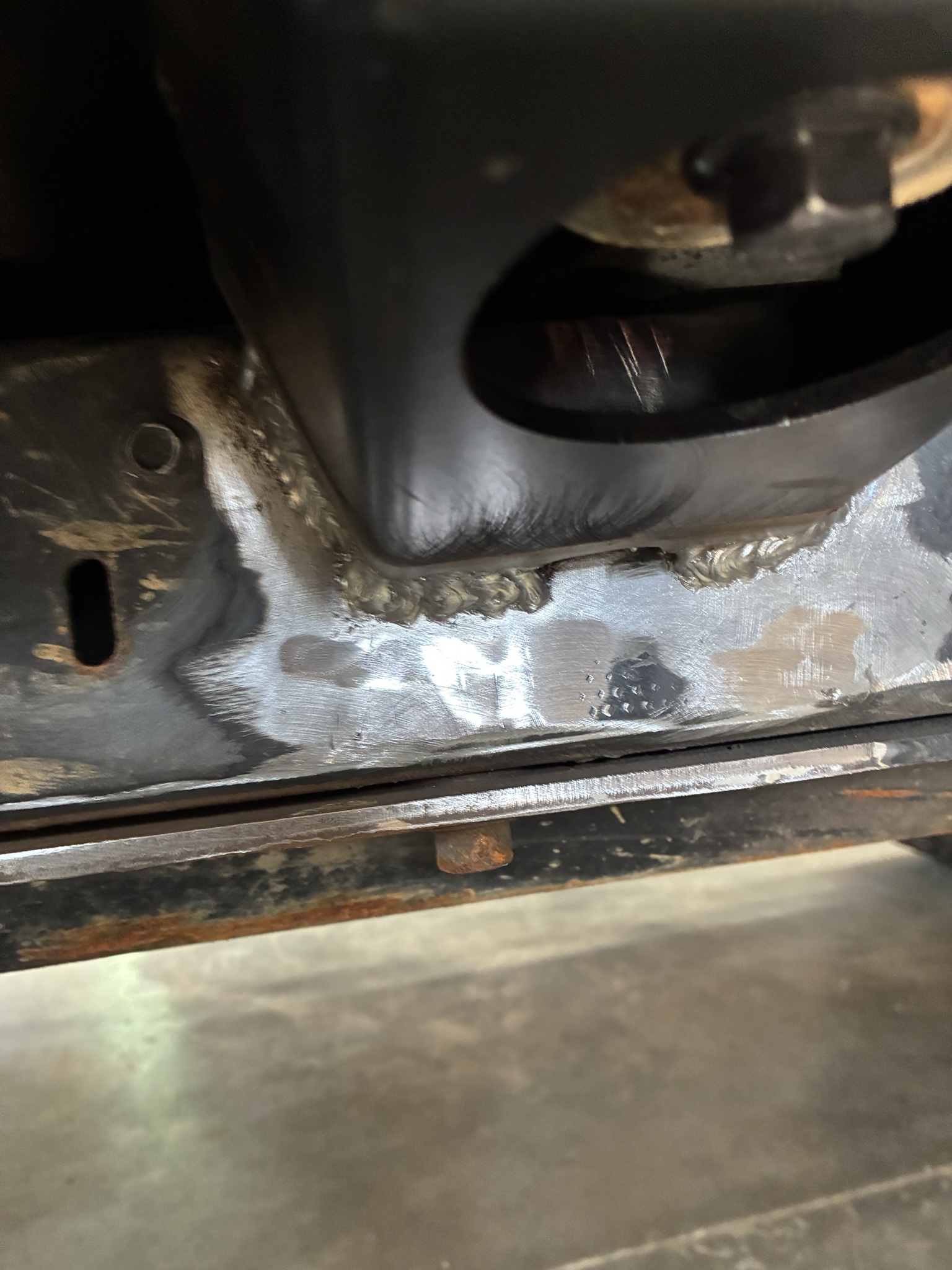

I said it almost 4 years ago on post #30, yesterday I finally completed the task. I replaced my cracked and jacked body mounts. I plan to weld in a small gusset on the top section of the mounts later when I replace the other body mounts.
I'm pretty happy with the vertical welds.
This one was cracked into the bolt hole in the center.
