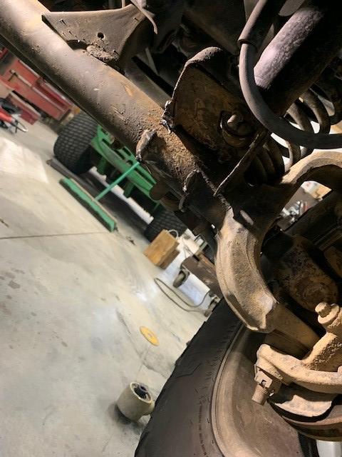

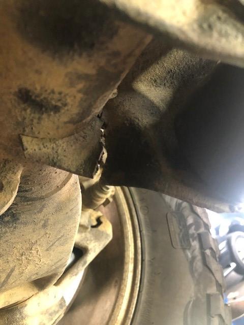

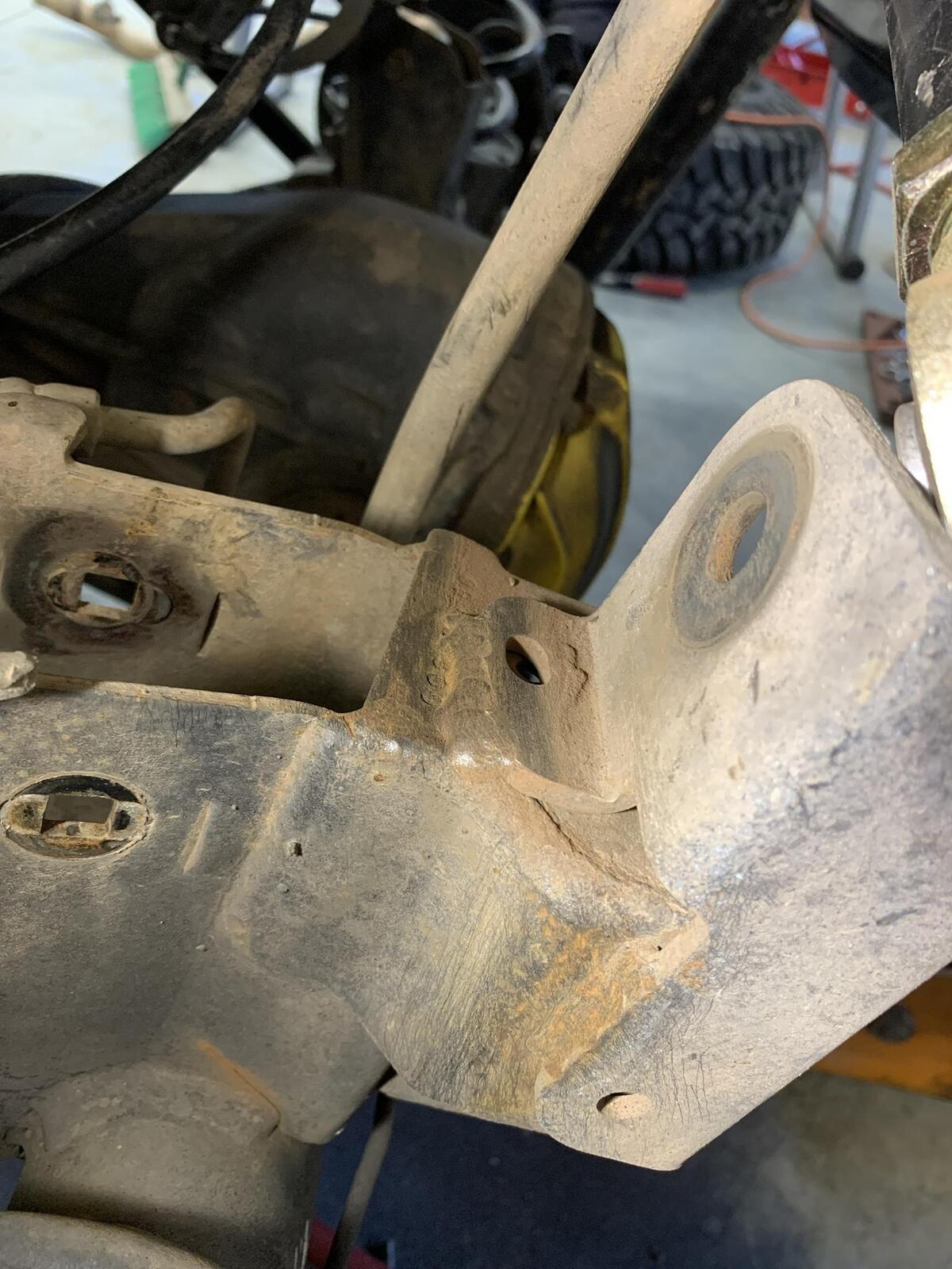

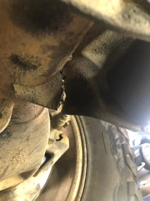

This past weekend I tackled the flimsy lower control arm brackets. It was a little unnerving cutting into the Jeep (it was my first time) but the artec brackets are idiot proof. I'm glad that weak link is replaced.

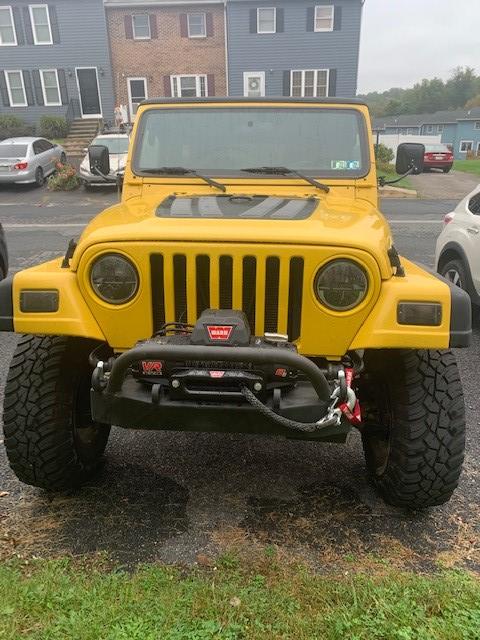

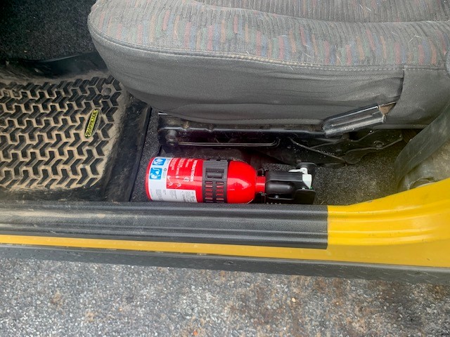

In other news I picked up a warn 8000s winch and made a nice fire extinguisher mount from a stainless bracket at work.
before
during
after
Reactions: Alex01 and Wildman
Well the new control arm brackets have been put through the paces and they are tough! 2 more trips to Rausch since the upgrade and I even played on some more challenging trails (no videos yet). I also scored a 231 transfer case with a brand new sye kit installed for 200$. I still need to order my rear driveshaft.

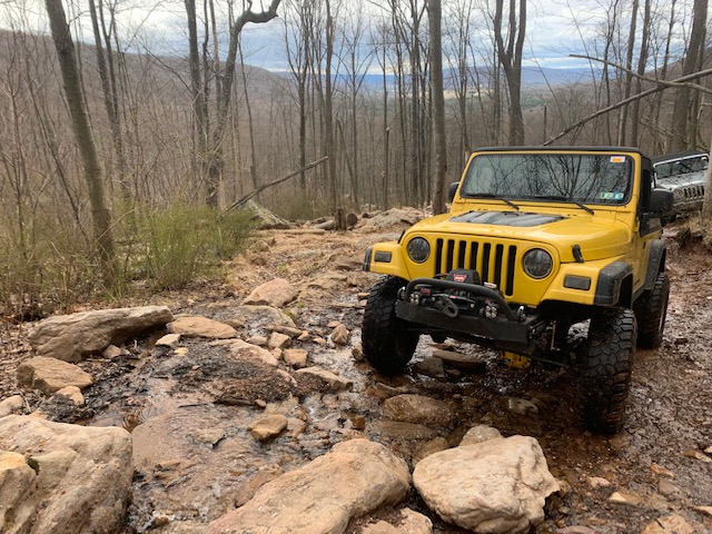

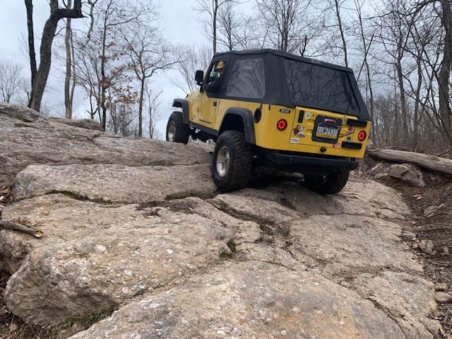

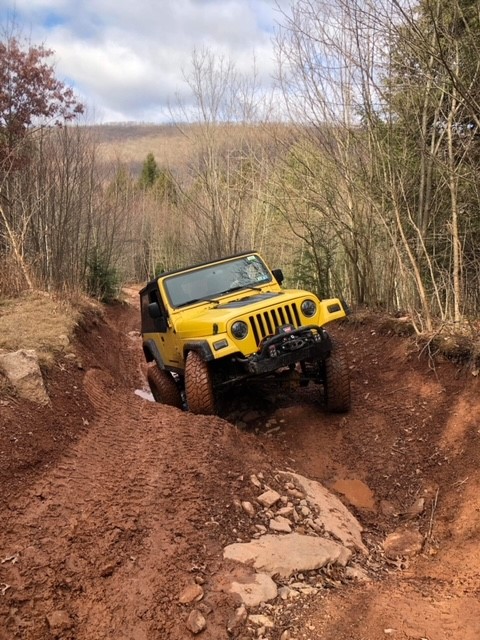

A few trail shots till my buddy sends over the ones he has.
angle does not to this spot justice the hill was steep leading to this ledge.

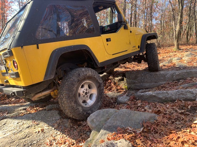

A few shots from todays trip. It was pretty tame but we did hit up a few black trails.
In other news I bought my dads suv so I now have a daily driver to keep the road miles off the jeep and now I can tackle the bigger projects that I have been stock piling.

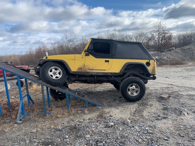

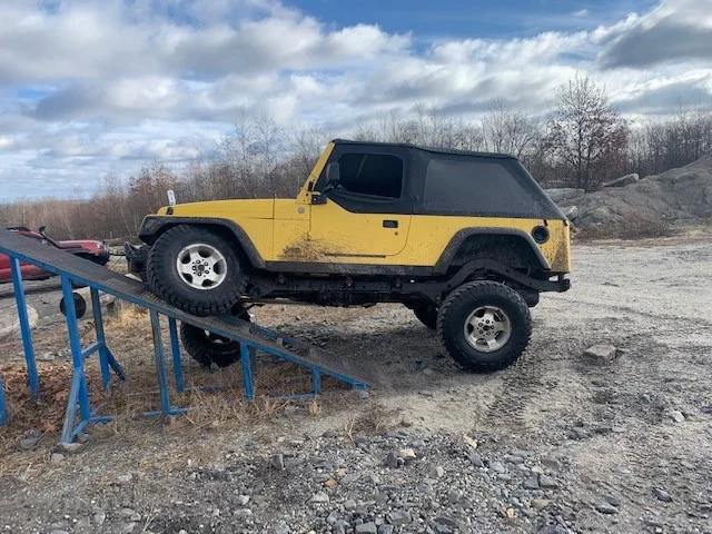

I actually got higher on the ramp than my buddy's gladiator on 38's which was surprising.

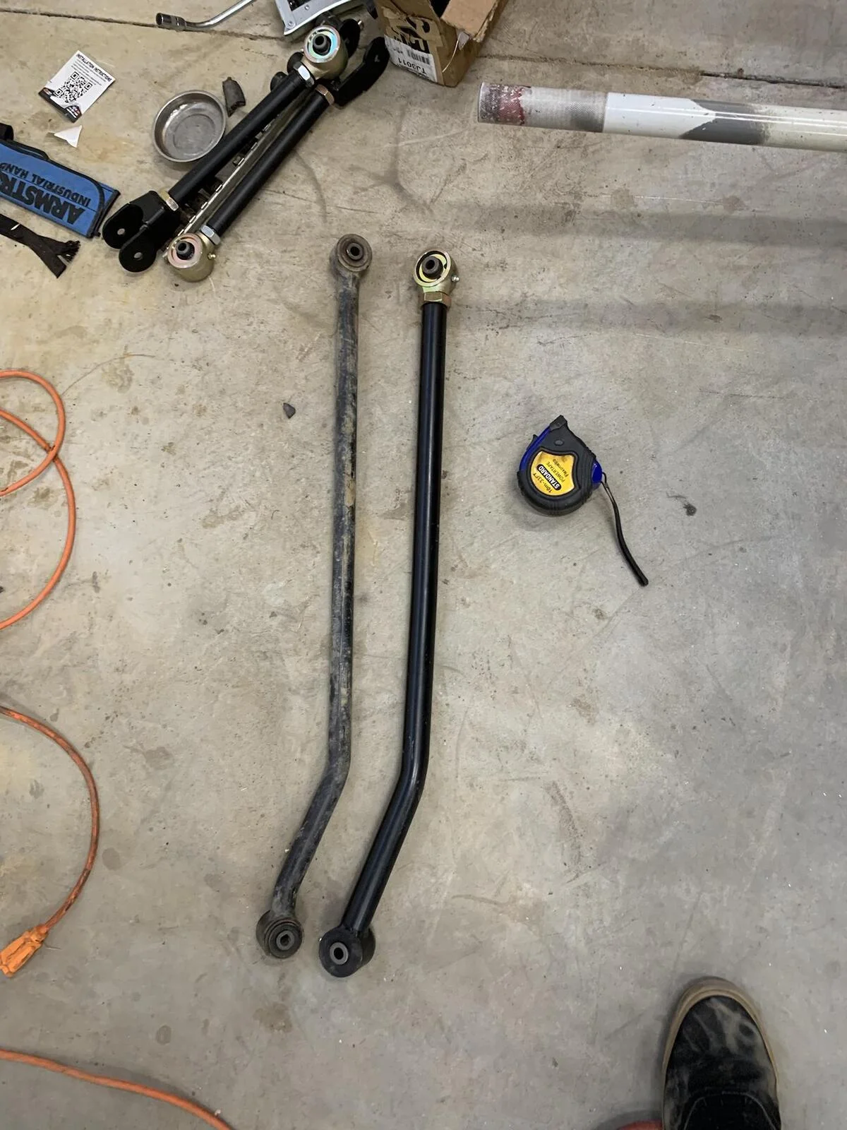

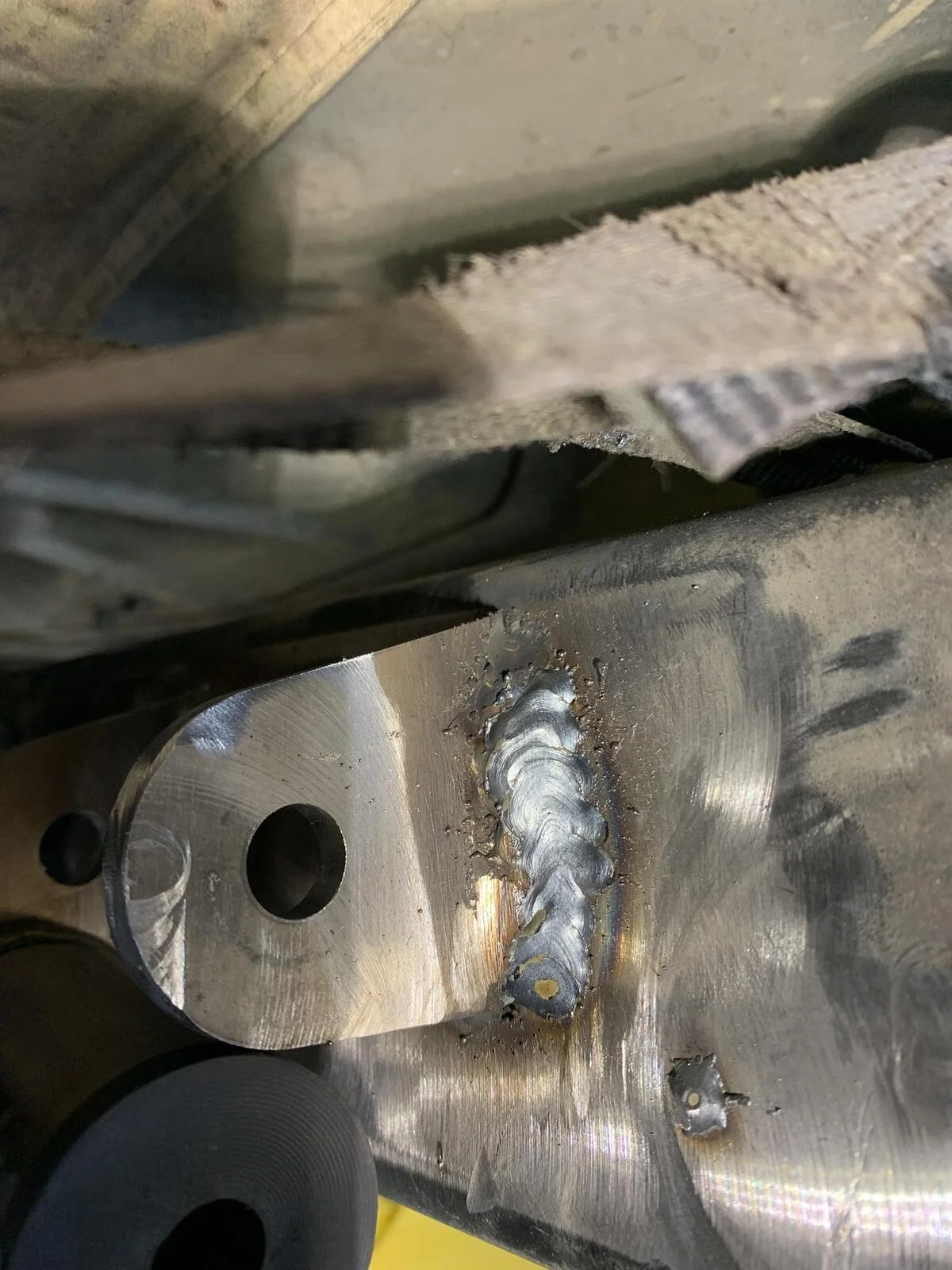

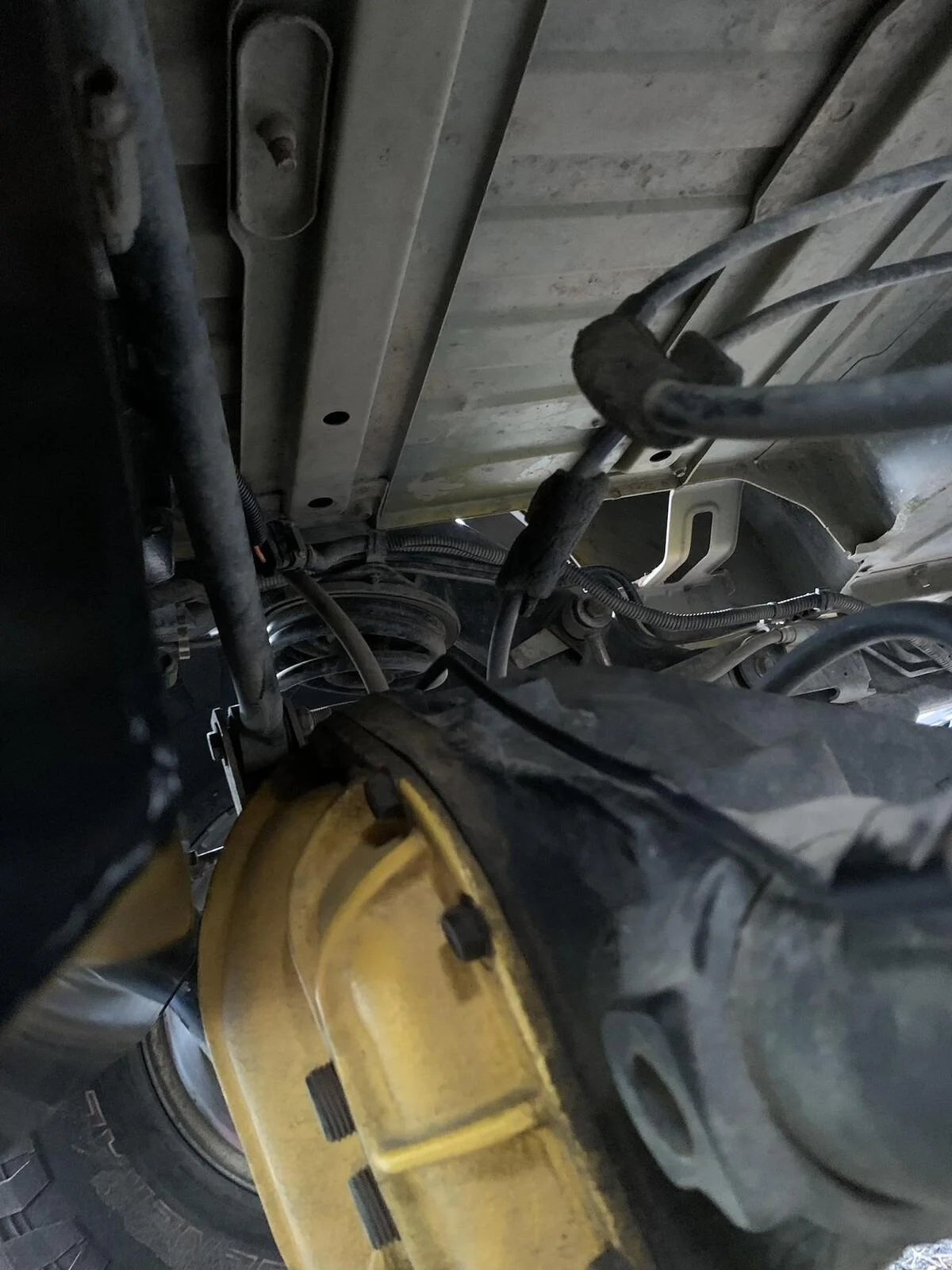

Additionally I installed the rockjock rear track bar and relocation bracket. Thanks to the previous owner for completely welding the old one on instead of installing it properly. The axle was out 1.625" before the track bar replacement. onto the pictures

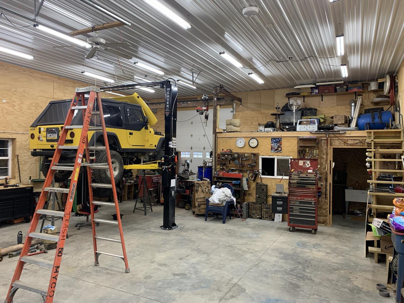

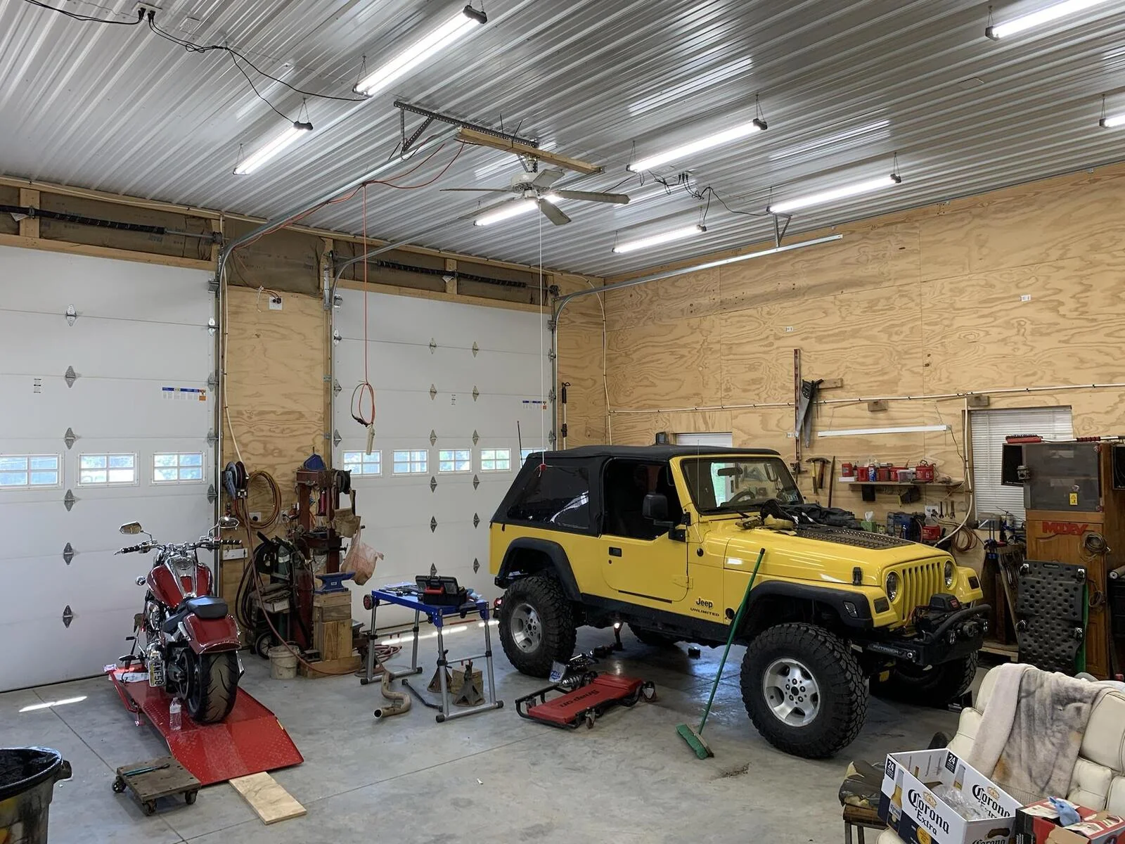

I am truly lucky to have awesome inlwas that let me use their huge air conditioned garage.
before I centered the axle the rear diff skid was hitting the gas tank skid. I brought the axle in an inch and rotated the axle to set the pinion angle

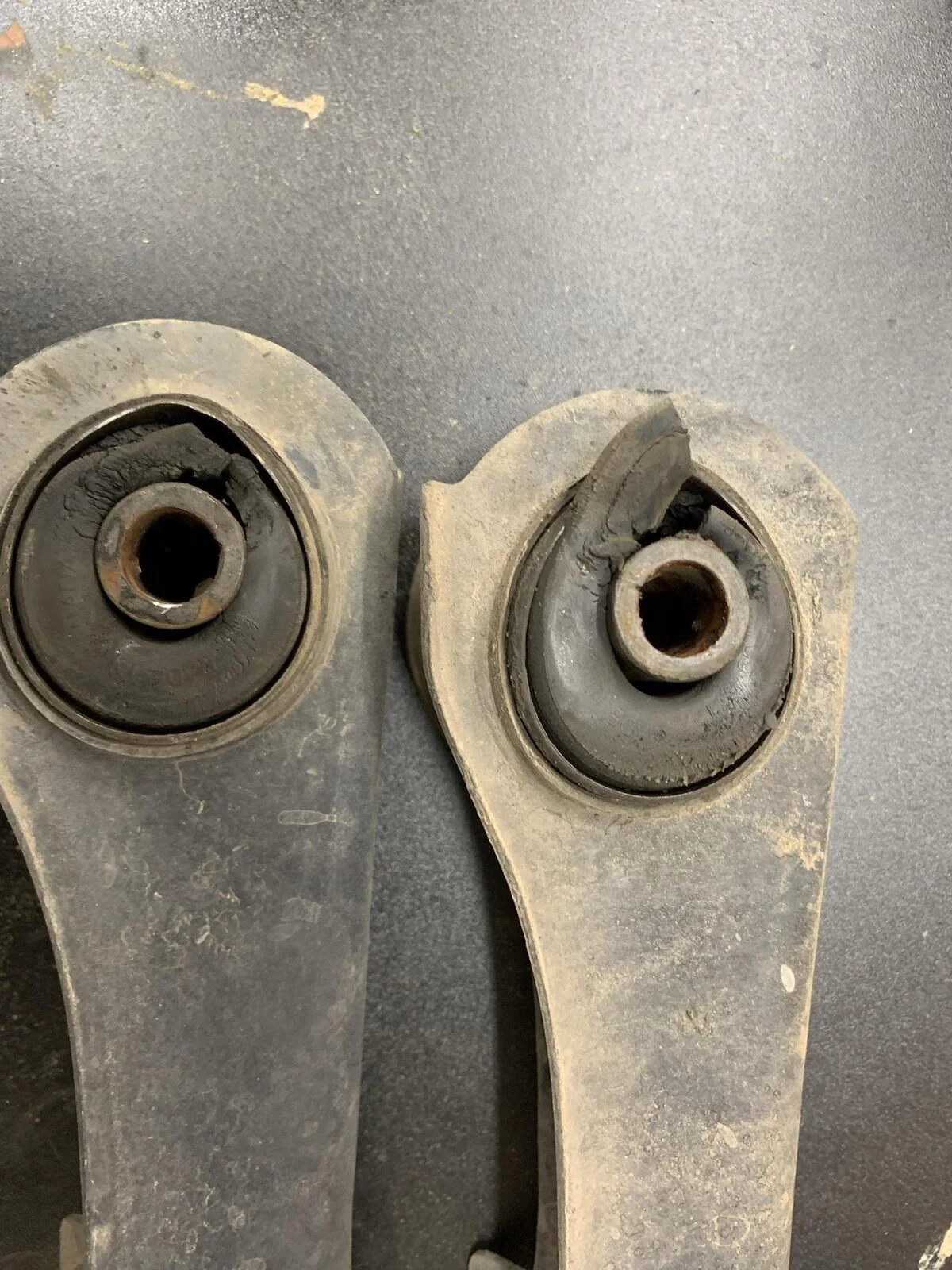

these were my insanely beat stock conrol arms
previous owners hack of an install on the track bar bracket
rock jock goodness

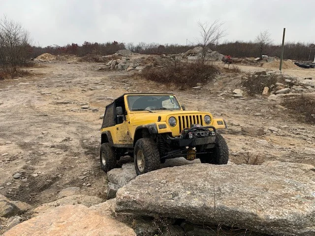

I developed steering slop and a slow leak in my steering box so that was replaced but there was still a few degrees of wobble. I chose to ignore it for a bit (don't do this) and later discovered my brand new teraflex front track bar nut had stripped and the whole thing was hanging on by the cotter pin! That was replaced with a Currie track bar. It's so nice and easy to install.

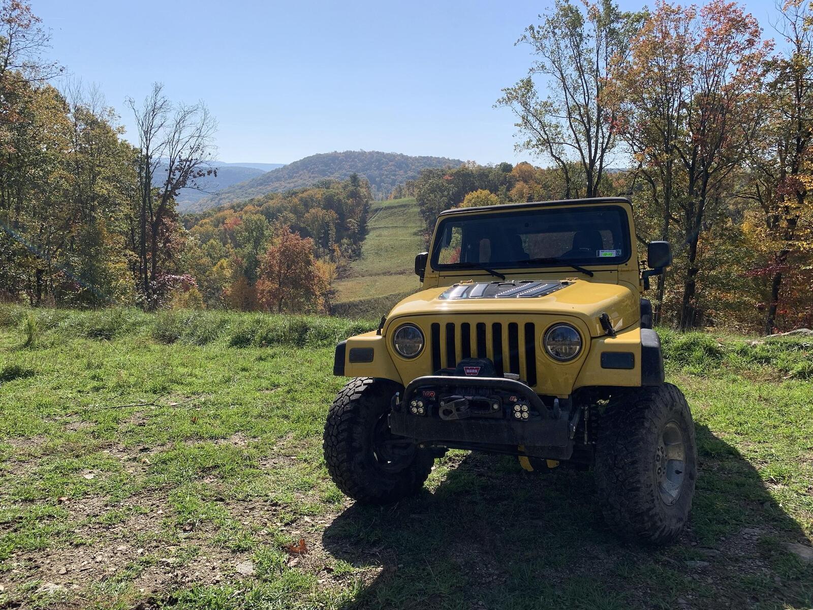

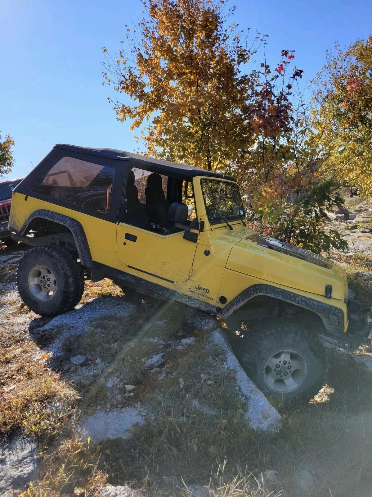

I took the Jeep out wheeling one more time before I start a few more projects and snapped to decent pictures.
ROTM material
I cannot wait to ditch the stupid stock shovel. If I had installed my belly skid I could've drove out of this instead of winching.

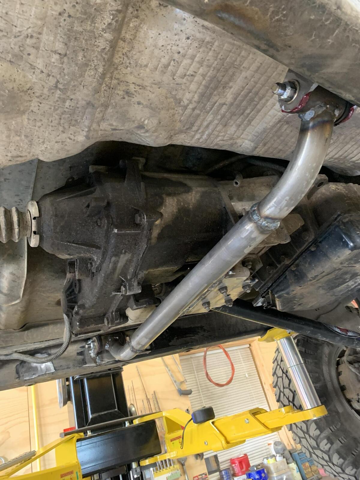

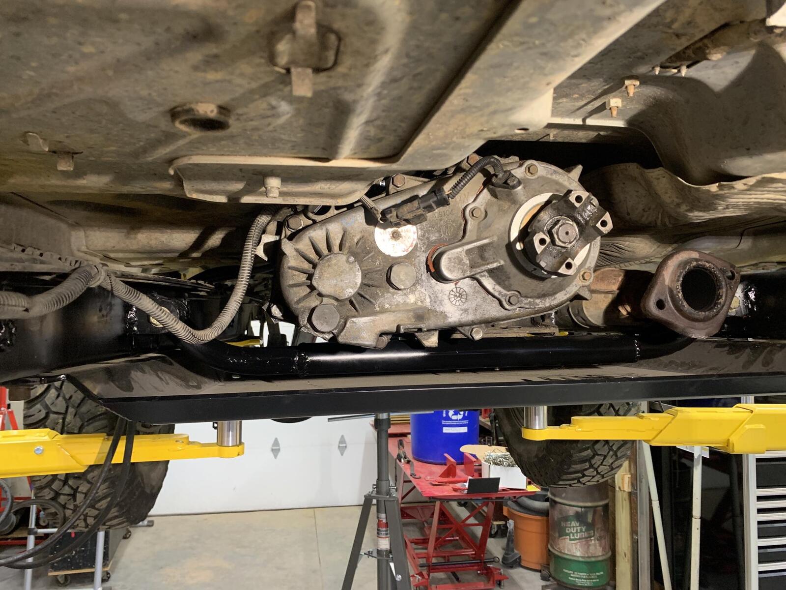

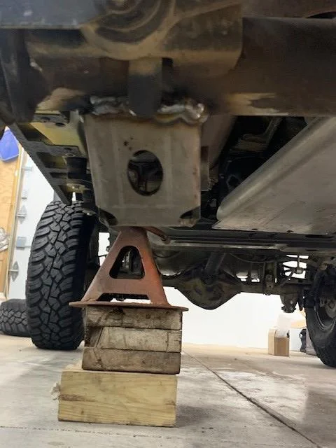

The tummy tuck has begun. I installed a cable shifter and am now in the process of tucking the the transfer case. I'll swap the SYE in shortly. My brother in-law installed a MAJOR UPGRADE in the garage. After years of driveway modifications on all the vehicles I've owned this almost feels like cheating. Hoping to have this buttoned up in the next few weeks.
I need to take measurements to make sure the transfer case is centered in the frame before I weld everything in place. I was a little concerned that the passenger side cross member tube was shorter than the driver side. Am I ok?

You may want to check that. If memory serves I do not believe that the stock case is centered between the frame rails. I may be wrong, but perhaps someone with a stock setup could give you some measurements.

I had to weld the tcase bolt plate to the crossmember pipe and I centered it on that. I'm hoping to get back over to the garage this weekend. I'll measure everything before I burn it in. I suspect its offest from the factory based off how far over everything is. I cant believe it dropped that far over....we'll see

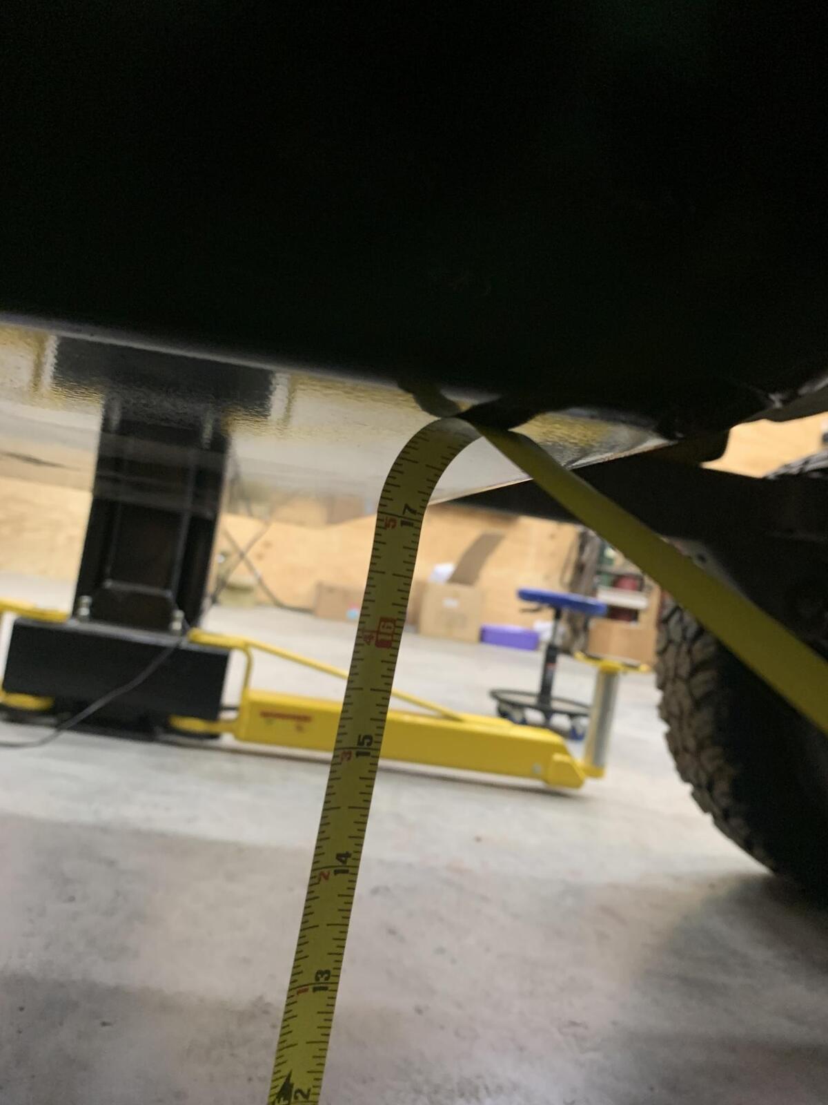

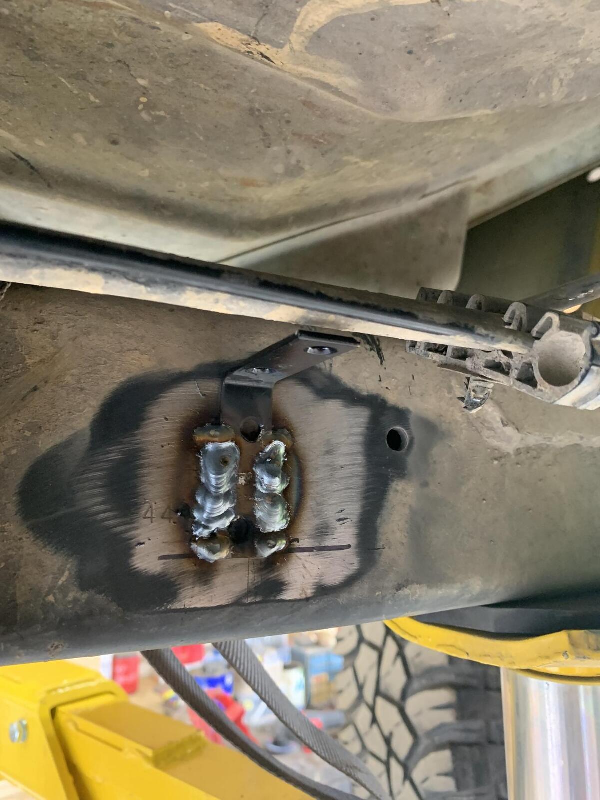

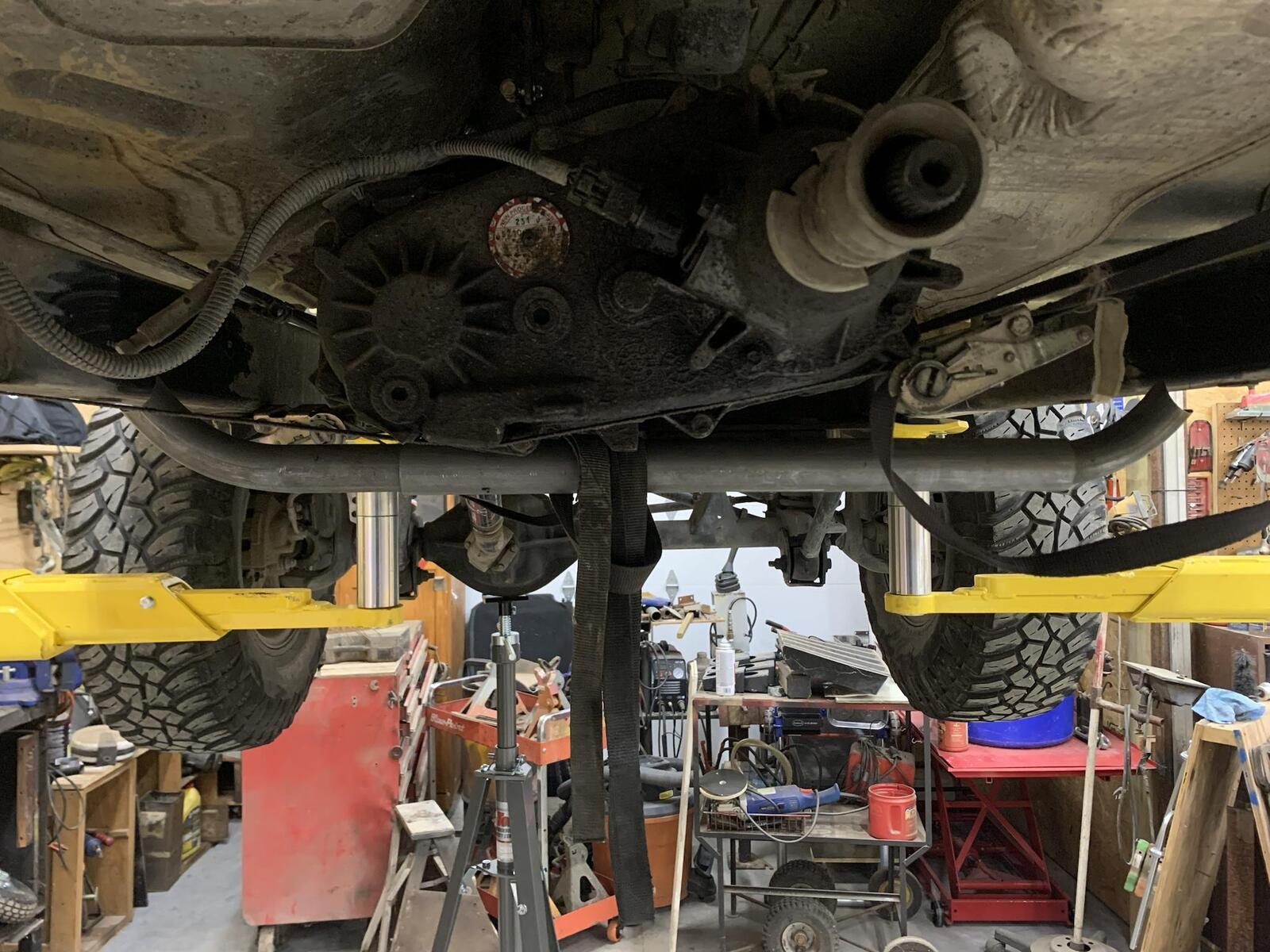

With the t-case raised I needed to relocate the mounting of the lines on the driver side frame rail. I picked up some shelving brackets and welded them in. They'll do the trick. I know some guys mount them on top of the frame rails but I thought this was easier.
Tummy is officially tucked! I ordered my rear double cardan driveshaft from Adams offroad today. Once that shows up I can dial in my front and rear pinion angles and get this this to the exhaust shop and get it inspected. I'm so close to getting the jeep back on the road.
I didn't take a before measurement but I'm a little over 17" ground clearance on 33's with a 3 lift. It was hard to hold the tape measure and snap a picture.

5. Weld in crossmember kit + install new transfer case with SYE + install new belly skid + install savvy cable shift + order rear driveshaft- 100% FINISHED!!!

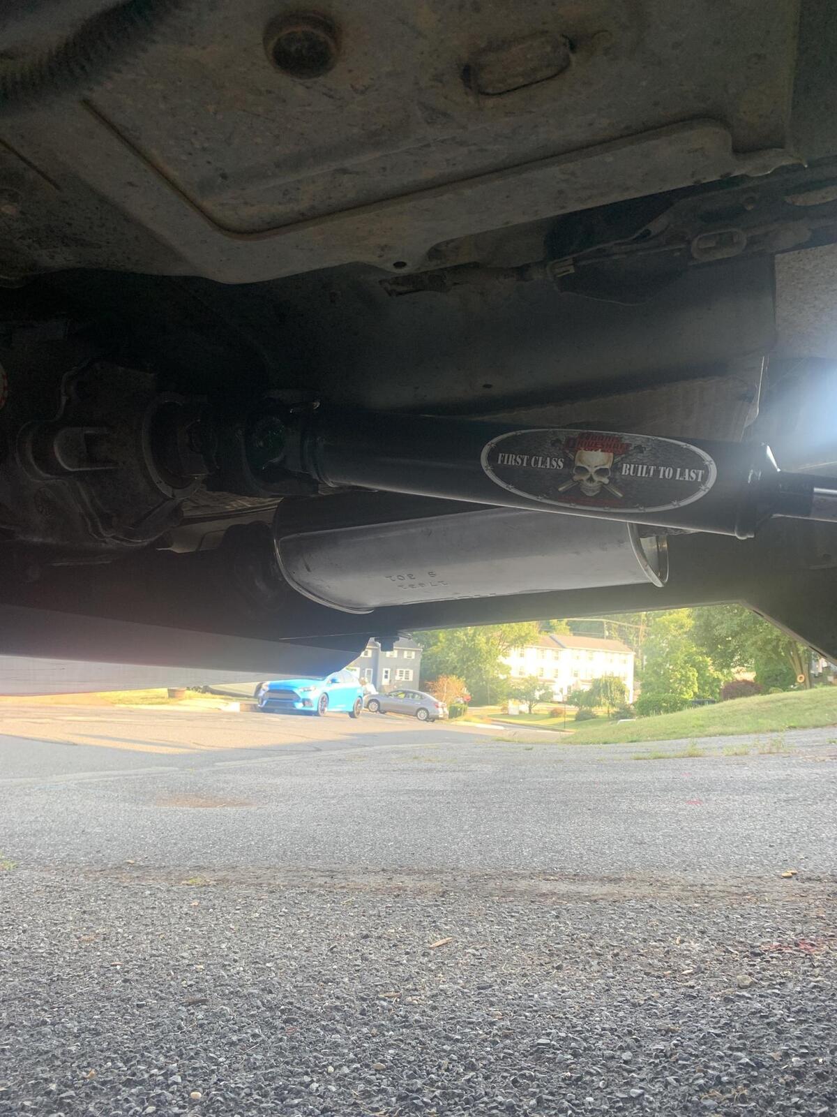

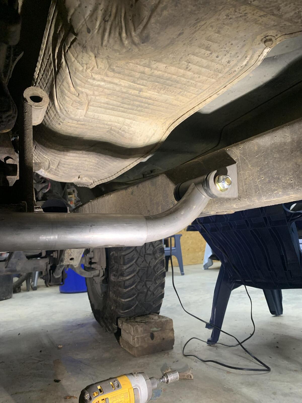

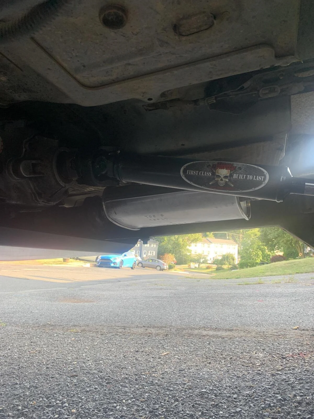

Jeep is back from the shop. Thrush Hush muffler installed and leak fixed. It was coming from the sye section, the only section I didn't address... thats on me.
exhaust is tucked nicely

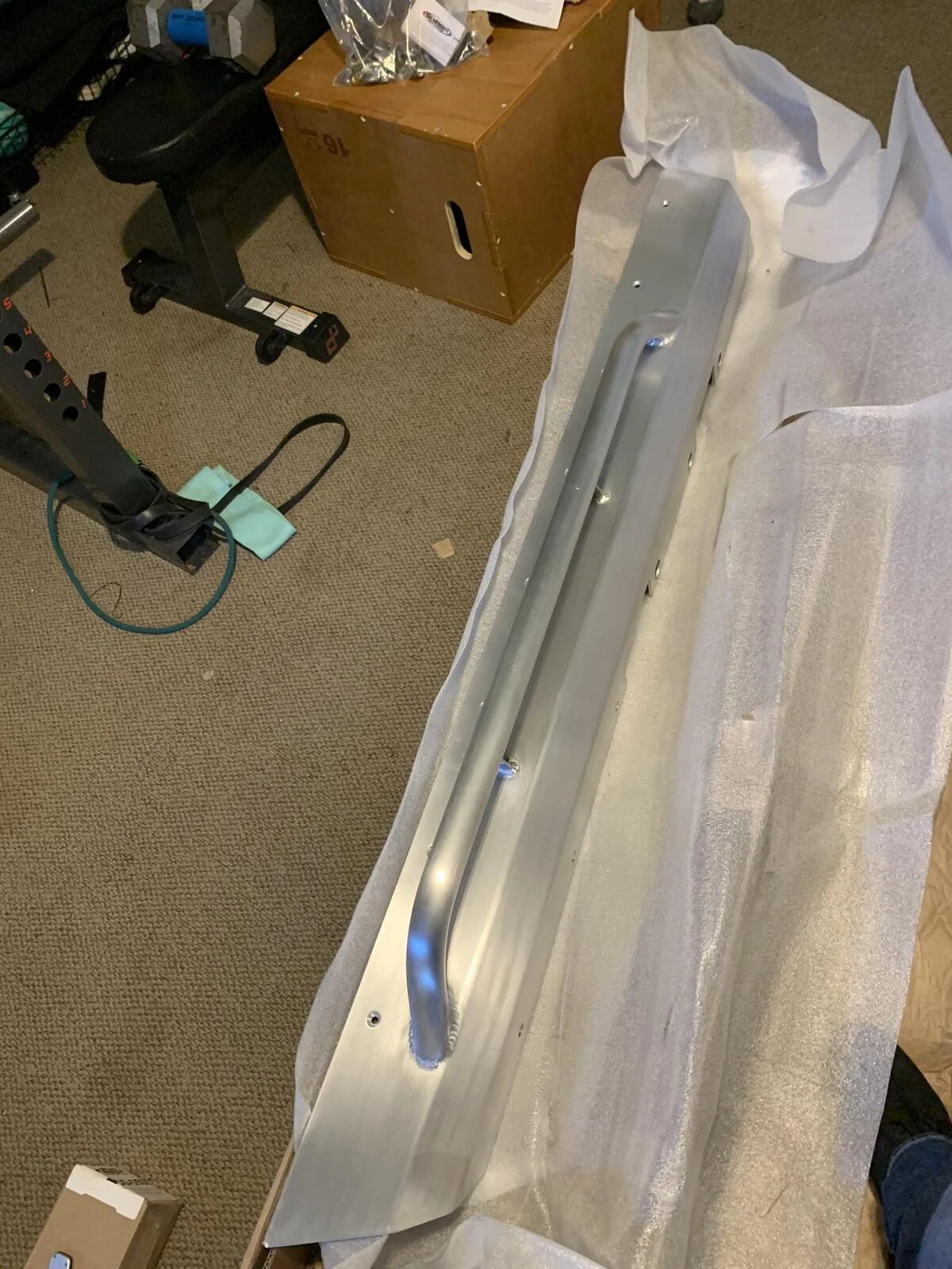

Coming soon.

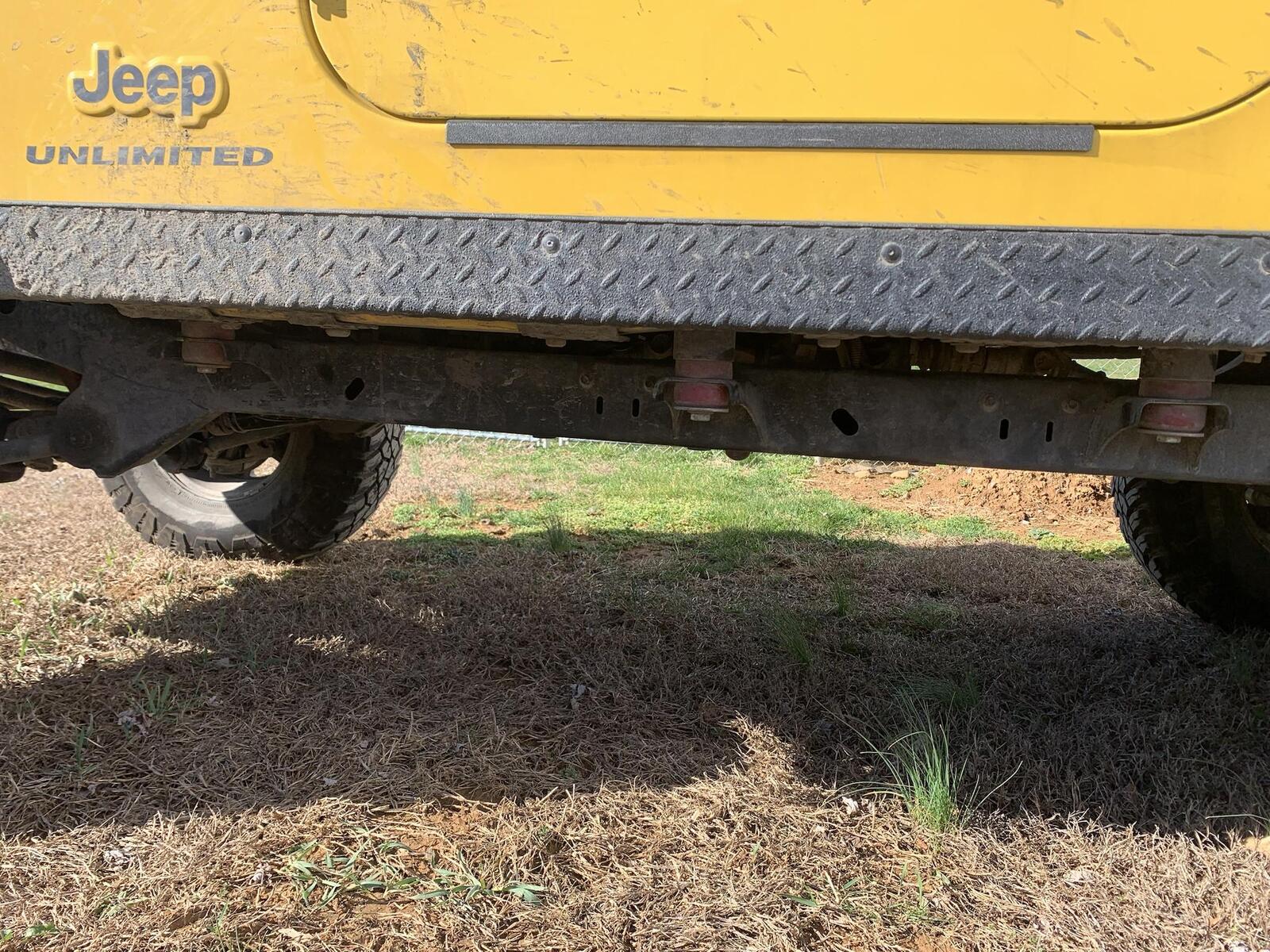

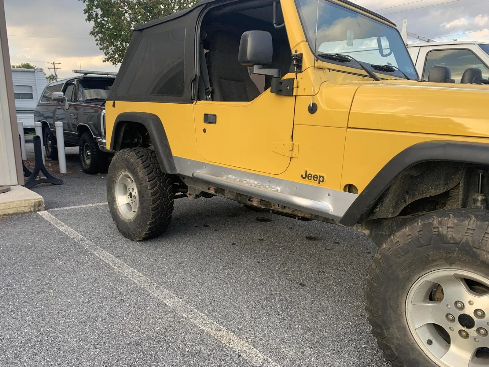

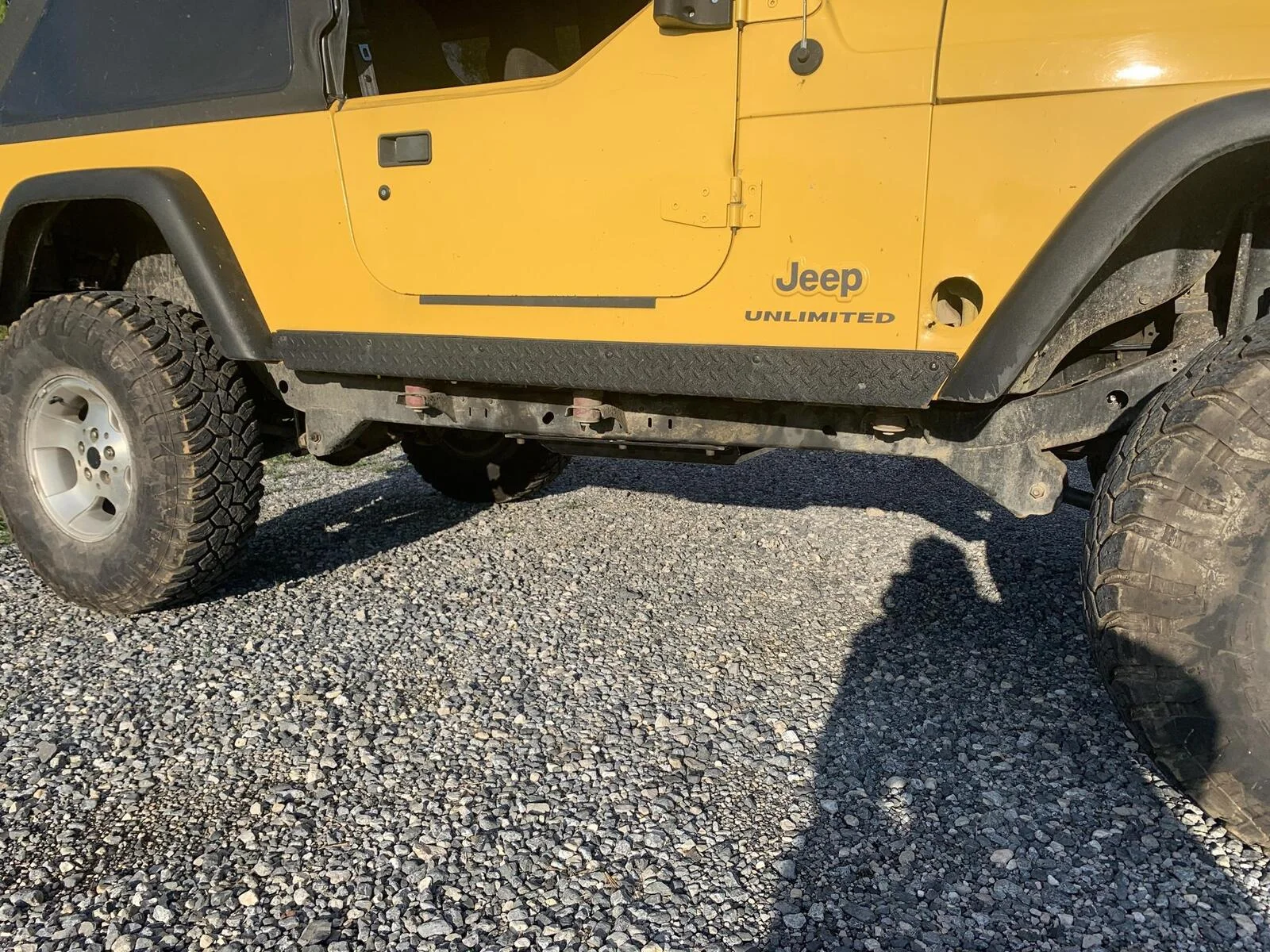

The jeep needed inspected so I took it back to the shop that did my exhaust work and I had them install the sliders since I was going to be away for work. I need to trim the flares but we're ready for the trails.
really wish the PO didn't install a snorkel. tube fenders may be next on the list.
