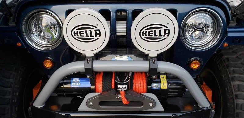

For personal reasons, I put a hold on any major modifications to the Jeep. However, I did finally get around to doing a test install of a TRE winch line, thimble, and thimble fairlead I ordered a while ago. As I suspected, when the thimble is placed on the thimble fairlead it contacts the UCF Extra Clearance bumper hoop. Fortunately, it only needs to drop down about 1/4", so I should be able to notch the two mounting holes in the fairlead mount and get it to fit.
The quality of the TRE line, thimble, and thimble fairlead is exceptional. The winchline even came with an attachment plate, attached to the line, and new screws to attach it to the drum. I went with an 85' length rope, which is perfect for my Superwinch EPi9.0 winch.

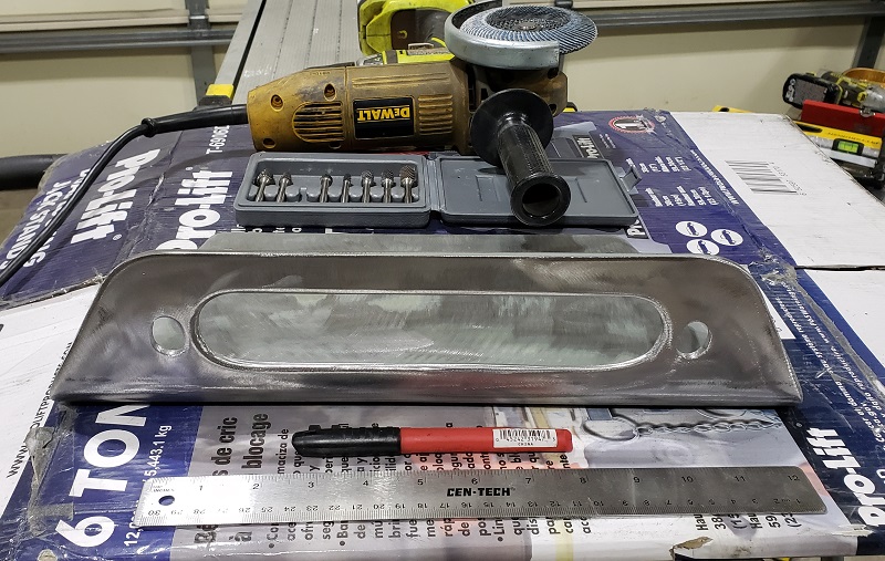

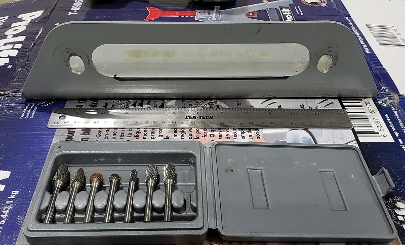

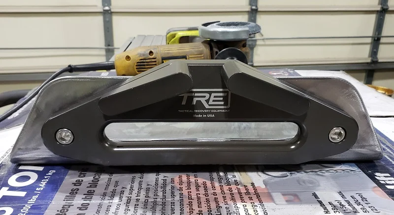

This is a case where one thing impacts another. I purchased a new TRE rope, thimble, and fairlead. When I went to install them, I discovered that the thimble wouldn't sit flat in the fairlead cradle, because it hit the hoop on my UCF Ultra Clearance bumper.
The fix was to elongate the holes in the winch plate and drop the TRE fairlead down 1/2", which I did. After doing this, I was able to get the thimble to sit flat, clearing the bumper hoop by 1/8". Now, problem #2. Since I lowered the fairlead, the winch plate opening for the rope was sitting about 1/8" to high, which meant the rope would drag across it, causing excessive wear. Next, I had to remove the winch, bumper, and winch plate.
I marked up the mount
Then went to town with a 40 grit flap disk on the grinder, and carbide bits
Did a mock up and all was good

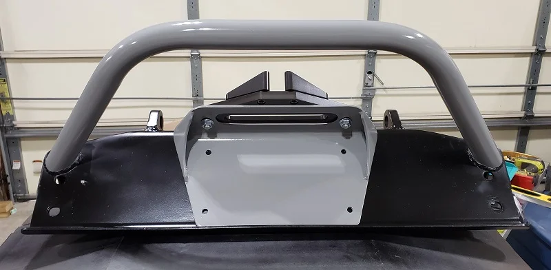

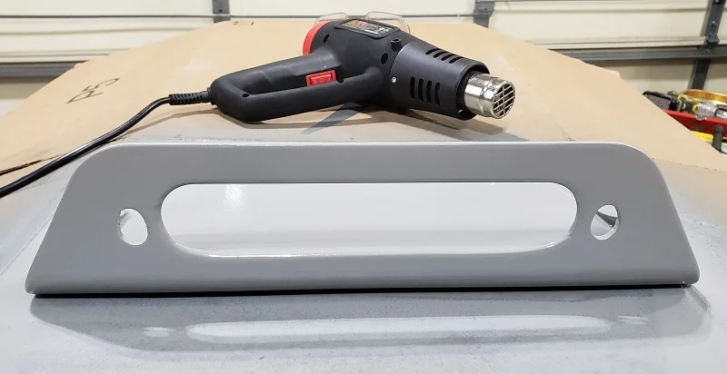

Painted the winch plate

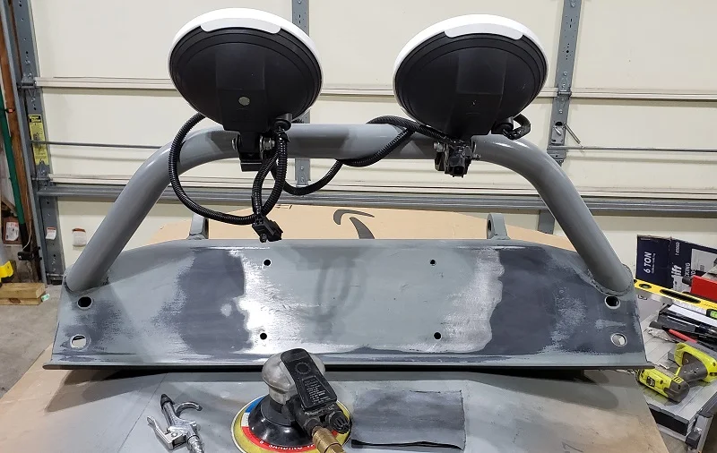

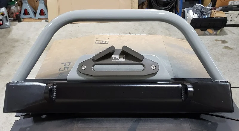

Now, I have to strip and repaint the two tone bumper. Black on the bumper and gray on the hoop

What was the heat gun for? To help the paint dry faster?
Yep. I've only got the garage at 60°, so I use the heat gun in between coats of paint.

Finished sanding and repainting the bumper this afternoon. Definitely not my best work, but I'm learning not to be so OCD. I'll let the paint dry for a day or two, then assemble everything back on the Jeep.
