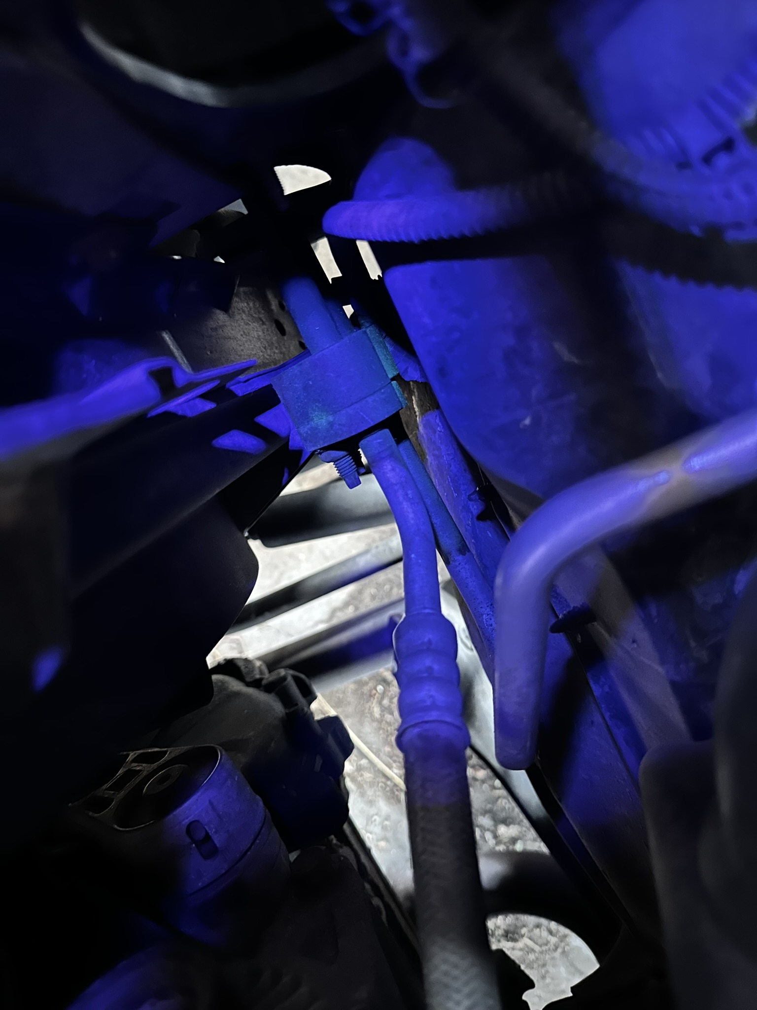

Hello again, all. When I had my Jeep in at the shop last, they recharged my AC which hadn't been blowing cold for a long time. A couple weeks later it's not blowing cold anymore. They put dye in as well so I hit it with the UV flashlight and this seems to be the only part that's glowing. Is this the liquid line or do you think it's the condenser side that's the problem?
Shine your light up from underneath. I had the similar leak after replacing the liquid line due to the charging port leaking/cracked and I found my condenser leaking where the tube goes in the block. I found it with the uv.
