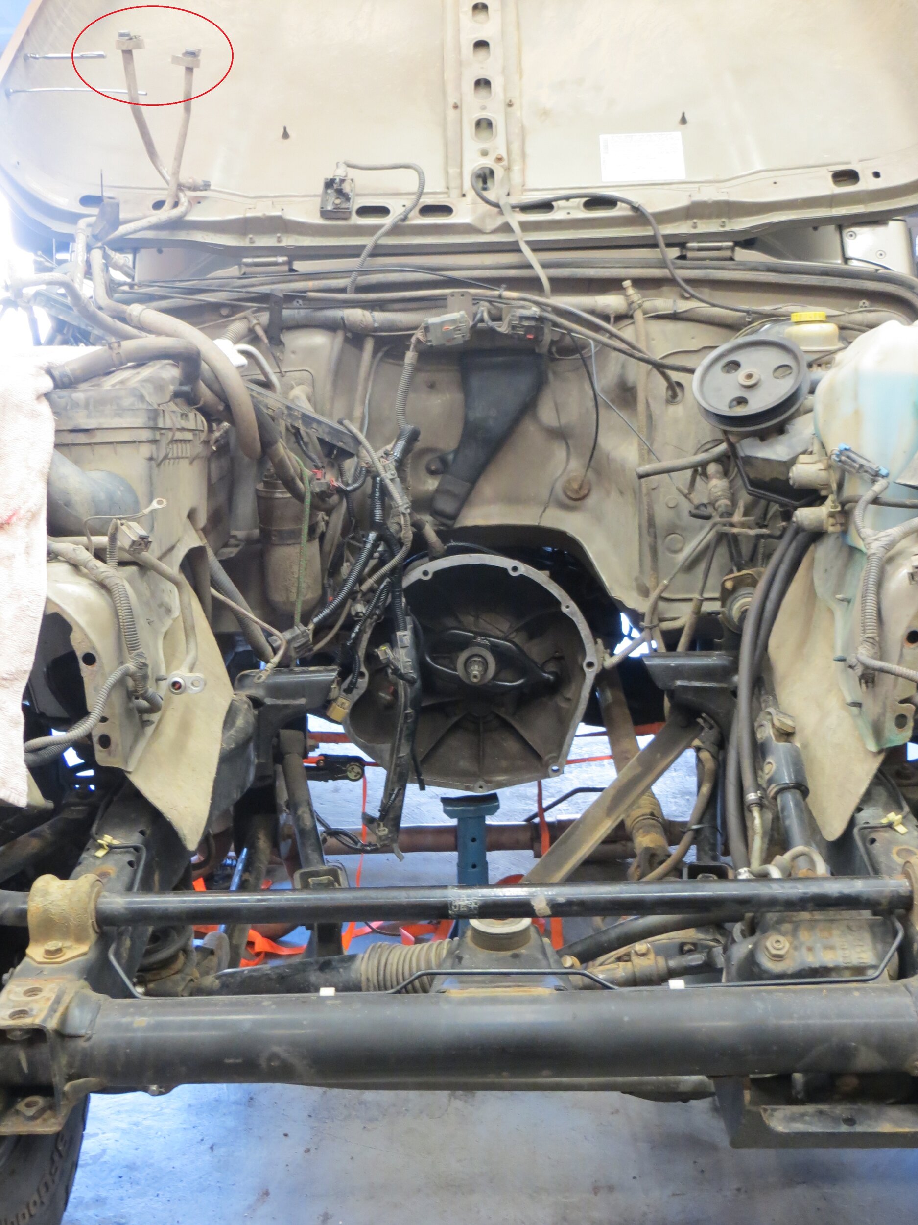

Great question. Being the professional I am/was :) I used the Mopar approved storage location...
All kidding aside - During the engine replacement, the system was open for a solid 4+ months and the lines were in this position and uncovered (amateur move on my part for sure).
My research showed that an open system for that long means the most critical part to replace is the Accumulator, hence grabbing a new & sealed one already. But I only recently also saw advice on the orifice tube and the valves.
Open to ideas if more work or parts need to be inspect/checked.

I would rotate the compressor by hand and see how it feels. If you can put a little oil in the compressor and rotate it around to get the internals lubricated. If it’s locked up or feels very rough the compressor will need replacing. When you remove the orfice line, pull the orfice out and look for debris in it. A Lot of metal would indicate a failed compressor, sand would indicate a desiccant bag failure which would require flushing the condenser. I would also change all the o rings in the system. Add an oil charge to the accumulator, evacuate it and test the system.
