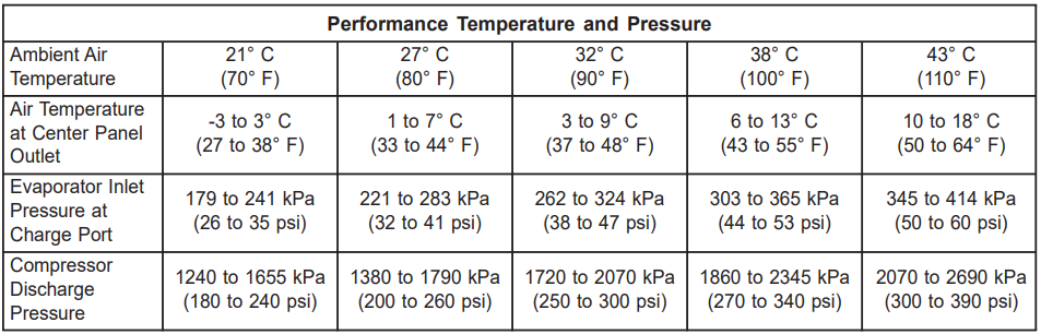

Low on refrigerant, which would mean a leak look for oil traces at the condenser in front of the radiator. If you can get some refrigerant with dye in it you can recharge the system with dye to lock for a leak.
At 90 degrees you should be at approximately 50/250.
