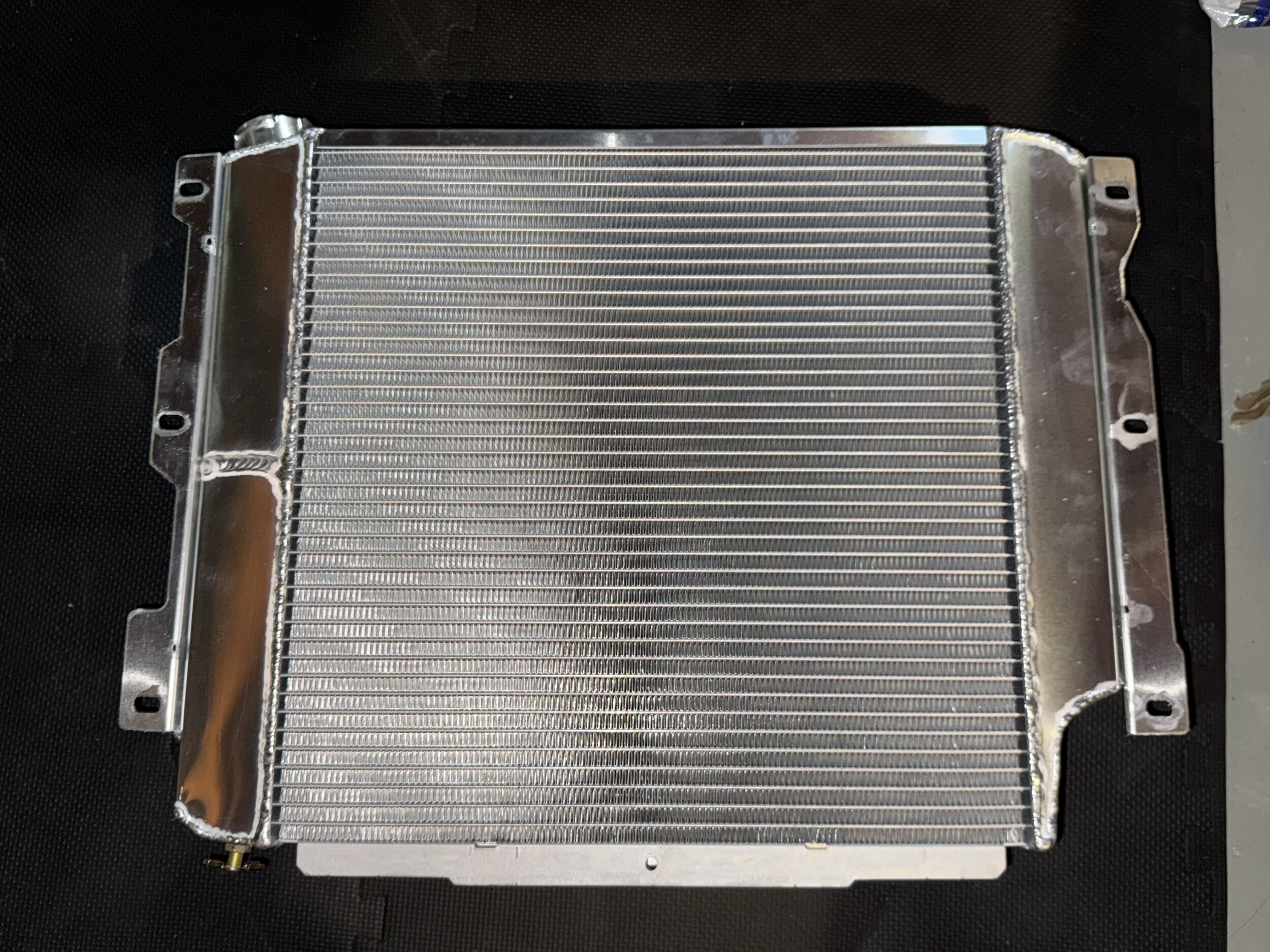

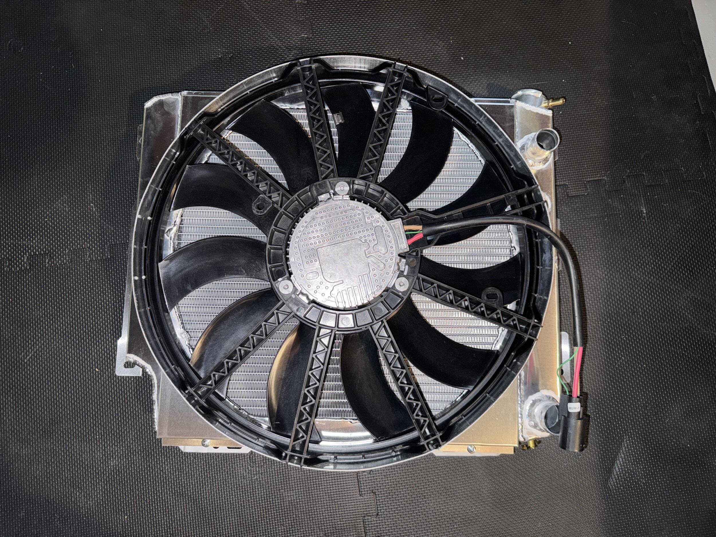

This showed up today. Definitely paid enough for it so it better cool.
Superior Radiator. It’s a 6th Gen V8 Camaro fan. Allegedly it’s the best there is.
Have you been following this thread? Some good info on the oem spal fans

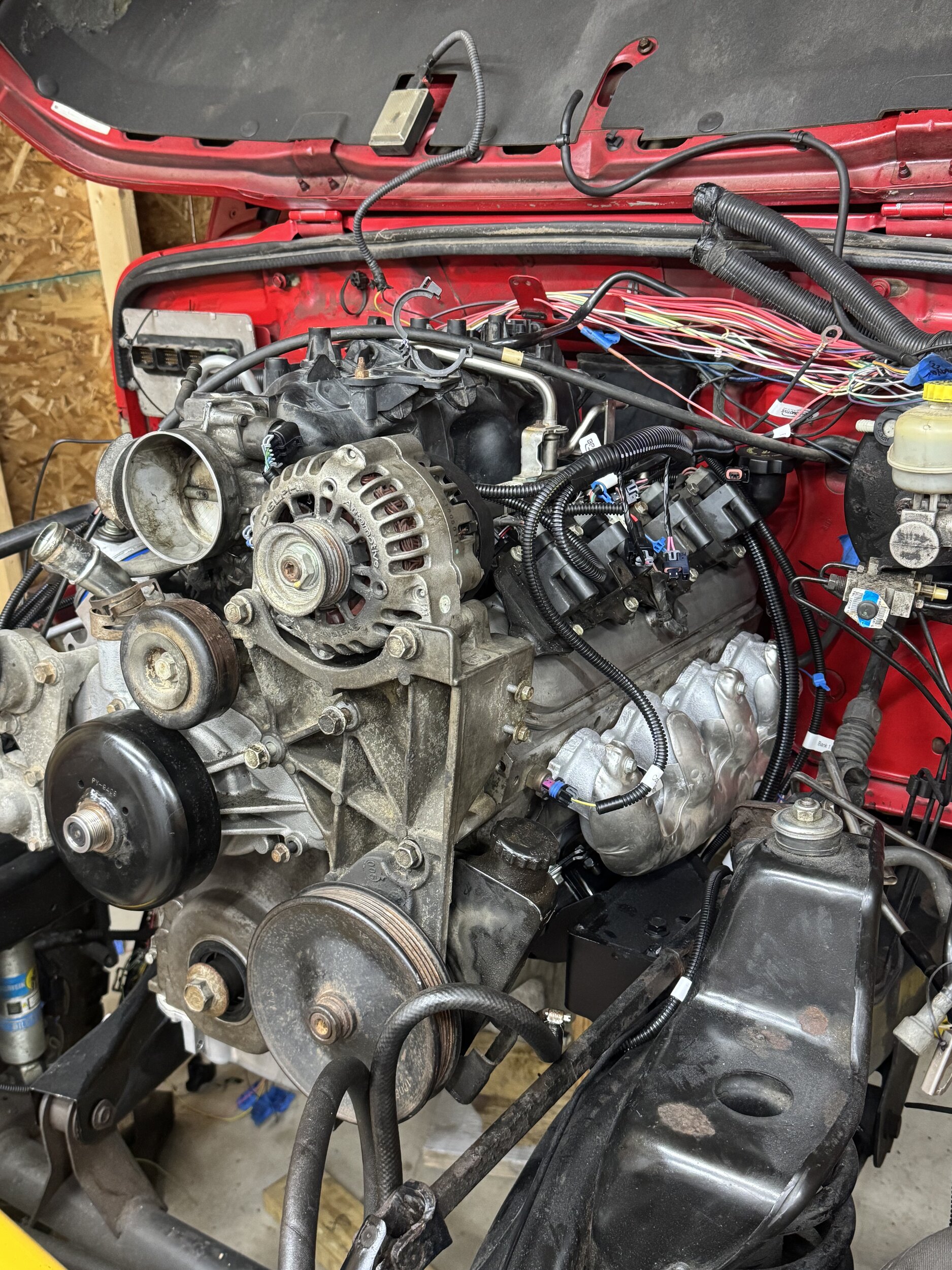

At any rate, I am getting closer to trying to start this. I am close to figuring out the tuning. New injectors are in, drive shafts will likely be in this week.

As usual, everything is connected. The Duramax is gone, sold to my buddy that I got the 4.8, SYE, numerous LS parts, and likely an ARB locker from. Time to get focused back on the LJ.
A massive hangup is my lack of understanding of tuning. I have EFILive (largely obsolete compared to HPTuners). From my basically non existent understanding I was good to change from OEM injectors to another year/style OEM injector. While I was somewhat correct, I was very incorrect in one aspect, going return fuel to returnless is a much bigger issue. Perhaps I can figure it out, but it seems I may need to pay for expert assistance which I am currently unsure where to get.
I am basically at the point I need to solve this before I can proceed.

I converted my MR2 to return less, it was essentially plumbing the pump output to a housing with a regulator, returning that back to where the rail used to output, then having 1 line from regulator to the rail. What are you stumped on for this?
Fuel system is already setup for returnless factory Jeep, it’s the LS tuning.

The Jeep turns over, TCC (disengage torque converter when braking) works, every Jeep feature I quickly tried worked.
I need to determine if I switch to HP Tuners (I have EFILive, HPT is significantly more supported). I think I have the tune ready either way. I don’t really see any reason I can’t try to start this once I determine which tuner I want to go with.

If it was me I'd go hp tuners. I don't know anyone doing efilive with LS engines really. I've done multiple LS swaps and they have all been either HP tuners or swapped to Holley EFI. But a well supported system makes life a lot easier
I’m strongly considering it. It’s basically a drop in the bucket relative to how far into this I am.
