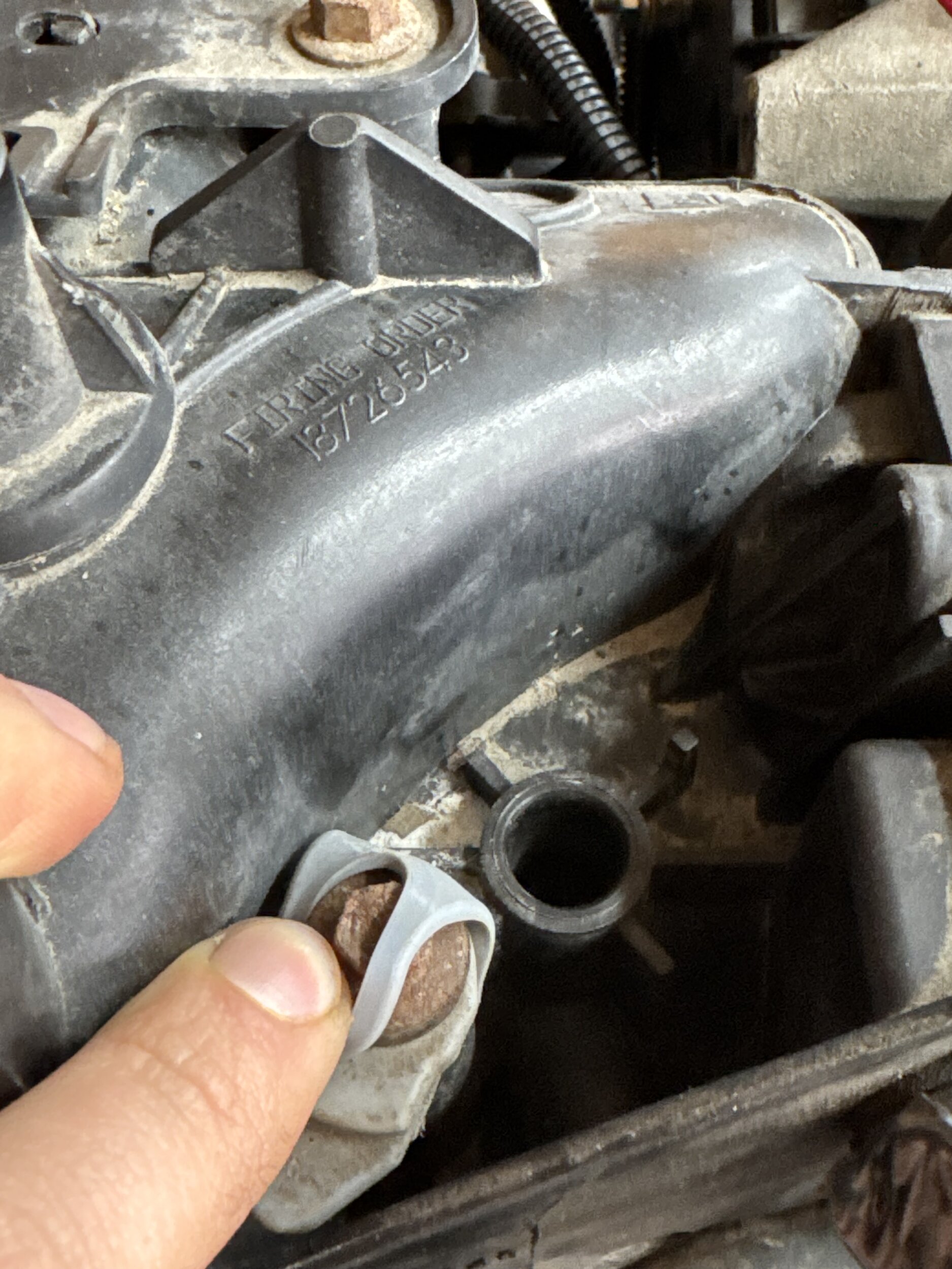

Surely this giant hole in the intake wouldn’t be causing my idling issues…

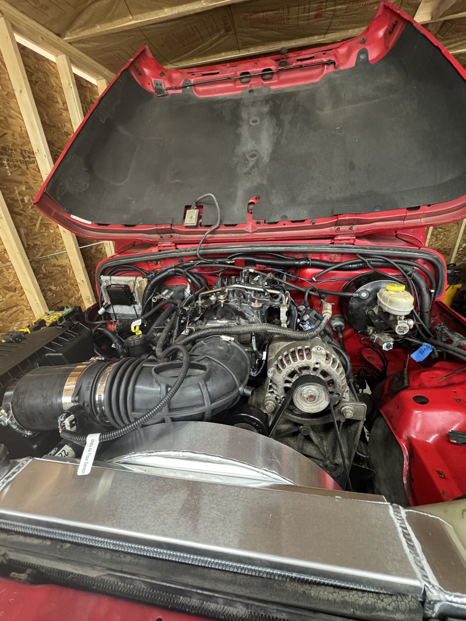

Wiring is mostly buttoned up and mostly works…🤣
