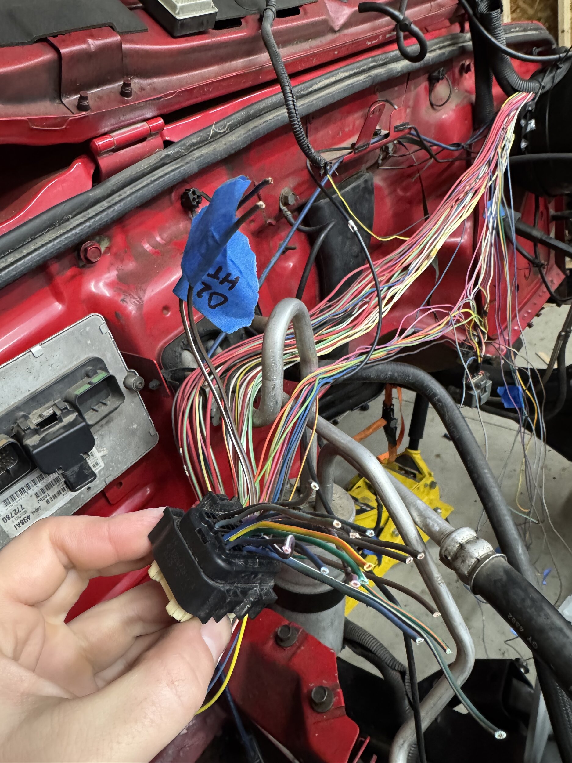

Hopefully I understand the wiring like I think I do, wire delete is in process (yes everything is labeled). Phase one will likely have a cluster of labeled, cut, and heat shrink capped wires on drivers side coiled up. C1, C2, and C3 are no longer. C102 and C103 are next to be deleted.
Phase 2 will be depinning connectors into body and cleaning up.

Nice man. Really gettin' at it. This is the scariest part of a swap for me by far. I wussed out and paid someone to do it
