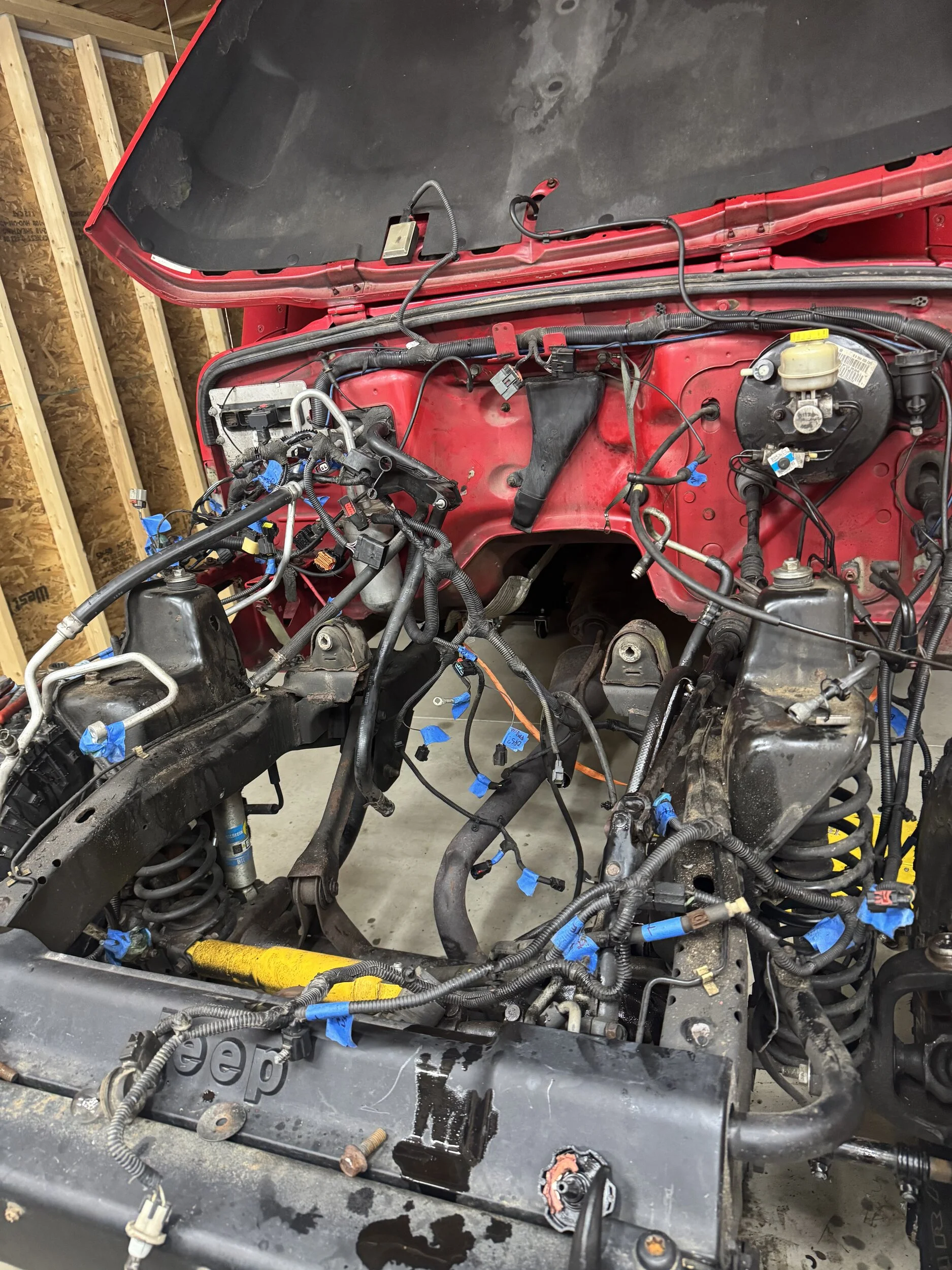

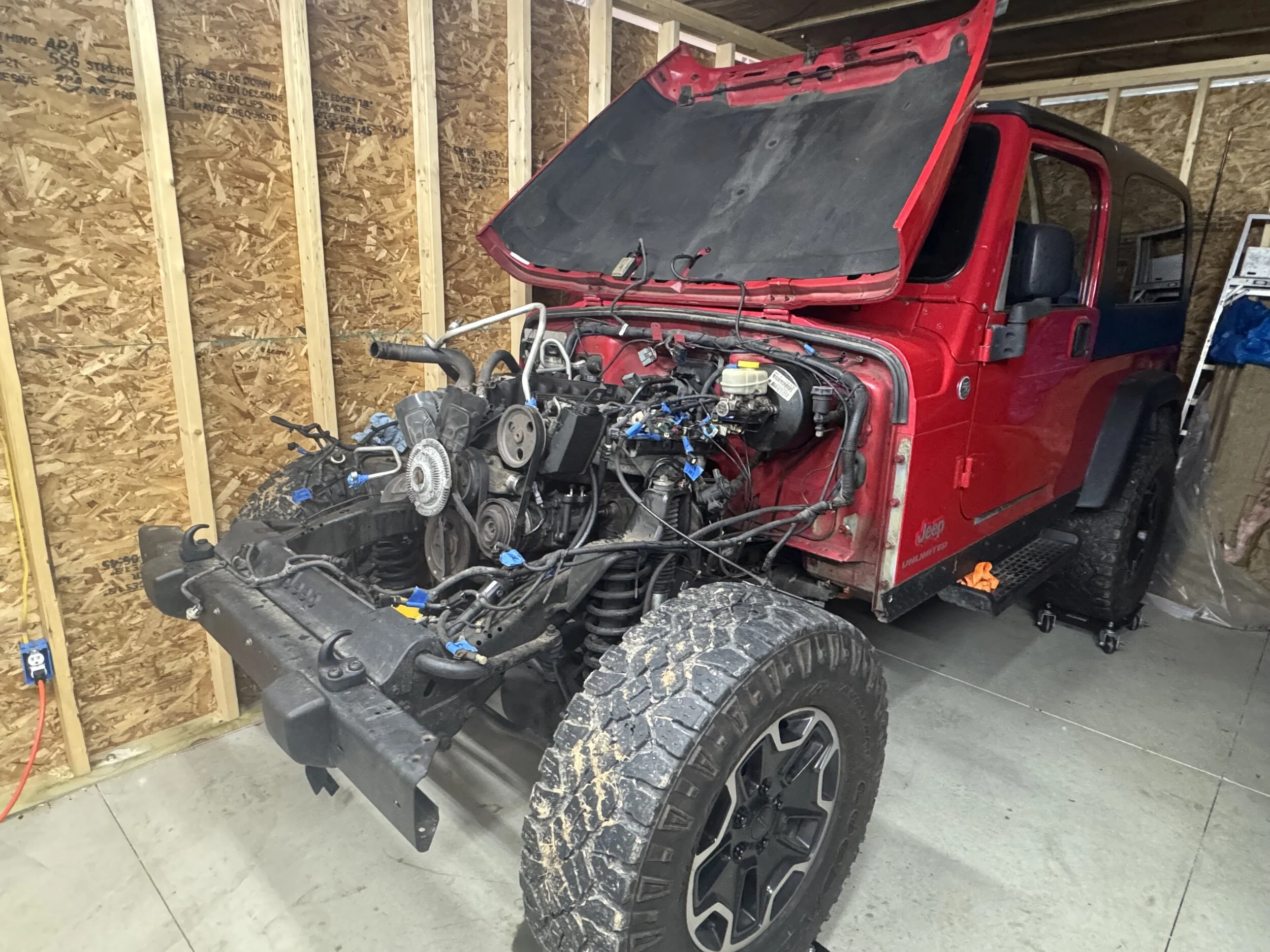

I pulled the fenders, grill, and transfer case today. I have almost everything I need disconnected and labeled (actually labeled a lot I don’t need just in case).

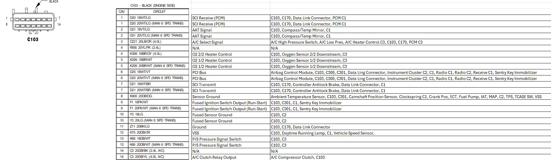

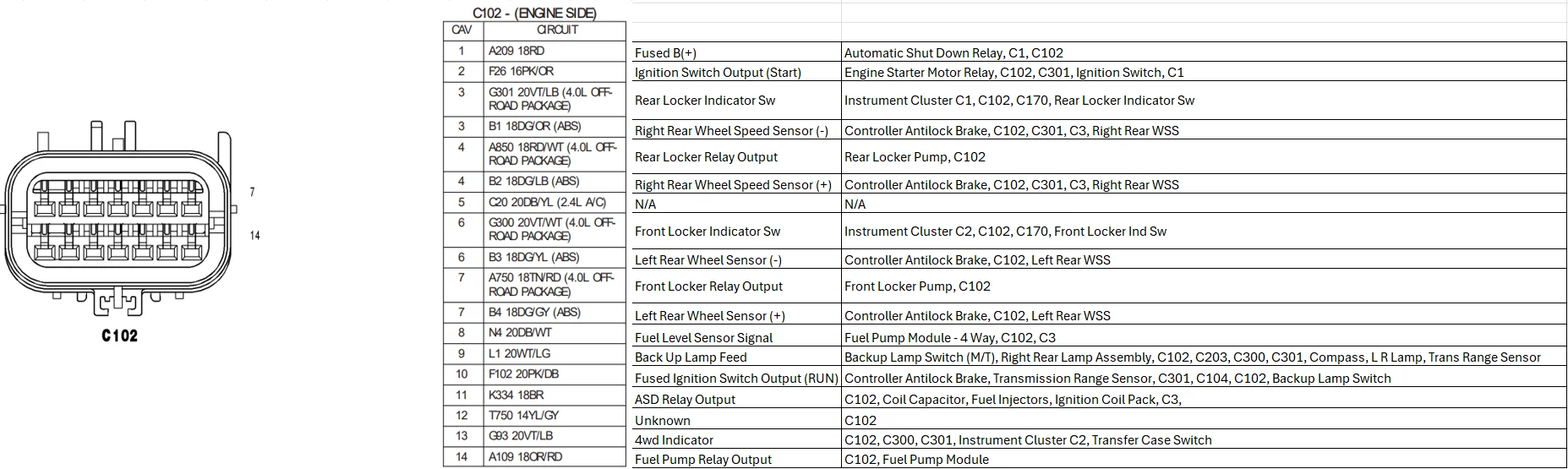

Surely someone has gone through this and labeled what everything actually does already? I want to know what goes where before I start gutting my factory harness/ECM. I need to get rid of a lot since I will run aftermarket gauges.
View attachment 590310View attachment 590311
You are keeping your factory pdc correct? To me it makes sense to focus on the systems/circuits that will stay until you have what you need.lights,hvac,radio,fuel pump(?),etc. When you have identified everything you'll keep and how to energize their relays without the stock pcm it will be easy to strip stuff like o2 sensors and auto trans.
Using the ignition switch to activate a relay would be an easy way to have a switched ground supply in place of the pcm

It uses grounds to control the injectors & the replays plus a whole bunch of other things.
All of this is one of the reasons I & others suggest a Magnum for the 97-02 & Hemi for the 03-06 rigs & then if you're going to do the LS you do like @Apparition is planning to do & that is to remove most of the stock electrical.
Reading the Jeep FSM schematics is harder than others. You can get wiring diagrams from AllData offers better ones on some vehicles.

If you are ditching factory gauges, you pretty much don't need any of the factory 4.0 engine harness. I run factory gauges and the Jeep harness and PCM is pretty much only for the gauges and I used it to control the fan for AC purposes only, but that can be run other ways too. My fuel pump, PCM power and cooling fan is controlled by a standalone harness PDC and I left the starter wiring alone except for adding a ring terminal at the end of the wire.

I wouldn't toss most of the electrical,just consolidate needed pcm triggered grounds onto an ignition triggered relay.I'd ditch the ASD crap and then decide which circuits I can trigger with a ground and which with a positive. By tapping into the PDC relays to power the body and fuel pump it should come out looking clean.
Basically cut off the head and leave the body. Then find simple ways to turn on the heart etc without needing to totally rewire. That way schematics are still useful.
Thankfully the engine harness will just be b+,b- and switched b+. Depending on what he buys it will control the fuel pump circuit and a few other things as well.

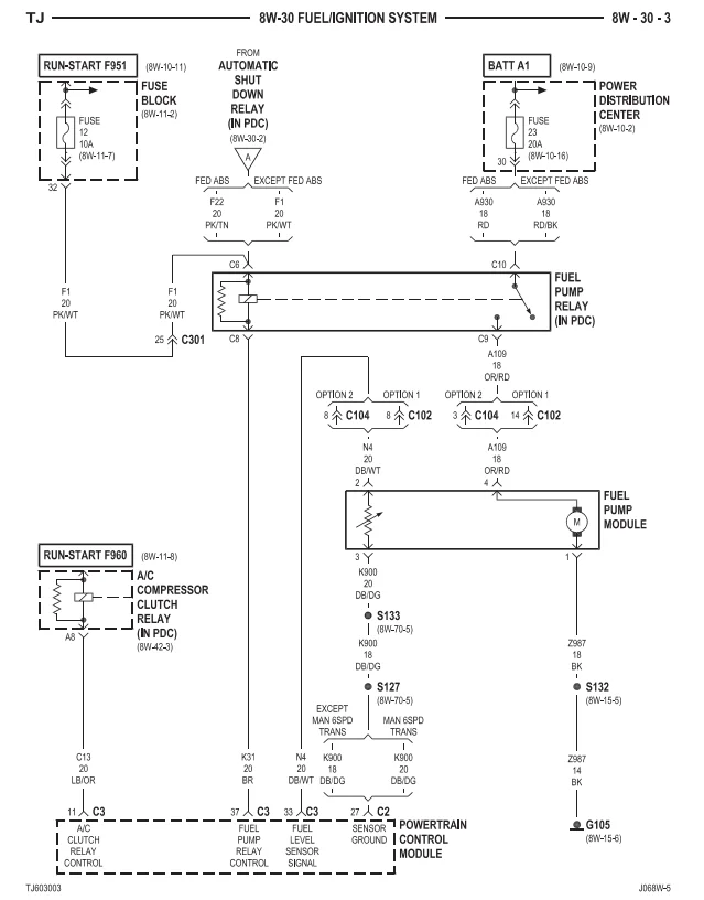

So based off what I’ve read K31 (C8 on relay) is ground. What I am failing to know is how I would know this is a switched ground from PCM besides there is no other ground shown to Fuel Pump Relay. C8 is fused power from inside panel, C10 is battery power, C9 is sending power to pump.
If a ground like that goes to the pcm on the actuating side of the relay you can be sure the pcm is switching it. Otherwise it would have no way to function.
