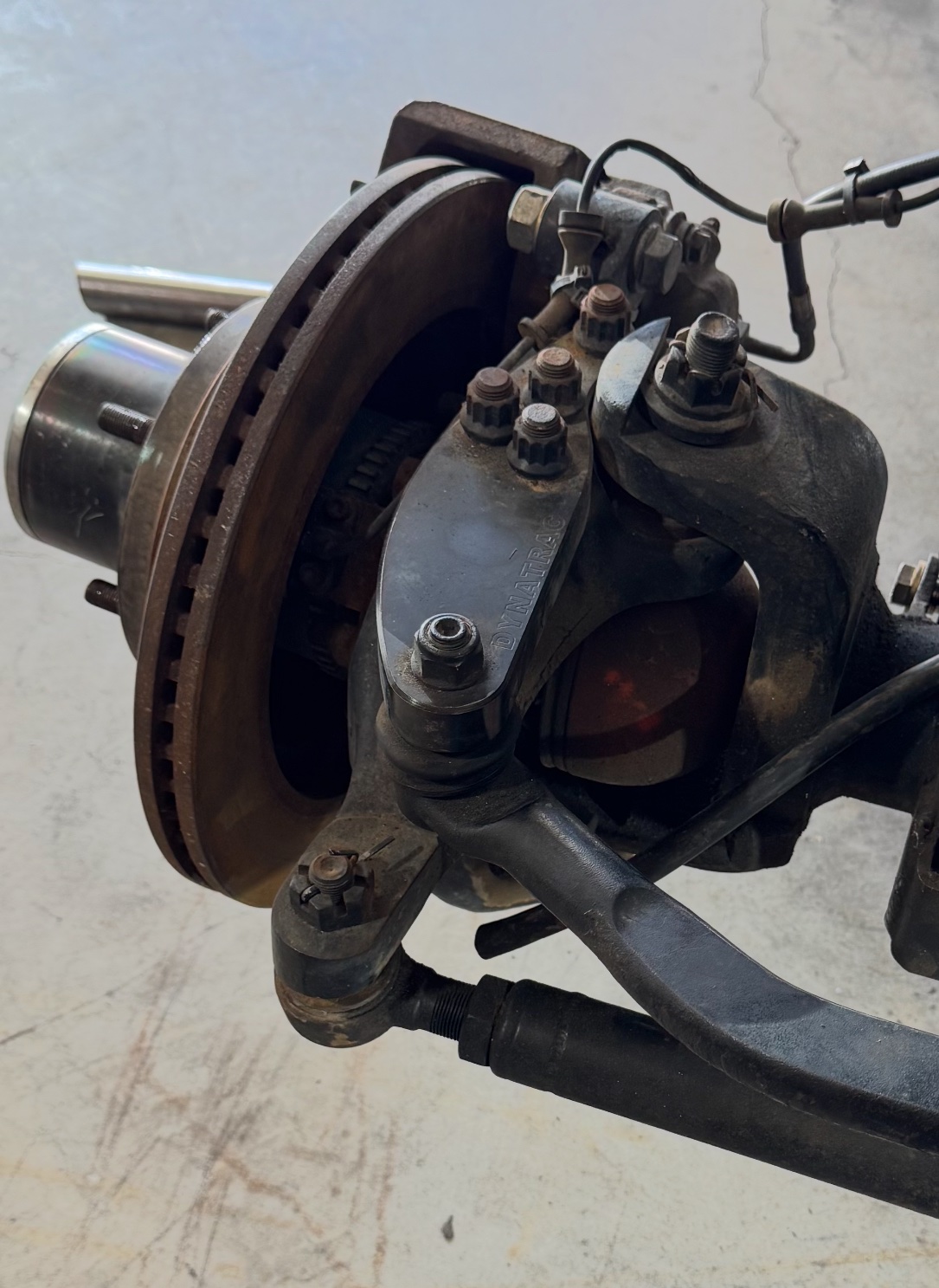

Almost done adding a front Dynatrac HP60 to my LJ. The axle was adopted from a parted out JK (65WMS). Ive got it all pretty much done with a Clayton 3link/ORI/single ram assist.
I just need to find a decent doglegged draglink to connect the 60 to my psc big bore box (SG400). At center the tre to tre is 38”.
Or come up with a steering arm and straight DL kit option.
Trouble Im having is:
Any thoughts or insights are appreciated.

- The current dynatrac drag link is dog legged, 3" too long, and has a JK TRE at the steering box side
- few vendors list the actual length on their site, most bolt-in-able drag's Ive seen like this are going to be too long and have the wrong TRE

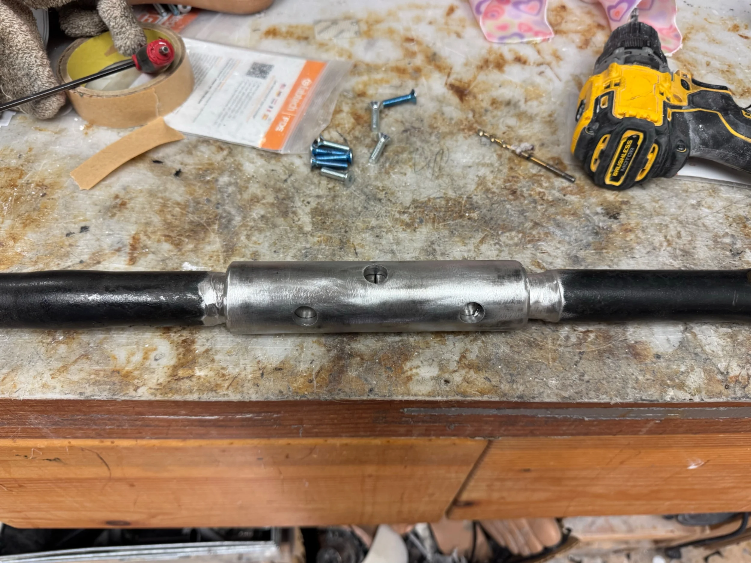

- I could build from this one, cut it and sleeve, and change out the pitman to accept a JK TRE. How much load does a DL really see in a hydro assist setup?
- I could build a straight arm kit (Barnes) but because the dog leg reaches rearward, a straight arm would induce an unwanted rearward angle. So I'd have to change out the steering arm (longer) and build a straight DL (seems my best option, just more work)
- and I stupidly commited to be in Moab in 13 days so I need to order from a company that ships quickly.
