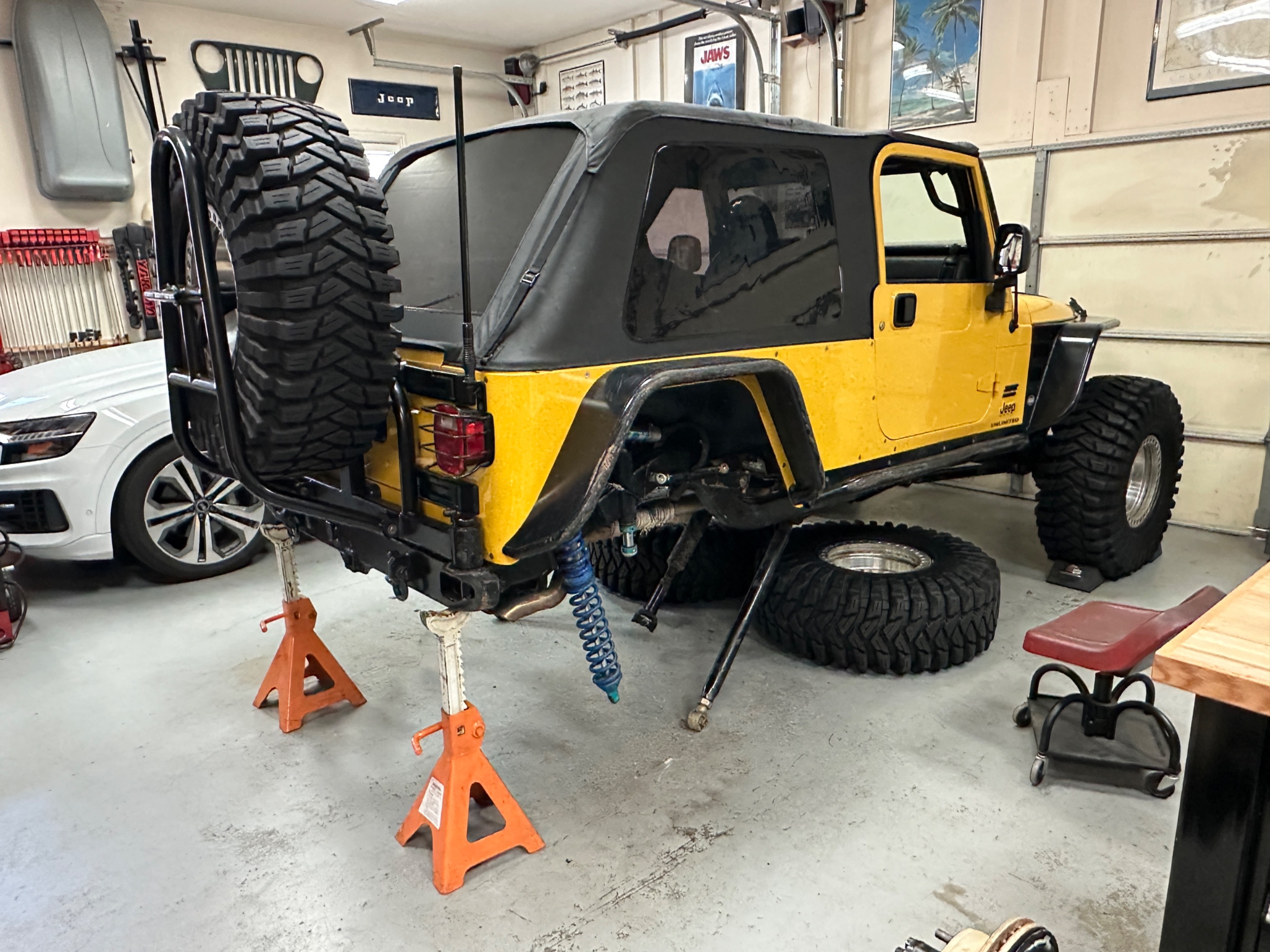

Ever have one of those days when you wake up to sunshine, in a great mood, looking forward to life, excited for your next project - and then a GM 14 bolt destroys it all???

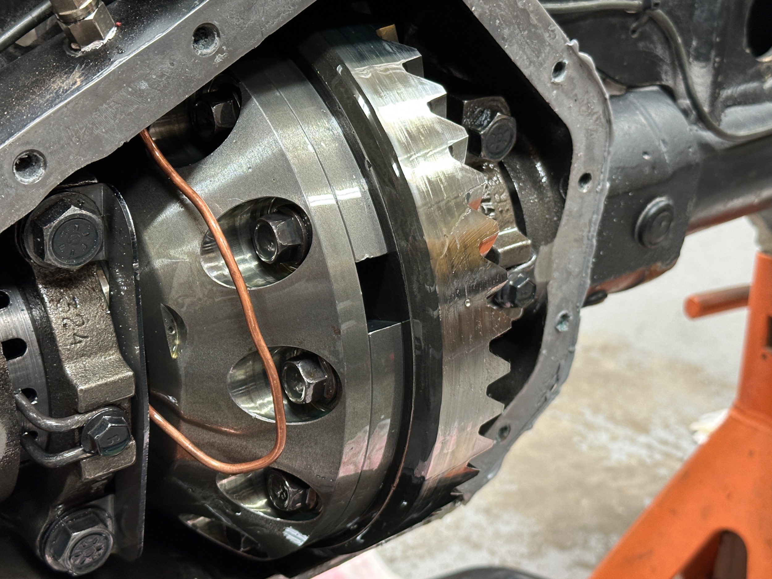

Yup. I buttoned it all up this morning and took it out for a test drive. The noise is still there. Exactly as it was before.
I wish one of you boys had told me to go ahead and install the new ring and pinion...
Oh, wait...
:oops:
To double check, I got under there once again with a mechanics stethoscope, and the only place I hear the noise is at the diff. The transfer case is fine. The spindles are fine. Also, since it's crazy easy to do on a sissy 14 bolt, on a whim I pulled the passenger side axle shaft and installed my spare shaft. No difference there either.

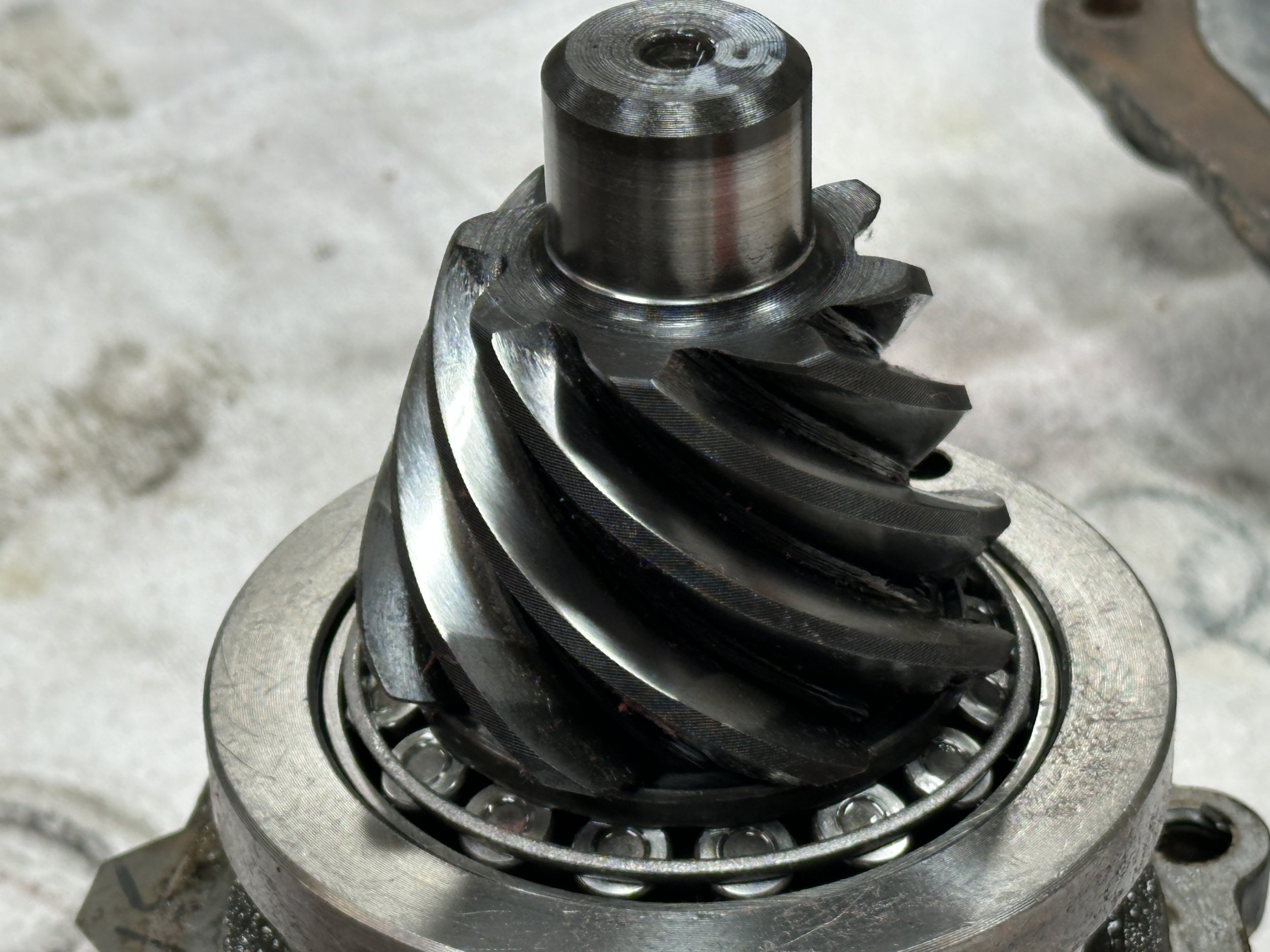

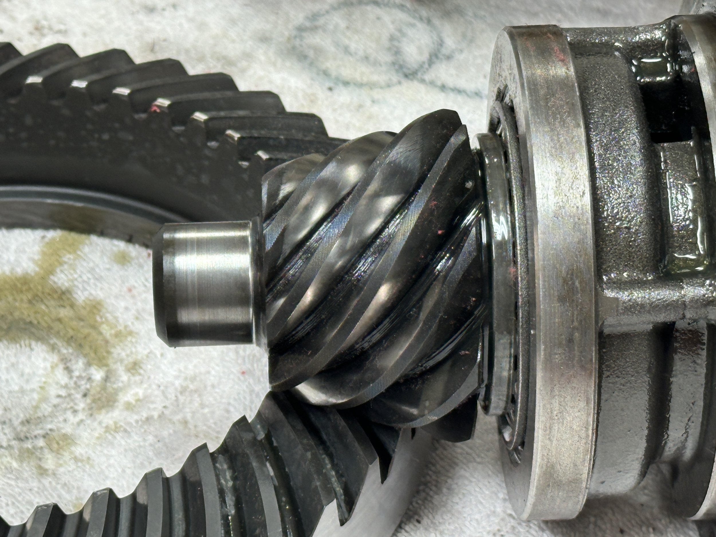

So I guess the R&P is my next step. At this point I can't imagine what else it could be.

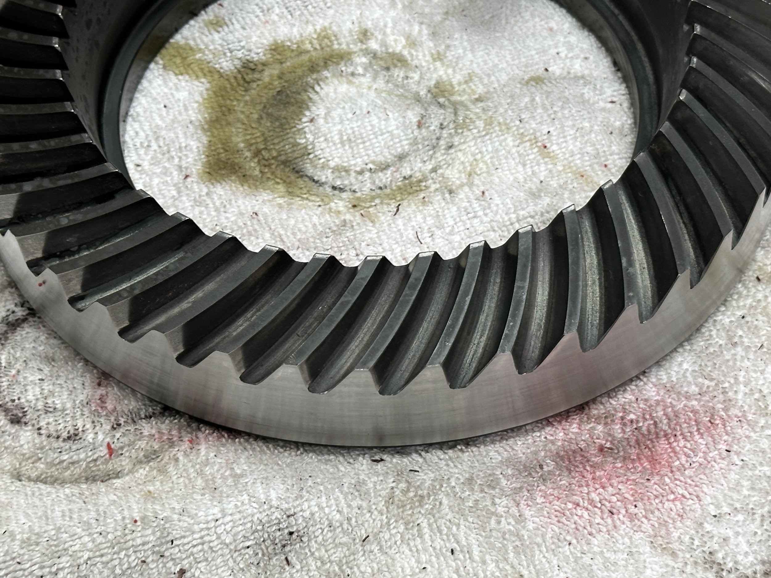

New bearings. I thought about the backlash, but I don't think that's it. It's still in spec - which is 3 to 12 - just on the low side. When I set it up last year it was 5 thou, compared to the 4 I did this time. I would think if it were too tight on a good R&P, the noise would be more even, and not pulse perfectly with the rotation of the axle - as if there is a bad spot on the ring gear. But again, I'm just guessing.
When I say the noise is exactly the same - I mean it sounds exactly like it did before swapping the locker. No change at all. I know because I paid so much attention to the noise before. The only thing that is left is either R&P - or the axle housing is bent. And on a trussed 14 bolt that's unlikely, but possible. I'll check it again when I pull it out. There was so much slop in there from the failed bearing journal, I can see it damaging the ring gear. Again, just guessing though.

Looks like R&P it is then.
