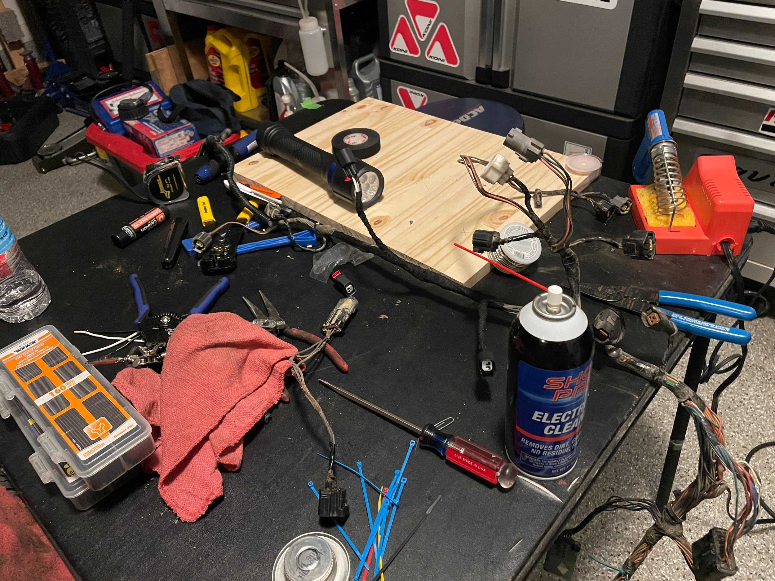

Waiting on a few replacement connectors for the wire harness rebuild project.
There is a GOOD chance that the wiring colors on the pigtail won't match your harness, so be intentional as you splice in the new connector.

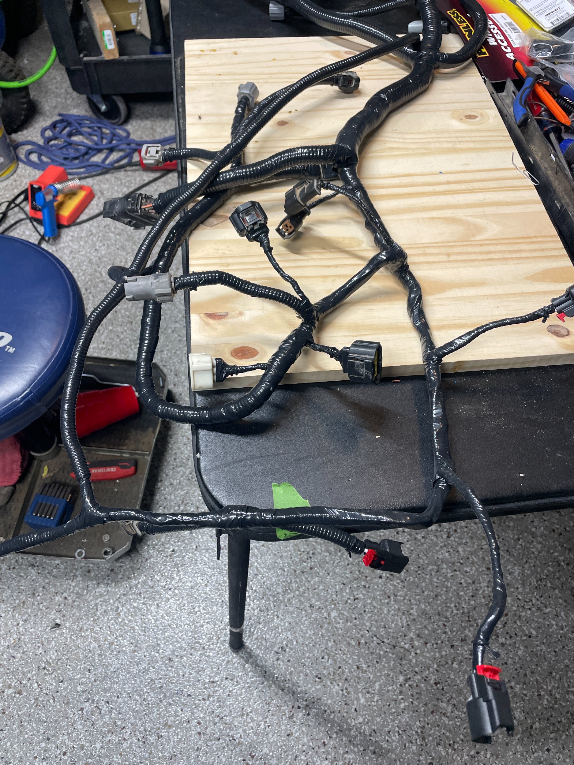

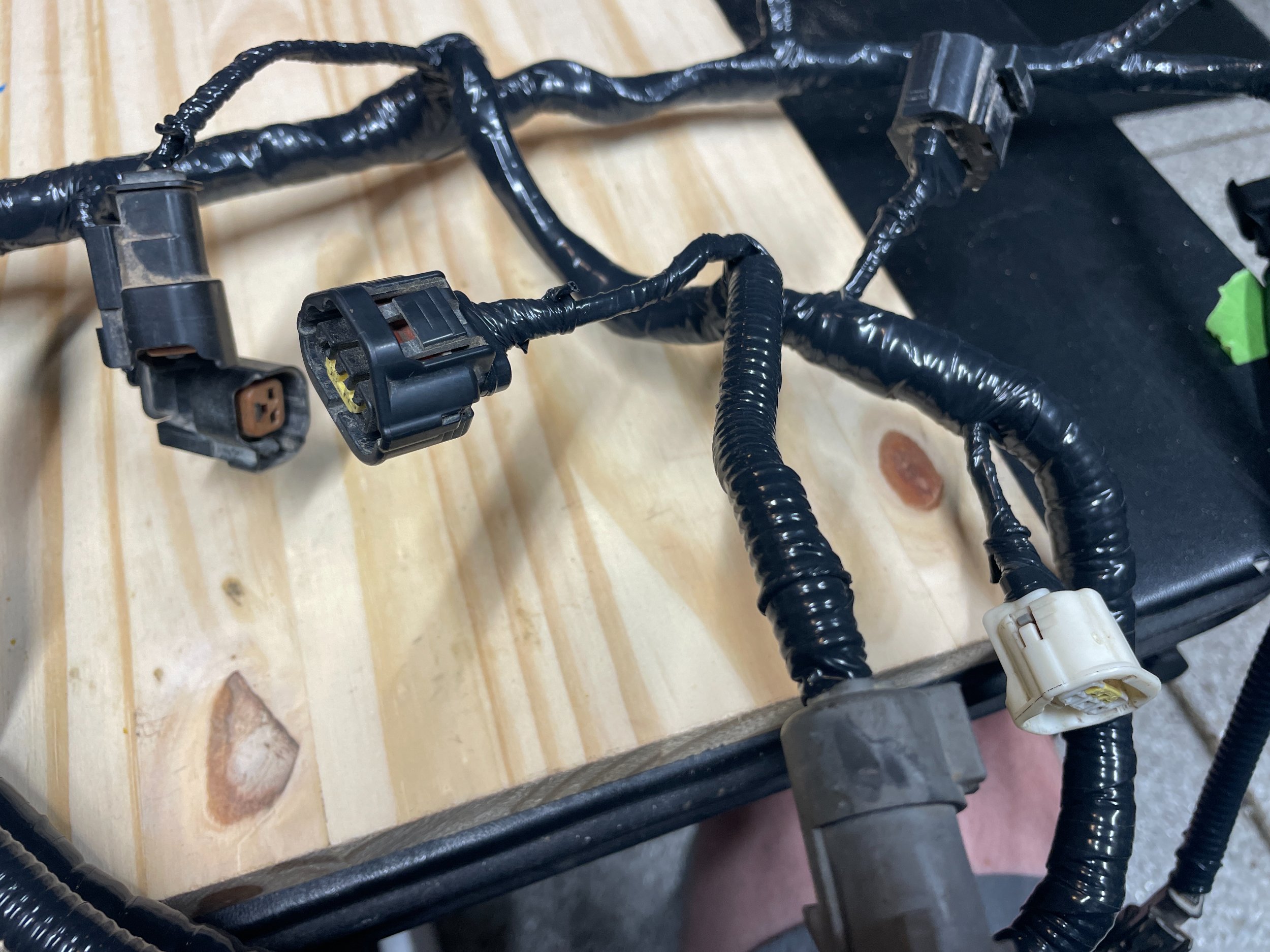

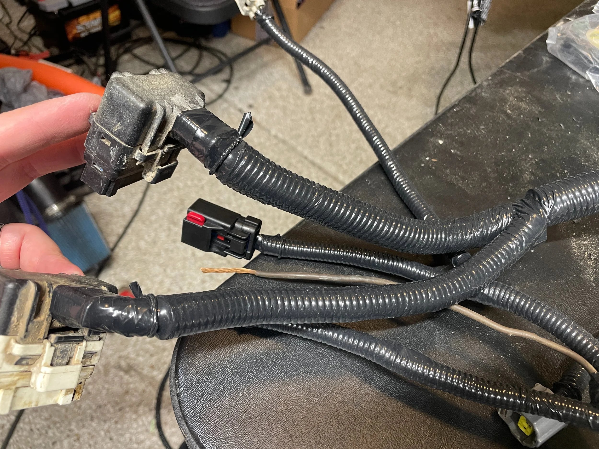

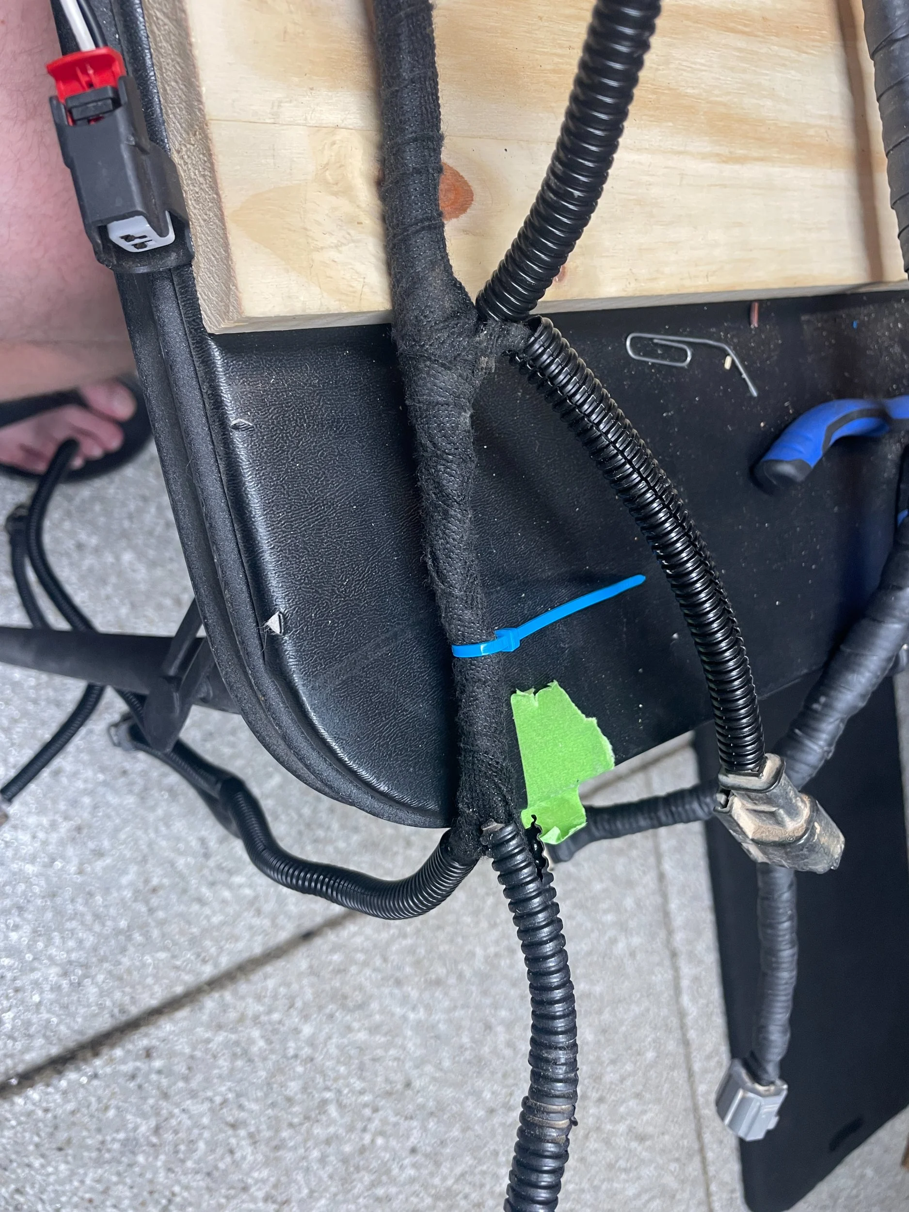

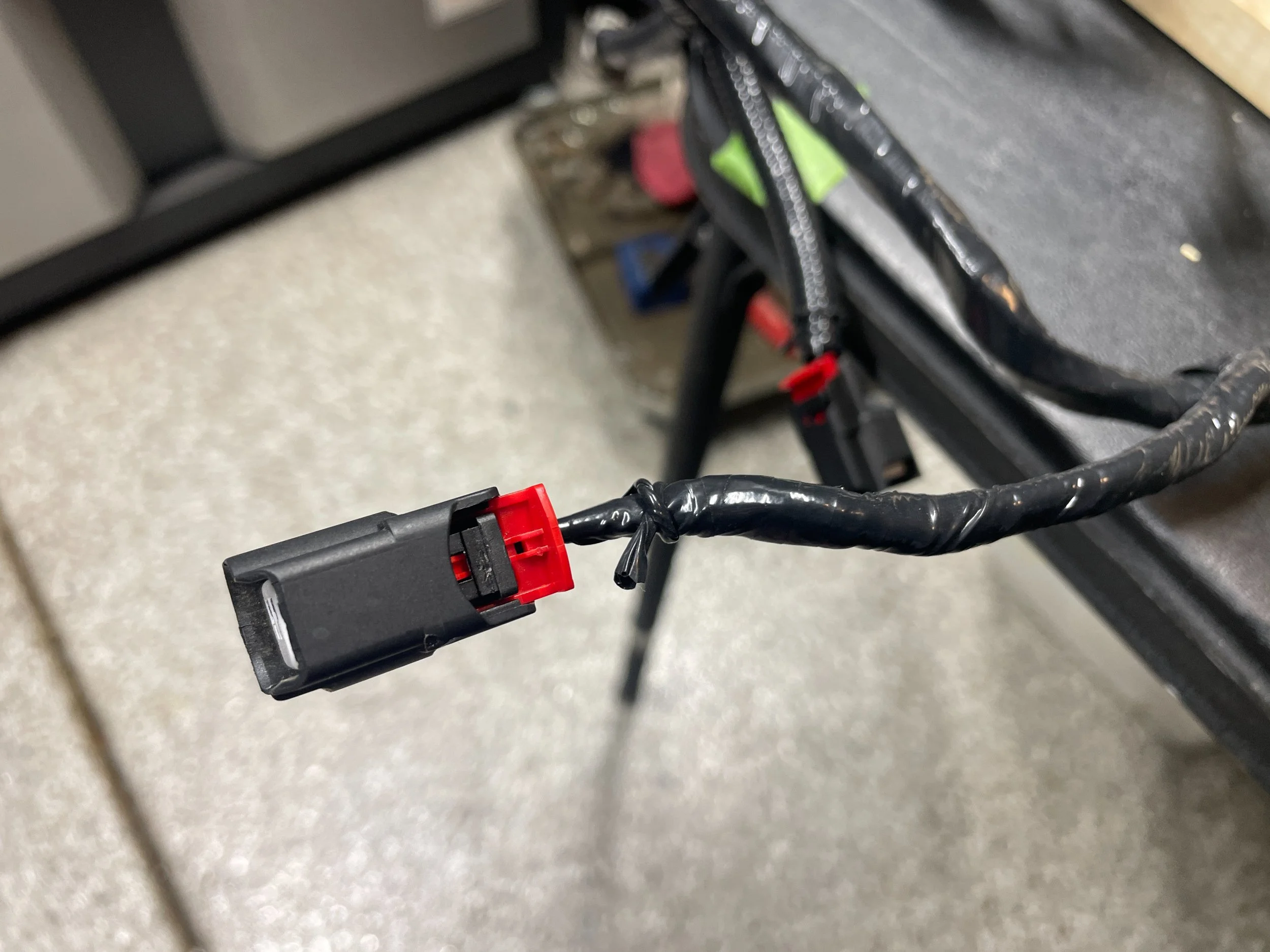

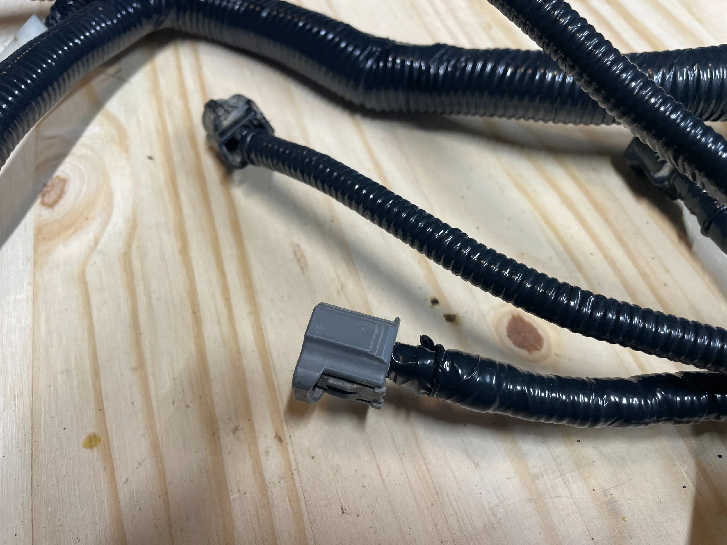

Just about done with the harness rebuild.
For tape, I settled on Red Wolf wiring harness tape for the first layer
https://www.amazon.com/dp/B0BBV3NNTM?tag=wranglerorg-20
Then normal looms as required
Then the top layer is non-adhesive wire harness tape from Summit Racing SUM-165109 in .75 and 1 inch varieties
https://www.summitracing.com/parts/...TlB5uq9tj1xtiMl_bDZ_nQrQwfSW49Jq81TBYp-O08mA7

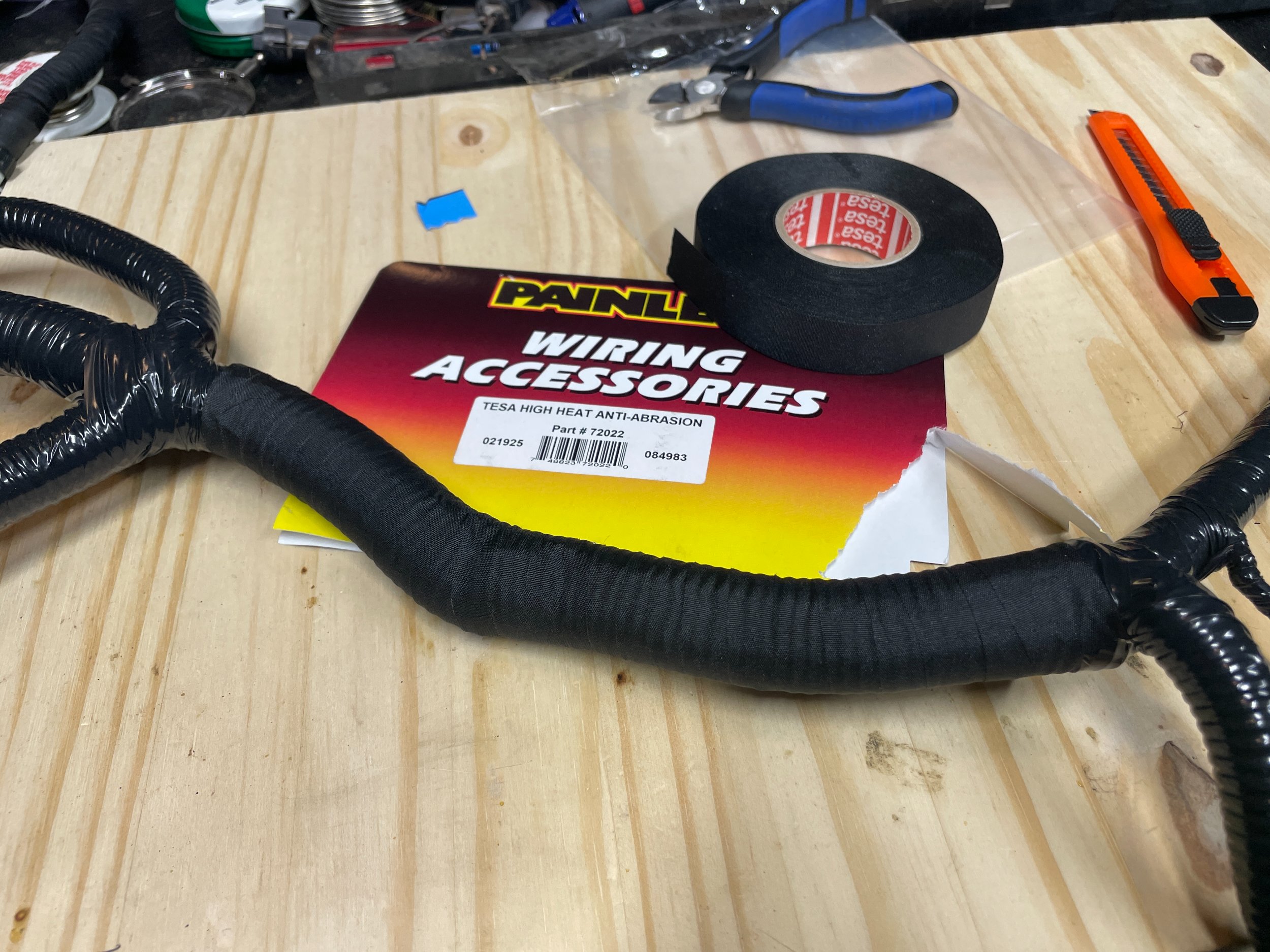

In areas that are in contact with the valve cover or other hot areas I finished with Painless performance 72022 anti-abrasion high heat tape.
https://www.summitracing.com/parts/prf-72022

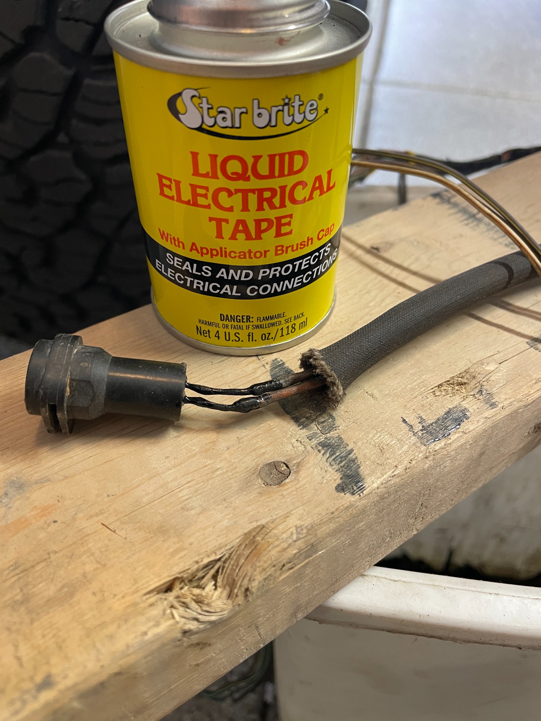

I used liquid electrical tape for connections I could not put shrink wrap on, or other exposed wires.
https://www.amazon.com/dp/B0000AXNOD?tag=wranglerorg-20

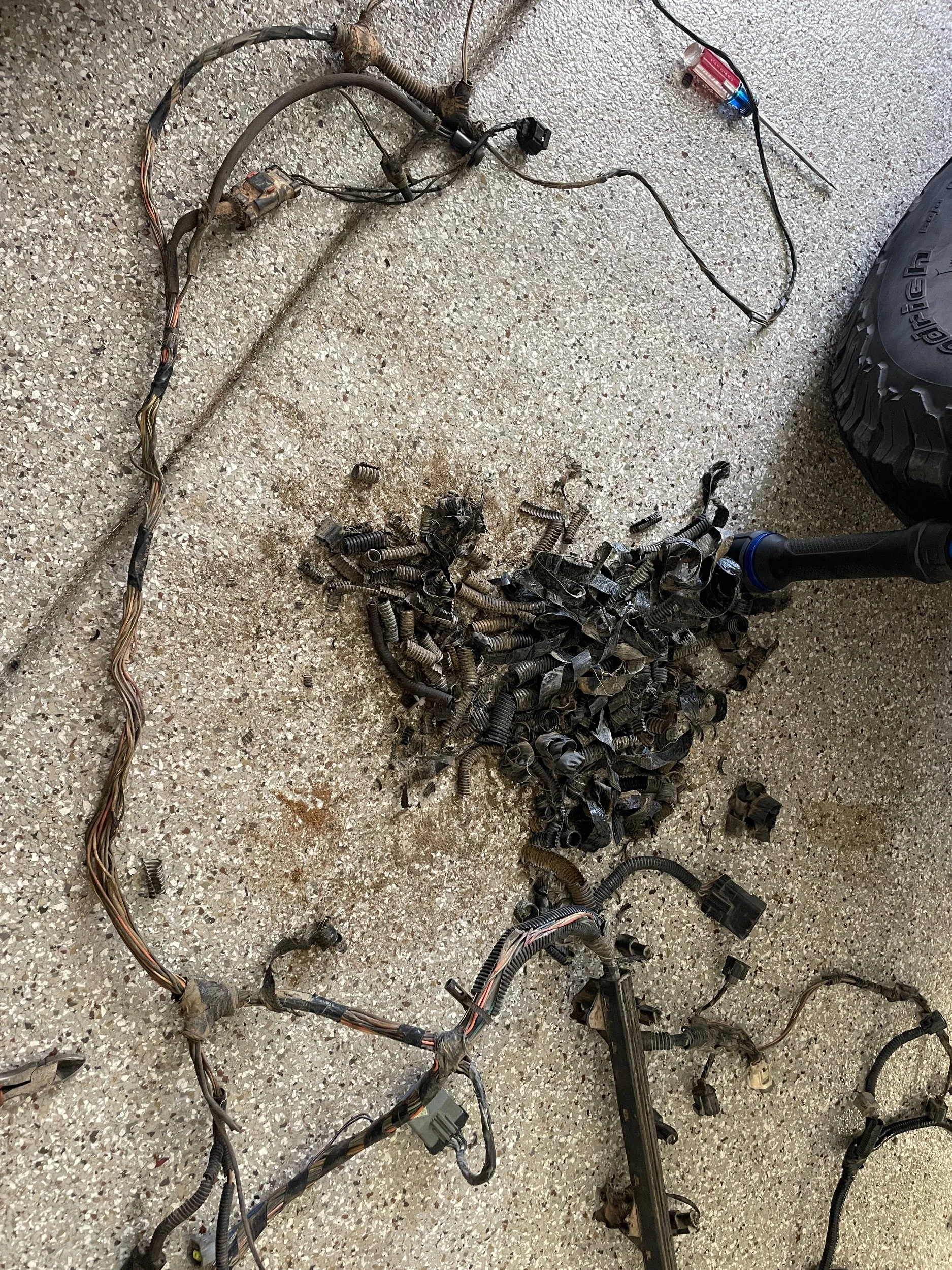

Nice work. The worst thing that can happen by pulling the harness to inspect it is that you get all new tape & loom.
