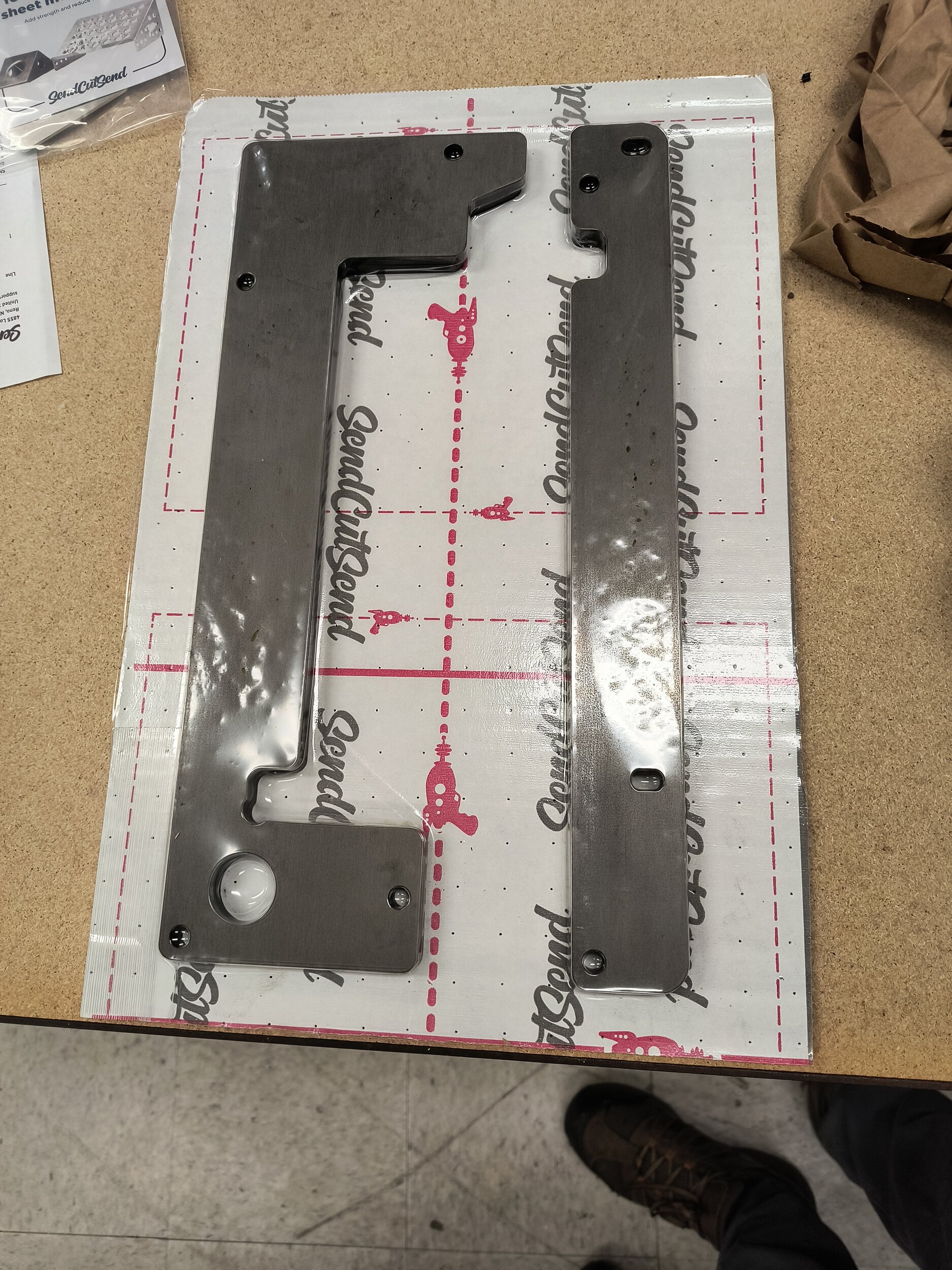

Final update, the cooper seats are in. Brackets painted.

Installed also aftermarket seat belts with the proper seat belt buckle that fits the cooper catch. (apparently there are many different sizes, the coopers are type A). My original seat belts where also end of life and would not pass inspection. Some custom breakers where needed to mount them properly at the bottom.
