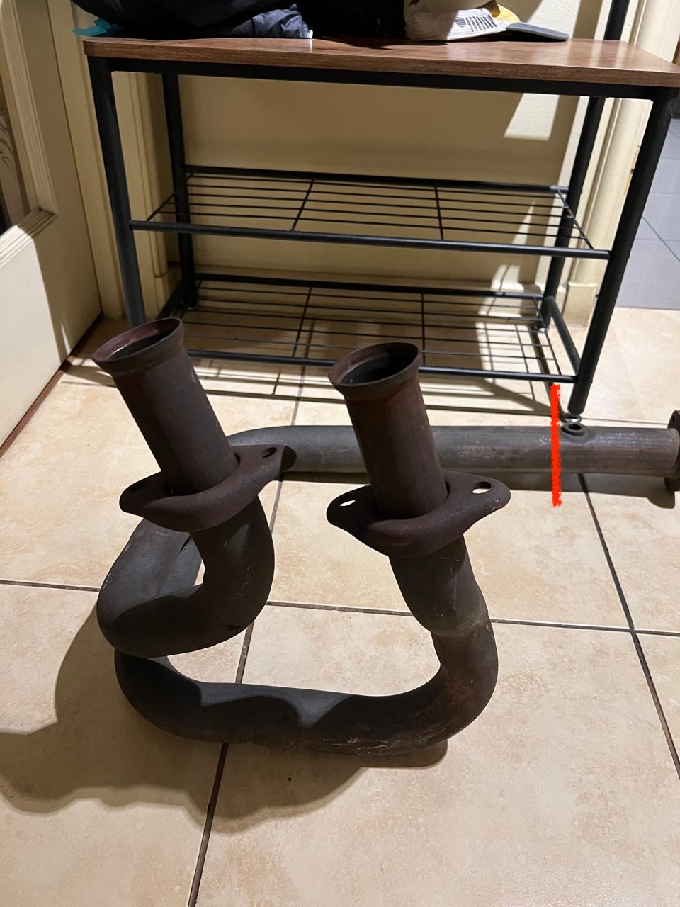

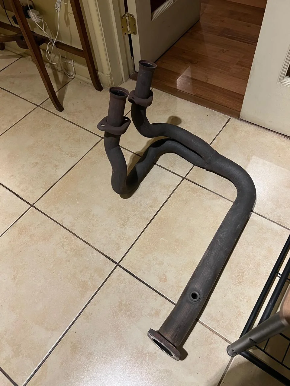

Anyone knows if this older catless down pipe (out from a TJ imported from japan) will fit my 2005 TJ Rubicon?.
I want to remove the 2 cats and 2 O2 sensors after and was thinking to use this downpipe, cut it just before the O2 sensor bung and weld it to my OEM exhaust pipe, before the third cat converter. (I know i'll have to deactivate the 2 O2 sensors with HP Tuners)

Yes, but why? Have your mini-cats gone bad? They're not robbing you of significant power if they haven't failed. Also, you can just have O2 bungs welded in to the downpipes and keep the existing sensors rather than disable them in HPTuners. Perhaps space them back a bit. Up to you on that. And just use a plug on that downstream bung and cut below it if you can. You might want to pop a wideband O2 sensor in there later.

Yes, i think they are gone bad and here in Chile can´t find a new catted downpipe (TJ's aren´t common), so i have to import it and will cost more than USD 600.
Also, i have to re tight the bolts very often because they go loose, and with the precats it's very difficult.
