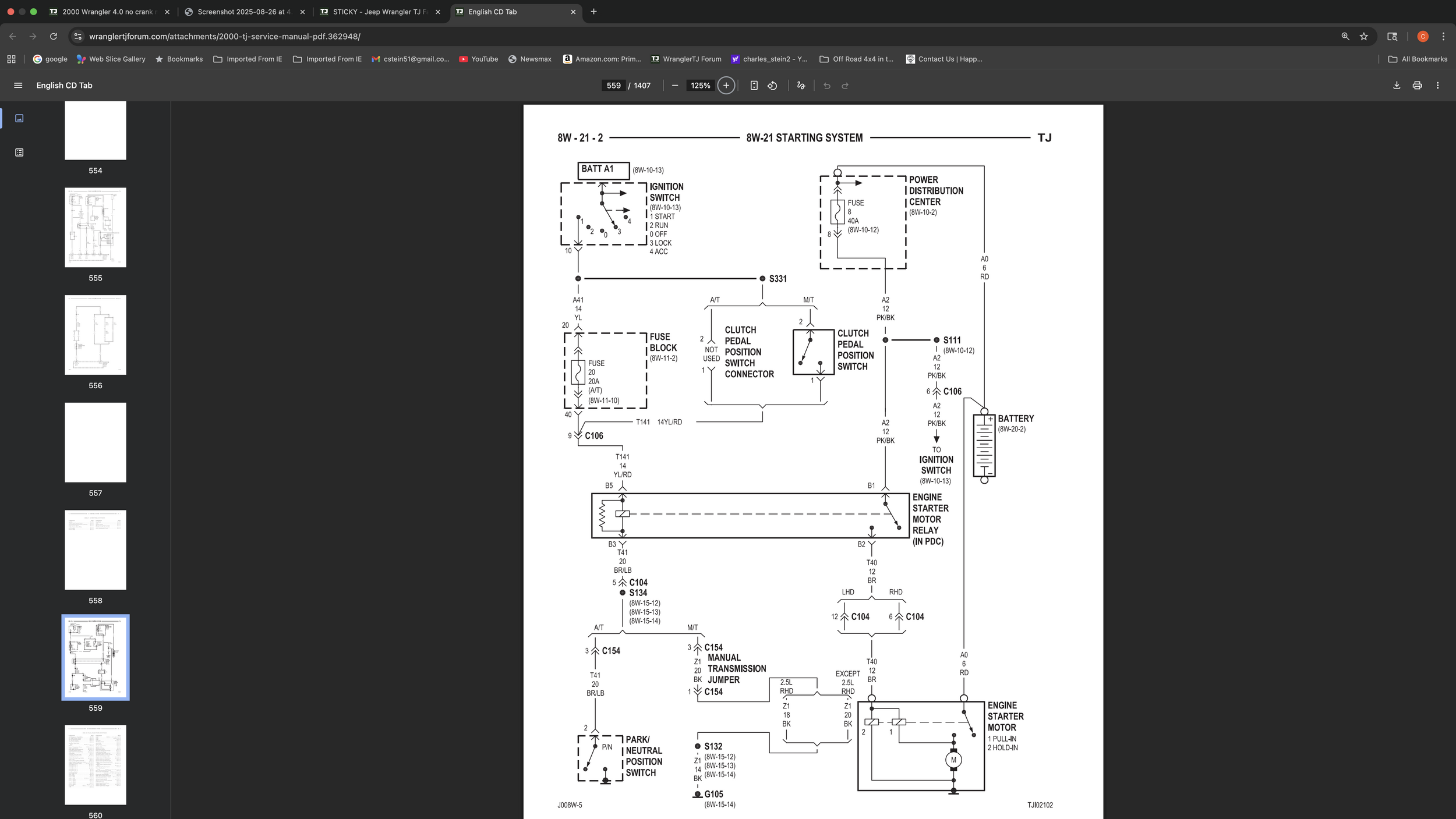

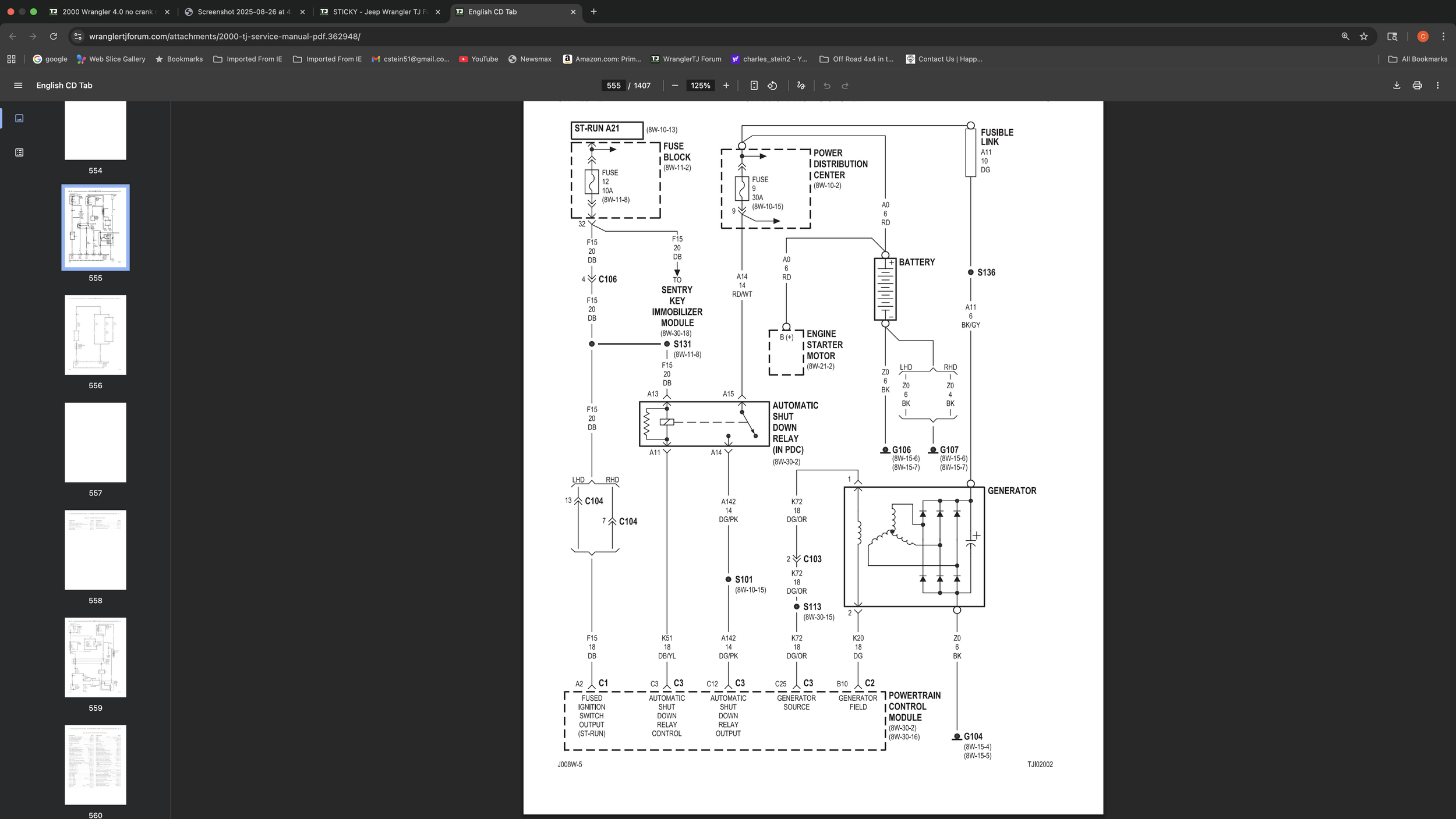

Hope these schematics assist you in further troubleshooting your starting problems.
View attachment 638961View attachment 638960

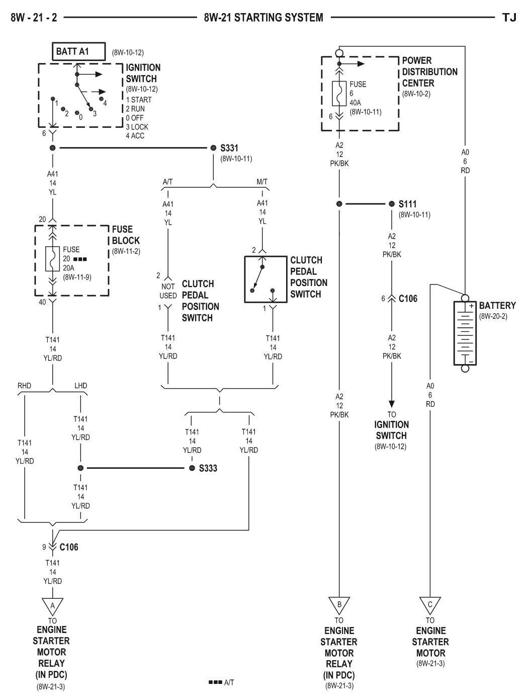

Transmission in neutral. Might want a fuse in position 20 to bypass neutral safety/clutch interlock.
Based on my research this weekend, Fuse 20 looks to bypass the clutch interlock, but the NSS is further on in the circuit and completes the ground on the other side of the starter relay to allow it to close.
That said, I'm not (yet) clear on how Fuse 20 works on an automatic. This diagram is from an '02. On my '97 Fuse 20 is labeled as "Spare" so that tells me that on the A/T path, the "not used" Clutch Pedal Position Switch must be just a direct wire....the use of "not used" is confusing. Is it not there? Is it wired? Is it an open connection? Or is the '97 just different? I'm further confused by Fuse 20 not being labeled as M/T or A/T only like how the clutch switch is....maybe it's wired in for both cases on the '02 (and others?), but if it happens to blow current still flows down the clutch pedal path? That doesn't sound right either.
Reactions: macleanflood
That's how I see it, and there is a connector point shown at the location of the clutch switch where it must just plug together. I'd guess they didn't change anything with fuse #20 since it wouldn't matter if it had a fuse inserted or not. Unless they omitted the wire from the load side of the fuse to save a few pennies.
Yeah, I guess that's ultimately what I want to know. Pulling the fuse would answer the question I guess. I need to compare the diagram on my 97 since it's explictly labeled as Spare on the fuse box.
