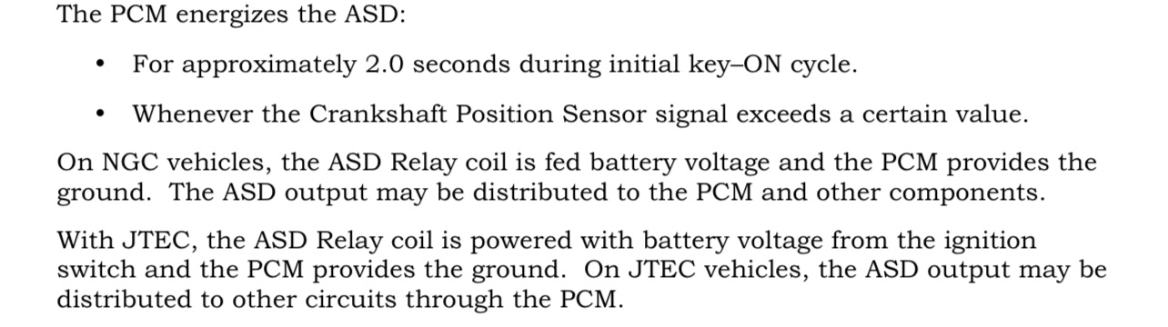

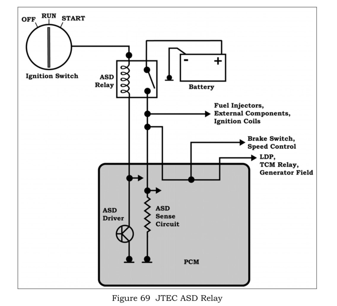

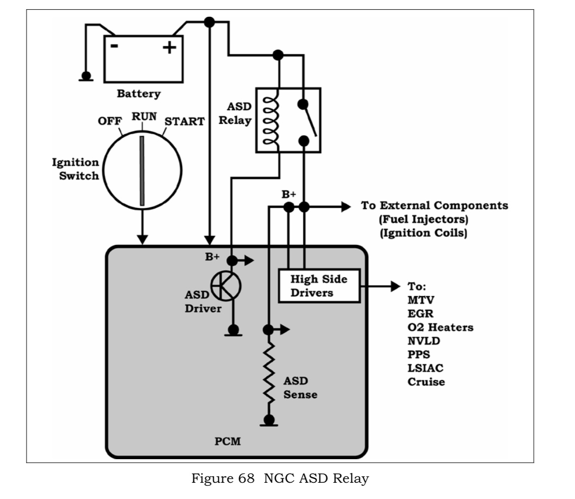

Starter won't turn over when ignition is turned to start. Resistance on the starter relay (pins 85 and 86) checks good with 78 ohms. I have 12 volts on pin 30 on the relay. I have 12 volts on pin 85 when ignition is turned to start. The clutch safety switch has been jumpered. I can jump the terminals on the starter solenoid with a screwdriver and the Jeep will start and run fine. Looking on manual page 8w-21-4. It appears the powertrain control module controls the ground through s134. I'm thinking the computer does not want to let it start. I had forgotten about the ASD relay but still thinking it's just that the PCM isn't happy and isn't going to ground the starter relay when it shold to start.
