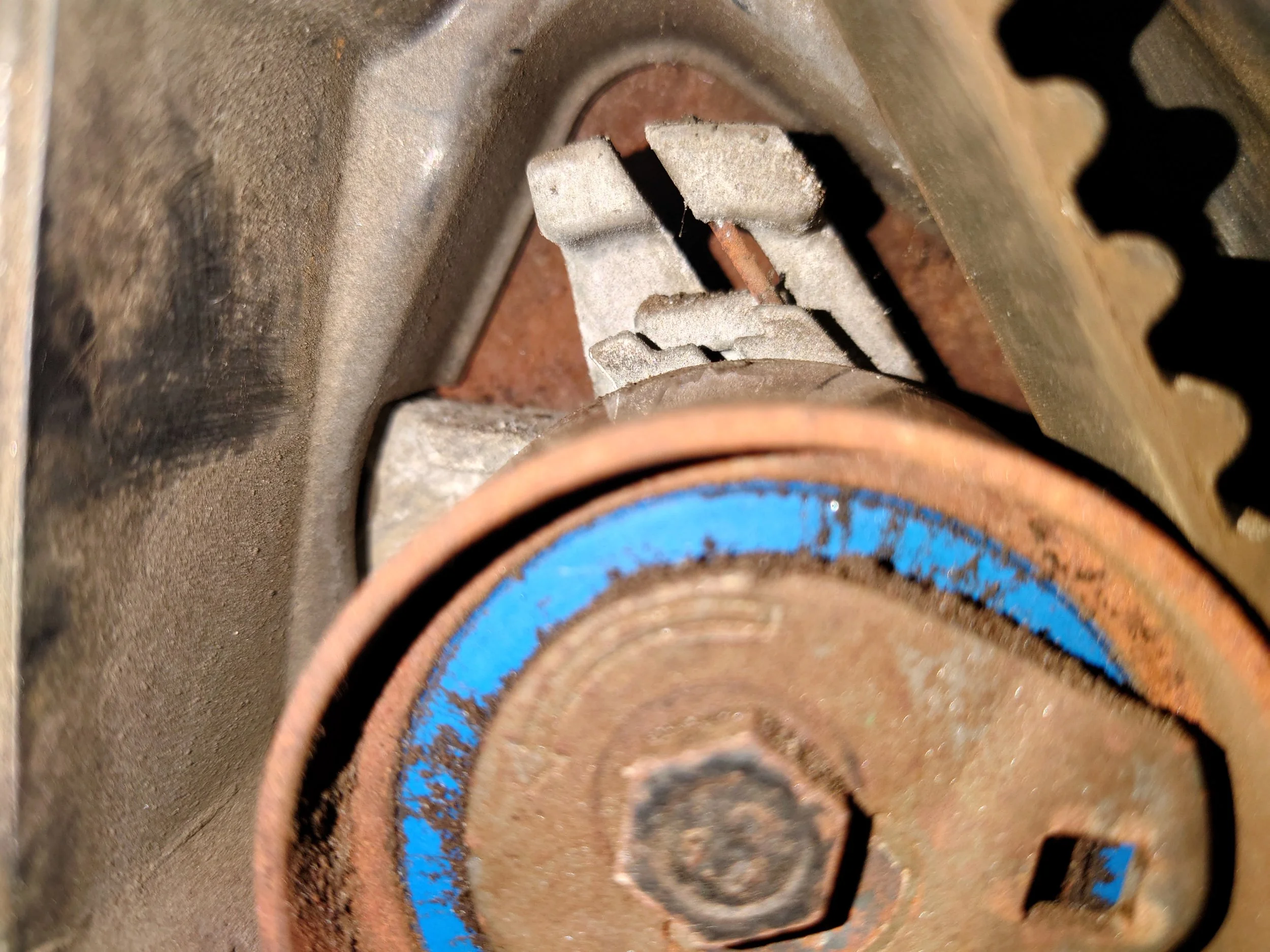

Have you verified the timing belt hasn’t jumped?

Jumped timing belt. Classic. When it's done let me know.

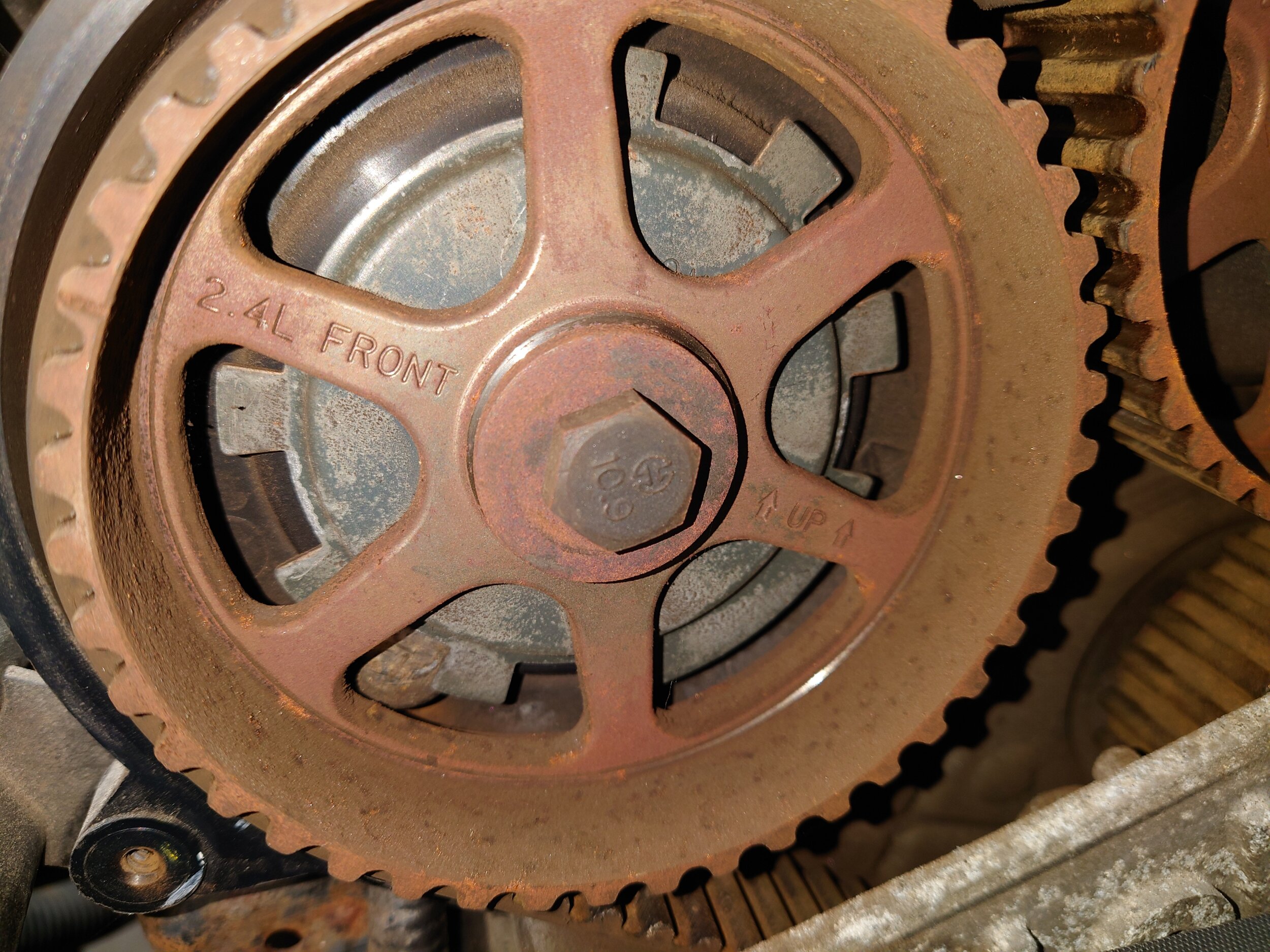

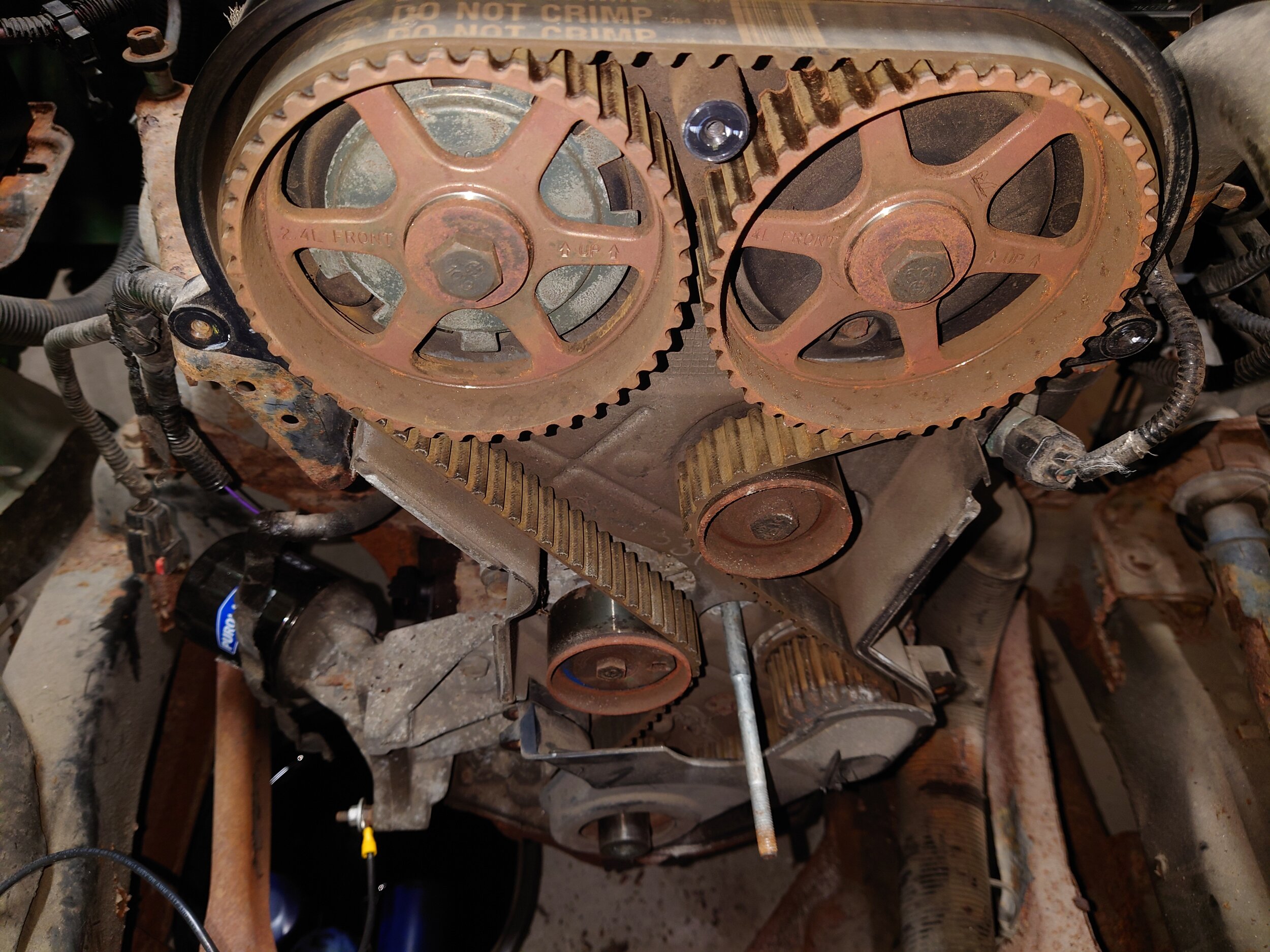

Haven't actually verified if jumped or not yet, but it sure was a pain getting it to as pictured. Think I'm going to have to undo that final screw holding the bottom plastic cover on using some pliers through the back.
Tomorrow I'll clean up some up the dust and crud on everything in there and actually check the timing

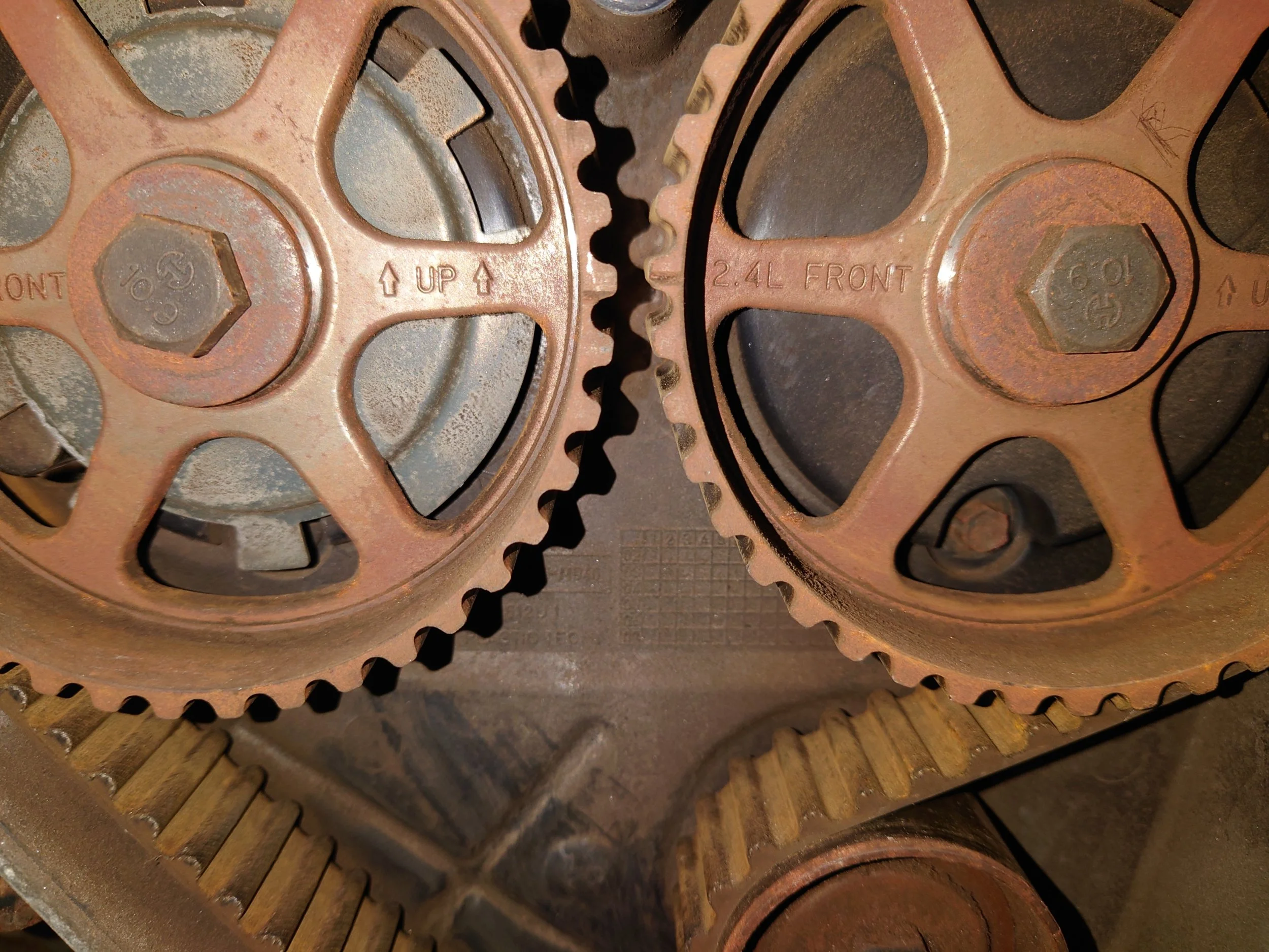

Oh my bad. It looks like it may still be in time. IIRC on the PT Cruiser (same engine internals, block is casted different), the timing marks should be able to side to side in line with each other. Turn the engine over by hand at the crank and see if they line up. If not, intake and exhaust cams are out of time with the crank.
If that's the case, boom. No start. I can't be sure from the photo. Either way, just one tooth off will cause a no start or will hit and then immediately die.
By the way, imagine doing that timing belt job on a Neon, PT, Voyager, Sebring, etc. You gotta drop the motor mount and like 10 other things. It. Sucks. Ass.

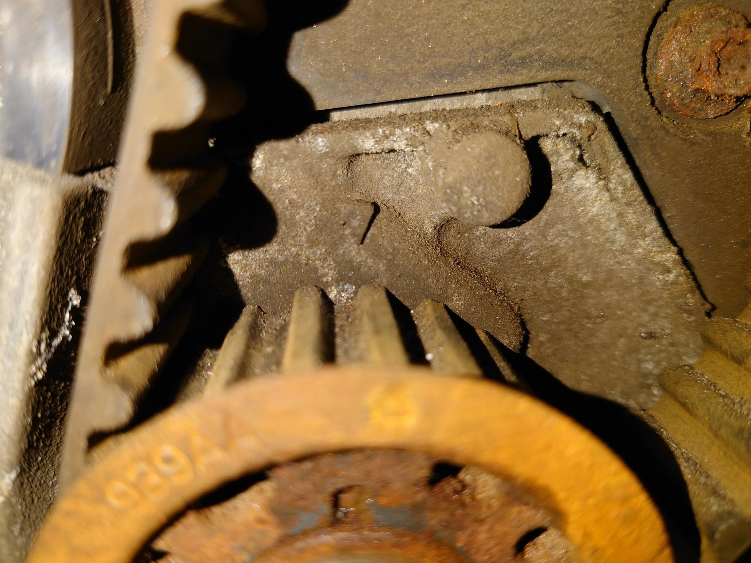

Checked out the timing last night and it looks correct to me. However, I realized that since I had some rotation in both directions to get the crank sprocket to TDC, my measurement of the belt tension is invalid. I'll have to try that again tonight, after taking out the spark plugs this time.
If the timing is right but tension is too low, can that explain the no-start condition in the videos posted?

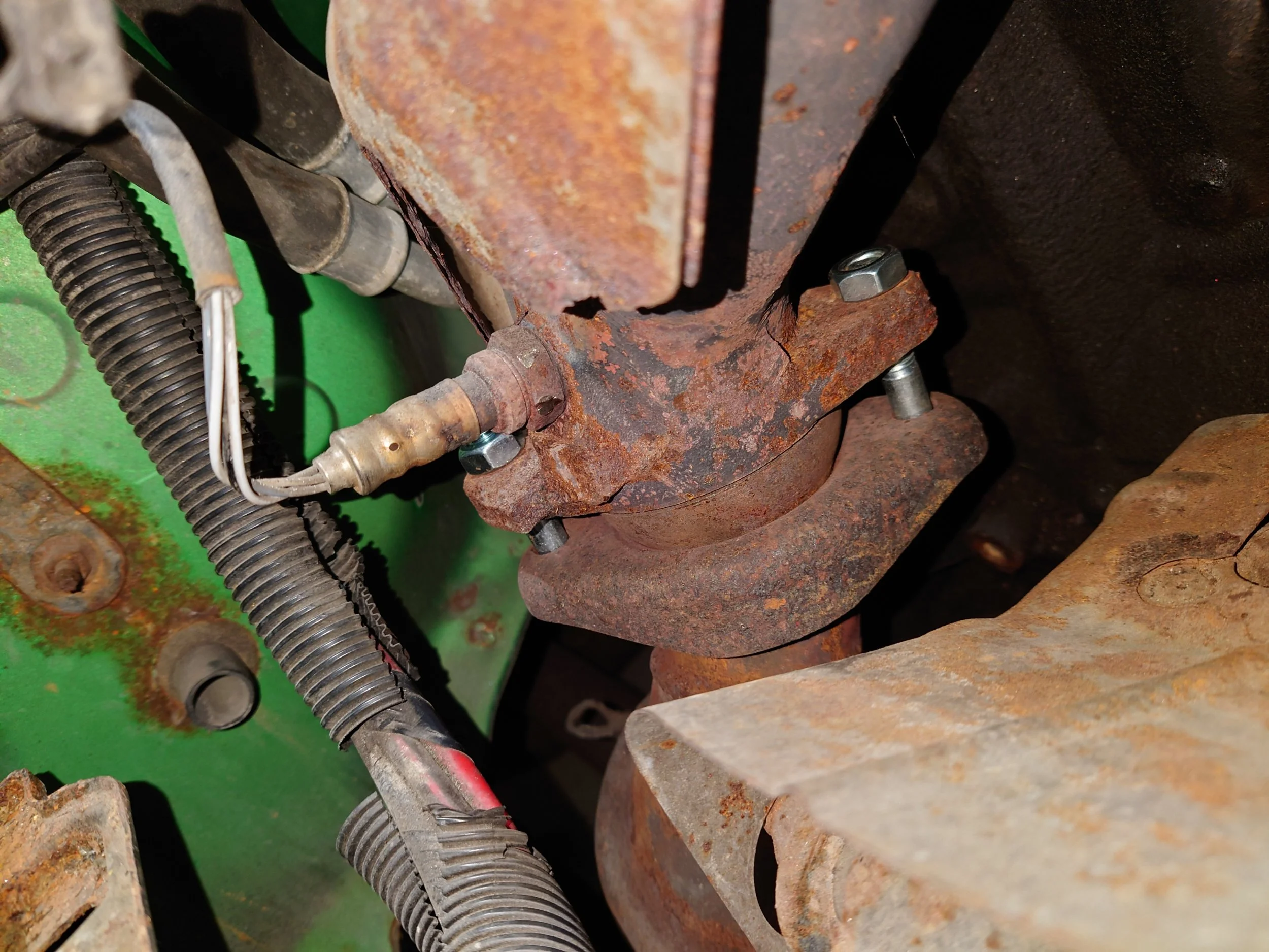

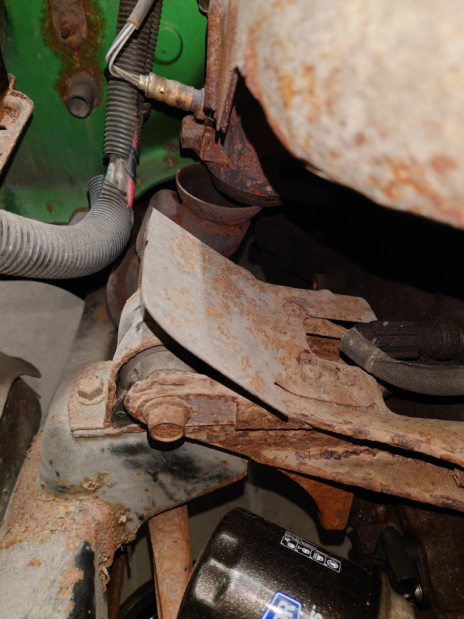

Also I noticed while taking the covers off back a few days that the exhaust pipe had fallen off!
Bolted back on now 😅
Same position of that indicator after rotating clockwise twice around, and then still same after the third rotation.
Can this improper timing belt tension cause a no-start condition?
Worth it to go buy a new belt and tensioner? Think I'm also going to send the PCM off to @Wranglerfix at this point to try to rule that out.

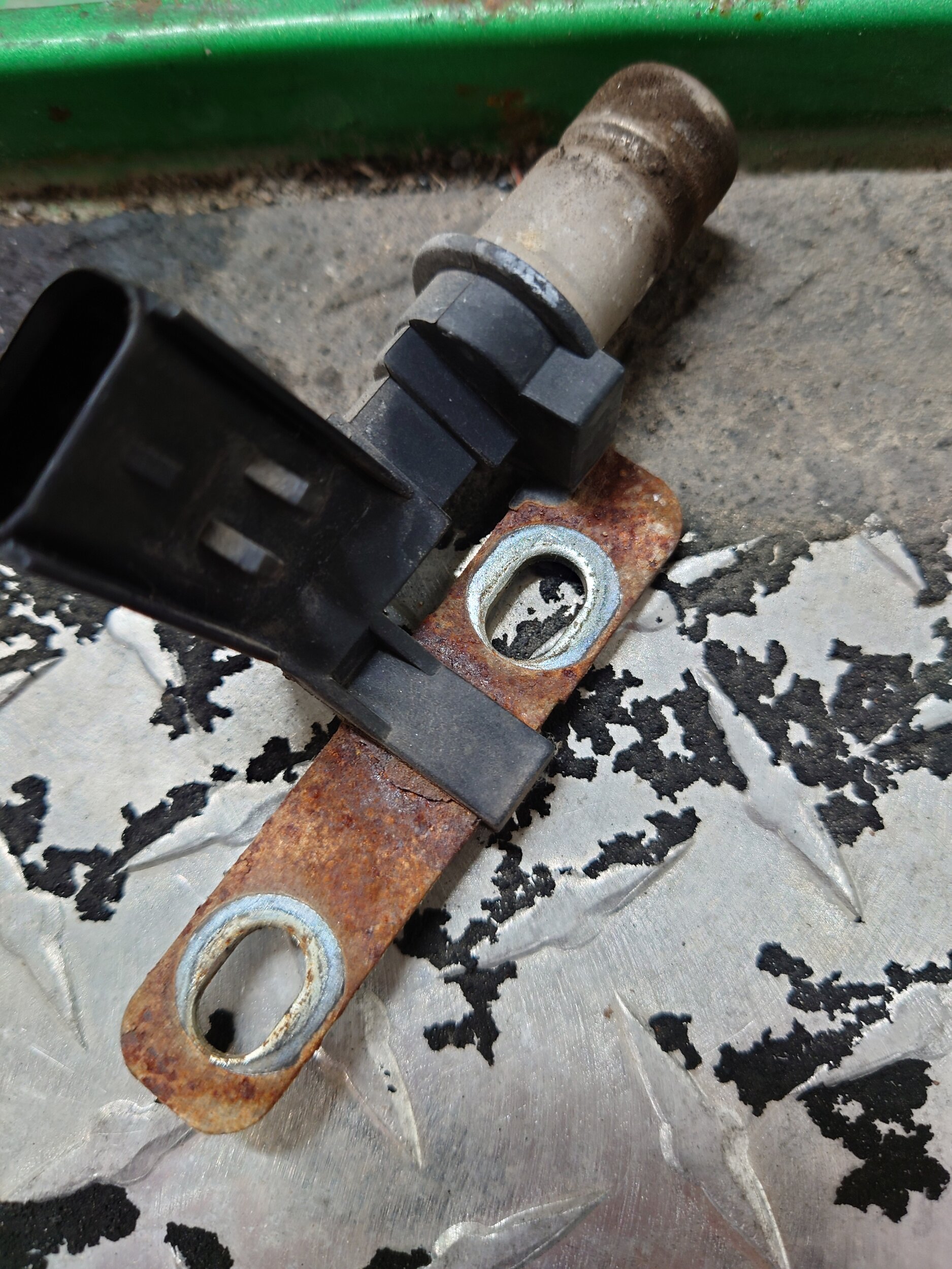

I think what I’m gonna do is disconnect that sensor on Monday (under the oil filter) and find out what it is. I’m almost positive that’s your issue. Id do it today because I’m off in a couple hours but it’s wet from the storms last night.
