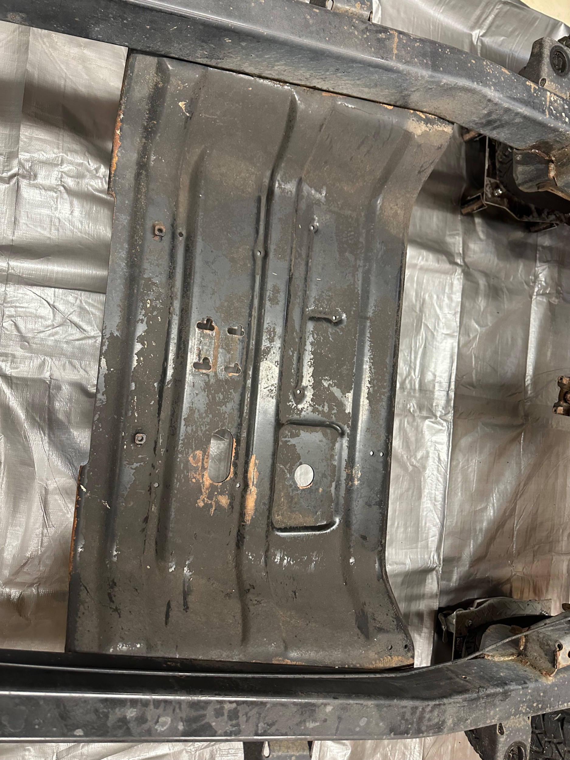

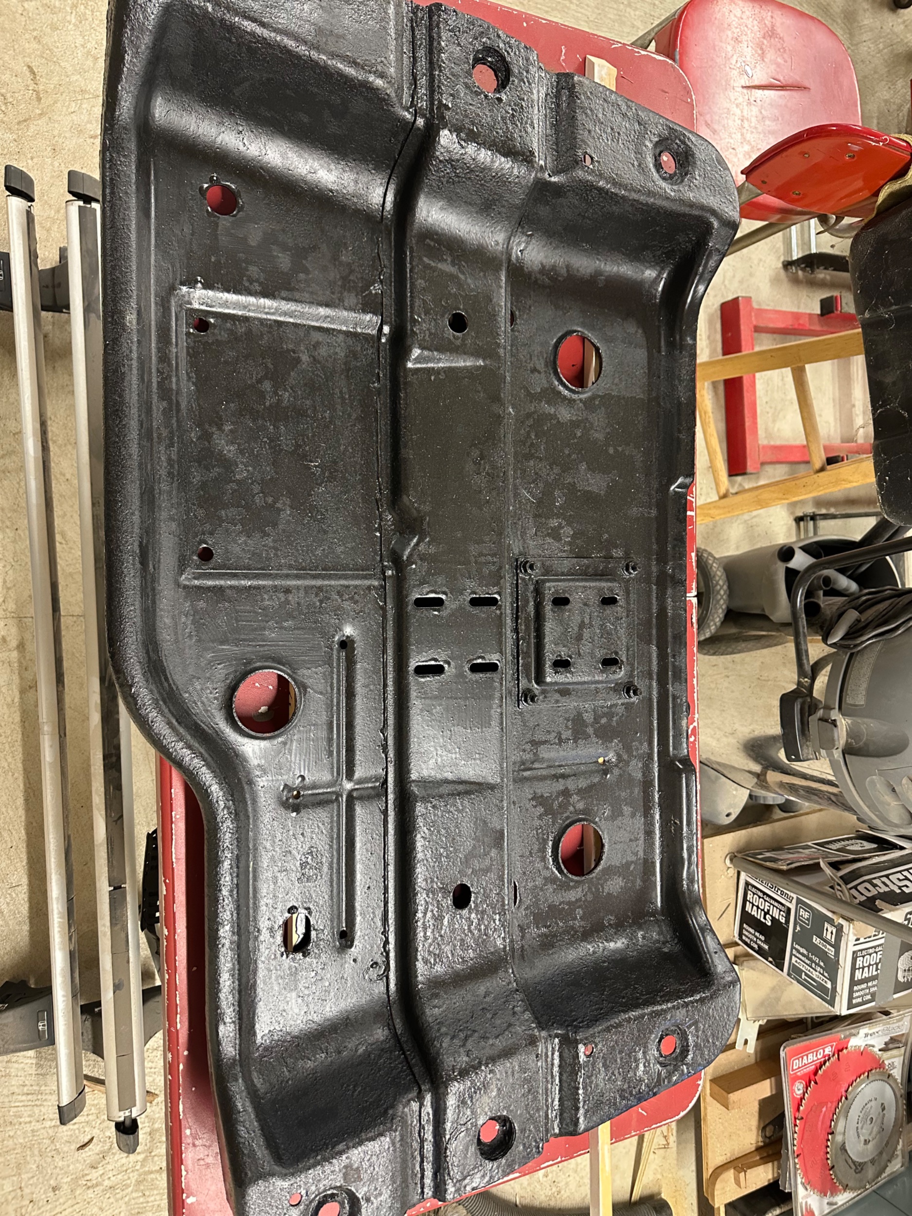

Here are the two skid plates! The one in the frame is the 2005 and the one out of the frame is the 1998.
Those rear slots for the transmission mount look dangerously close to the older skid... that from a look at two pictures and not standing there with a tape measure.
Is it me or does the earlier frame narrow more to the front and the newer frame is wider?
-Mac
