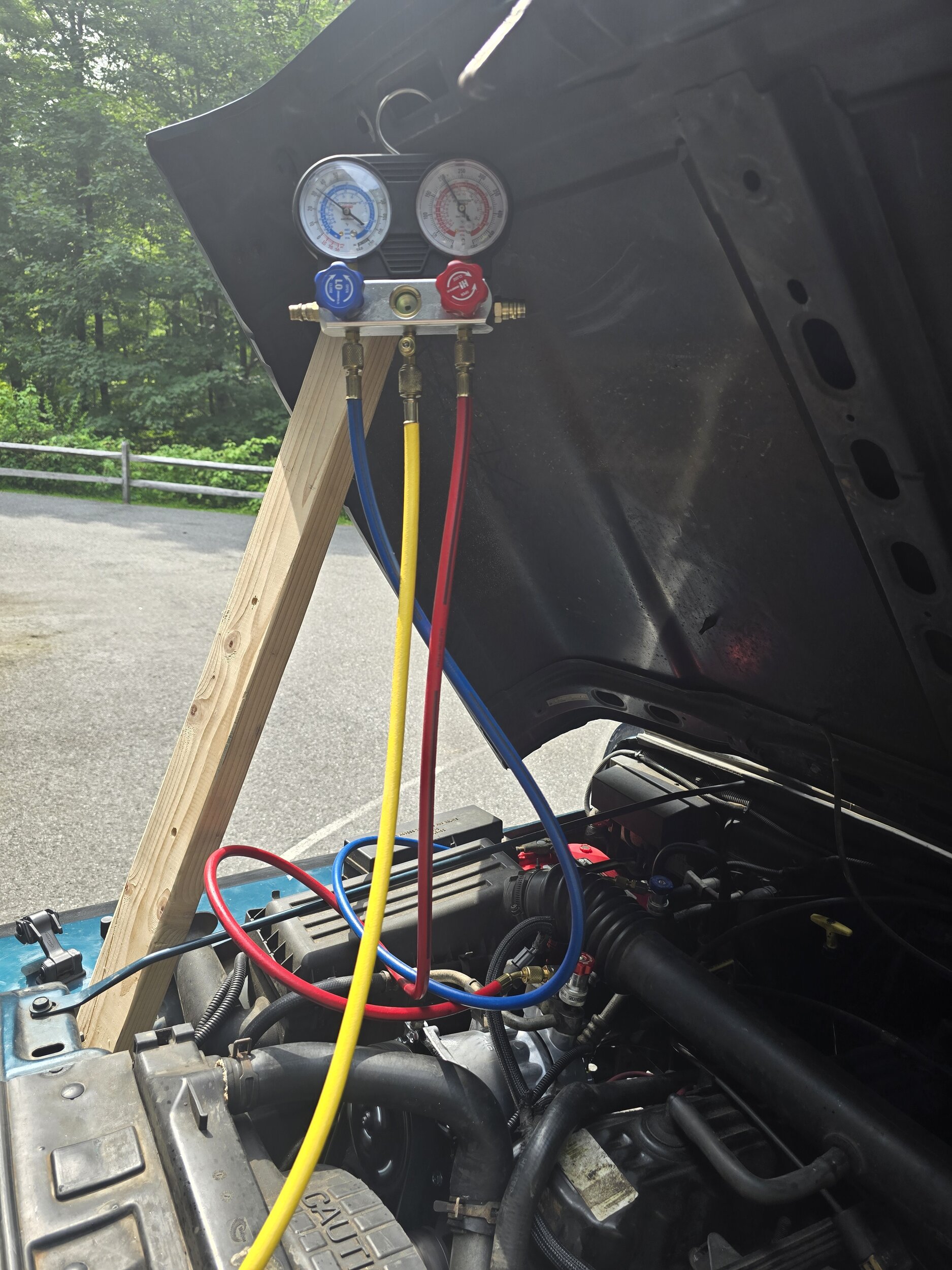

Hi,
Just gut checking. '98 TJ, A/C quit years ago and never bothered to diagnose. I hooked up the gauges, pulled a vacuum and left it over night. Everything was right where it should have been in the morning. Proceeded to fill the system, AC compressor engages, and get cool air. I'll go out a few hours later and no A/C, like I never did a thing to it. When the compressor switched on, didn't sound all that great and so my hunch is that I have some leak in the compressor.
Before I drop some cash on parts and my time, want to double check if this is reasonable assumption or if there are add'l tests I could perform. I did send dye through, but didn't see evidence of a leak anywhere using blacklight. While I have the patient open, should I replace anything else like accumulator and hoses?
TIA
