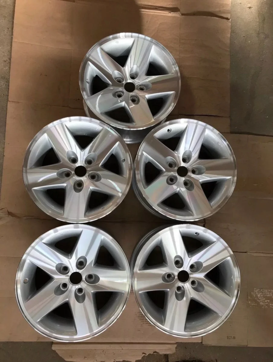

I also really like the Moabs in machined finish. It’s the best looking Moab rim finish IMO. The issue with running them is that they are built in the 16 inch diameter, which we all know is less desirable. But damn they look good. Also, any Moab can be turned resulting in a beautiful machine finish. I think that info is listed in my Jeep thread.

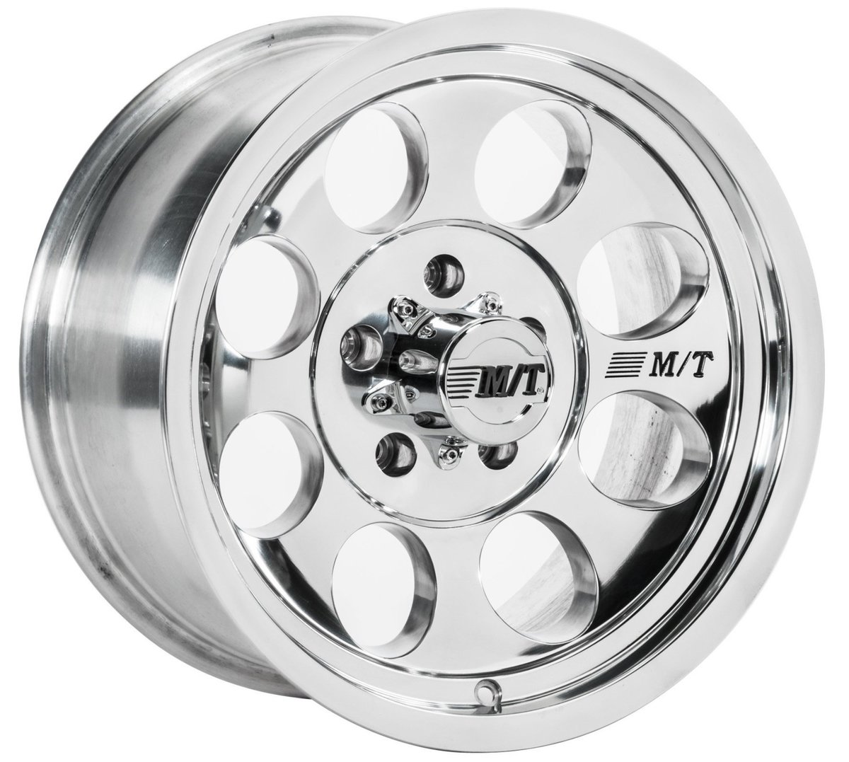

I like the Mickey Thompson polished classic lock II wheels, without the fake bead lock ring.
https://www.quadratec.com/p/mickey-...p-wangler-yj-tj-cherokee-xj-grand-cherokee-zj

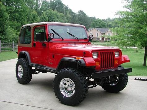

My brother ran them on his YJ with a 33 inch tire and I thought it looked really good paired with the Flame Red paint. View attachment 151965

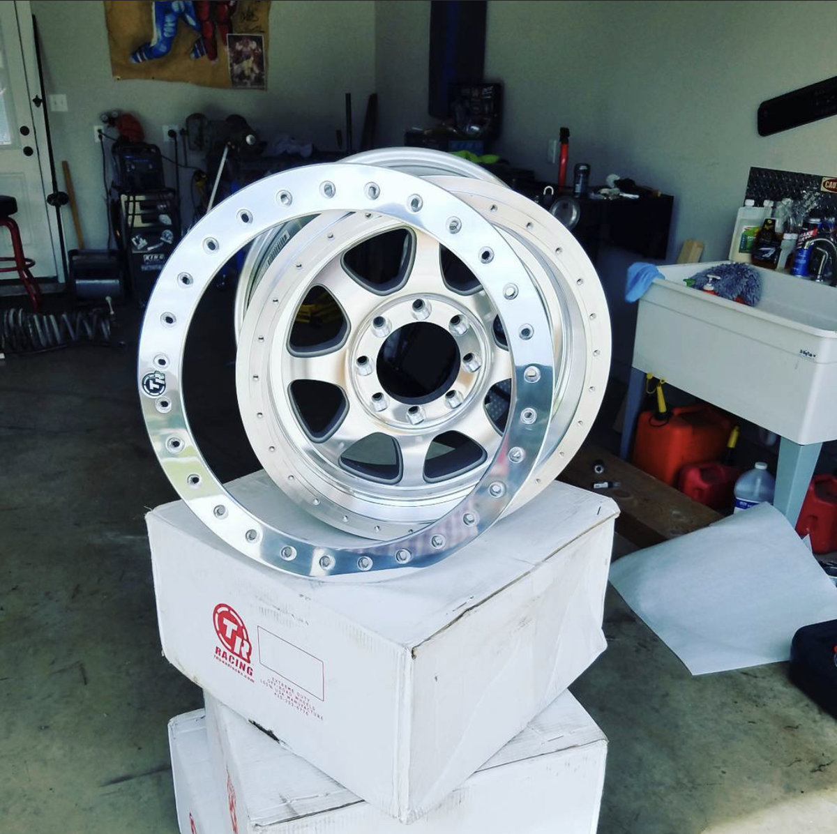

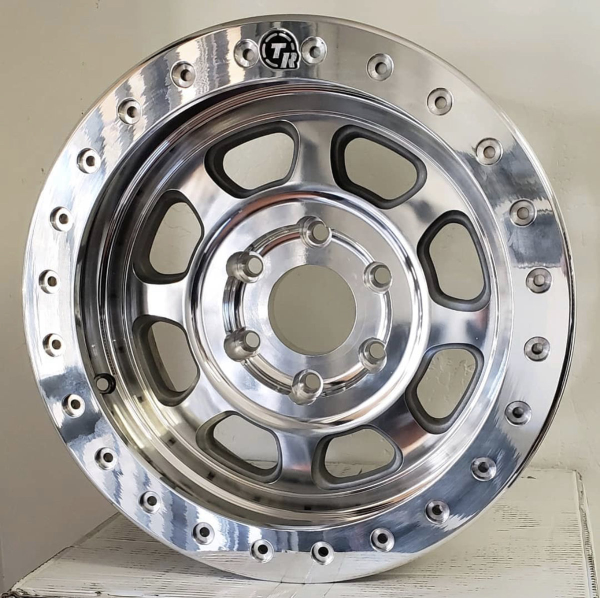

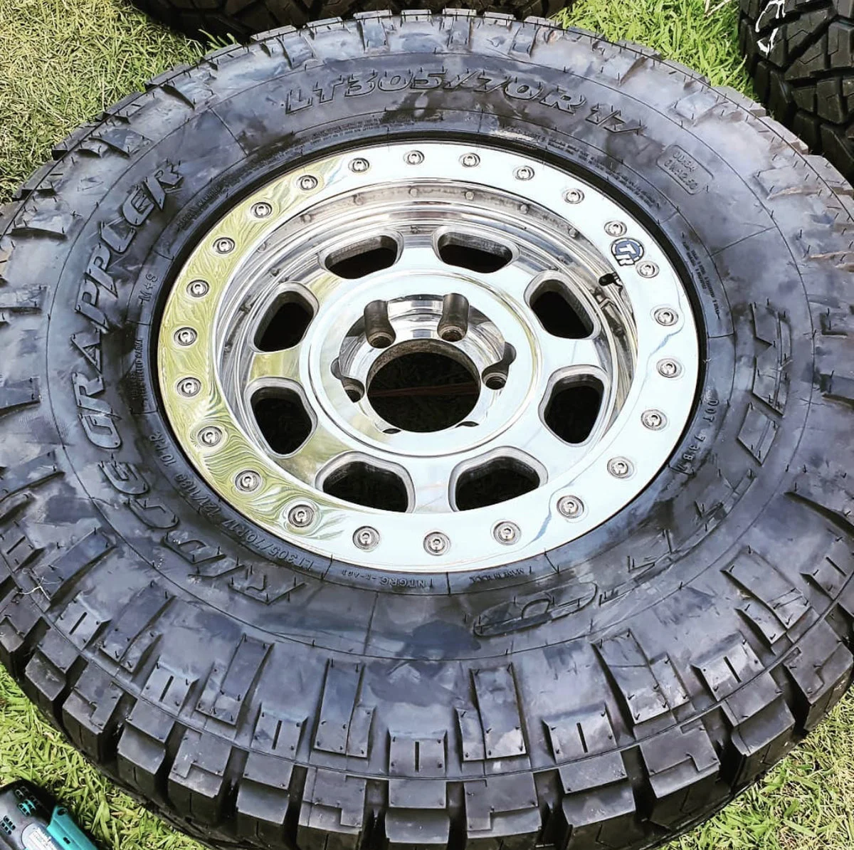

Are you considering a Trailready beadlock? The HD15 looks amazing. I ask only because you are going that direction eventually.
View attachment 151976View attachment 151977View attachment 151978View attachment 151979View attachment 151980
http://secure.trbeadlocks.com/hd1515x9beadlockedwheel.aspx
Those trail ready rims look amazing.
The micky Thompsons would look great on your jeep.

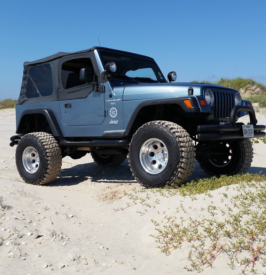

I personally have always been kind of fond of these:
Another vote for the Micky Thompson's. It's a timeless look.

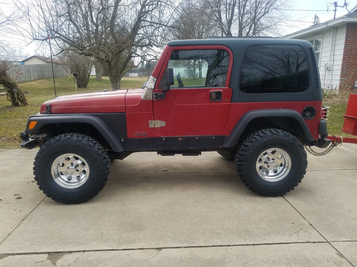

This is my buddies chill pepper red TJ with soft 8's
I have thought of Argent Soft 8's. I think Extreme Terrain offers some. I thought they looked great. My wife was not so impressed. That doesn't mean everything. She really likes my DC-2's. I also like that polished machined Moab look like the Mamba's too. The only issue with them is a 4.5" BS. That may work, but I might risk rubbing on my lower CA's and I also might need some bumpstop to keep the tires out of the fenders. Decisions, decisions...
