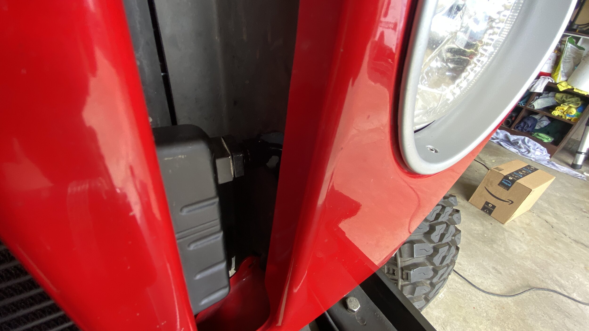

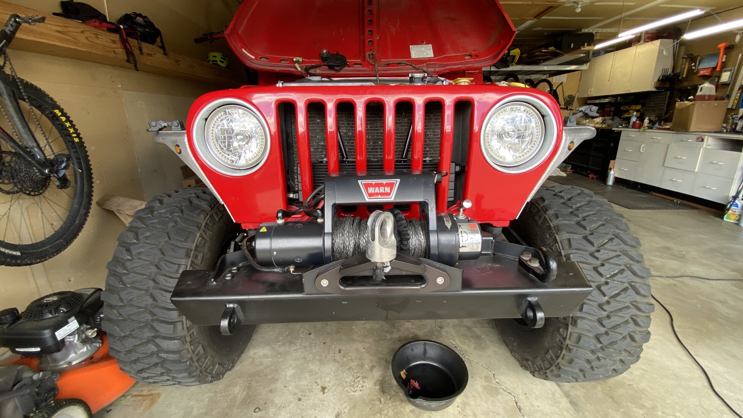

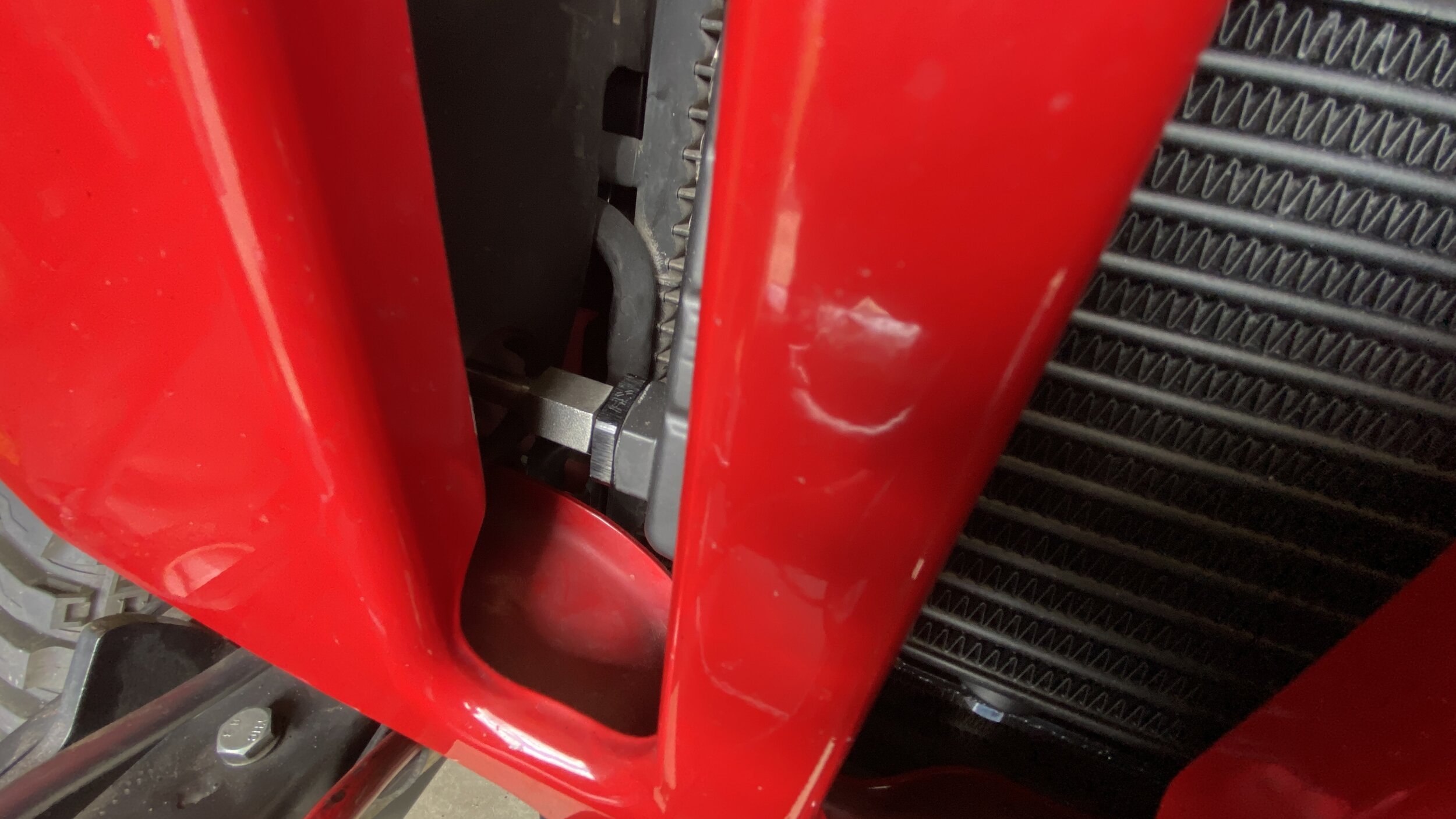

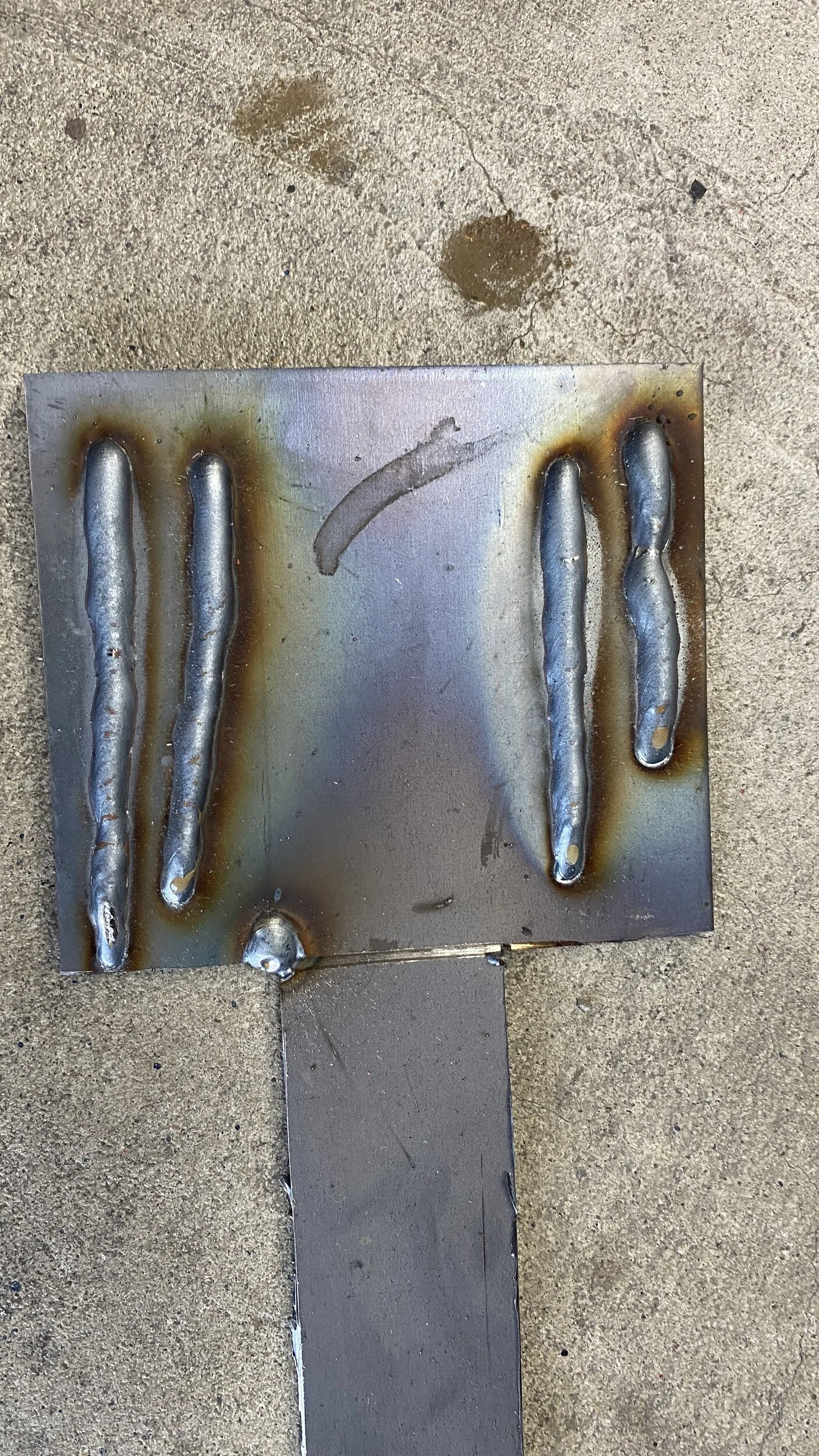

Finally worked up the motivation to start installing the Setrab transmission cooler. Blaine sent me some small parts awhile back. Super nice parts. I just got tired of working on the Jeep after the transmission swap, but I’m ready now. I’m mounting it to the V-Bar behind the grill. Tolerances are tight so I drew it out on a 3M sticky note and made the two strips of 1 1/4” wide x 1/8” thick steel brackets. Drilled the holes where they needed to be for the bosses. It fits well without touching the V-Bar or the back of the grill.
Laid down a few beads to warm up. It’s been awhile.
No warm ups needed if they look like that ;)

@mrblaine, I got the Setrab cooler installed. 😎 Thanks for the pictorial and the small parts, especially your nice piece that gets you out of the dicey passenger side.

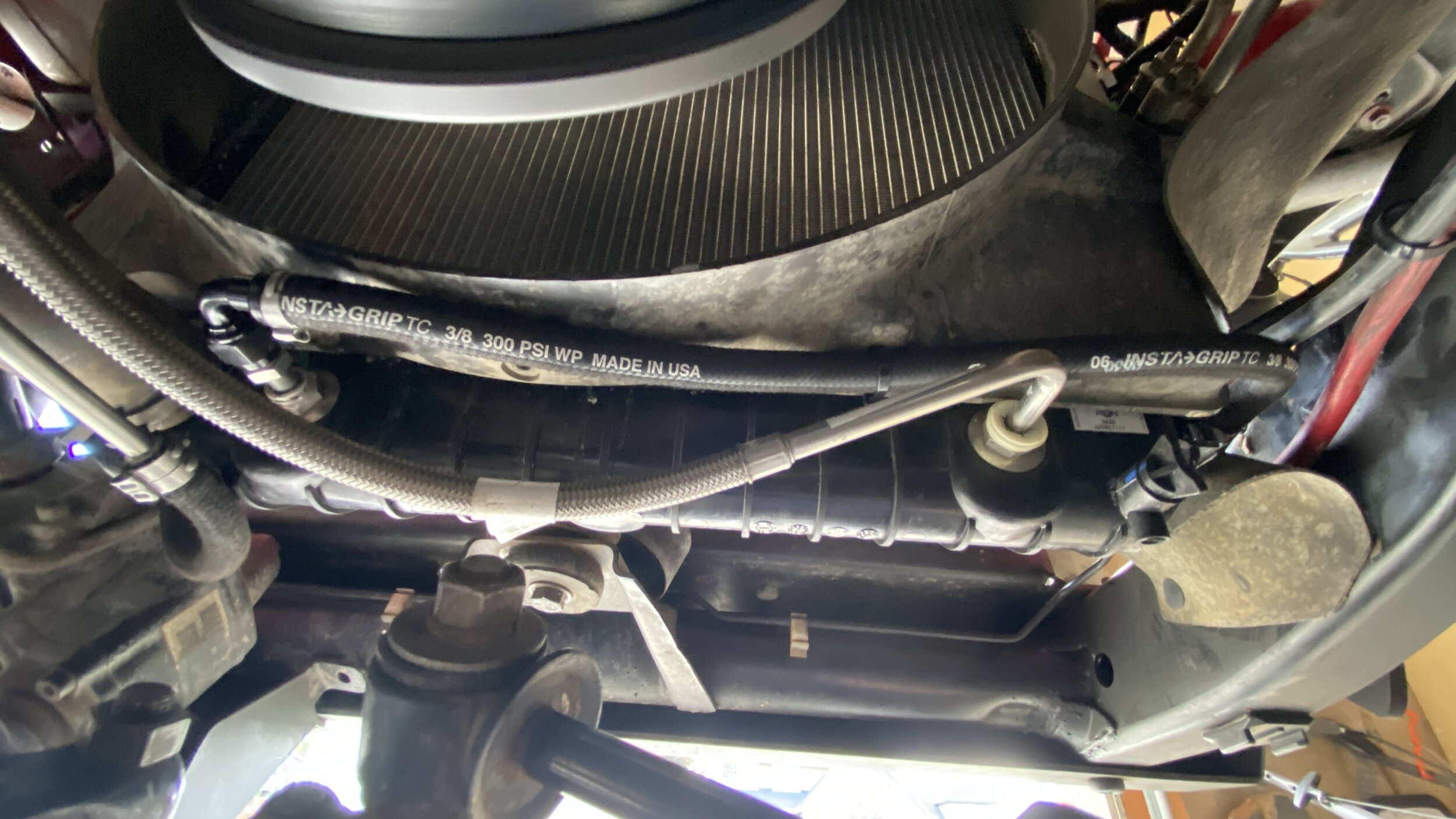

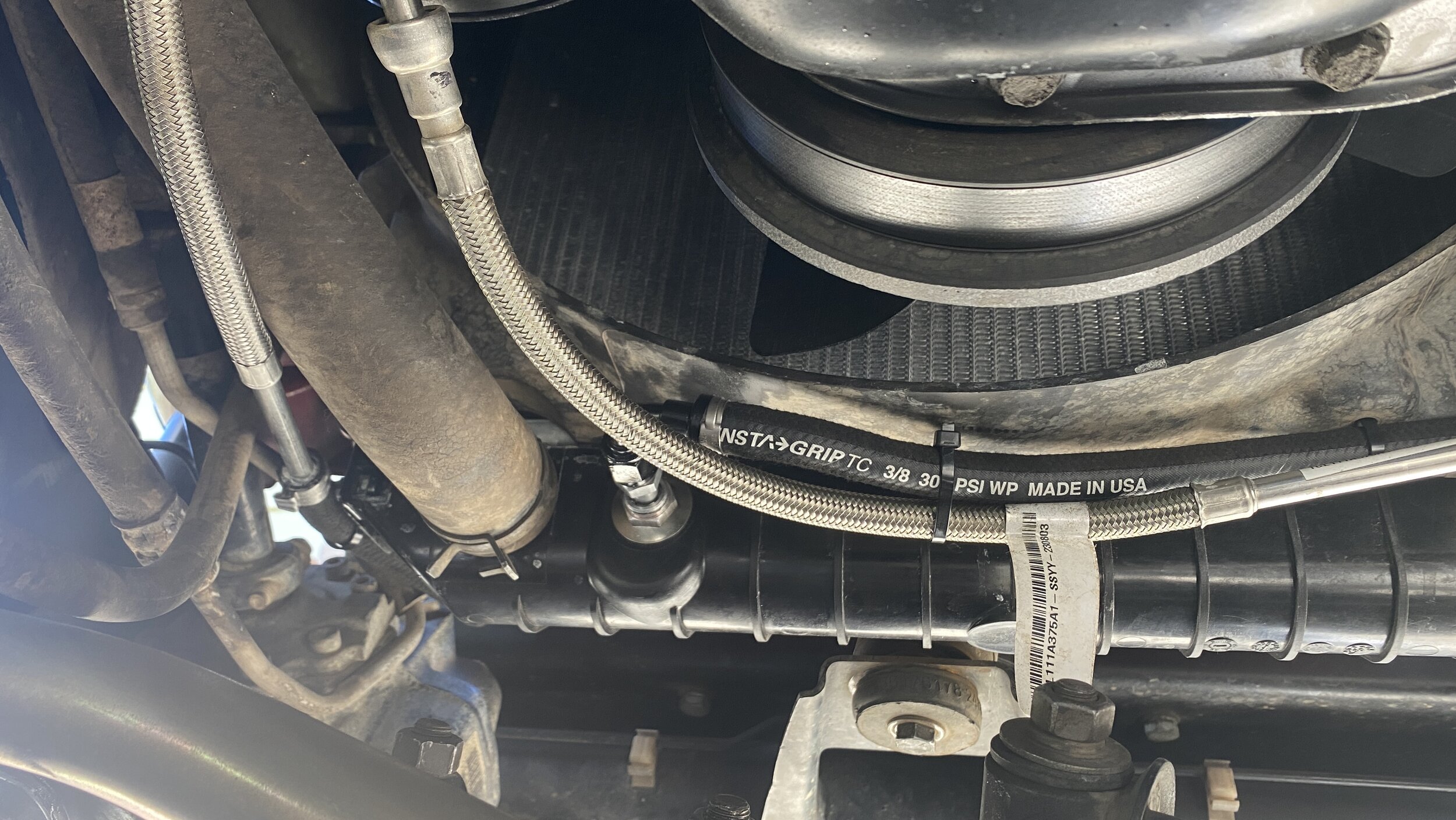

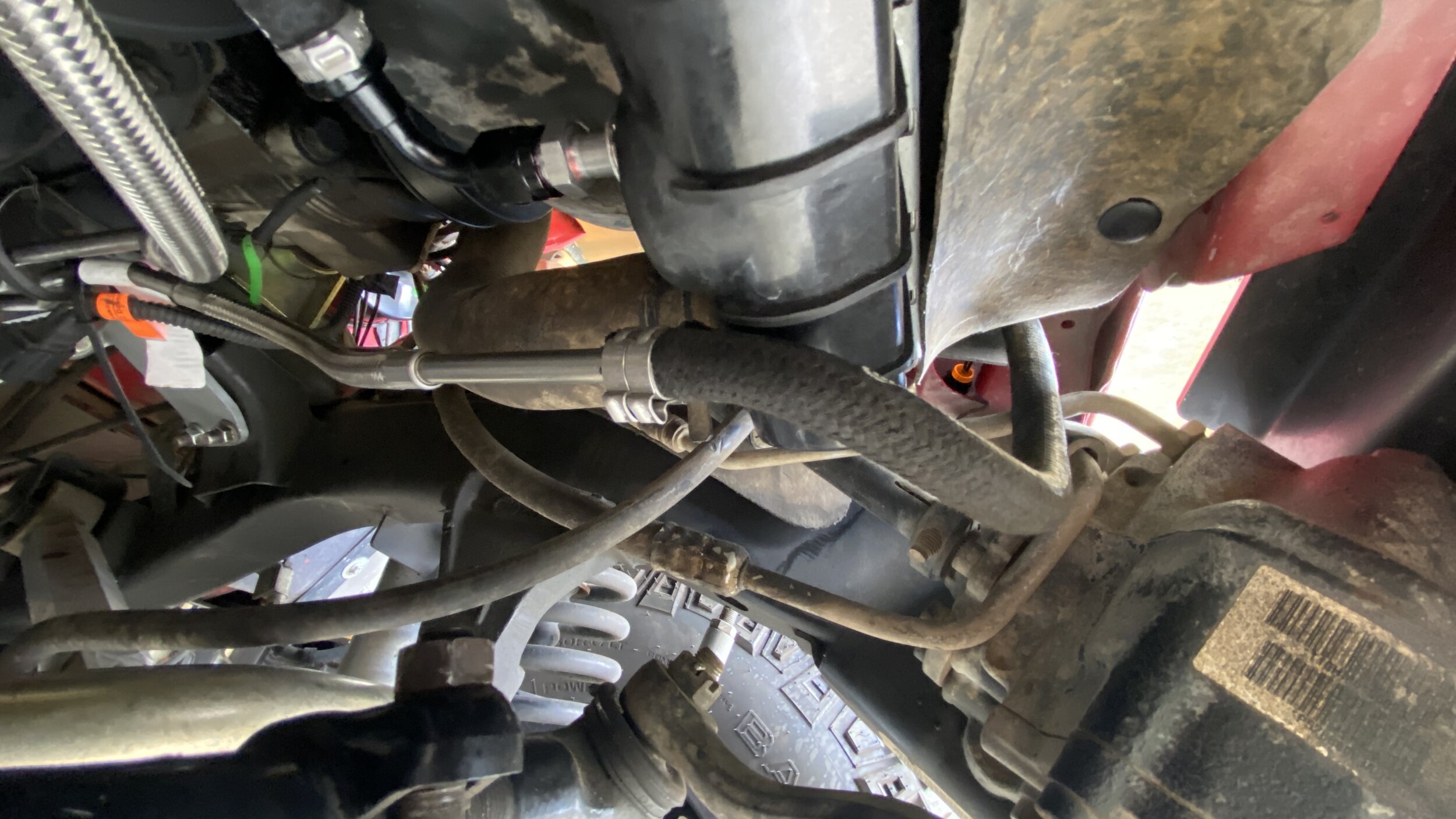

I couldn’t cut into the crimped portion of the line to add the tube and clamps because there hardly anything there, so I just removed the stock clip, pulled the hard line out of the radiator, and pushed the tube over the flared end. This was the biggest PITA because the flare is slightly larger than those on the AN fittings, and even with white lithium lubricant I could only get it 3/4” past the flare. It was good enough for two Oetika clamps! So far no leaks. The cooler is almost level and almost centered. Hard to get it perfect with limited tools and doing it the first time. I doubt anyone would notice. No leaks!!!

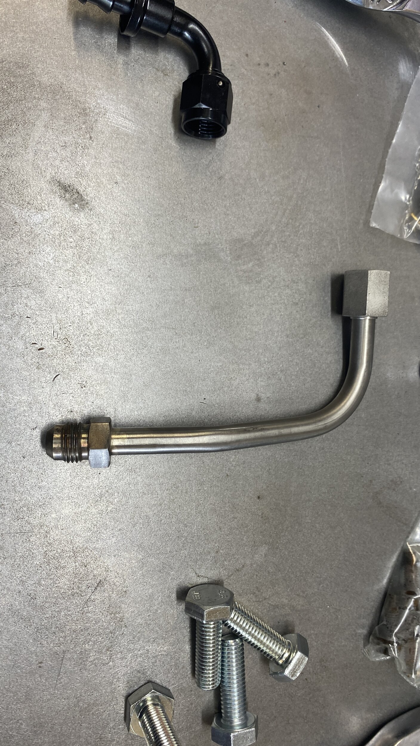

Zip tie that SS line up to the other one to make it behave. Now that you've messed with the right side, you can understand easier why I make that fitting. If anyone is in need that is adapting into the 05-06 radiator trans cooler, I have the adapters from Quick Disconnect to -6 AN Male in Stainless Steel now. They should go from about 12 bucks each plus freight.

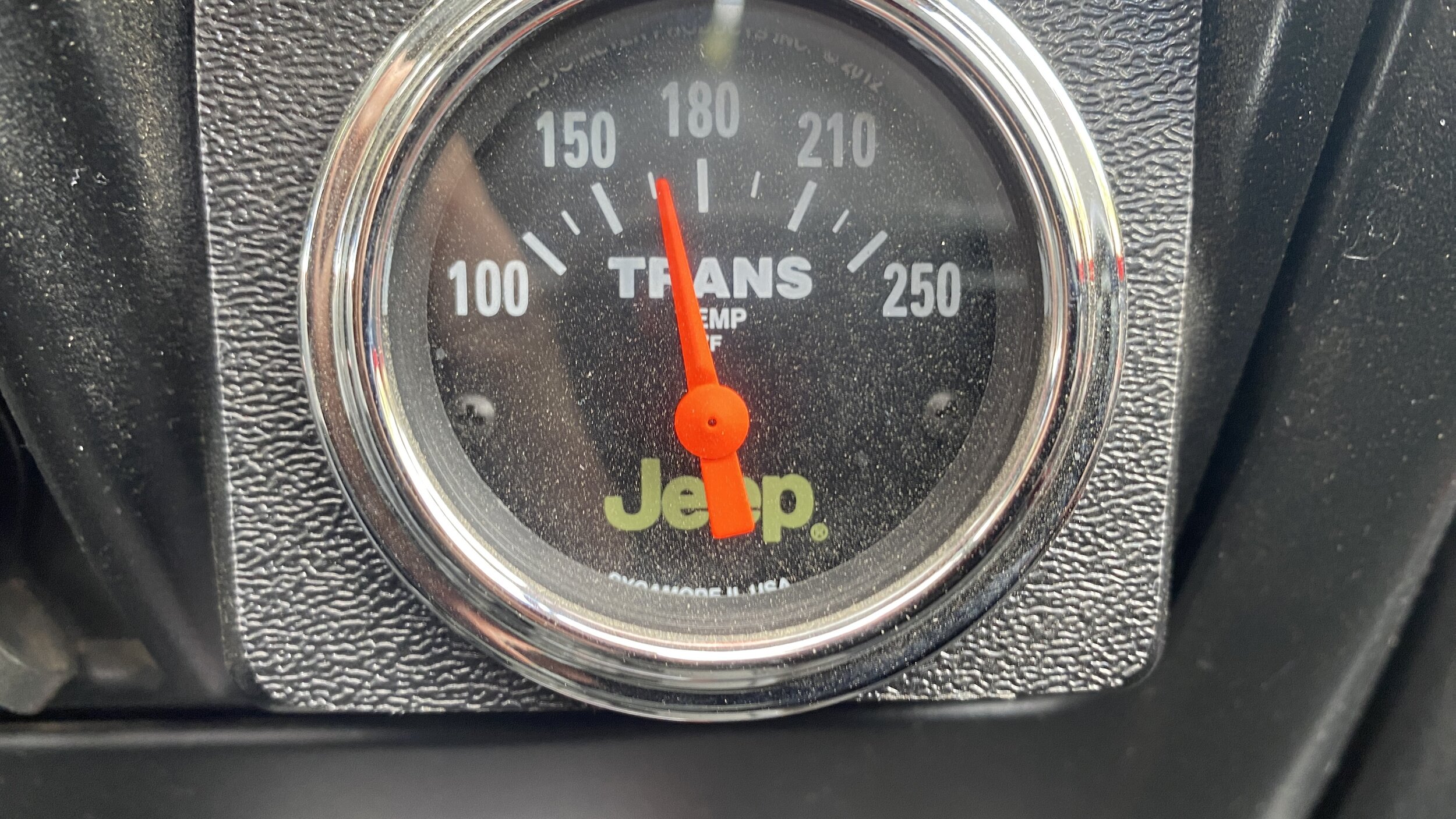

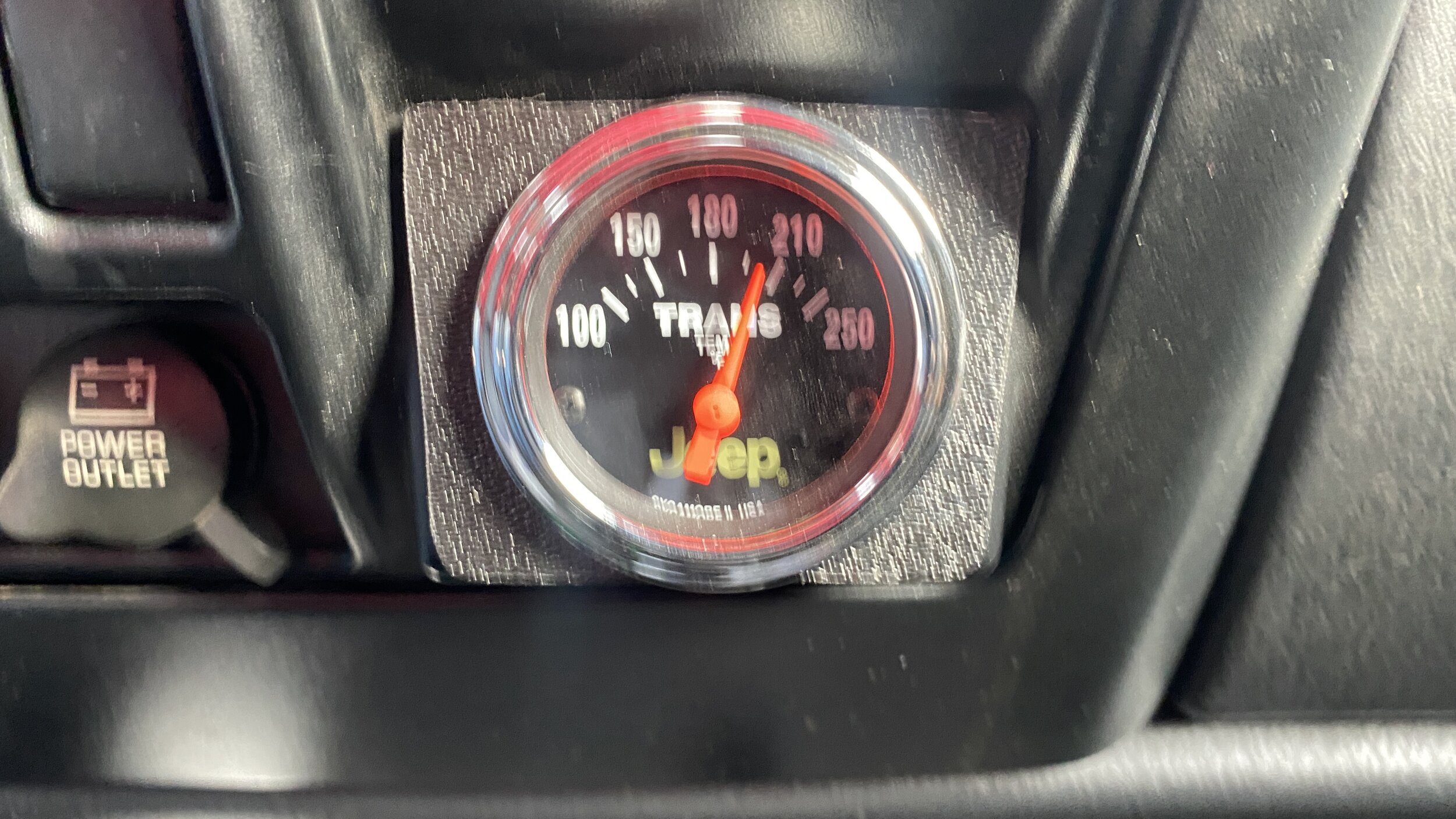

I’m really liking how smooth everything is working now. I’m airing down to 7.5psi on the beadlocks. The tires are hooking up very well on the loose terrain. I can just crawl. The auto transmission allows me to focus on other things that I wasn’t able to give my full attention to with the manual. I’m much more relaxed and that means less fatigue after a day of wheelin’. The transmission temps are much better, so I don’t have to worry about burning up my transmission. Airing up from 7.5 to 24.5 takes exactly 2 min 30 sec/tire.
