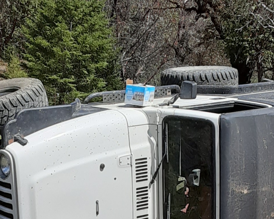

Did you flop for the full experience?
Twice, it gets more comfortable each time.
