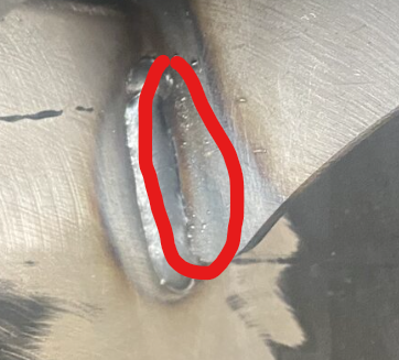

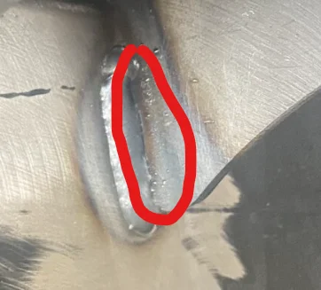

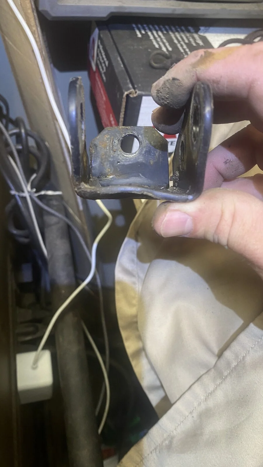

I'm a Ray Charles welder like the rest of us, but are your welds hot enough?
Everybody keeps saying, "Are your welds hot enough?" What are you seeing to conclude that, so I can understand?
I'm going to take it they are not hot enough. After the last time someone asked me that, I decided to increase the amperage a notch above the recommendation for 3/16". I believe my welder was set at 130 or 140A for these passes. I'm using .030 wire.
EDIT: Did a little reading. Said a beginners mistake is not going slow enough and not getting enough penetration, resulting in a cold weld. I still don't know how to identify that though, apart from a break test.
Let me start off by saying, I'm not an expert. I'm a "self taught" welder.
The overall shape of your bead tells me somethings up.
Reactions: JMT
65fec3b2-4fad-4ac3-858a-9bf6d9b109b0-jpeg.401281
Posting this immediately after your chart so I and others can evaluate. Thanks!
Reactions: DrDmoney

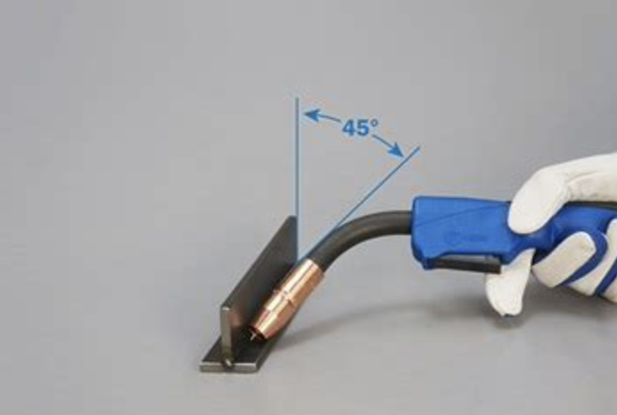

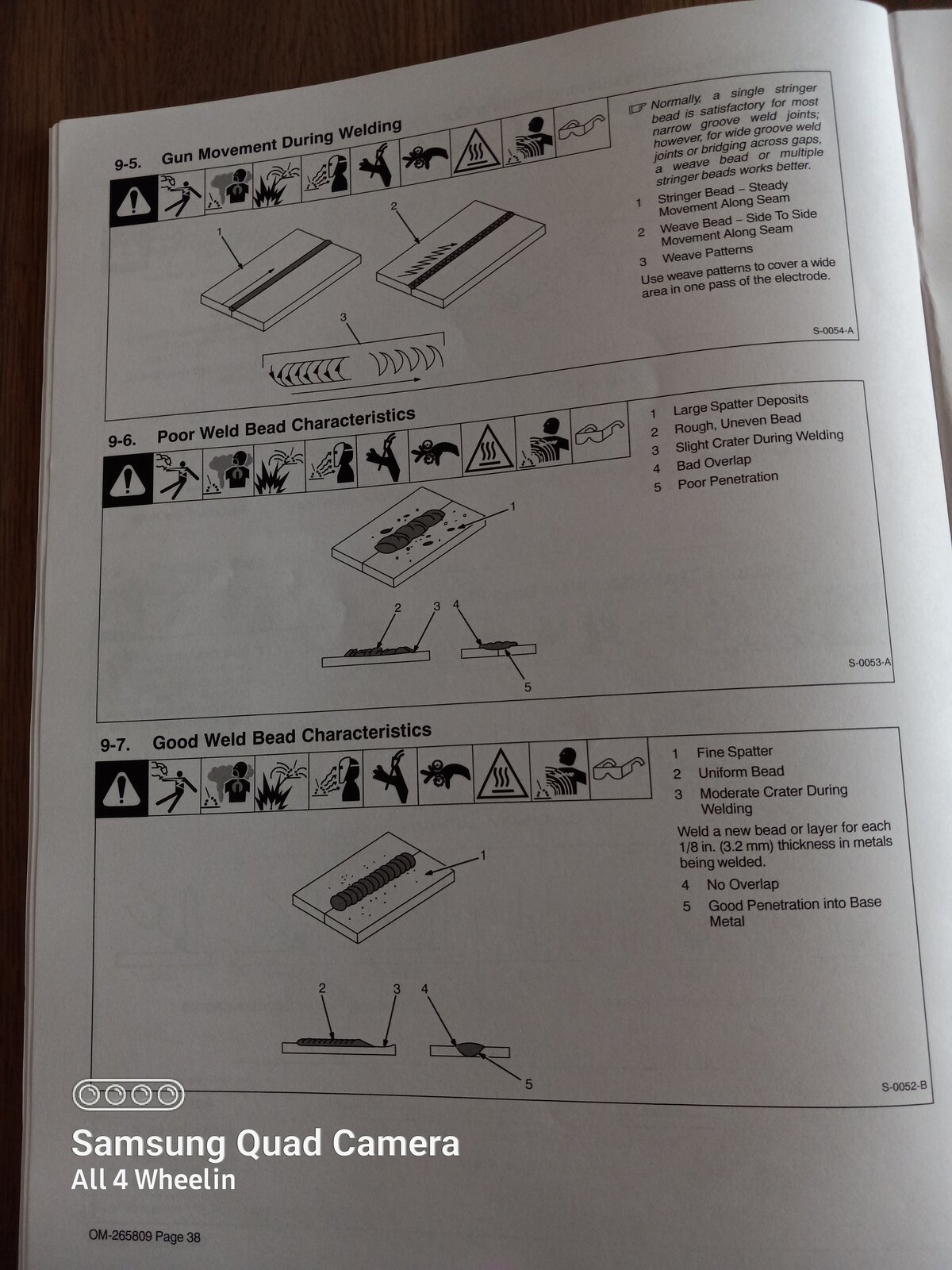

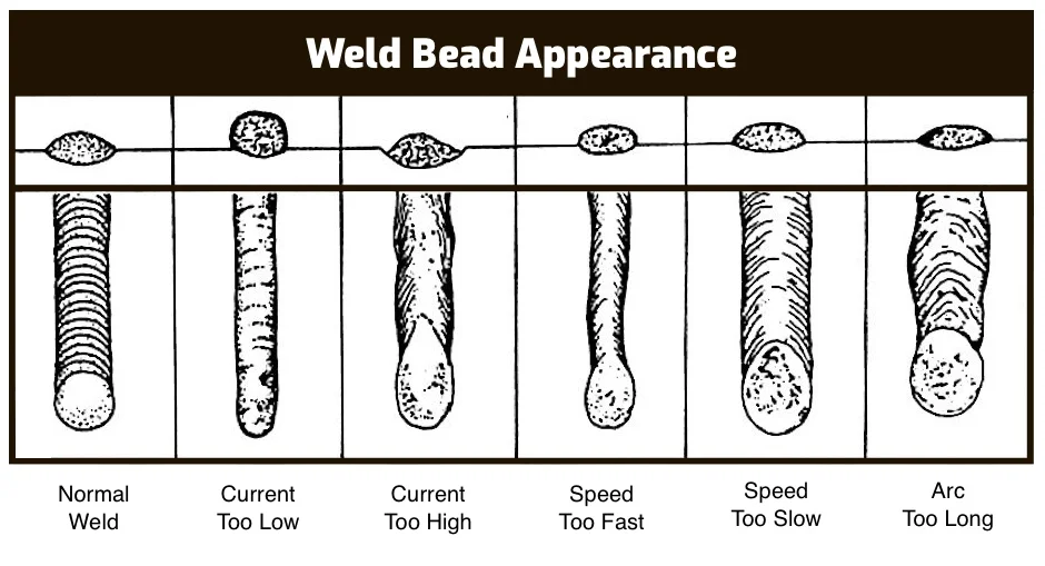

Other factors that may be at play, angle of torch to work, no more than 15 deg to line of travel. Direction of travel, are you pushing or dragging.
I try to keep my work angle at 45*, my travel angle at 45* and drag the pool. Just like this pic. Blaine told me to do this. I also try to keep the torch steady and not make e's or c's, just smooth movement. Due to space constraints, it is sometimes hard to keep those angles.
Reactions: Wildman

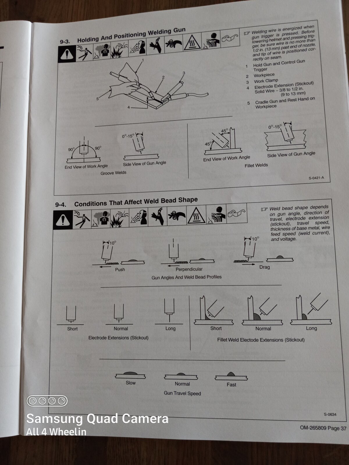

From my millermatic owner's manual
Reactions: JMT

I'm no pro, but that weld didn't penetrate. Its kinda piled on the body mount vs being burned in. If you look at the other side of the body mount in that same picture, the difference is pretty obvious to me. Its probably more a tip angle and approach problem vs a welder setting, since that one is the inside of the bracket vs the outside.
Reactions: JMT
I better make another pass. Thanks for the insight. I think that’s the weld where I fell off the line. I don’t have a good feel for what speed I should move the torch. 🙄

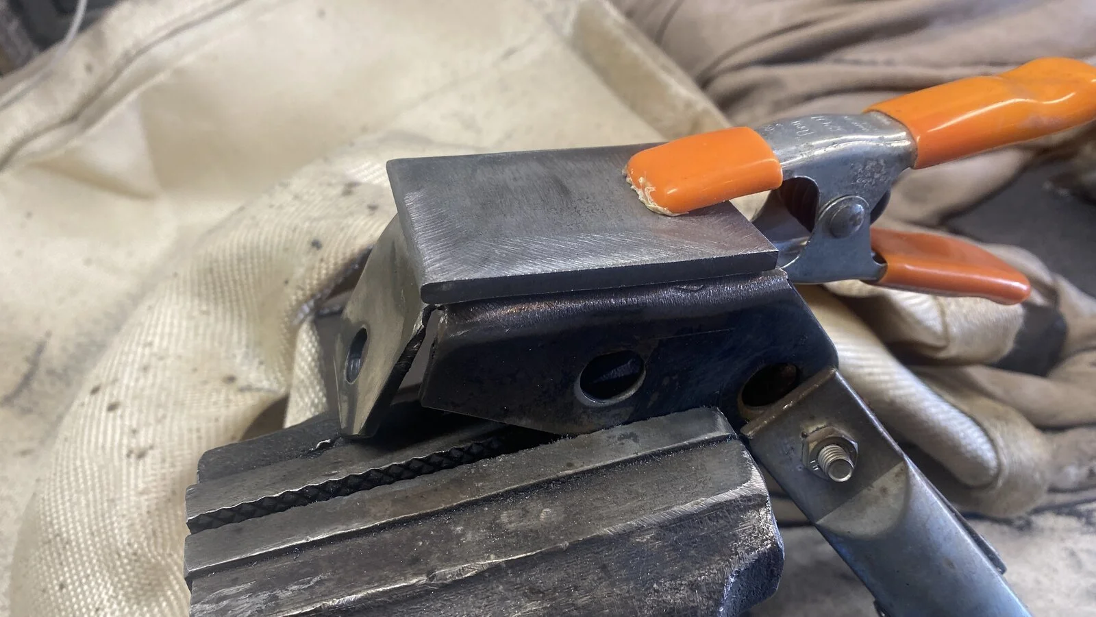

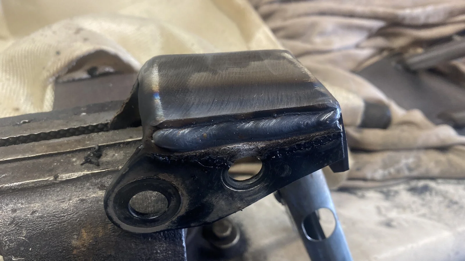

My attempt to fab rear shock extensions was a bust. I got into it just to move my Currie extensions over to my sons TJR. The extension was already damaged. The sheet metal is just too thin.
I tried to fab up some better extensions out of 3/16”, but they were slightly too narrow. 2 hours wasted. I have a greater appreciation for those that fab up brackets, particularly good ones and not crap. I decided to reinforce the Currie’s, but while I did this I learned something. This is a waste of time, except learning more about welding and why the top shock mount location sucks.
I tried to build up some weld on one extension by making several passes and grinding it all flat, like is sometimes done on the bottom of a diff. It worked, but it was too much work for too little gain.
I cut some 3/16” and welded it to the bottom and used the grinder to make it a smooth ramp, like a mini skid.
This was much better. Seamless after the grinder! Looks stock. Way heavier!
After all that I learned that rear shock extensions to clear the axle just is not a real solution. If you need it to get you by for awhile that’s fine, but the real answer is to outboard. blackjack brought the idea to my attention in January, and when you take time to look at the whole situation you realize that trying to cram 10-11” travel shocks in there is ridiculous. You also accept a hangy downy bit, due in part to the rotated pinion, which is counterproductive. Stock probably wasn’t that great either. That puts outboarding will definitely on the agenda. At least for now the skids are strong and it will get me by for awhile. My son will have to fend for himself with some kind of extensions. I told him if he’d cut the brackets out I’d weld them on his rig.
