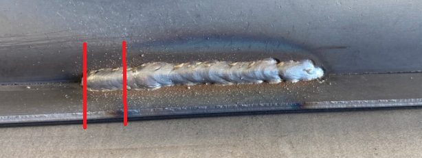

First beads and a filet weld. Tell me what to do to be better. 1/8” steel, gas at 20cfh and amps at 110 for the beads and 118 for the filet
I’ve labeled the order
1 and 2 were just straight lines (lol no tip movement side to side
3 was making e’s
The filet showing both sides
flat open plate is rough nothin to line up on and nothin to help hold or form a clean puddle.
that last bit is what your lookin for. the blistered back says your hot enough and gettin penetration. looks like your set pretty good you just gotta learn to duplicate what you did at the end there consistently.
get a start and slip ahead a 1/16-3/32 and pause for a split second then advance and repeat. slip pause , slip pause, slip pause
see if thats helps smooth things out . it's all about pace. no need to make shapes just point the wire/ nozzle 45* into the corner and 30-40* forward, be set comfortable and sure you can make the whole movement easily b4 you start to weld.

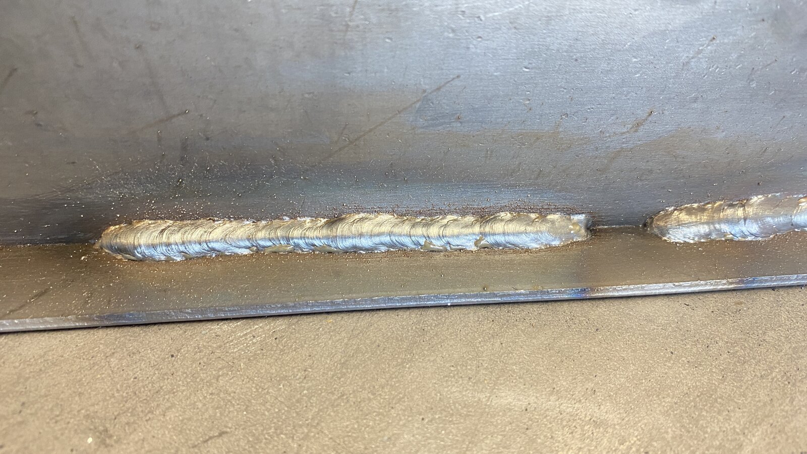

A few more beads and filets while I piddle around and get feedback.
I try to remember to dry weld first so I don’t have to move. I’m holding the tip at 45* and ~45* forward pulling the puddle. That’s what @mrblaine told me to do as the most important thing.
I’ll try the slip-pause-slip-pause method.
Reactions: Alex01
it's literally a micro second pause your just allowing that puddle to fill as wide as the deposit you just left then scoot.
trying to keep a steady pace right off the rip isn't easy, once you start gettin solid lines then you can learn to have the patience to slide along.
not bad at all if this is your 1st time pullin a trigger, that last 1 is not bad at all,

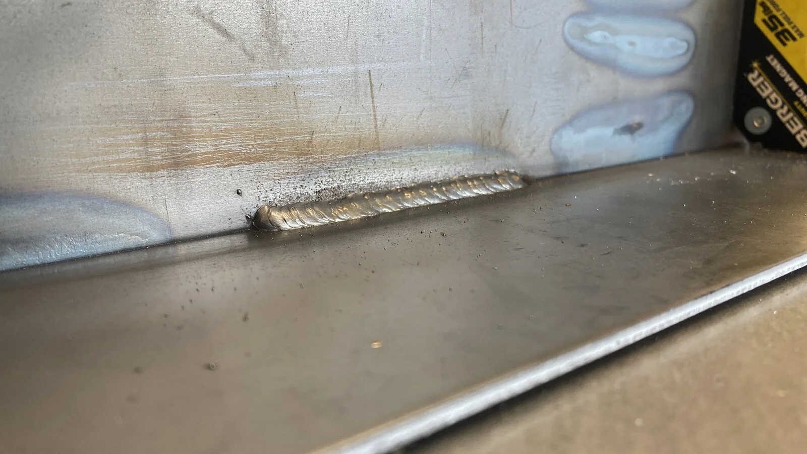

This was my best slip-pause so far. It’s harder for me, but I’m just starting today, so I have a long way to go. I can see why people use different strokes. Blaine said don’t do that!

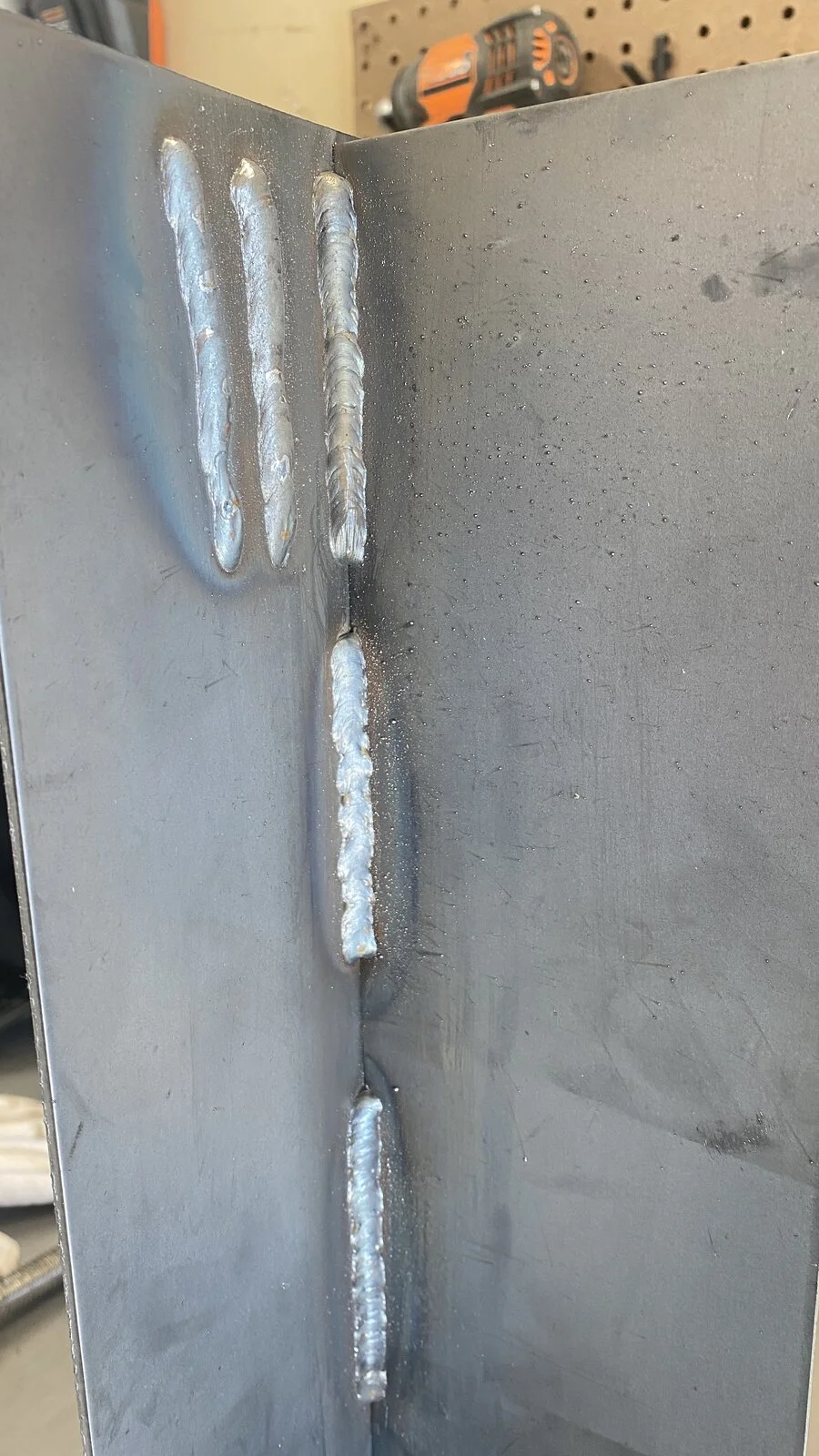

This was a vertical weld (one in the center)
if your more comfortable sliding, go that route. your not really deviating from what Blaine has told you, a hesitation is just that and inline with your motion, it's an aid to confirm your fill b4 advancing.
it's all that hokey swirly circle stuff some do to waste enough time to lay a sufficient deposit while spreading the heat all over and never getting a singular deep penetration that you want to avoid.
vert down can have some motion 1/16 across the center back n forth, this takes heat away and allows a larger deposit to be left behind.
the lines in the welds are the tells, they show were you jumped a little more or stayed a milli second long, when the pace is perfect they blend like a gentle ripples on water. like that 1st end i highlighted.
