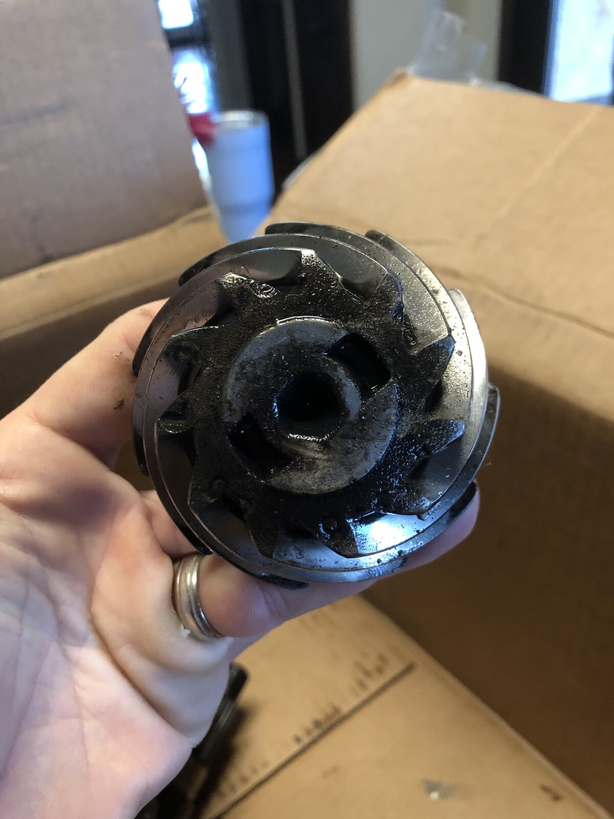

I should’ve mentioned that when I bought this axle it had a spool and one of the pinion teeth was badly broken. Actually two or maybe three were broken and that scoring was on the case prior to my purchase.
For the life of me I cannot find where those fragments have come from.

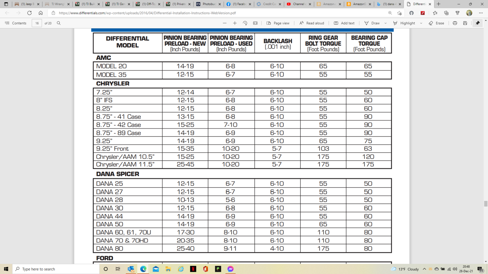

Here are the setup spec's for your Dana 44.
So you want 6-9 inch pounds of preload (rotational resistance) when you try to turn the pinion nut. This is without the carrier installed.

Thank you for the chart of specs. I’ve got an in lb dial indicator wrench that I can put on the pinion nut. What if it turns out to be the bearing? I’d have to remove it from the pinion and press a new one on.

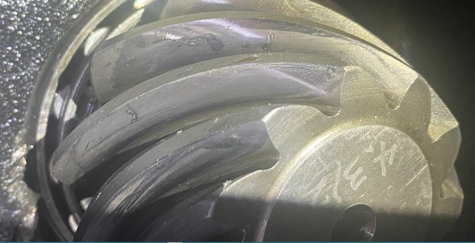

appears to have a few scars on the pinion head and the engagement is patterning a push all the way to the end of the tooth. does it llok like it's a bit deep into the root also? see that clean swipe at the bottom of the tooth.
when you put it back together put some grease on it and run a pattern.

Those races appear to have wear and maybe some fragments rolled into them. I'd put all new bearings and races in while its apart.
