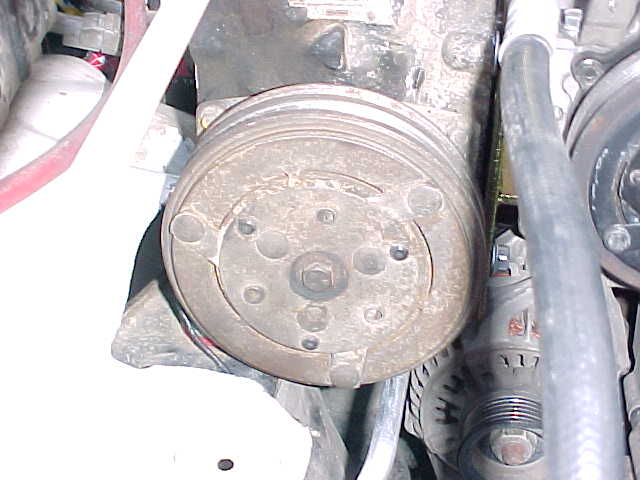

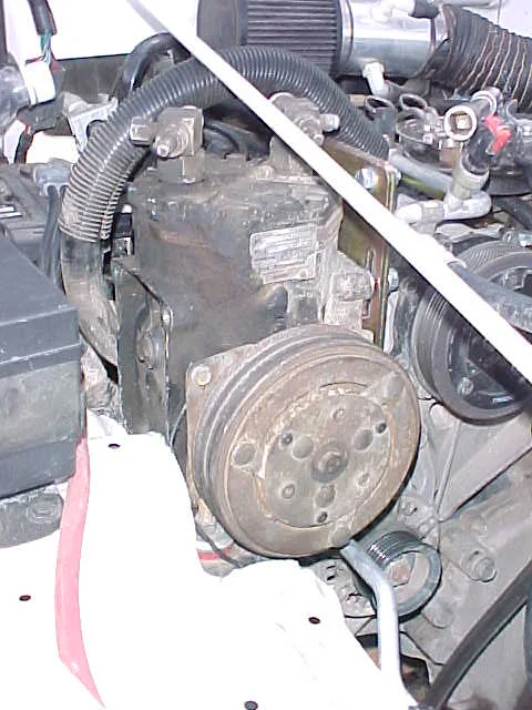

Here is how the York mounted on my 4 cyl. It was next to the A/C compressor. It's been too long now for me to remember anything about it.
This used a V-belt instead of a longer serpentine belt.
It was kind of a T bracket with the top of the T bolted to the York and then the vertical part went under the A/C. Don't know if that helps any as I haven't looked at how your setup looks.

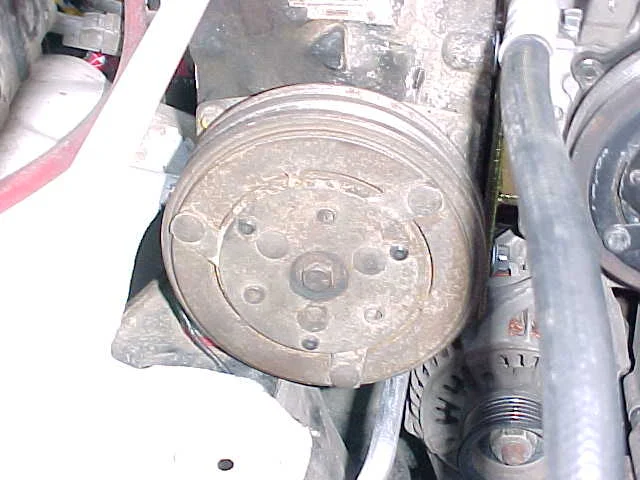

Yes, this was one of the first mods I did to my TJ after I'd bought it in 2002. Kilby sold his business a while ago and is now CU Off-Road.

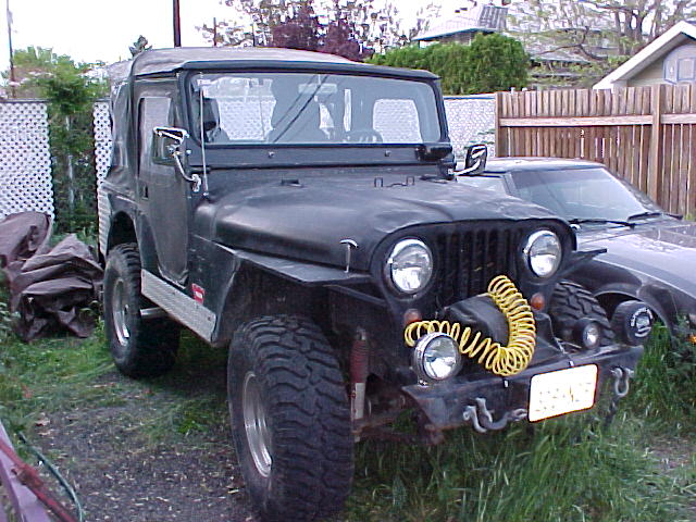

I've had a York on all my different rigs for a long time, here is my old CJ 5 that had a Buick 231 V-6 in it that I built a bracket for the York.

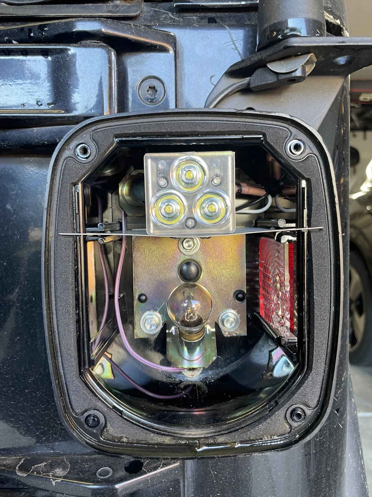

Got my LED tail lights in from @Claytone. Super bright and easy install, definitely recommend

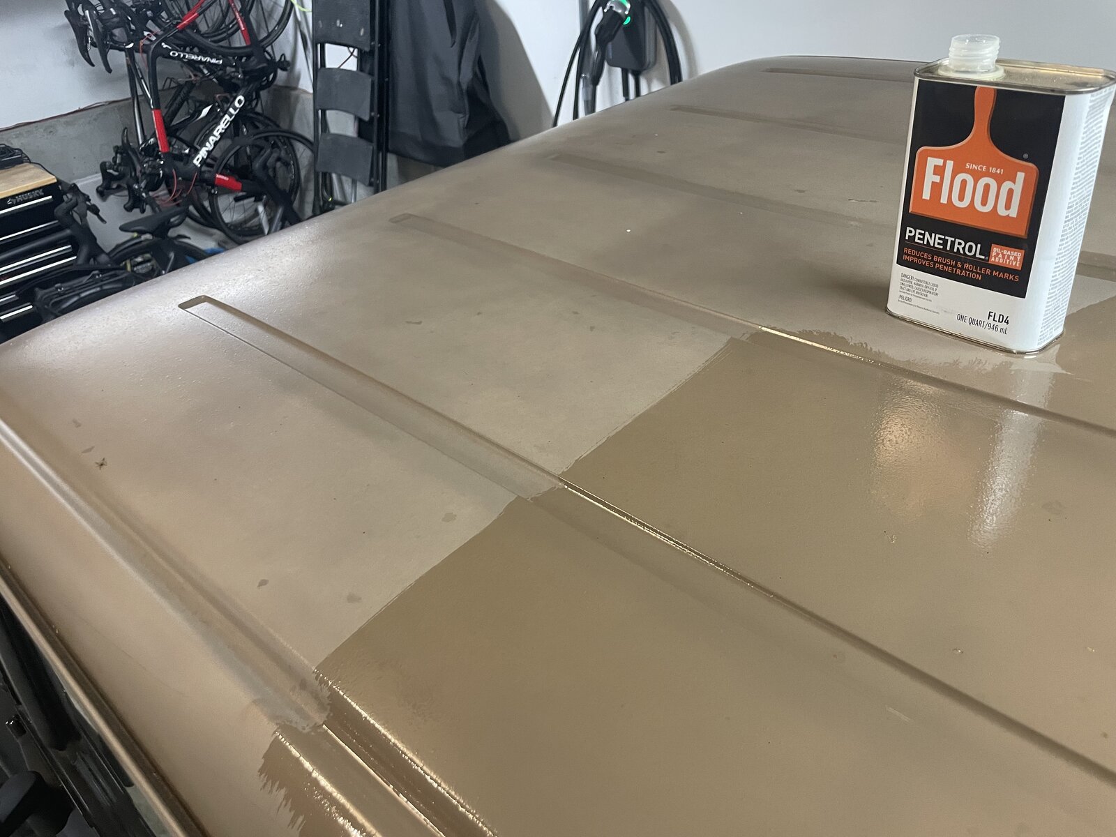

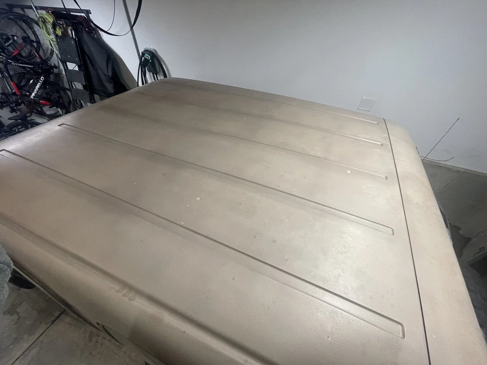

Also found a cheap hardtop, which was in better condition than my black one. Some penetrol and she looks good!
Can't decide if i prefer the black top or the tan top. Currently have the black one on my dads TJ.

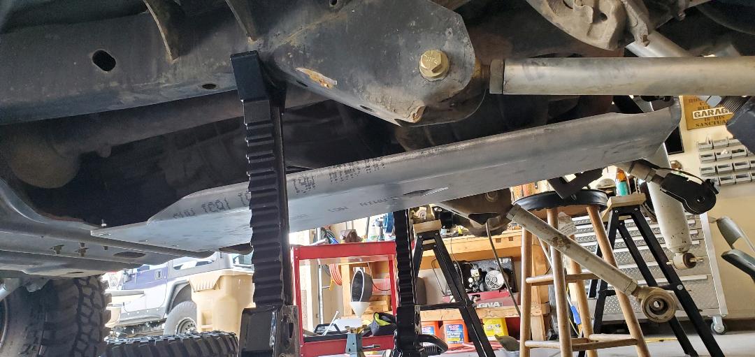

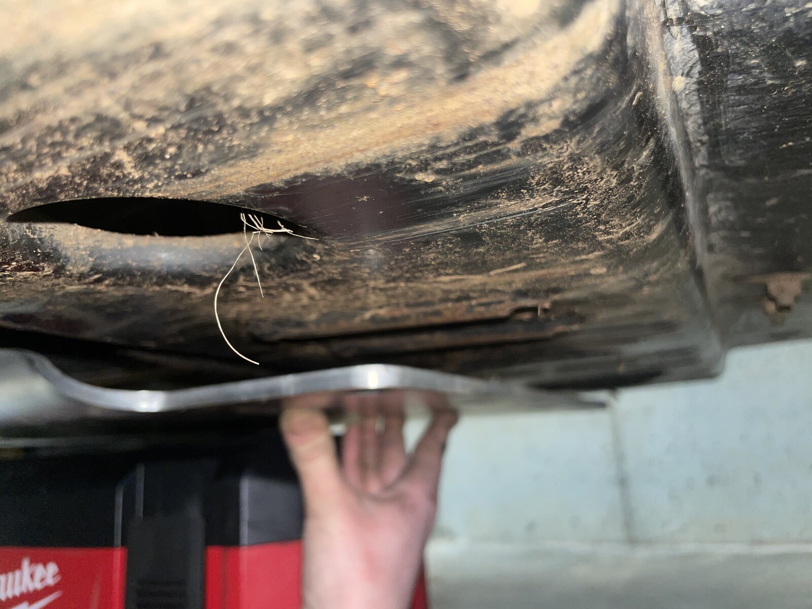

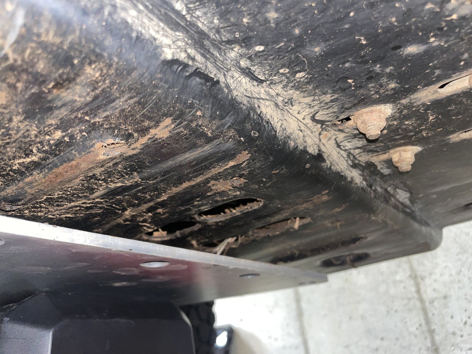

Picked up a Savvy engine skid on craigslist. Having issues with mating it to a stock skid plate. I believe on 03-06 skids it bolts right up after drilling some holes. On 97-02 skids it will not sit flush at all. Seems like it will take some major grinding to even out the stock skid so the engine skid will sit flush.
Debating whether it’s worth doing all that work to the stock skid or if i should just get a raised aluminum skid and then put the savvy engine skid to that. Anyone bolted this skid up to a 97-02 before? Was it worth the effort?
That’s the gap it has. Seems like i would need to grind the front edge as well as the ridges on the middle.

My '04 had the front lip of the stock TC skid already ground off. Not a great pic for the detail needed but ...

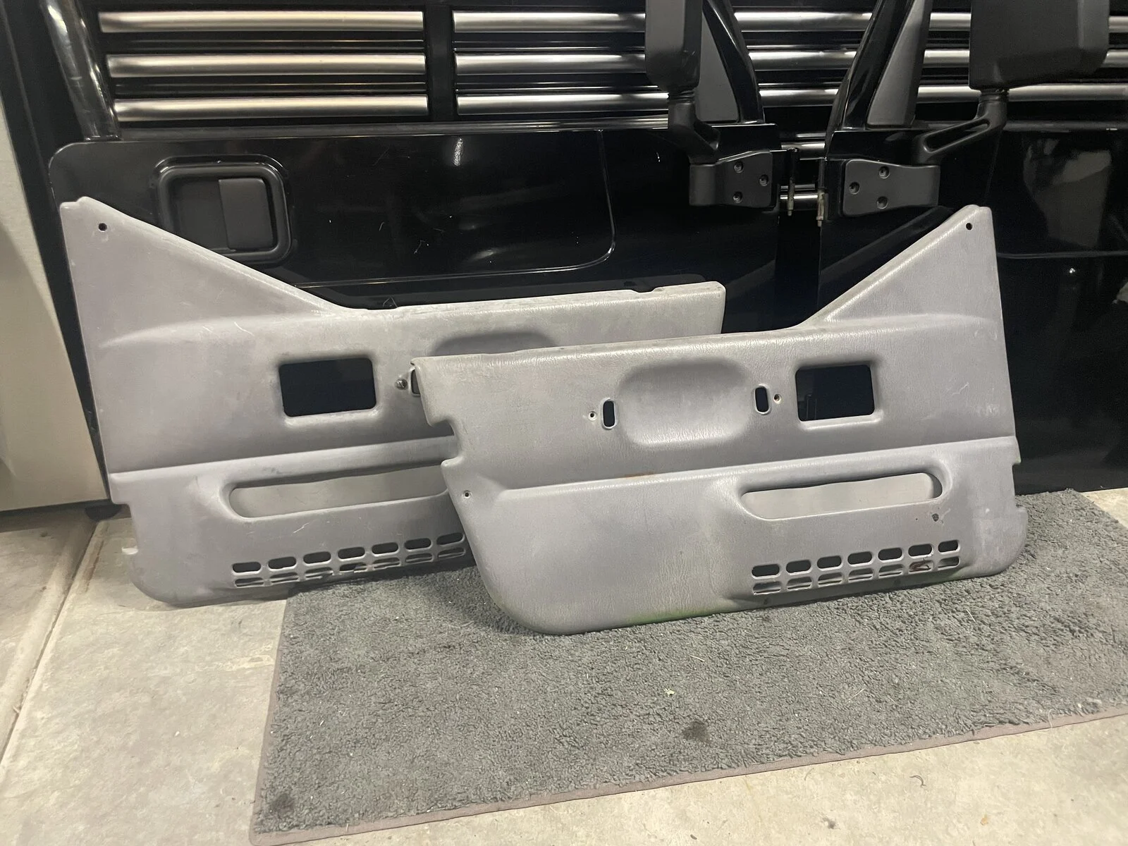

Half-Door Restoration Part 1:

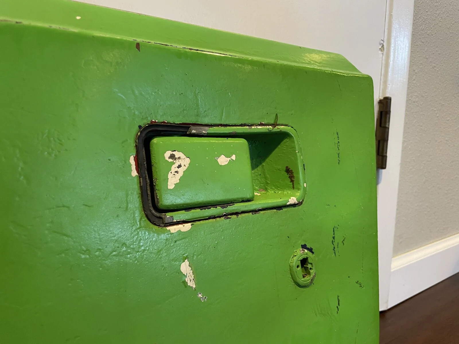

A bit over a year ago i picked up these half doors for 400$. They were in fantastic condition and came with soft uppers as well. This was october of 2021, and i held onto them until spring which is when i had plans to paint them. However spring rolled around and I couldn’t bring myself to scuff up the nice paint, so I sold them off to someone who would appreciate their condition (with insane half door prices i doubled my money)

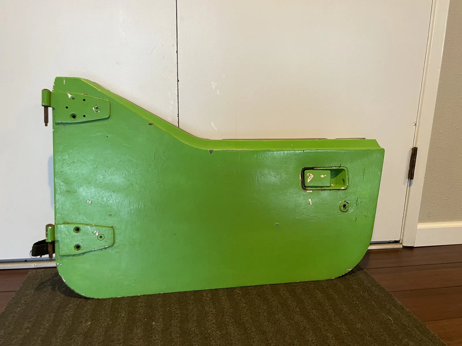

However still on the hunt for half doors, i picked up this set for 100$
From what i can tell they were repainted 3 times. Originally red, then blue, and then coated with green.

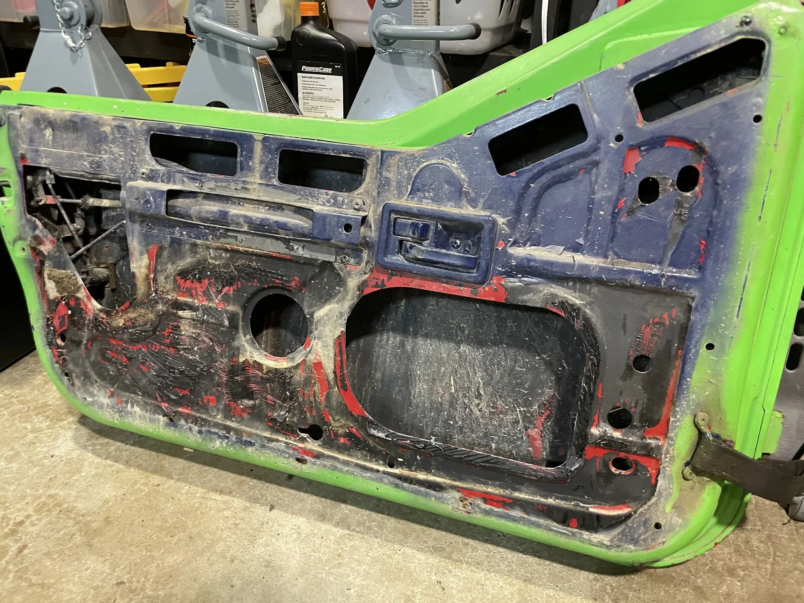

Half-door Restoration Part 2:

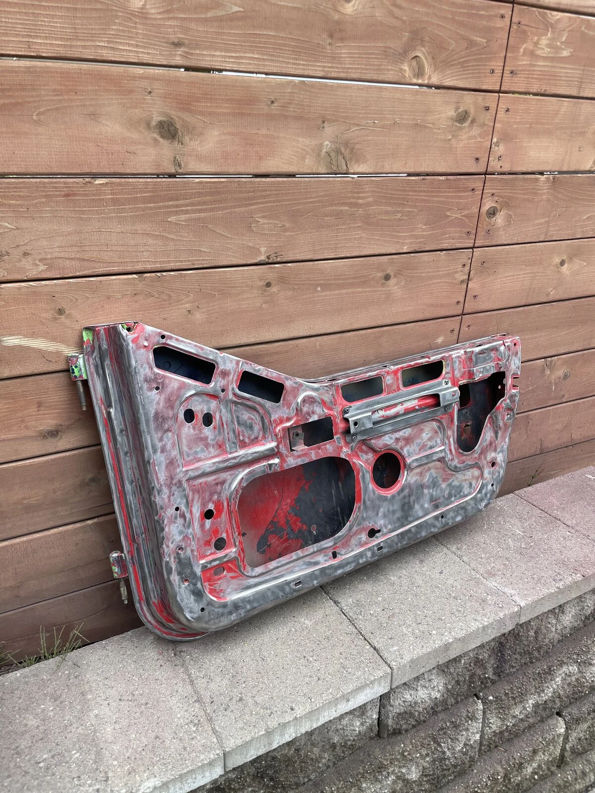

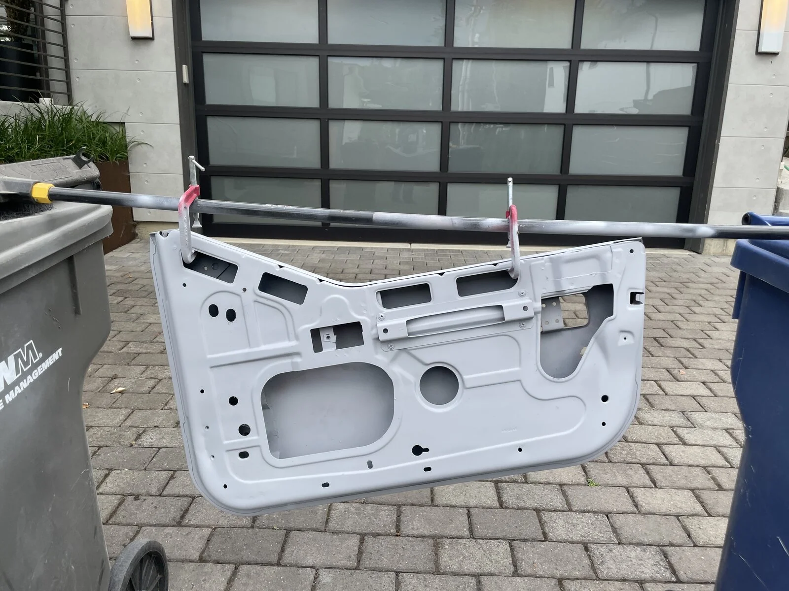

After tearing the doors apart, i decided to strip them completely to bare metal. Had they been in good condition like the original doors i would have scuffed the paint instead of going to bare metal, but these doors needed to be completely stripped
Starting with paint stripper, which removed the first and second layers
And then using a wire wheel/angle grinder to remove the rest of the paint
After A LOT more prep, i gave them a coat of primer to help me see the low spots
At this point they were almost ready for a final primer, but i spent lots of time fixing imperfections

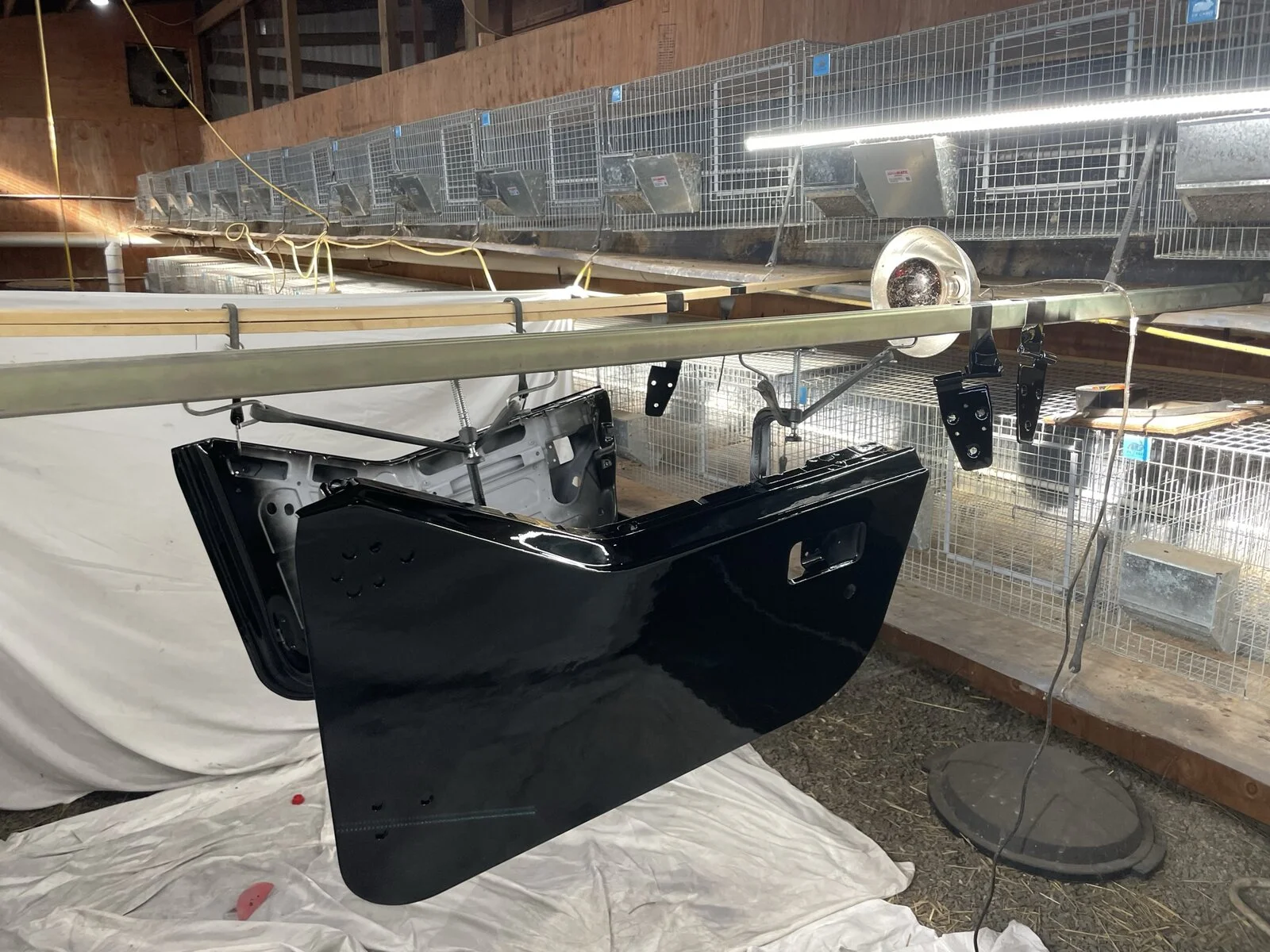

After spending a while on the body work, i was ready for the final primer
Wet sanded the primer, wiped it down, and then gave it the base coat and clear coat
For paint i used duplicolor color match, and for clear i used Spraymax 2k gloss clear. Both spray great, no regrets with those choices.

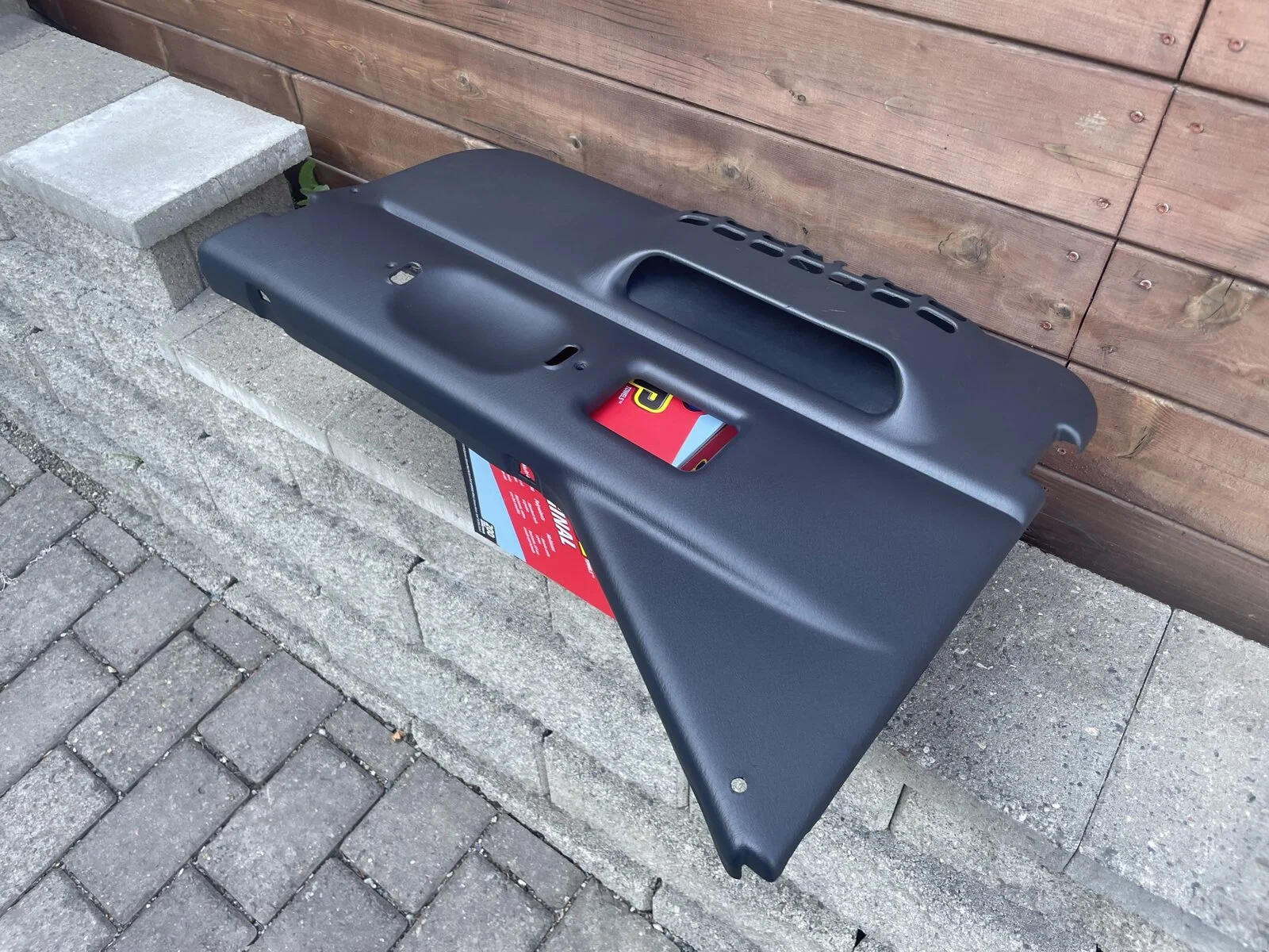

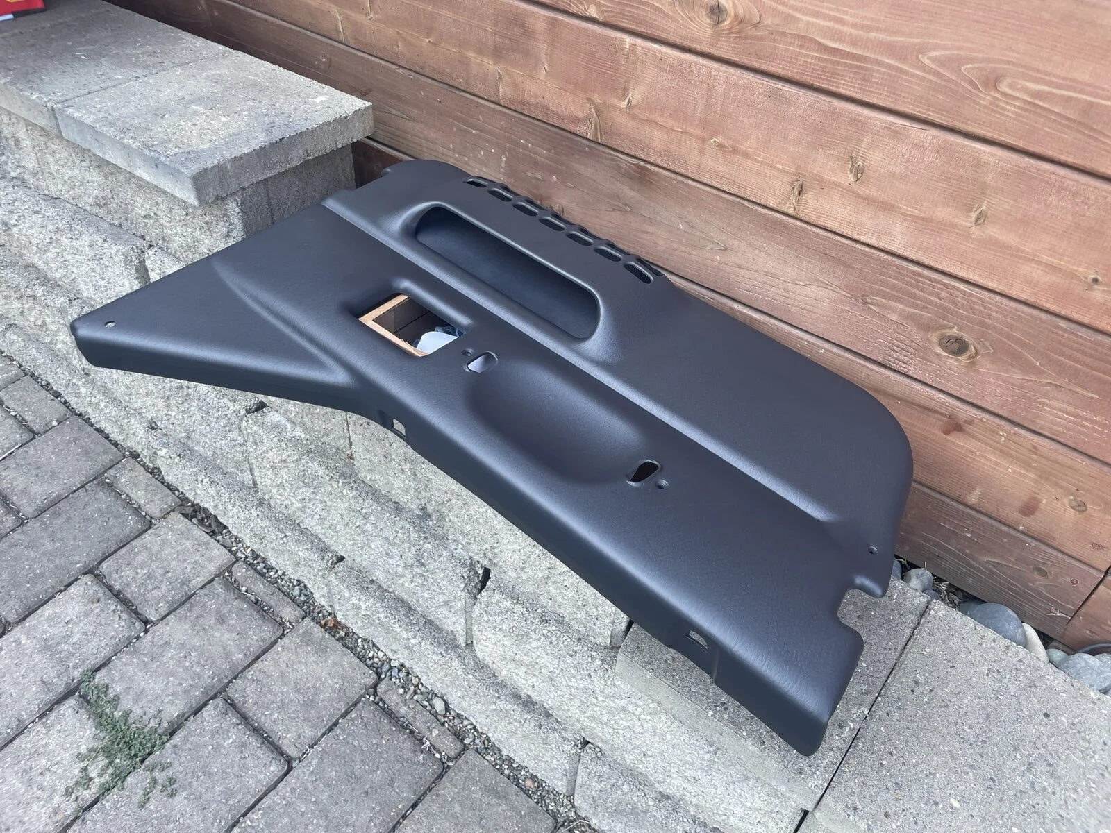

Half-Door Restoration Part 4:
The hard part was done, and all i had left was to paint the panels and assemble
For the interior panels i used Colorbond agate, which matches pretty well
Scuffed the panels with scotchbrite, gave them some plastic adhesion promotor, and then the paint. Everything went on super easily, paint sprayed light and dried quick

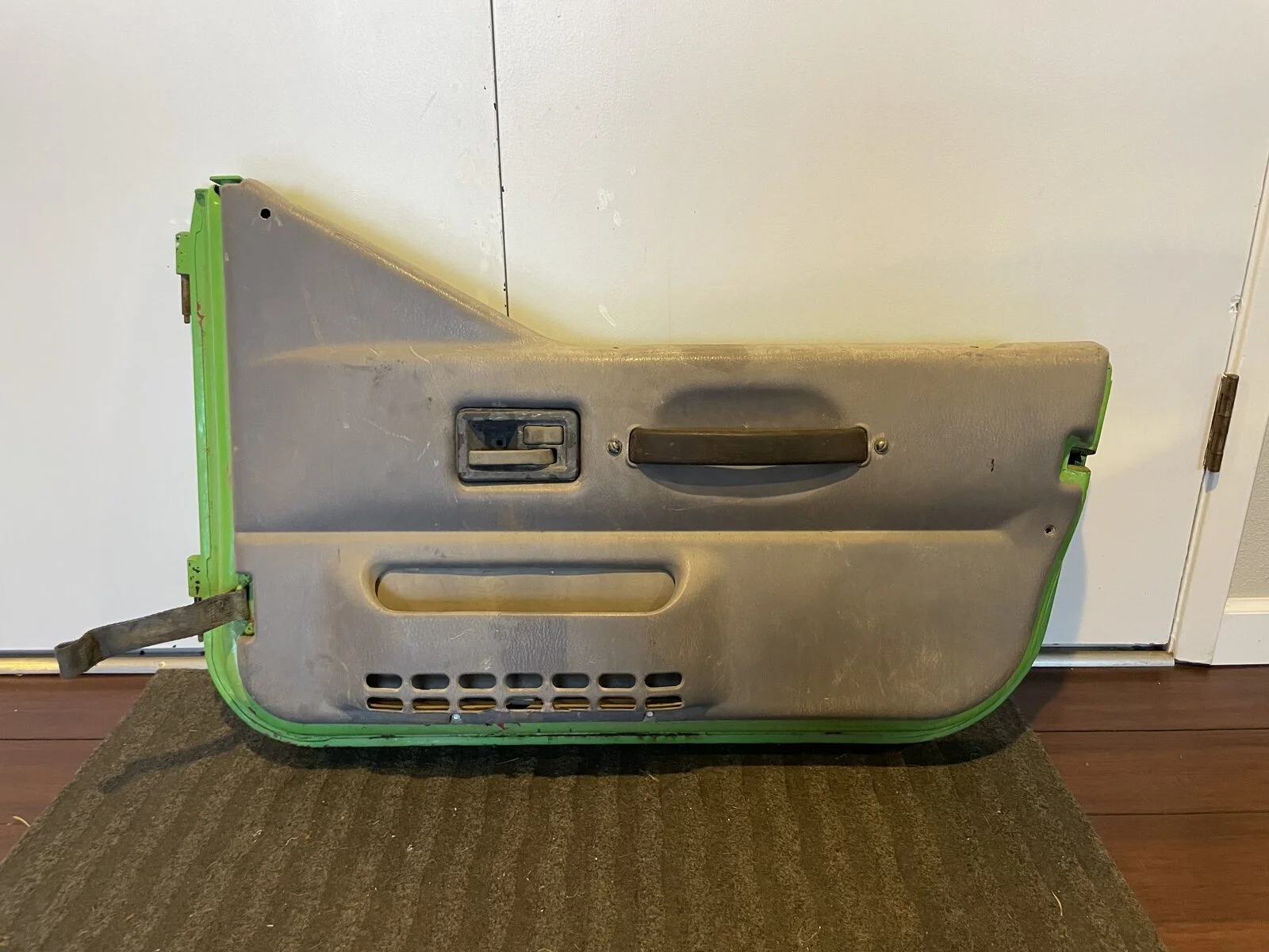

Half-Door Restoration Part 5:
Majority of the work was done, just worked on the finishing touches

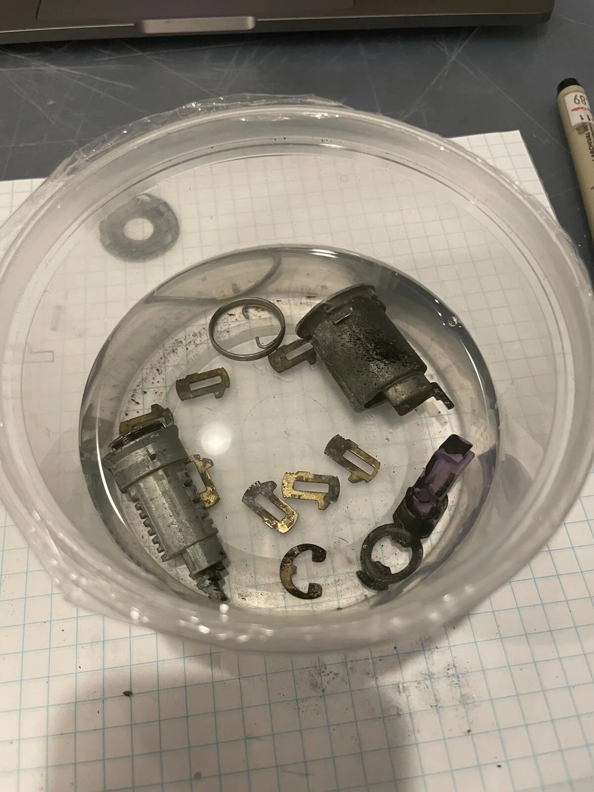

Followed @MountaineerTom guide for re-keying half doors, seems intimidating at first but is actually a simple task.
Soaking the parts in cleaner before reassembly
I don’t plan on locking my doors, but it’s nice to have the option. Also added a new key cap as the old one was worn down and it was cheap to replace

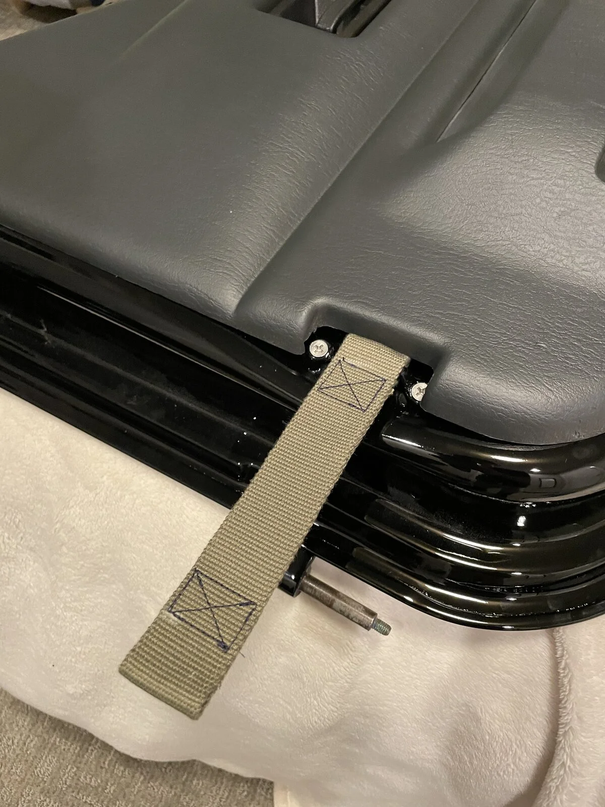

Door straps were worn and uneven, so i painted the metal posts and had my mom sew up some new ones
Also got all new door locks and handles, which made a huge improvement for the restoration
Lastly, all new screws. I just went to my local ace and picked up some black painted philips. They blend in well.
